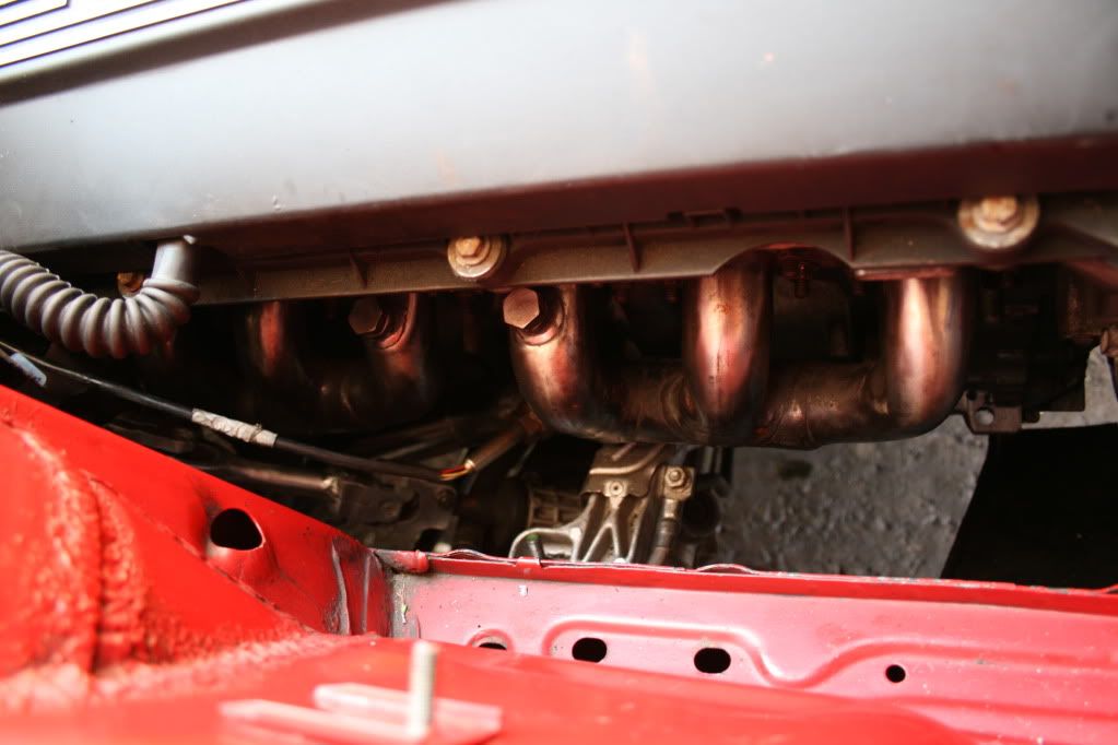

Quoted from Cooks build thread...
Cook318IS wrote:Its rather... quick. I currently have a smile like this - :D
Im estatic about my manifolds. M52 manifolds with 50mm(iirc) stainless downpipes. The quality of the job is nothing short of epic. Im so happy about them!

they look very nicely done 8)

Sun Aug 01, 2010 3:16 pm
He did a nice job of them.
Sound awesome too and gave good dyno results on his standard M52.
No cutting back of the rear manifold either when using a solid steering coupling,just a small indent in the downpipe was needed I think from memory?

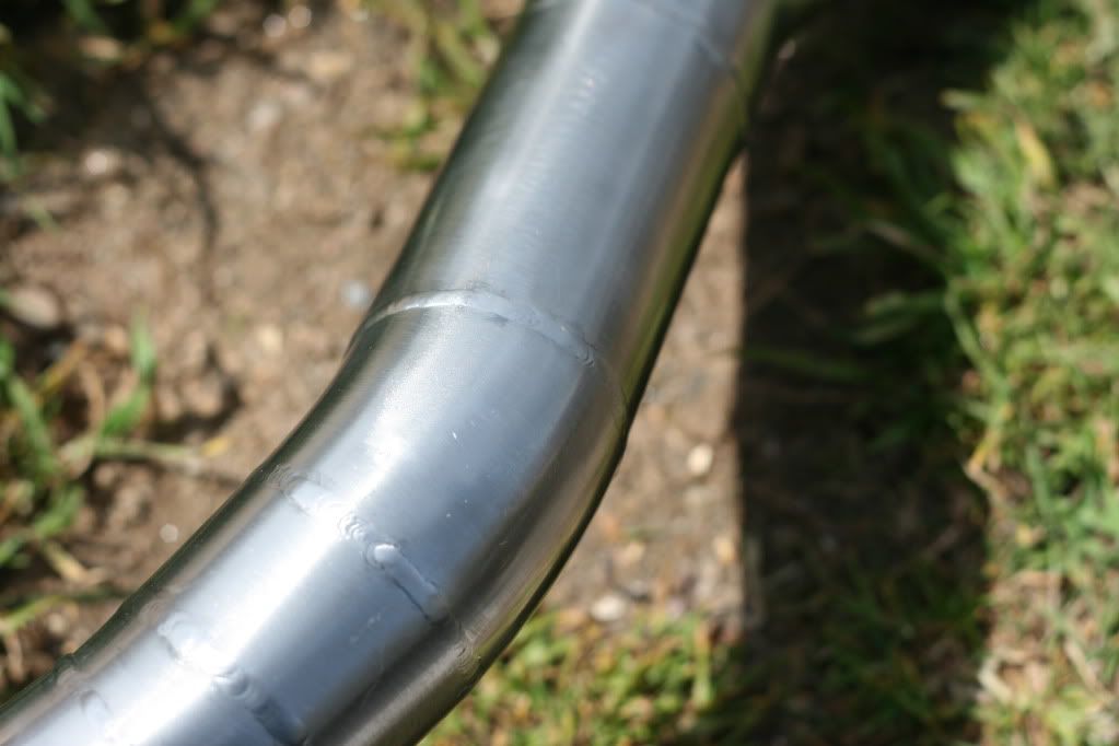

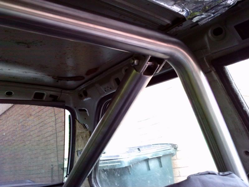

Thought id post this pic of the cage he is building in his iS,not to FIA regs but the welding quality is awesome.

I love my manifolds :) Very high quality job. Infact i'd go as far as saying that he is one of the most talented welders i have ever seen. And as im sure eko will agree - the stainless gives off a nice noise when the loud pedal is in use (edit, just read that you already said that :o:. Car made 203bhp still restricted, completly standard except the induction kit)

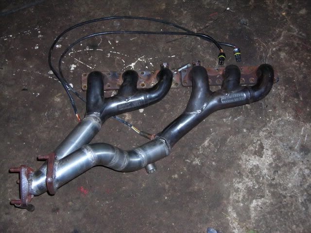

Here's some we made for a M52 swap we done recently
