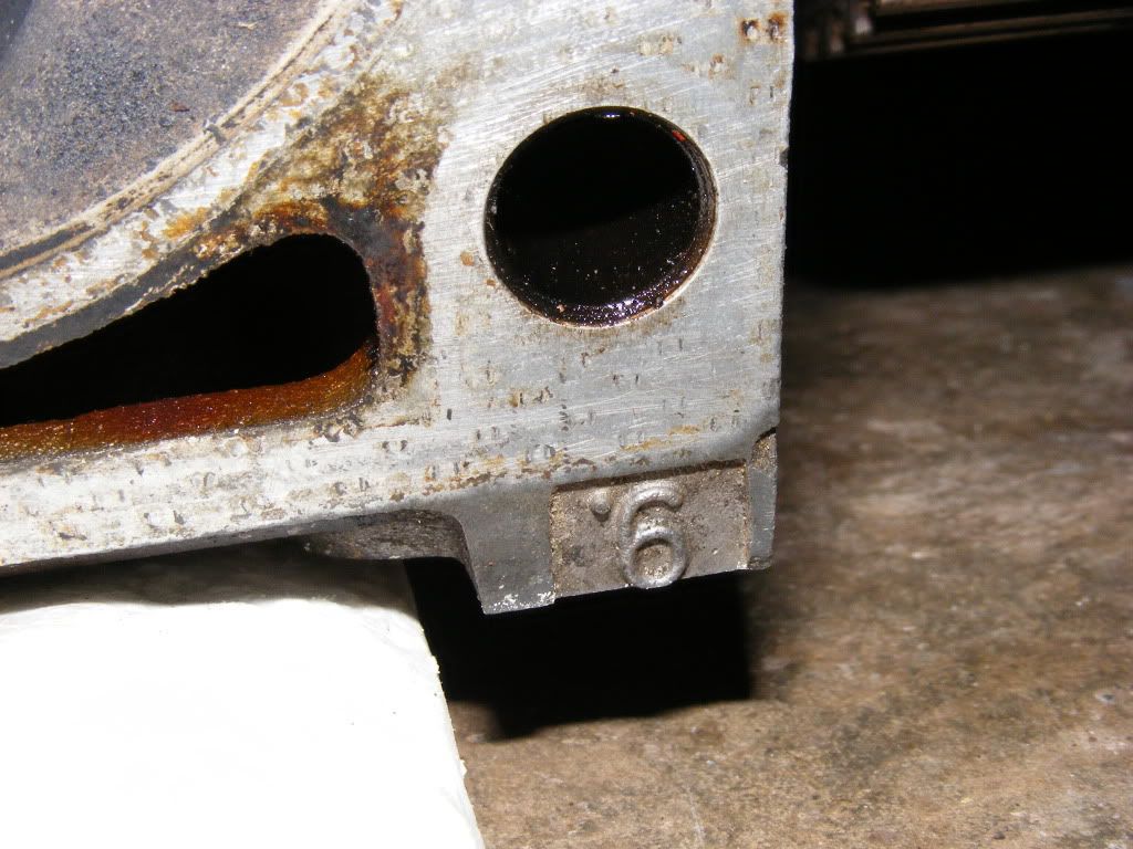

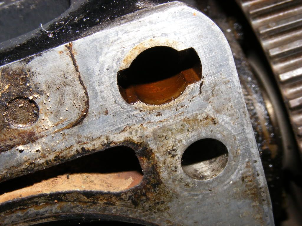

Is the head off the car if so there should be indecators on the corners of the head on the sealing side if these are gone and smooth the chances are it has a thicker gasket fitted if it didnt it would the piston would rattle the valves
The head is off and I can see there are little dimple on the sealing side of the head, pics below, cant tell if this has been machined in the past or not, had it checked and it perfectly straight, do i really need it skimmed and a thicker gasket or just use a standard one?

A skim is the standard responce when you ask a machine shop if it needs it or not.
Give it a clean with a scouring pad and check its true then bolt it down (provided its not cracked)
