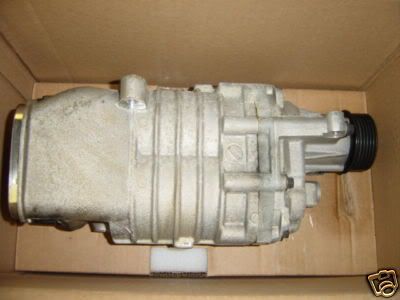

Super charger:

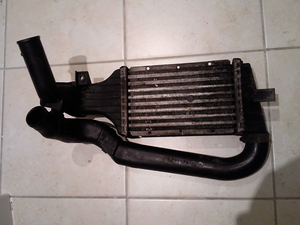

What im planing to use for my charge cooler + header tank:

good luck with the conversion mate, is that supercharger off a mini cooper s?
rix313
Posts: 4970
Location: Silverstone
Post Sat Nov 22, 2008 6:46 pm
Sure is :)

this might seem a little dumb but i dont know much about superchargers, but do you need an oil feed to it like you do with a turbo, i take it you water cool them then ????? :o:
rix313
Posts: 4970
Post Sat Nov 22, 2008 8:01 pm
They don't usualy need to be lubricated or cooled and they don't wear out so easily like turbos do. They have very close tollerences so nothing touches but its so fine its unreal.
The Rotrex chargers (the one Appletree is using on his new build) have an oil feed but I wont need one for this charger.
The cooler I bought is to cool the air down as it comes out of the super charger so it burns better.

How are you going to use the intercooler to make it in to a charger cooler???
Also if you haven't got mounts yet it msy be worth speecking to hoshy and alex to see if they could help you out with making a set.
lastly if you can i'd try and use intercooling if possible, its alot easyer and less complicated :D

I have had a though of making adaptors for it all out of glass fibre to make it possible to connect it all up.
The cooler was £15 from the scrap yard and it is leak free but yeah see what I can come up with with my accomplice.
Can some one tell me what the techincal difference is between rads and intercoolers besides one takes air and one takes water what makes them so different?

Alex wrote:this might seem a little dumb but i dont know much about superchargers, but do you need an oil feed to it like you do with a turbo, i take it you water cool them then ????? :o:
the copper s charger is self lubricated its a sealed unit, you can use a intercooler or charge cooler to drop the temperature of the air going into the engine, but superchargers do no get anywhere near as hot as turbos do :)

An intercooler has larger inlets and outlets and also has larger ''passages'' between the fins to improve the flow through the core. You cant realy use a rad as an intercooler as the inlets are to small and so are the cores.
I dont think fibre glass will be strong enough for holding 5-8psi boost unless its silly thick and has metal inserts were the hoses clamp up to it. If thats were you ment using it. :D

appletree wrote:An intercooler has larger inlets and outlets and also has larger ''passages'' between the fins to improve the flow through the core. You cant realy use a rad as an intercooler as the inlets are to small and so are the cores.
How about an intercooler as a rad? surely I could put a restrictive pipe on the outlet to stop the water shooting through too fast?
Noted about the GF was just a spare of the moment thought. Gonna need a bit of a brain storm for coming up with something to take the charge from the super charger.

You could i supose use an intercooler as a rad, but whats up with the rad in your car at the moment? You normaly put your intercooler in front of your rad.

I'm gussing you can piggy back off of the main rad for the charge cooler? That correct?
I'm going to look at using the intercooler as an intercooler and have a play.

Some advice.
1. Get your hands on two mini digital thermometers, the ones with a probe on wire.
2. Place one away from the engine and manifolds, not too close to the road either, this thermometer measures the surrounding temp
3. Drill a small hole into an intake pipe close to the throttle body and place one probe here.
4. Place both LCD displays inside the car somewhere around the drivers cluster.
5. Watch the outside temp and the temp of the air going into the car and see which setup works best.
A small front intercooler will be fine for this setup, (search for a 2wd cossie intercooler)you do not need one as big as the radiator. Also the less pipework you have the shorter distance the air needs to travel. So keep everything tight and on the shortest route possible.
Fit a recirculating dump valve, to release excess pressure that otherwise would charge back to the supercharger.
You can also get an atmospheric pressure switch to operate the electromagnetic clutch on the supercharger if it has one, otherwise wire this into the ignition.
Also buy silicone hoses for the joints and bends with jubilee clips, theres no point bodging a conversion and having boost leak.

Mount the intercooler you have in the above posts, near the passenger side wing with a surround and have a vent cut out forcing air into the wing, that way its still subtle.

No you can't use the engine water supply for charge cooling it would more than lightly warm the charge air up. It needs its own resivoir, pump, cooling radiator (i used a jag xkr charge cooler rad that is as big as my rad) for this set up to work properly.

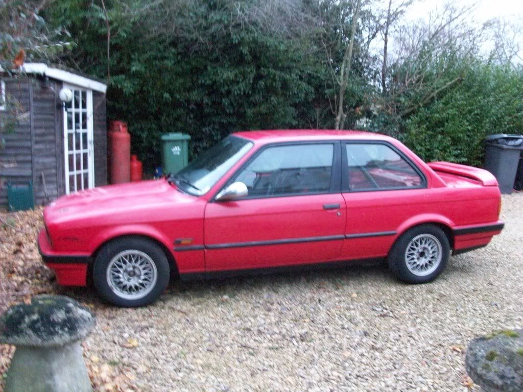

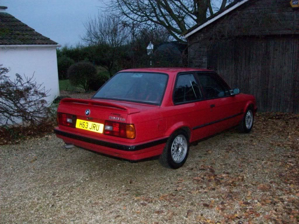

Got some pics of the car today:
TomCropp
Posts: 156
Joined: Sun May 11, 2008 11:00 pm
Post Sat Nov 29, 2008 9:16 pm
looking good chap!
