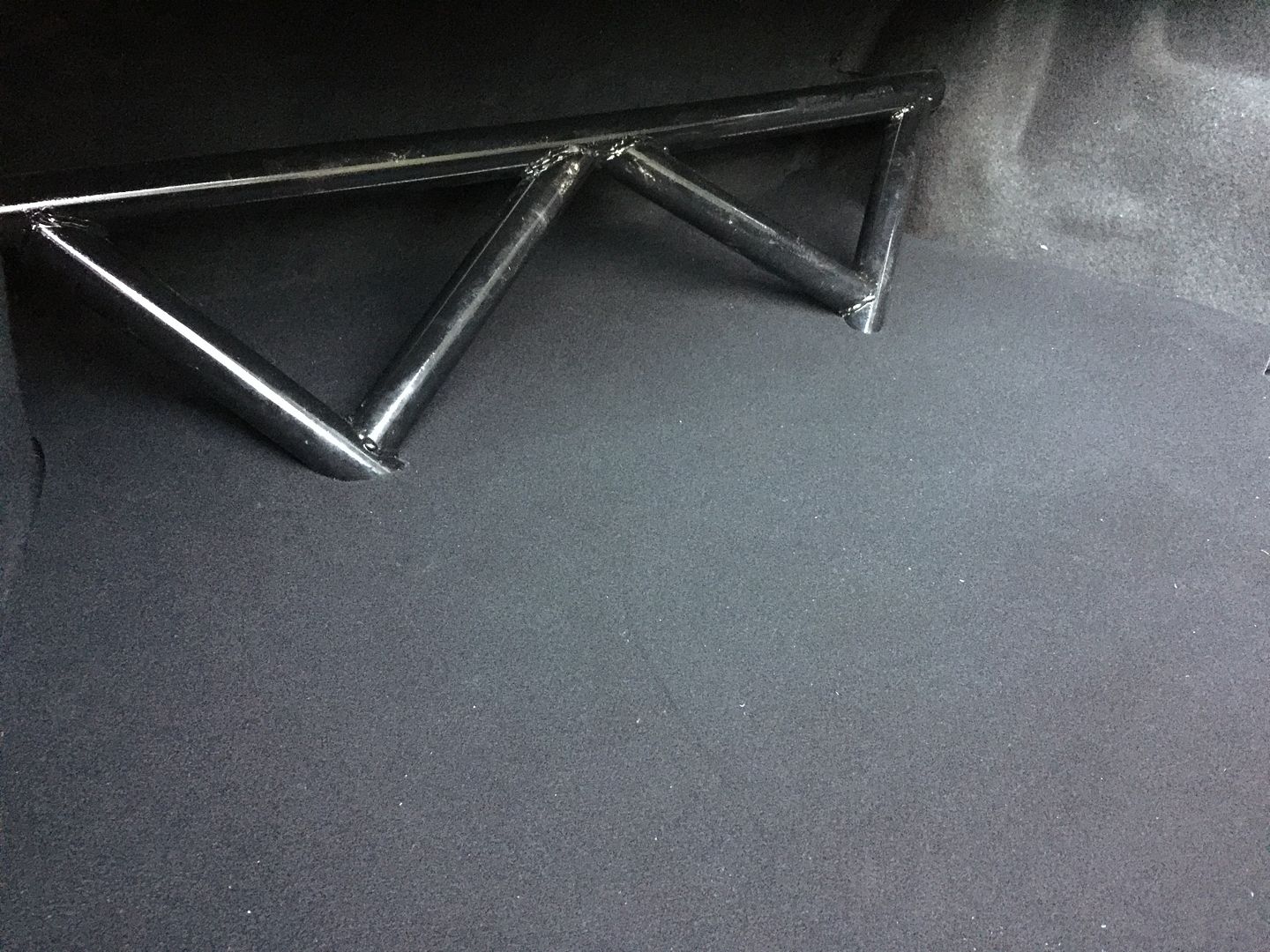

Done another couple of little bits today

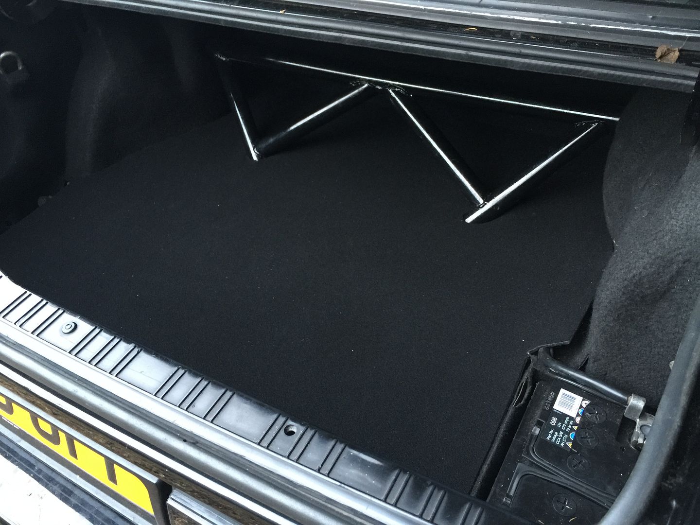

I've finished off the boot apart from the fuel side and got to get a new battery cover

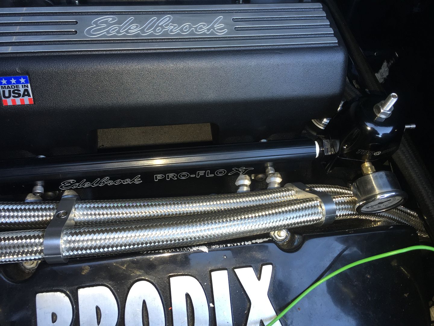

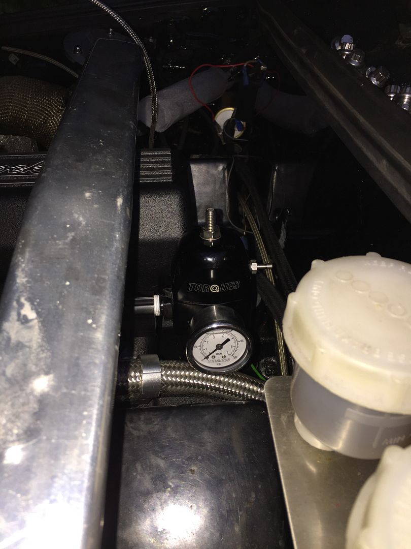

Fitted the fpr to the rail too

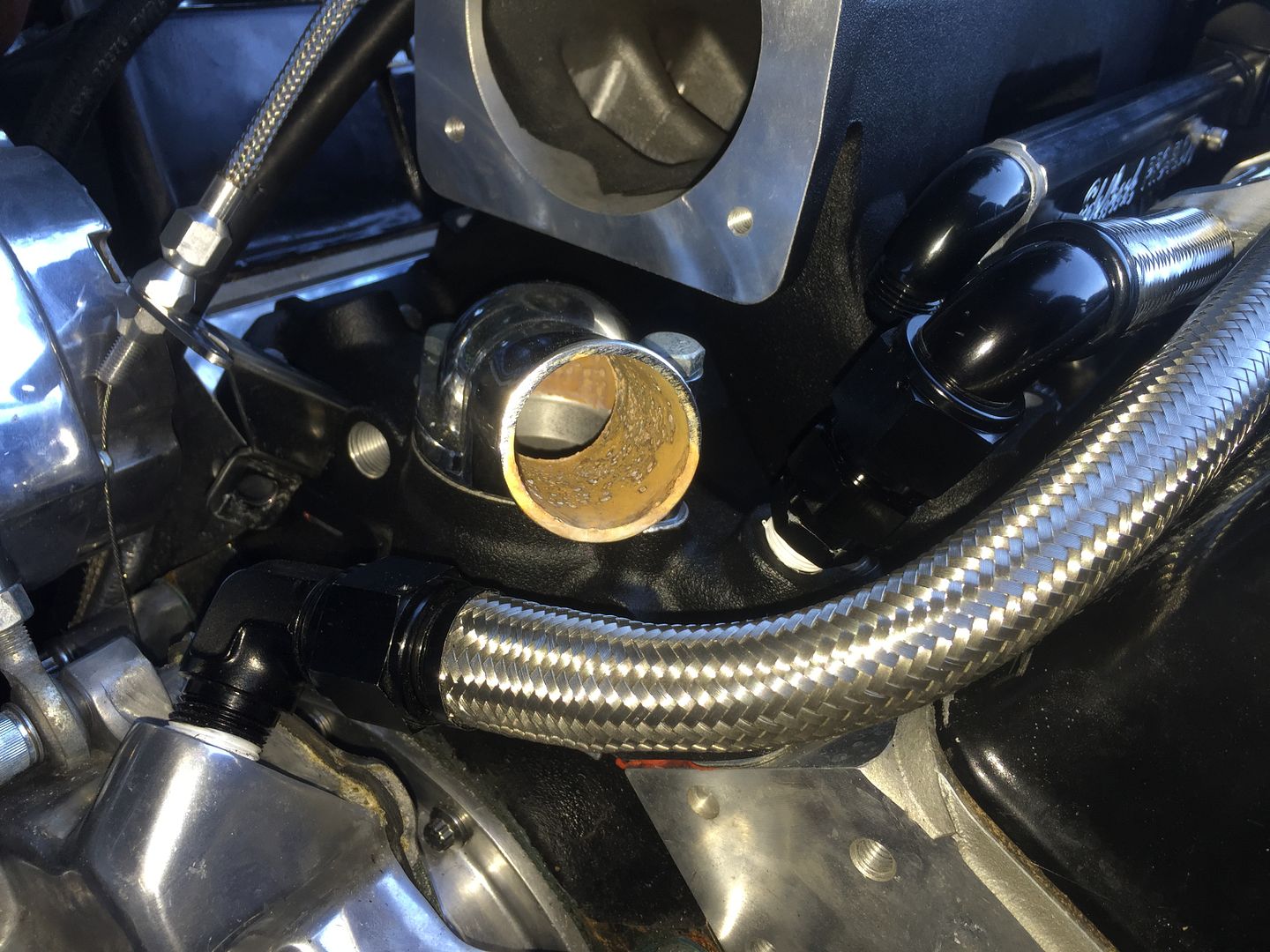

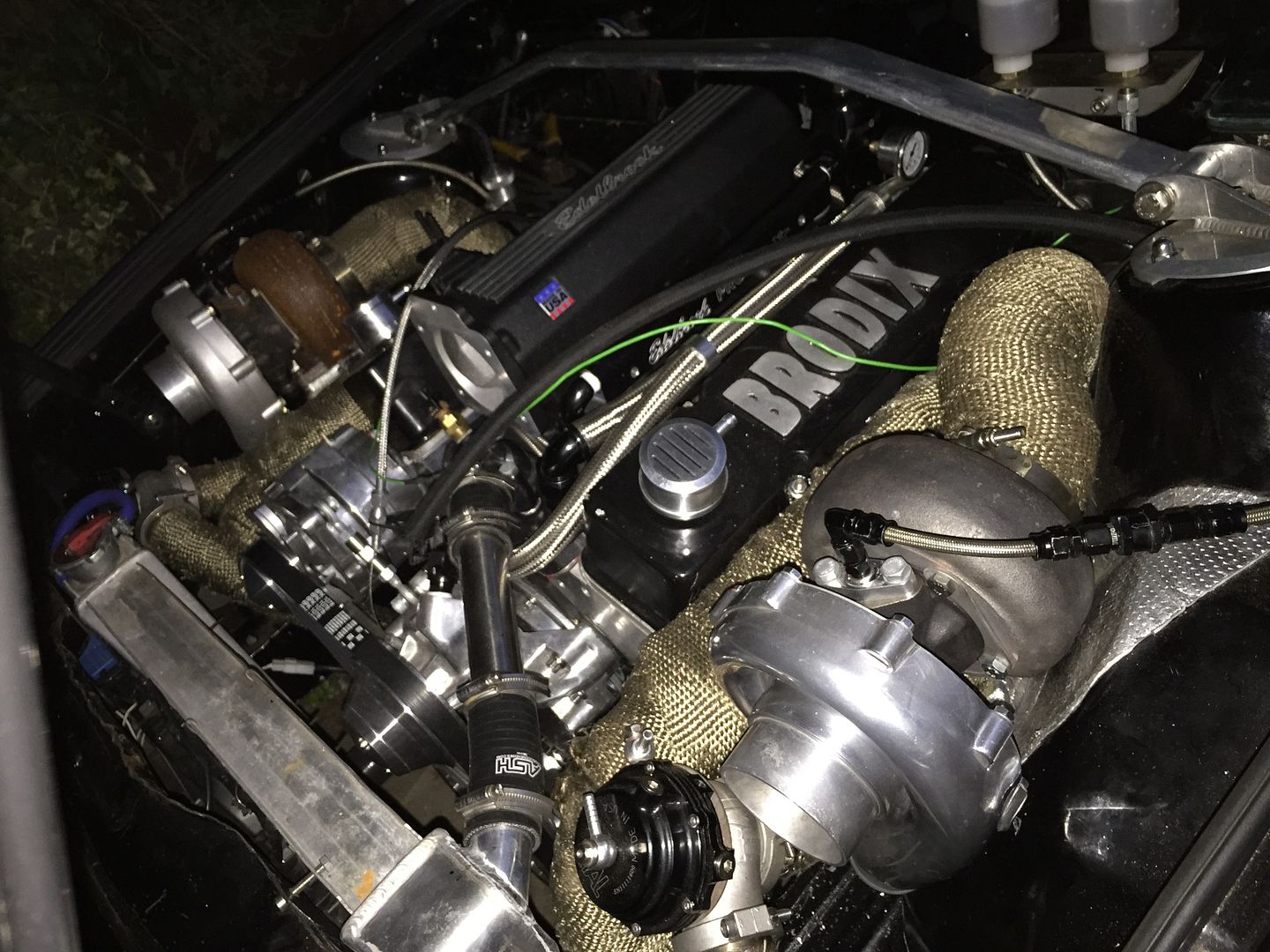

Done abit more today fitted the manifold properly
Fitted the dizzy plug with a new clamp
The dizzy plug still needs to be there as the dizzy also drives the oil pump from the cam
Also finished the heater pipes for the matrix

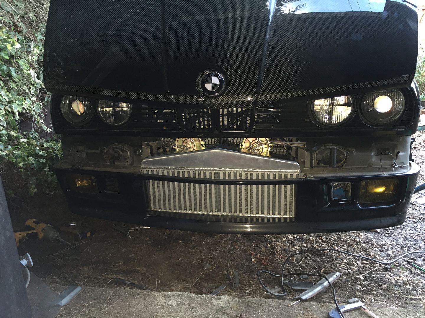

Had a mock up of the intercooler too it just about fits lol
Fuel system and boot install next up :)

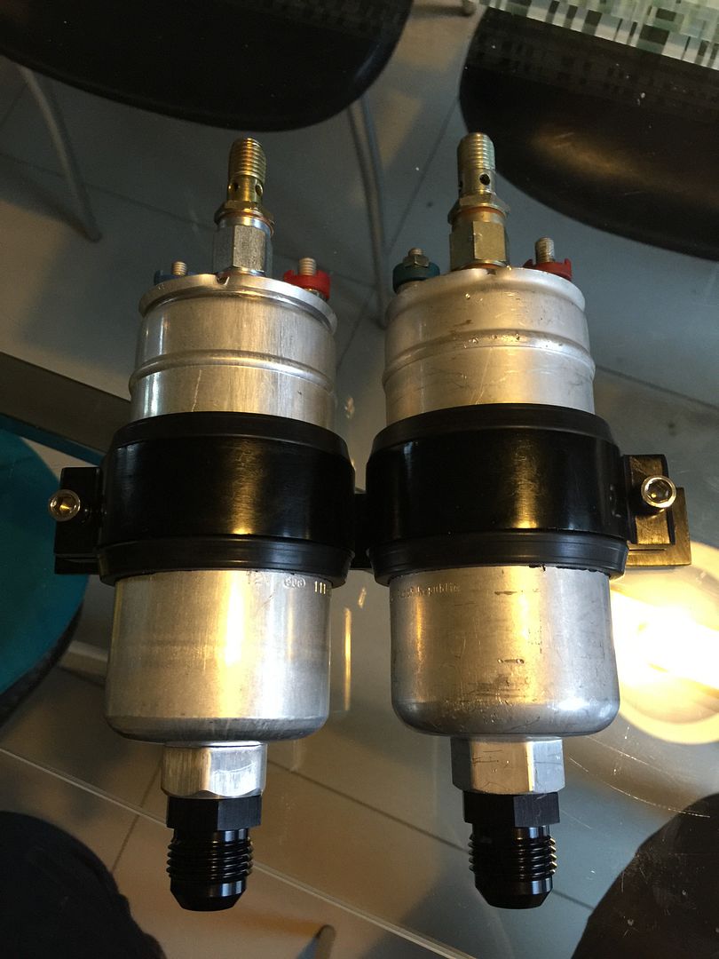

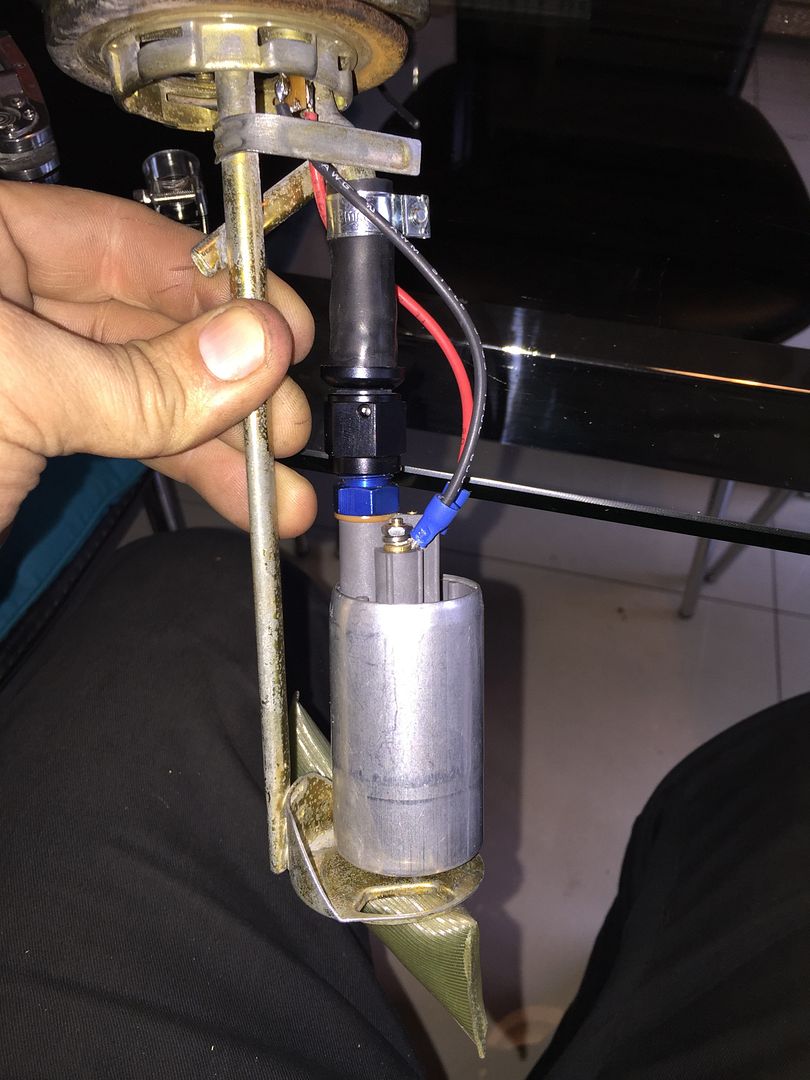

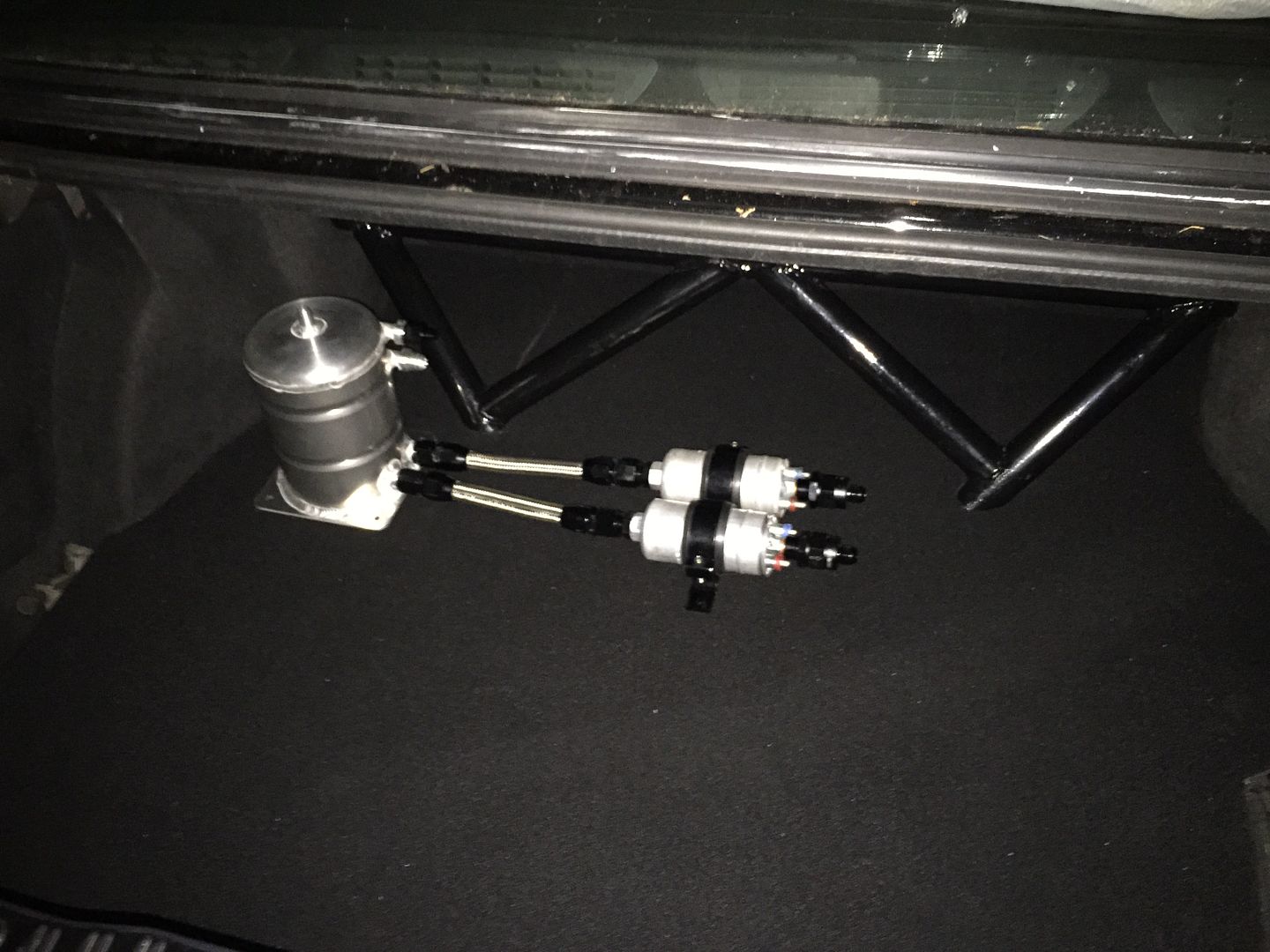

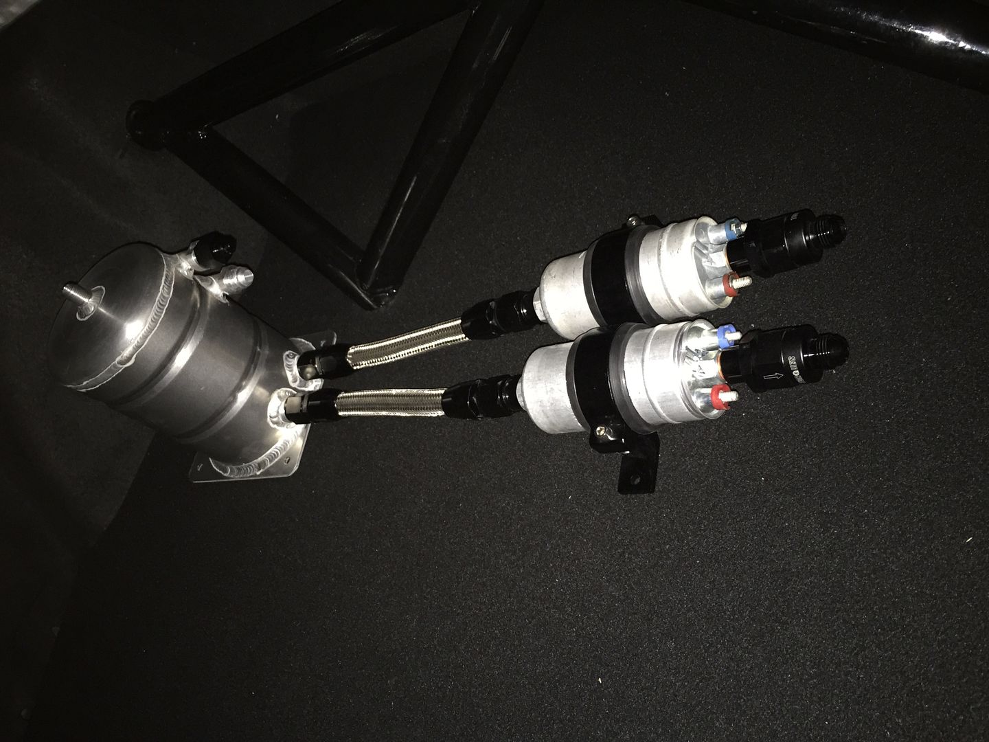

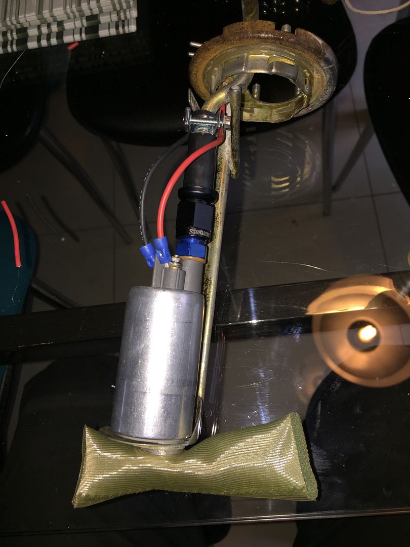

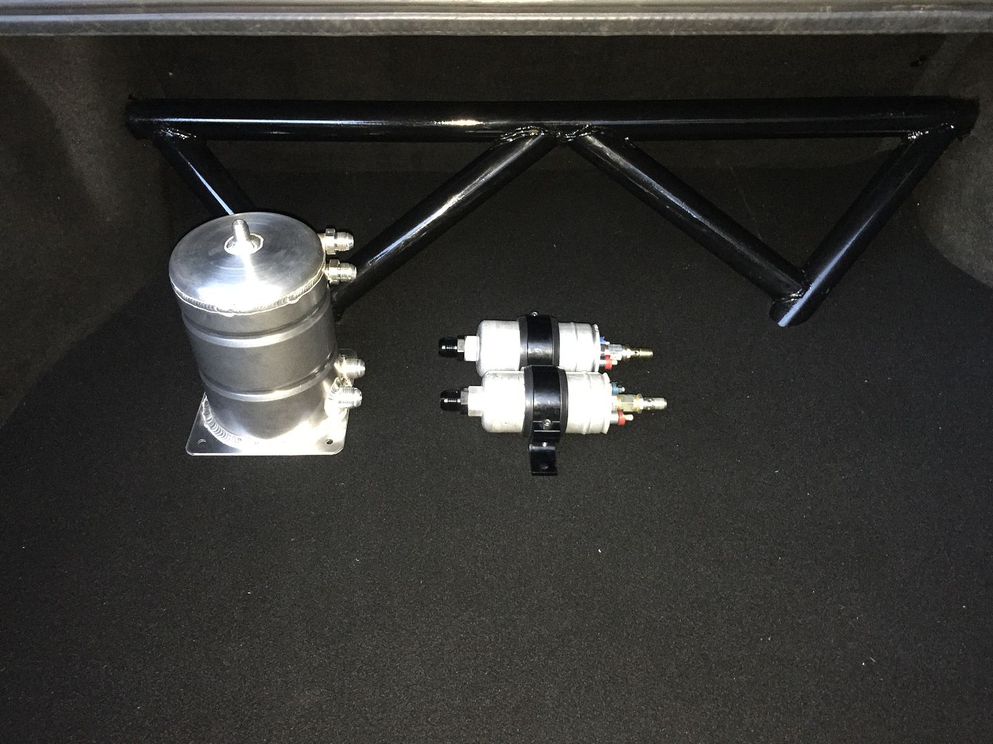

Put the lift pump for the swirl pot together in a standard cradle ( thanks mick for that )

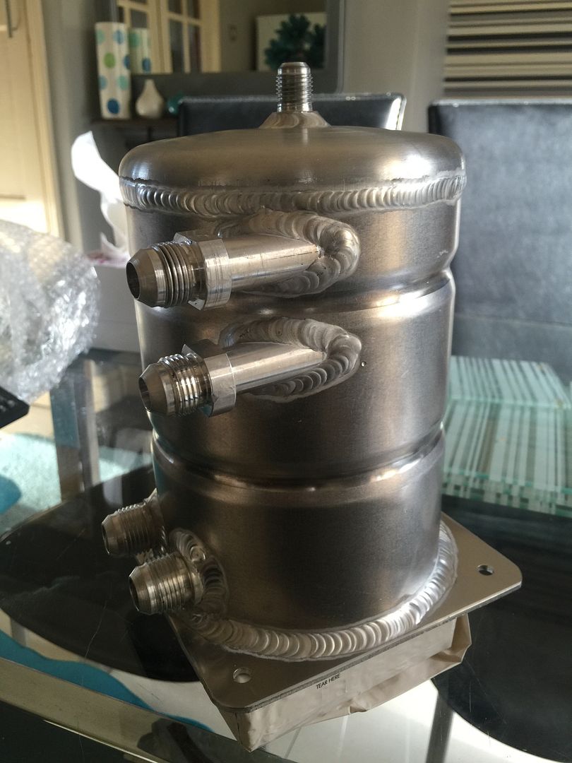

This pump will fill a 2ltr swirl pot in about 40secs , I'm going to be running twin bosch 044 pumps which will empty that swirl pot in 1.6 mins so it's plenty and will never run dry
Just waiting for the swirl pot to turn up now

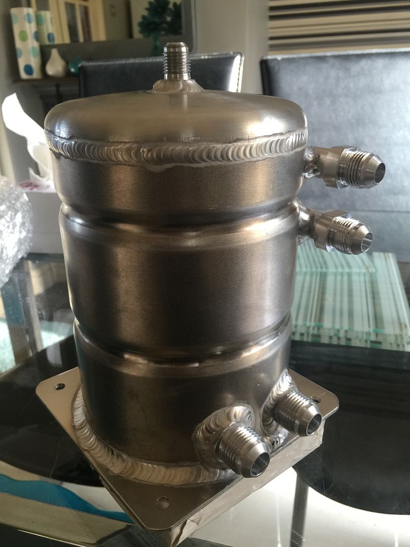

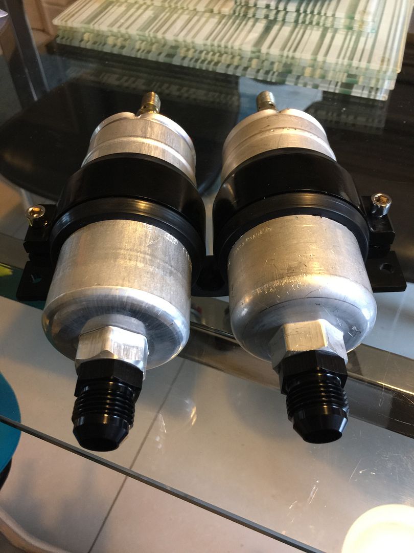

Done abit of everything this week as work wasn't busy swirl pot has turned up and is now plumbed in
Just offering it up in the boot as I have to get filters on the end of these too

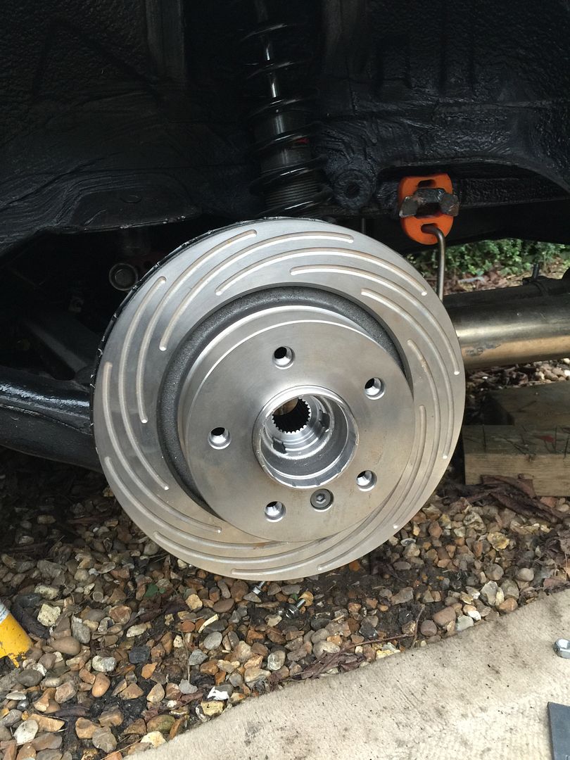

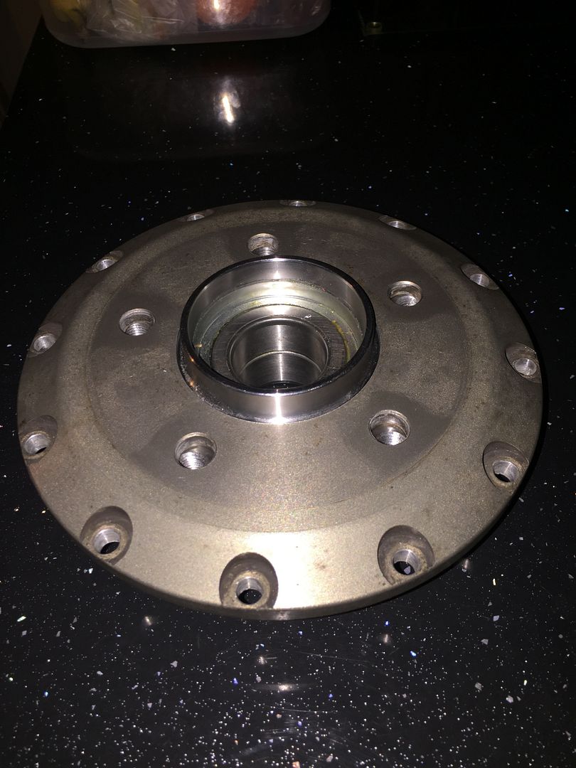

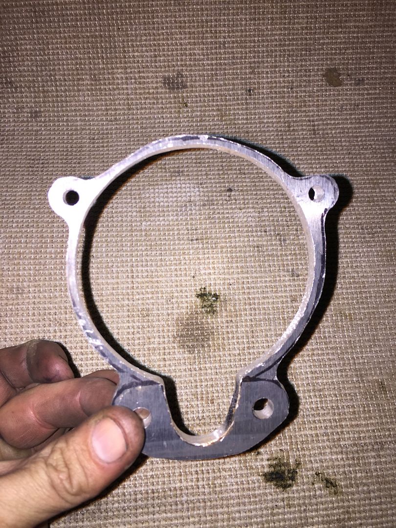

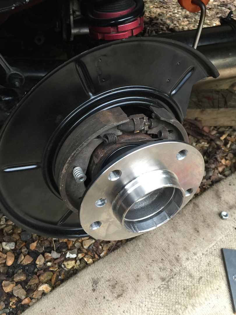

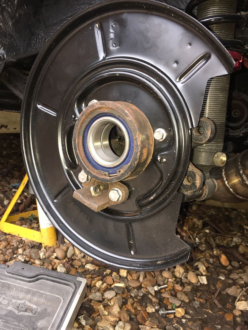

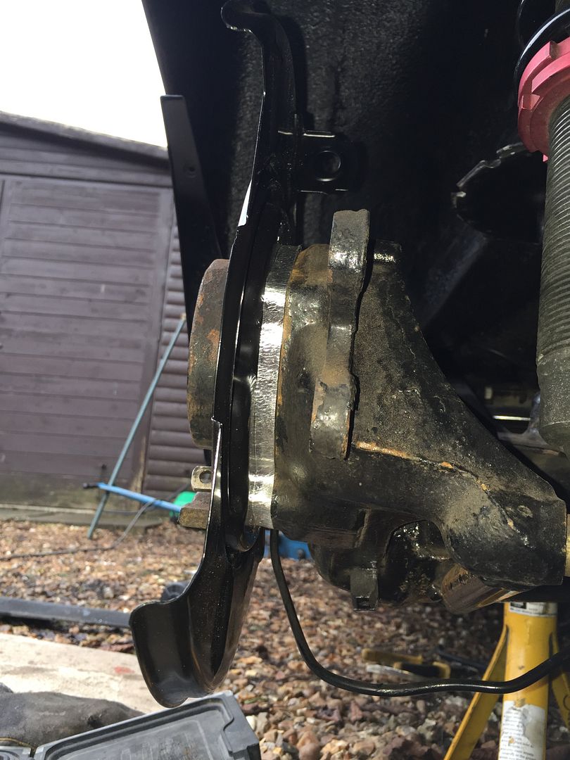

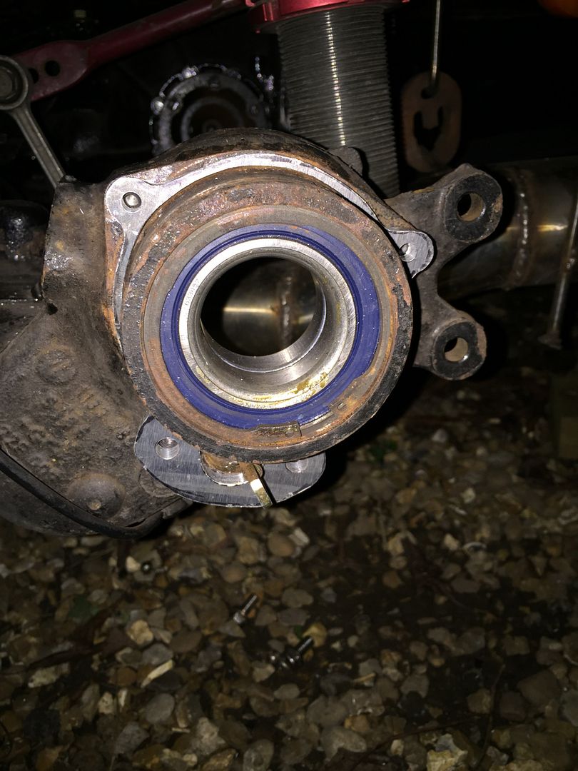

Had to machine my front brake bells out a little to fit over the 5 stud hub but not a problem, plus elongated the bolt holes a little as these bells were 5x114
So now back on to the rears as when I mocked these up before the brake shoes were showing from behind the disc
so I thought of a solution to this by machining the rear of the hub to bring the disc in further , but that was a no no as it would have only left 6 mm of meat to hold the rear together

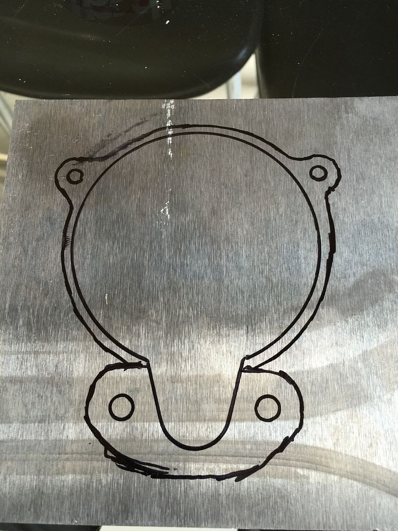

So had another think I needed to bring the shoes and hand brake assembley forward, so why not make a spacer ?
So I did I needed about 8mm so I got some 8mm ali plate and started making some
This was the idea
So started chomping
Which turned out like this
And fitted like this
And with some longer bolts looked like this
So put it all together with the new hub
Hey presto
Just got to do the other side now , make caliper brackets and then on to the fronts

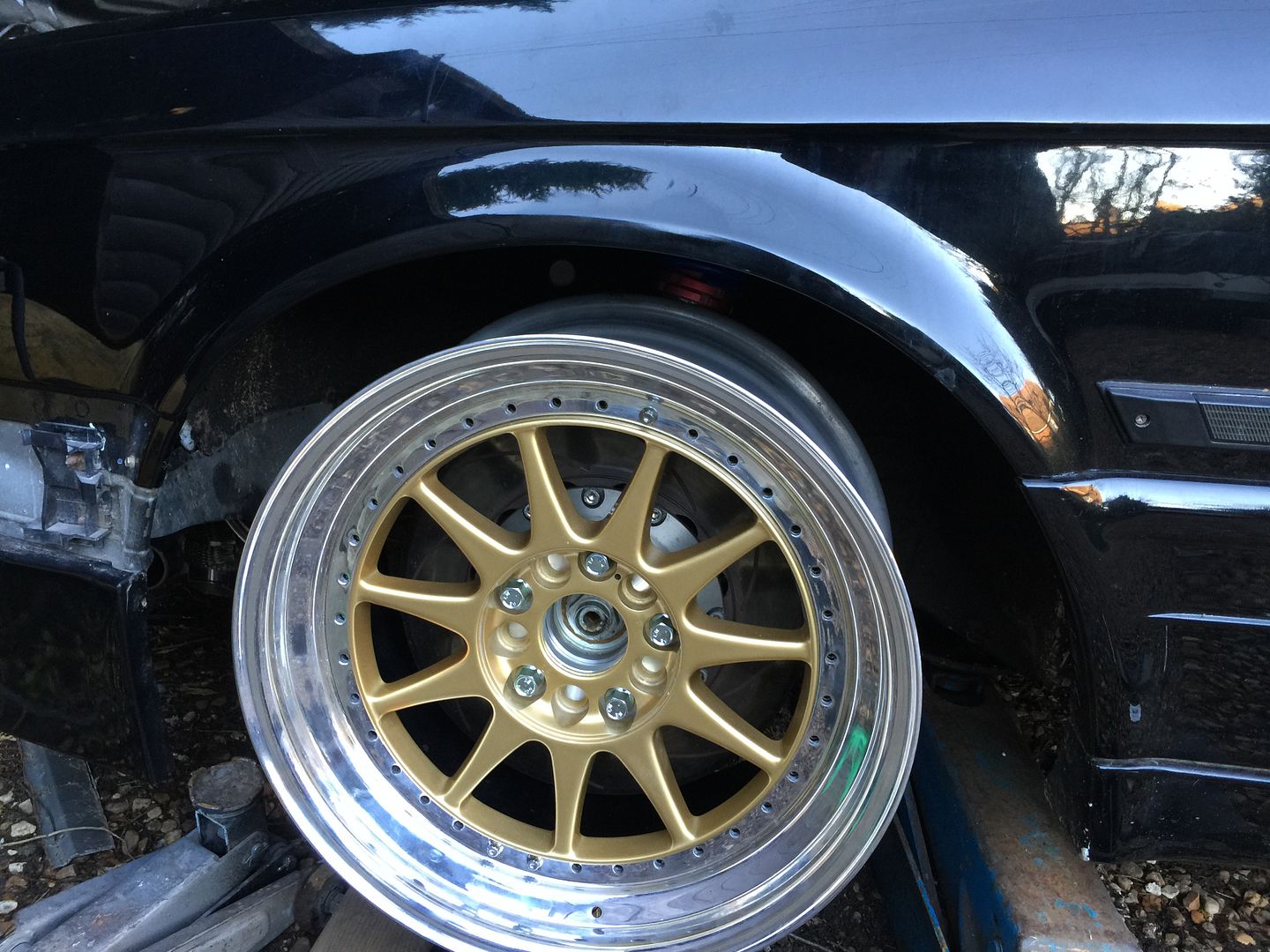

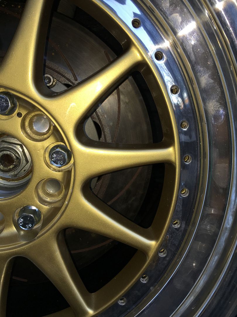

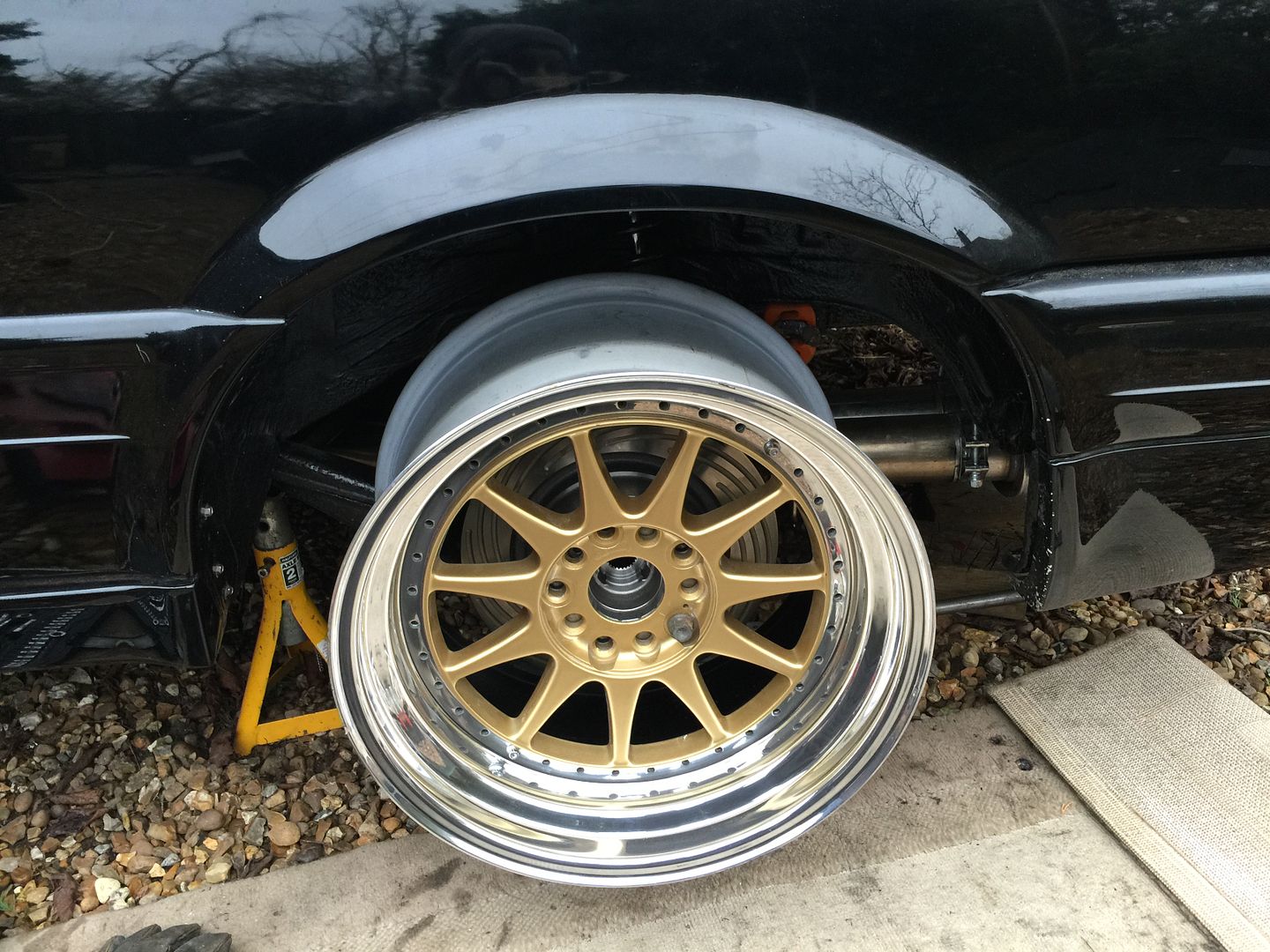

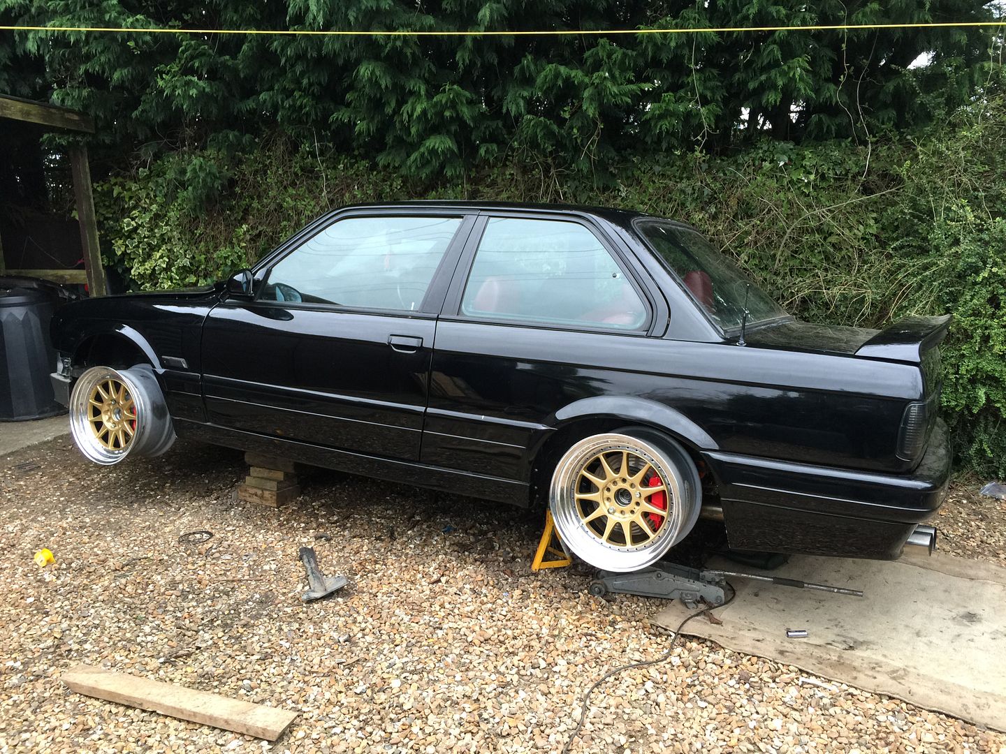

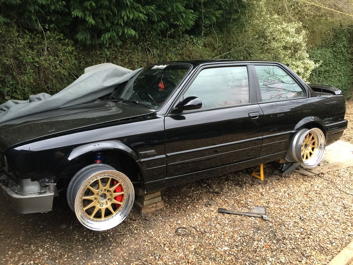

Well got the front wheel roughly where it needs to be, as the wheels were bigger I couldn't lower the car on the coilovers which left a rather hefty gap in the arch, so new springs had to be bought I went for 7" long 600lbs , bearing in mind the engine is roughly 500lbs 8O
So that's 2" shorter than the standard gaz spring so it's gone from this
To this
Pretty much perfect by the time the full weight of the car is on the wheels

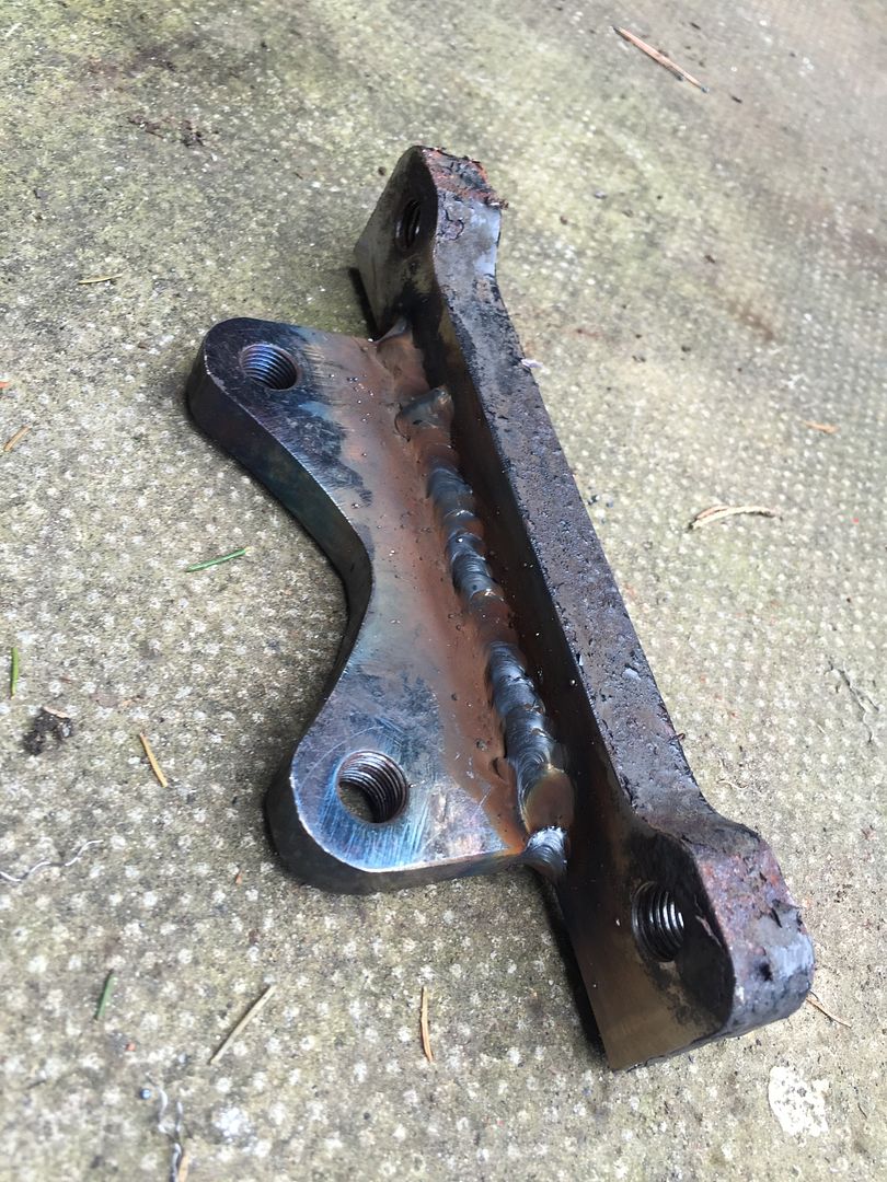

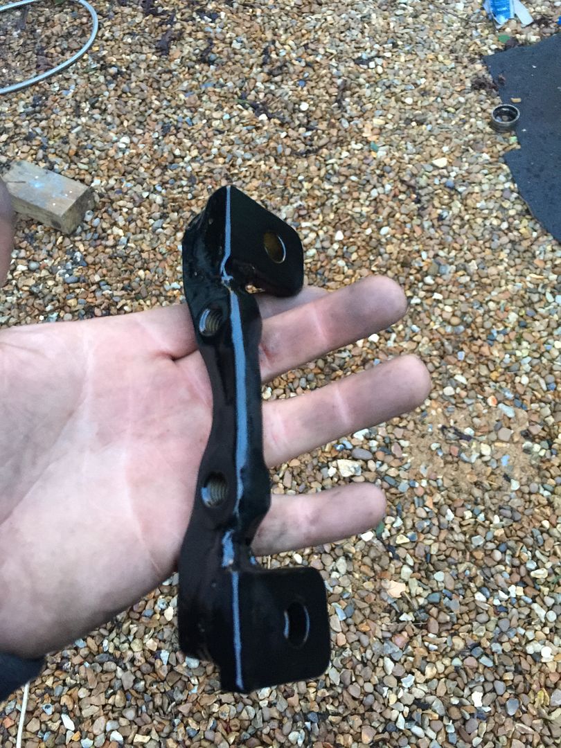

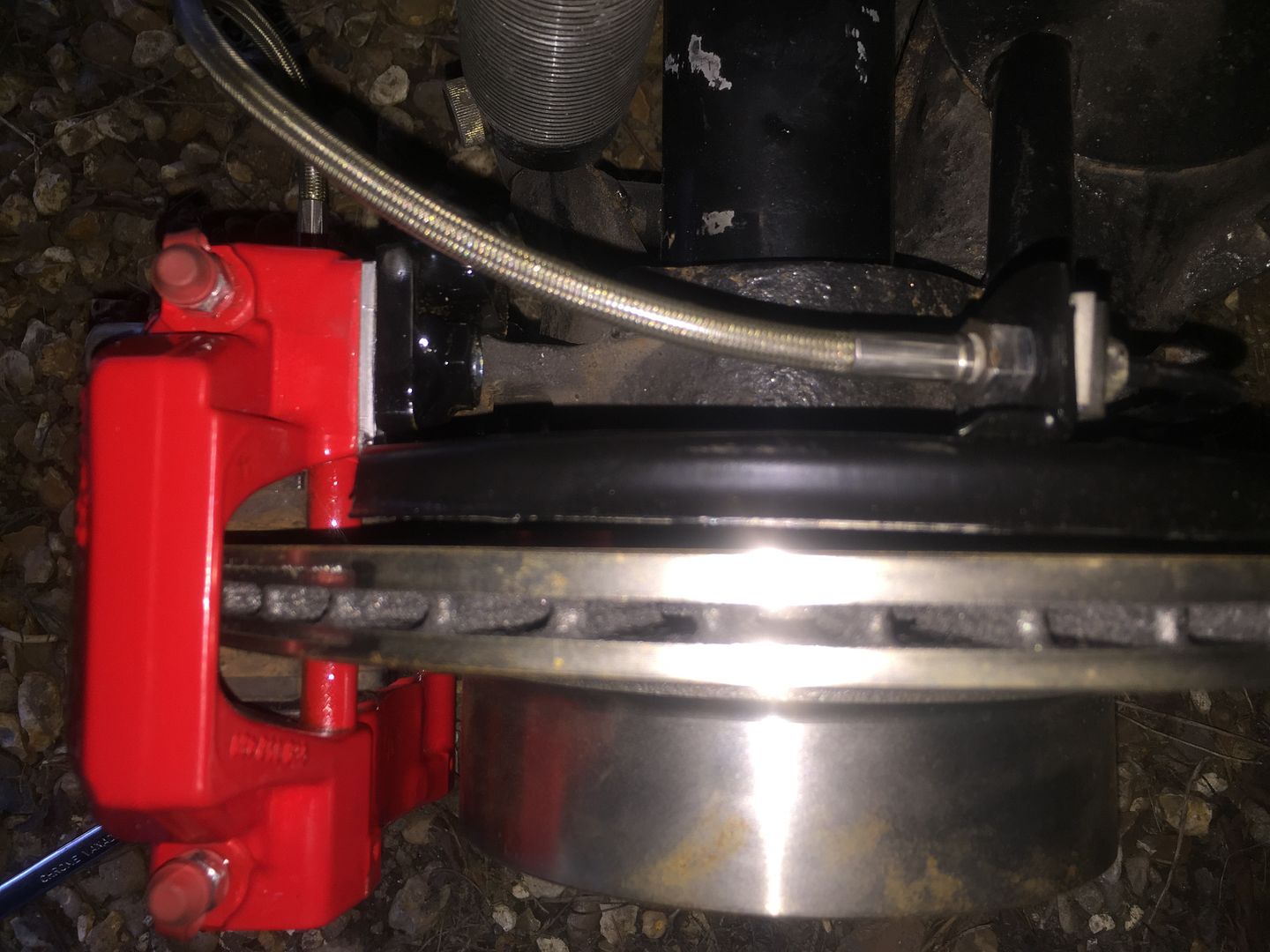

Caliper brackets are finished and calipers are now mounted

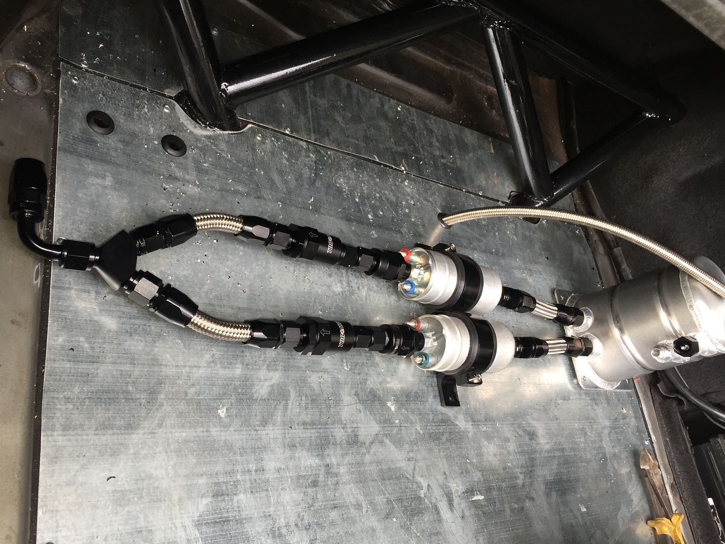

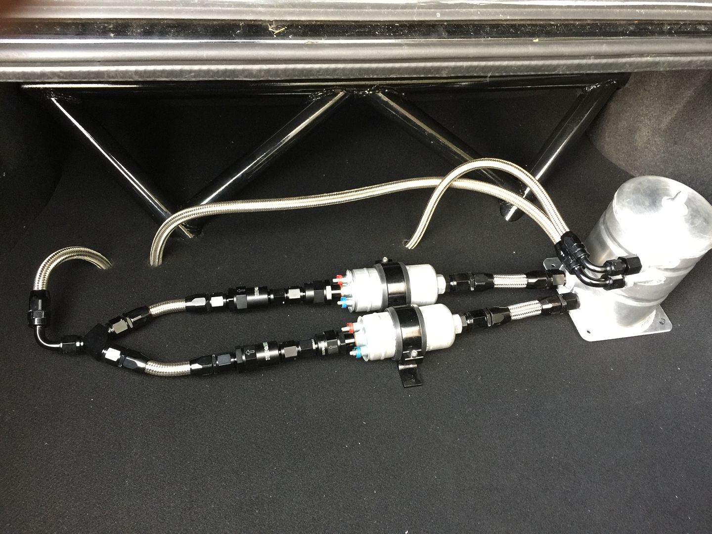

Fuel system in the boot is nearly finished , just need a return line back to the tank and bolt it down to the floor
New fuel lines are in and running from the front to the rear

Mocked up the front calipers this morning but started to rain so had to give in

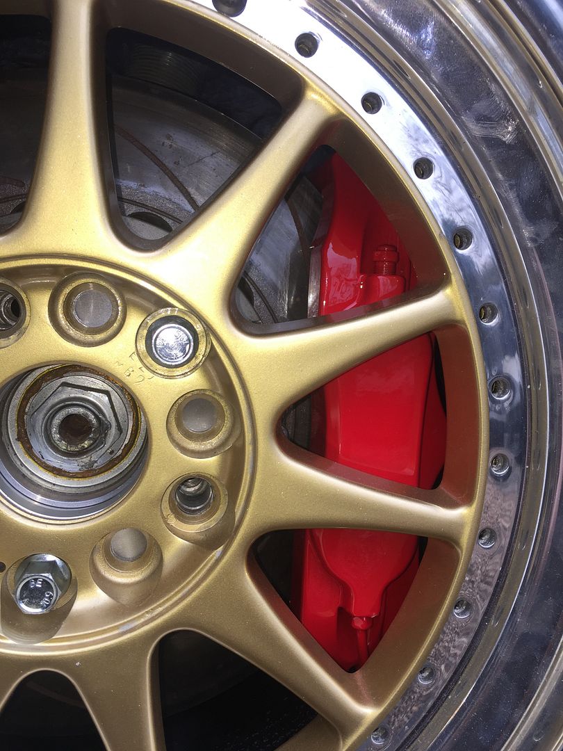

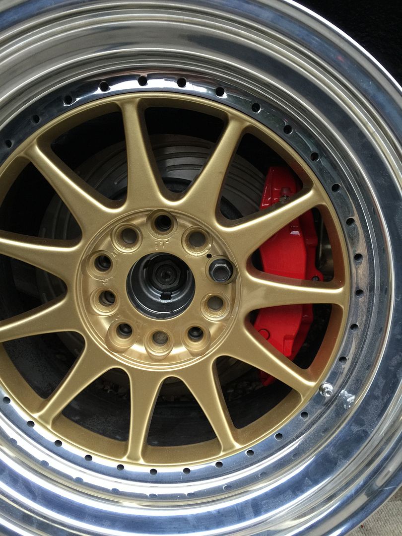

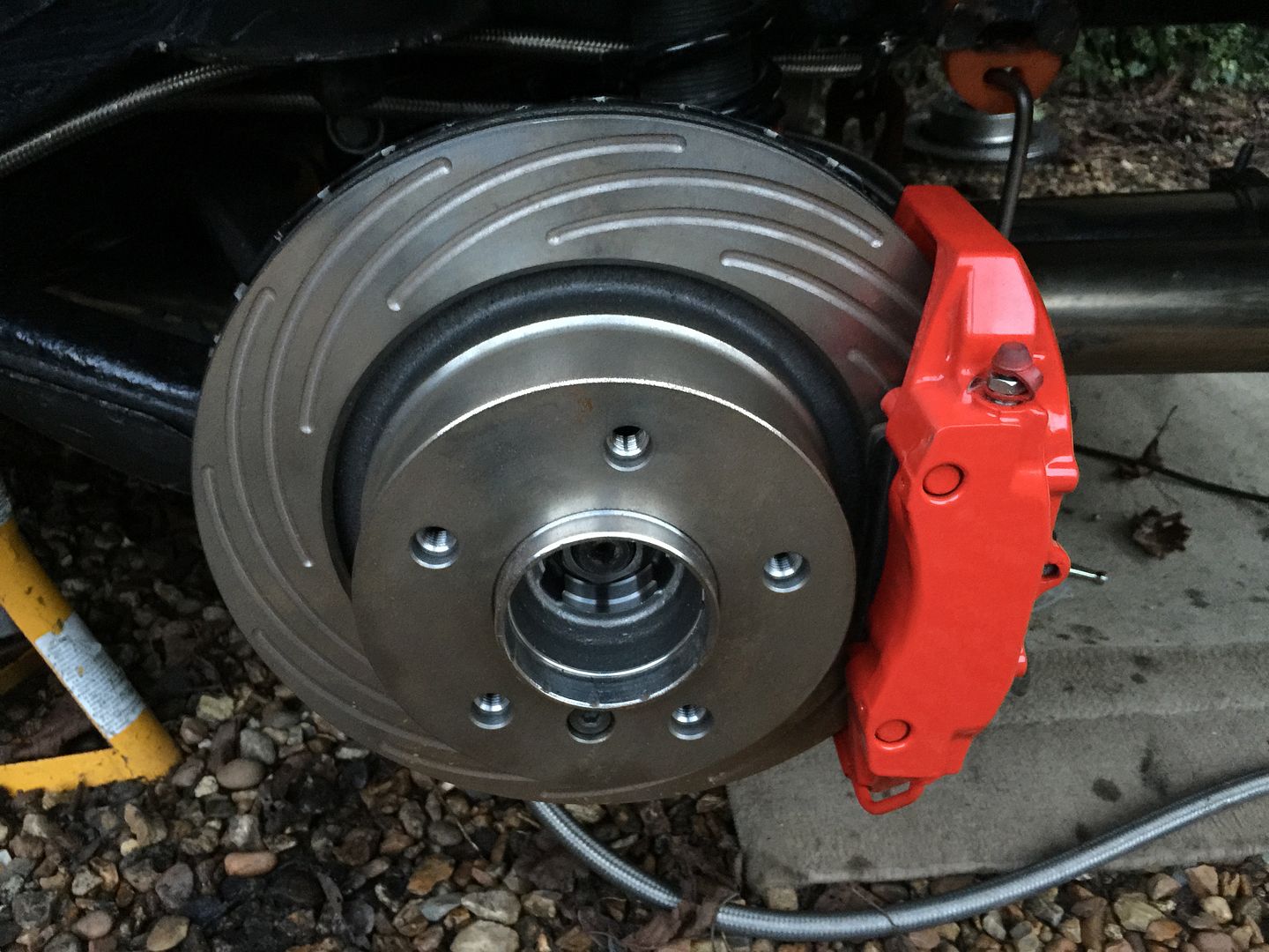

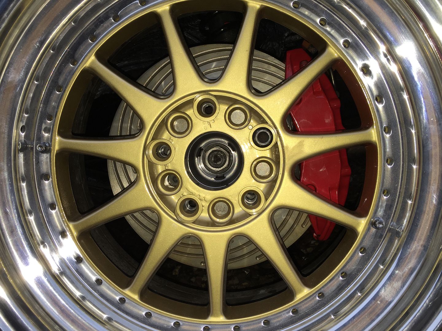

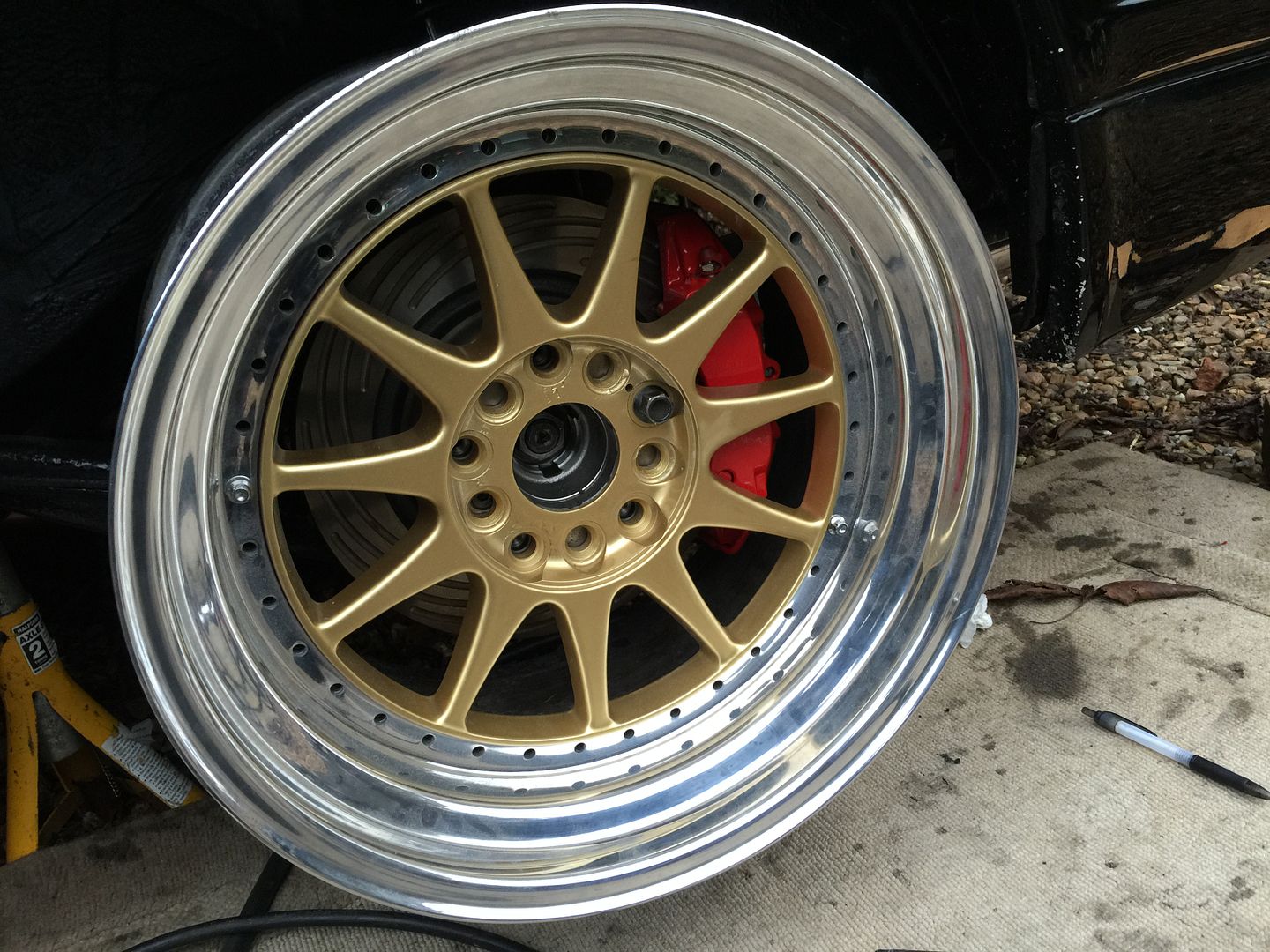

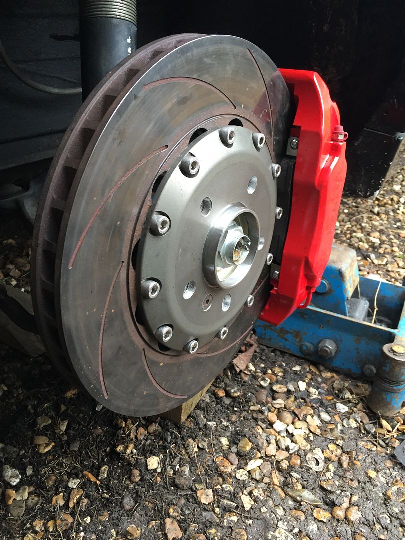

should that disc be on the offside ross ?
ross2009
Posts: 2762
Sun Feb 22, 2015 7:51 pm
glenn wrote:should that disc be on the offside ross ?
no mate as it dosnt matter about the lines in the disc its the vanes inside that are directional

ah yeh, i can see them now, perhaps i should take a better look before posting :o:

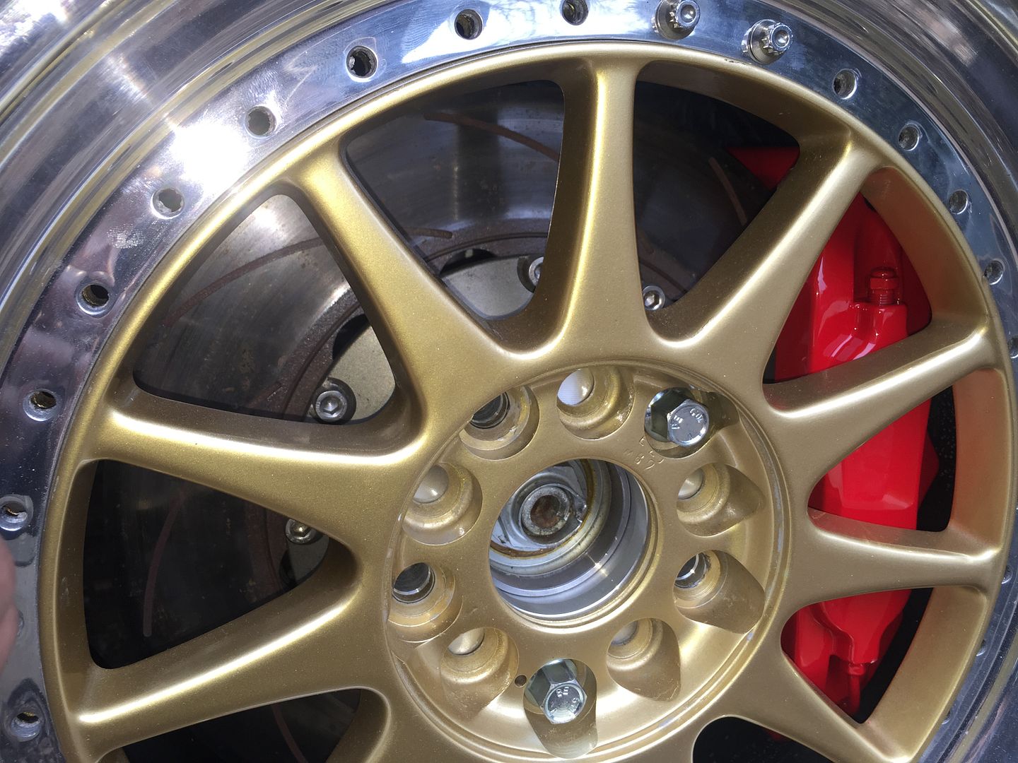

Turbo M20
v8 project 6.0 twin turbo

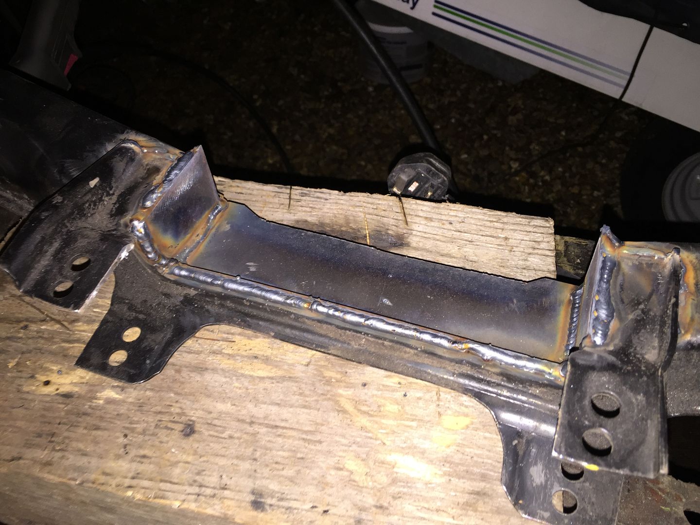

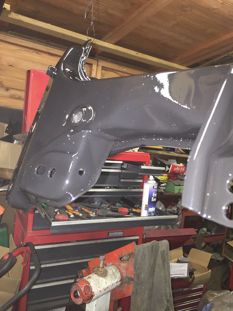

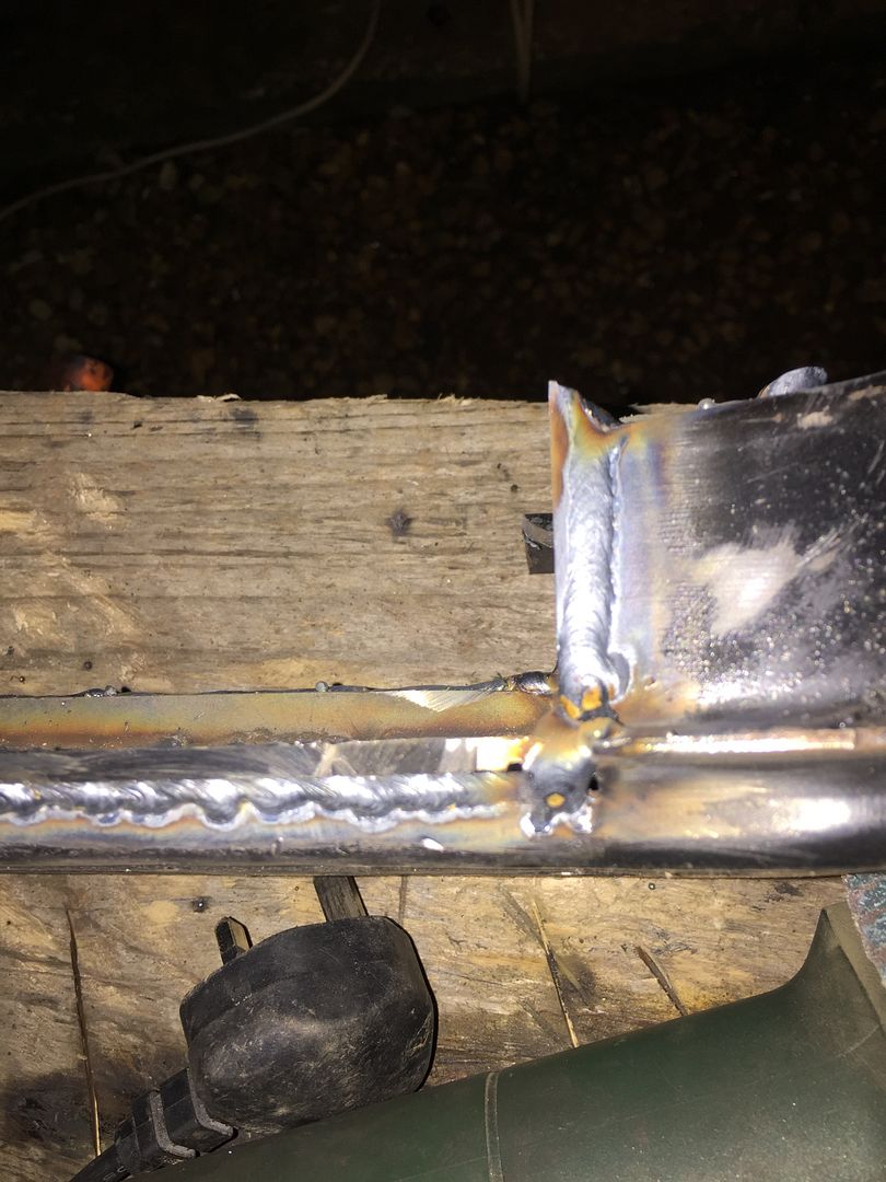

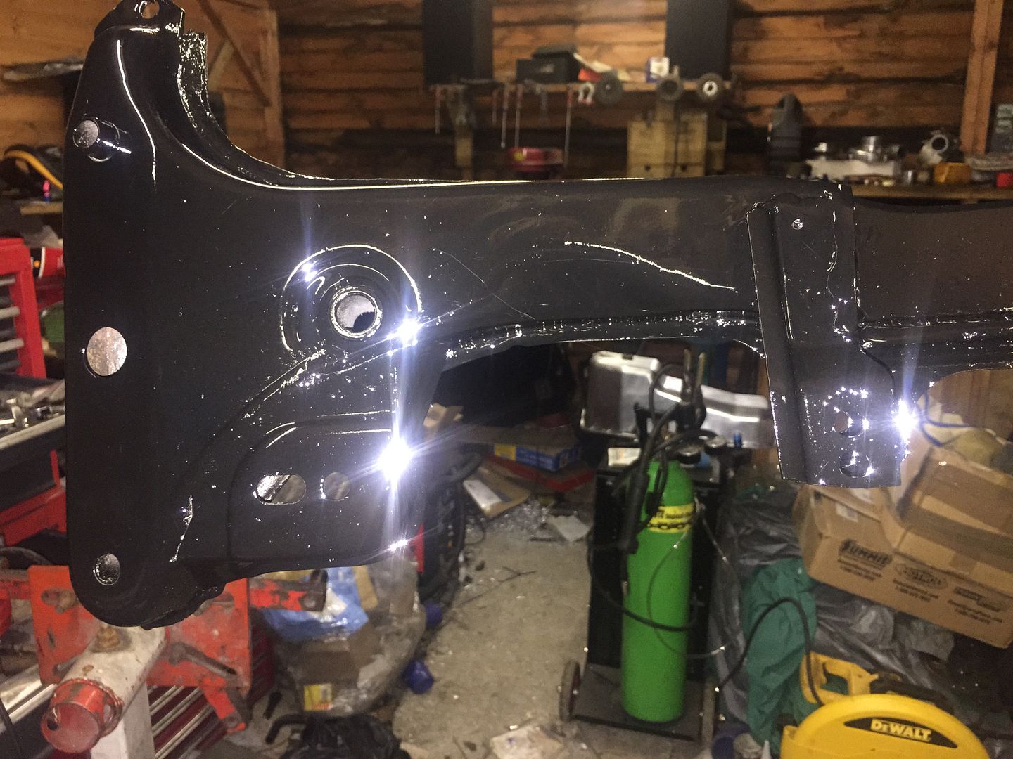

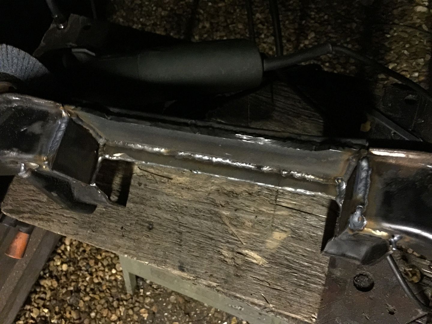

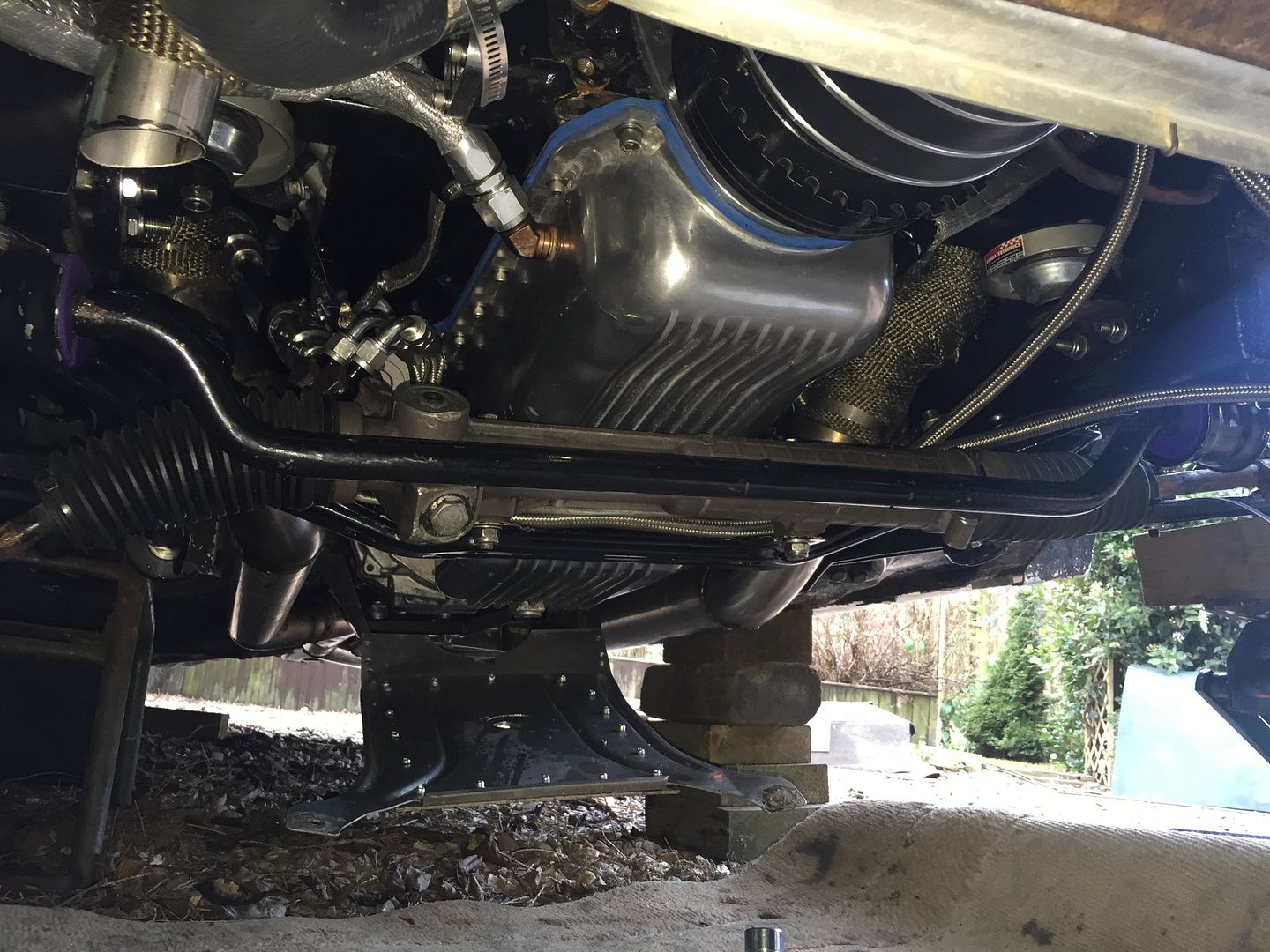

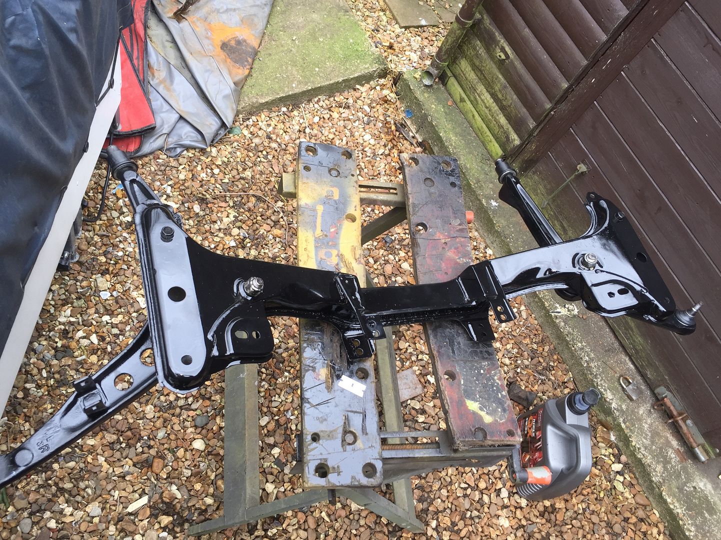

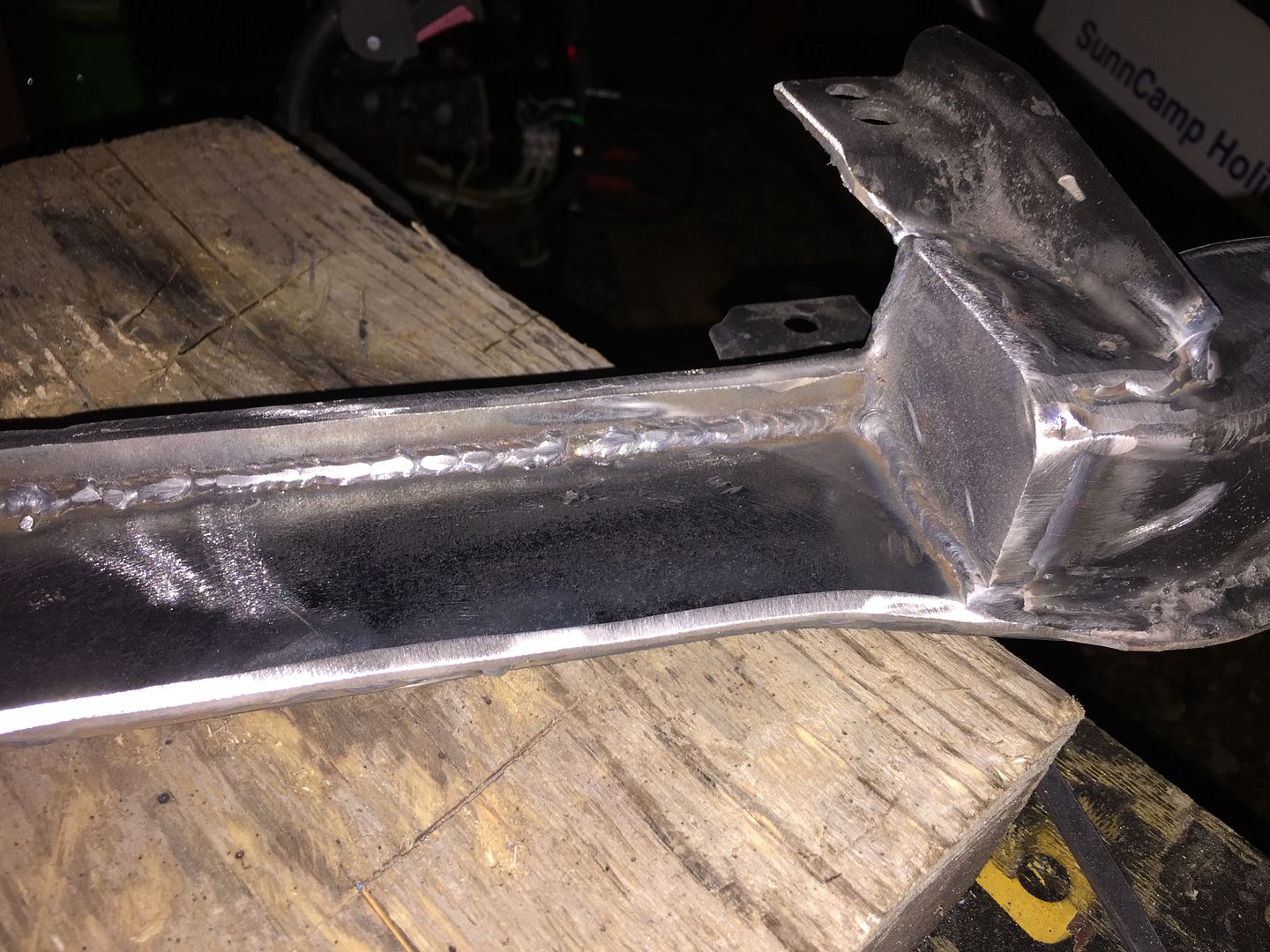

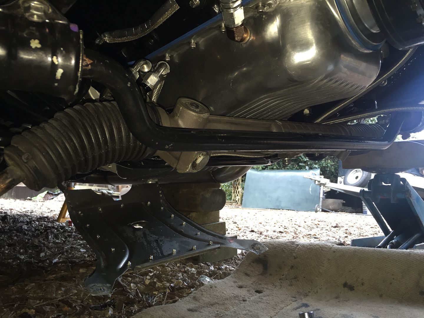

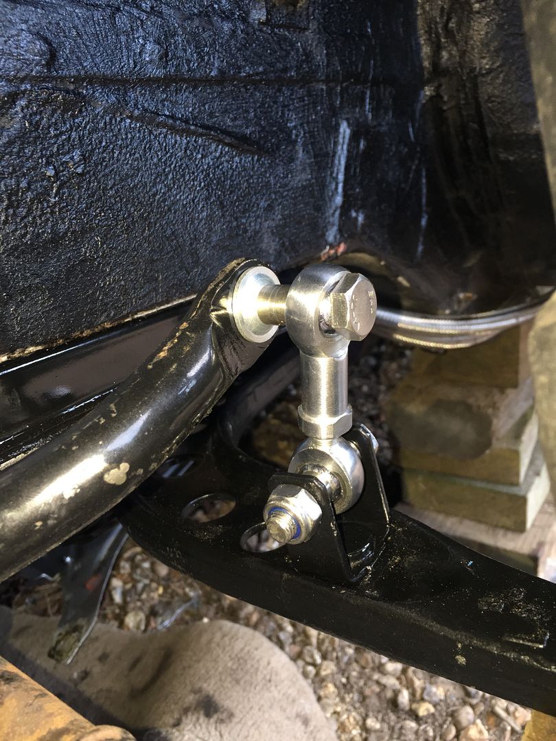

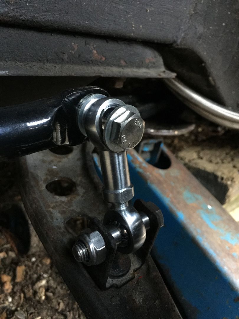

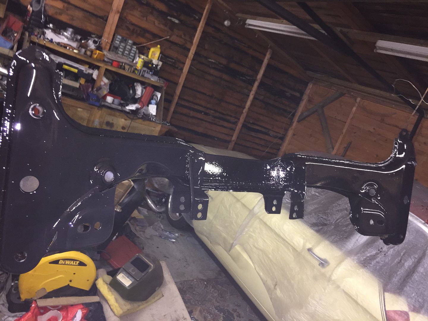

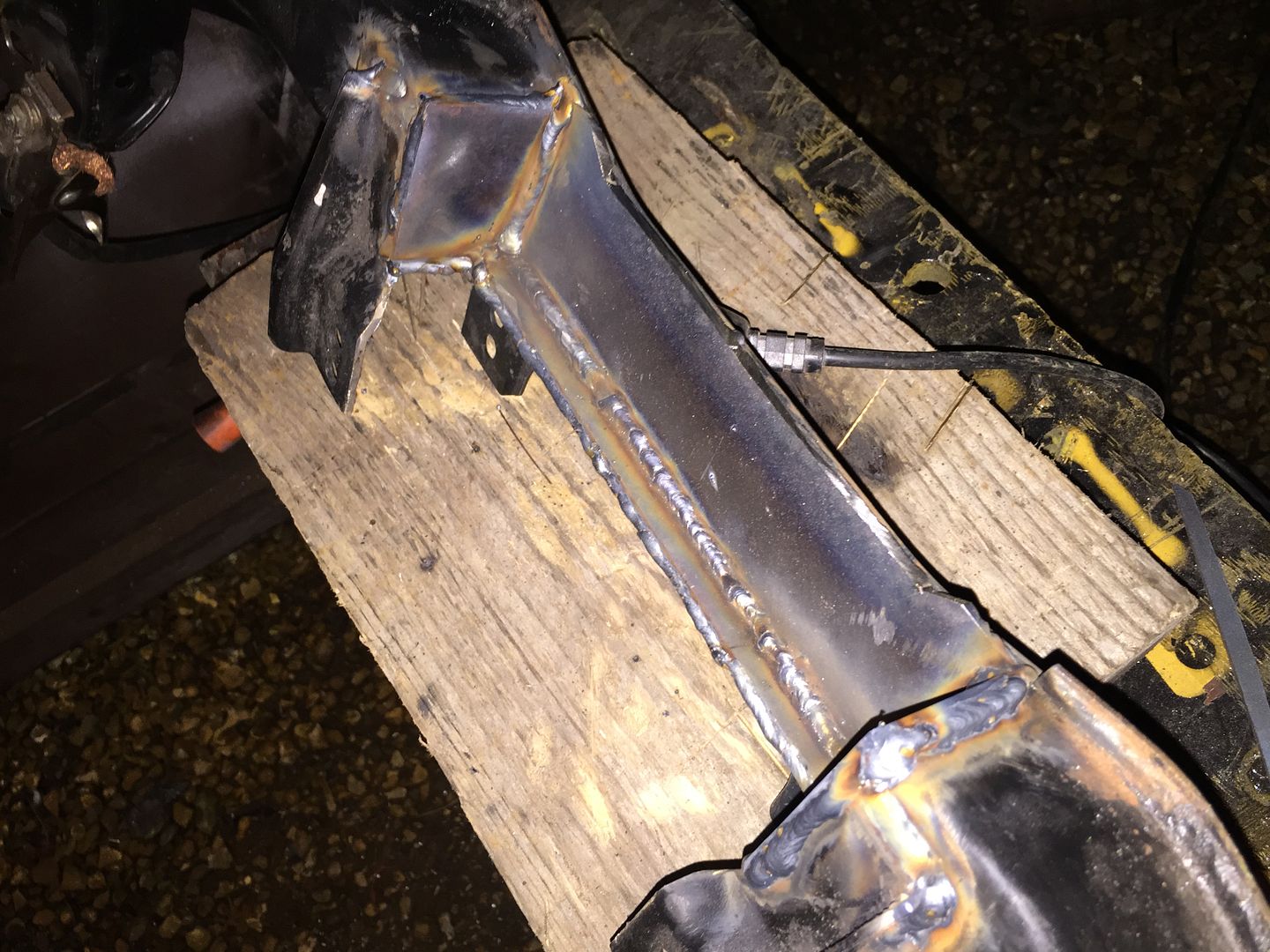

Well I finially got round to fitting the front arb if you can remember I've re mounted it to the front of the subframe and used a e36 m3 arb but as I moved the rack forward on the subframe due to the linkage hitting the starter motor , it now with weight on the front the arb now hits the rack so I've altered another crossmember but now keeping the standard rack mounts, as I now have a even smaller starter motor and more room for the linkage
I've just got to clean the lower arms up now and repaint them and fit new drop links
ross2009
Posts: 2762

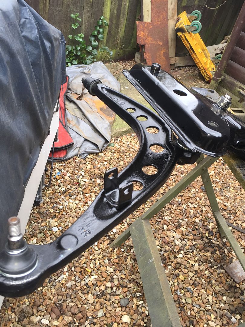

Sun Mar 01, 2015 7:41 pm

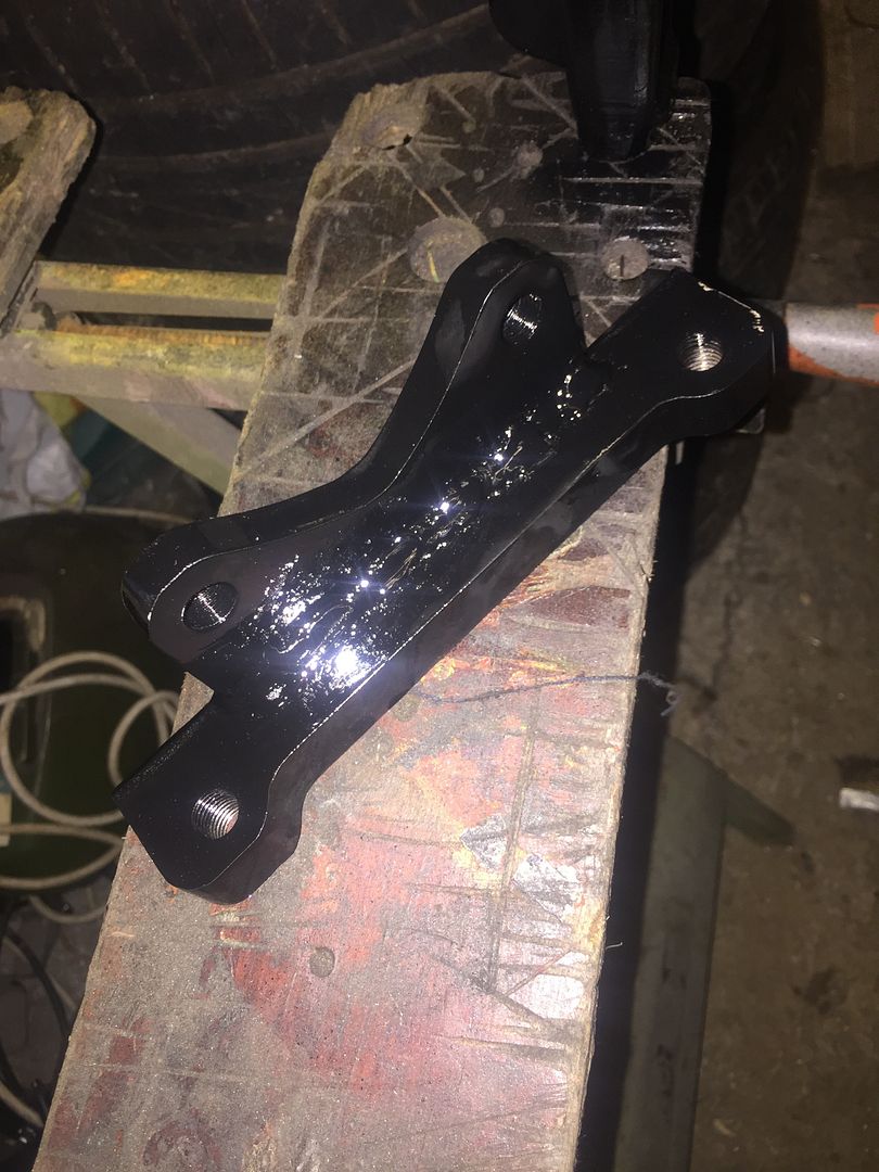

Finished one caliper bracket today and got the lower arms done, can't do the other side yet as I've had to send my other strut back to gaz as its seemed to have lost its oil
Look at the shine on that 8)

Rear brakes are completely finished :)
Turbo M20
ross2009
Posts: 2762
Fri Mar 06, 2015 8:25 pm
Front brake lines are made up and arb is back on and now fits with out hitting anything , we're getting there

ross2009
Posts: 2762
Mon Mar 09, 2015 7:00 pm

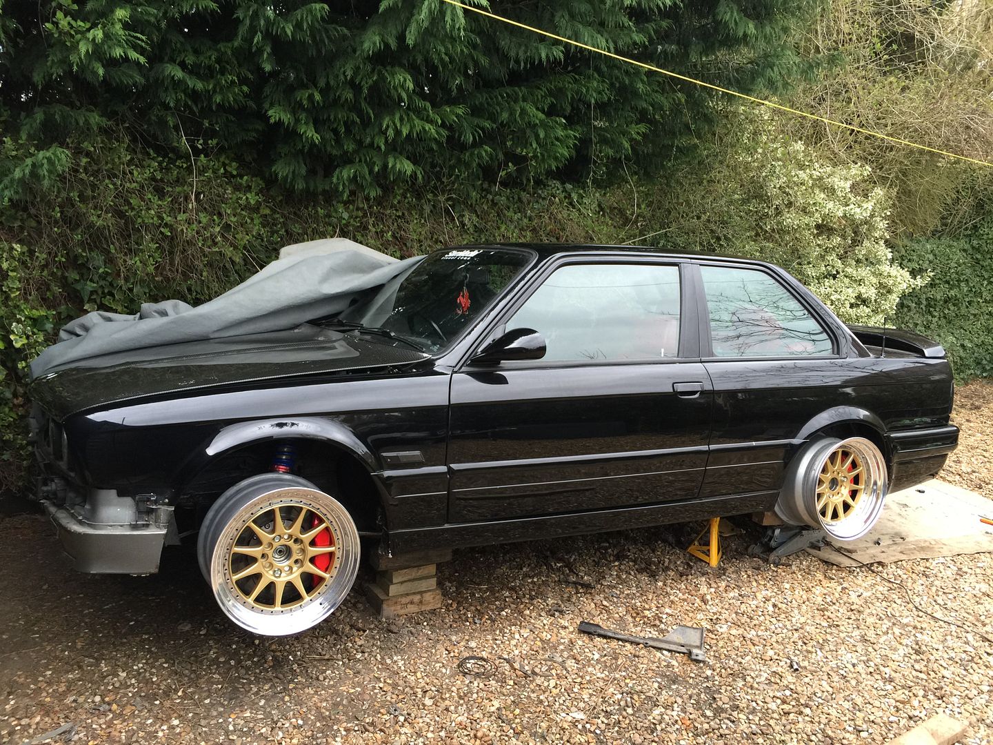

Front brakes are finally finished and on , just got to sort the wheels out now finish the fuel system and get a few more bits for the engine, then we're rocking and rolling

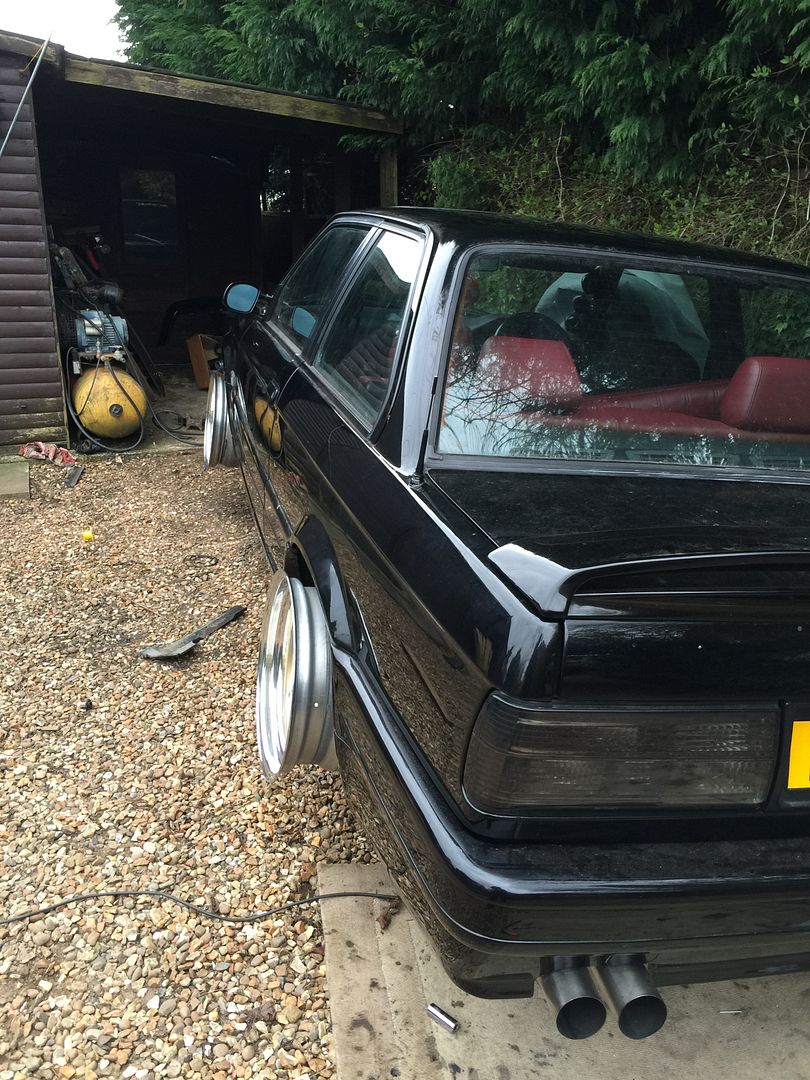

Mon Mar 09, 2015 8:02 pm
Not much room for rubber in there! :eek:
Demlotcrew
Posts: 13329
Location: East Anglia
Mon Mar 09, 2015 8:07 pm
Stanced though :cool:
ross2009
Posts: 2762
Mon Mar 09, 2015 8:10 pm
DanThe wrote:Not much room for rubber in there! :eek:
No dan there isn't im going to have to space the wheel out more to give me more room
I think that's the only way I'm going to get decent rubber on it with out it catching

ross2009
Posts: 2762
Sun Mar 15, 2015 9:34 pm

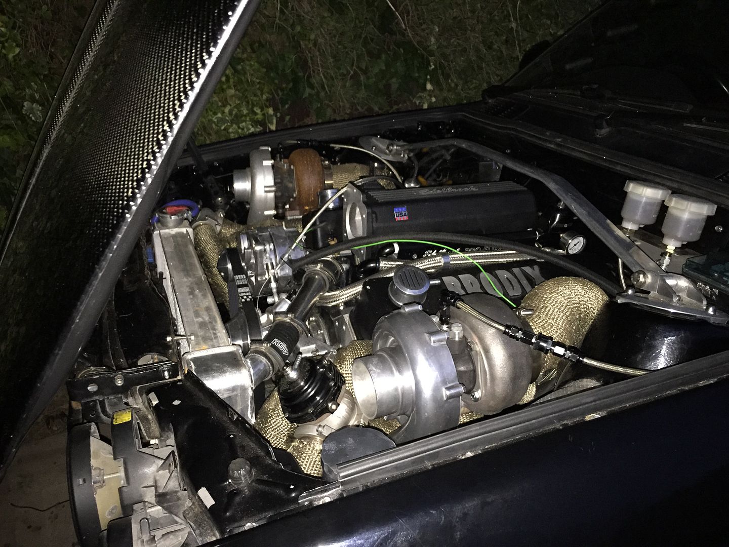

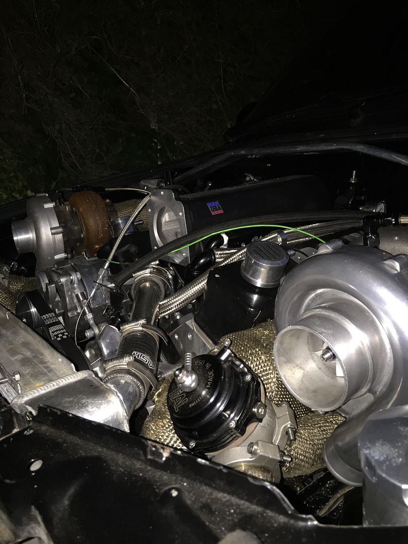

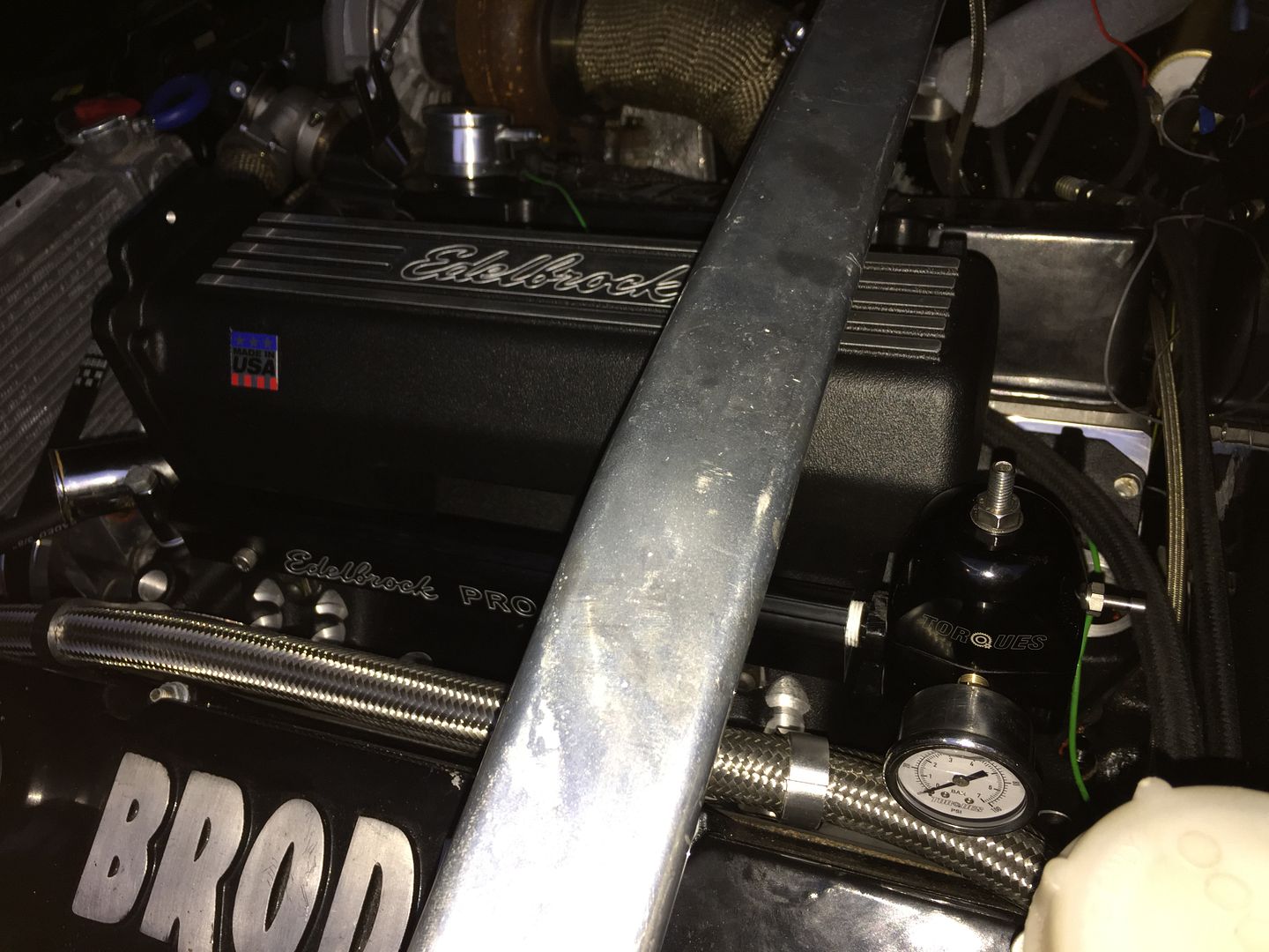

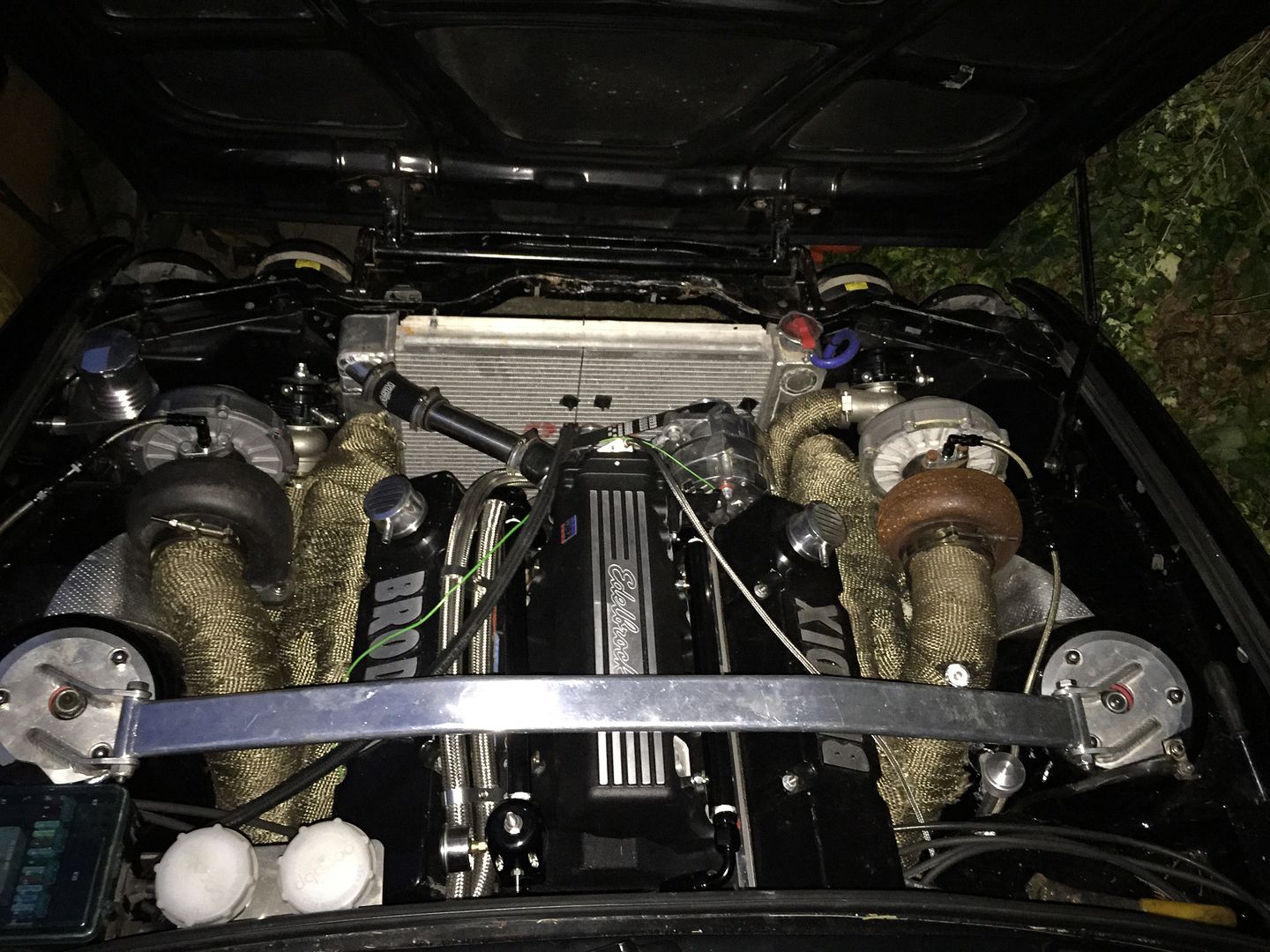

Engine is nearly all back together , and some test fitting of the wheels again , which are going off for polishing tomorrow :)

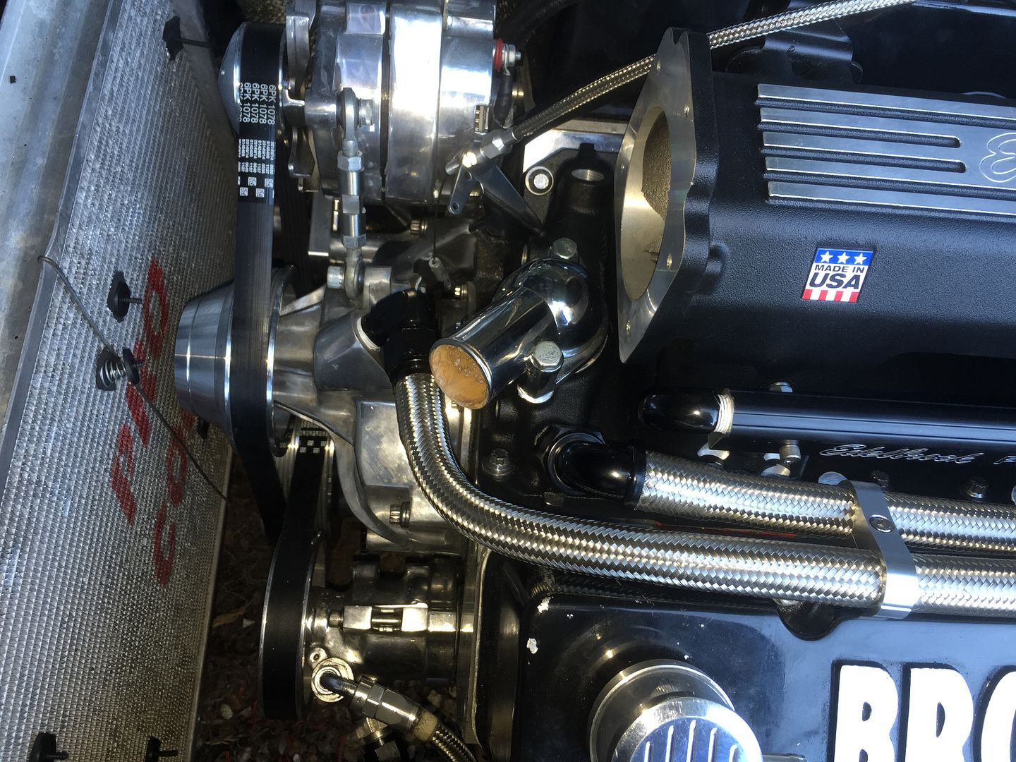

ross2009
Posts: 2762
Sun Mar 15, 2015 9:48 pm
Turbo M20
ross_jsy
Posts: 7307
Location: Jersey, C.I.
Sun Mar 15, 2015 9:49 pm
Looks incredible Ross.
Just a quick one, make sure you get a rubber fitting on that brake line connected to the suspension strut
ross2009
Posts: 2762
Sun Mar 15, 2015 9:57 pm
ross_jsy wrote:Looks incredible Ross.
only temp at the mo mate . dont worry all in hand lol

Looking great, though looks like one of the snails could do with a lick of paint to match t'other one... :wink:

Speedtouch wrote:Looking great, though looks like one of the snails could do with a lick of paint to match t'other one... :wink:
It's just were one has been blasted after a rebuild, and the other has been out side in the elements lol
They will both have blankets on that when I get round to it :)
