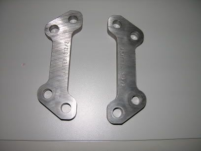

ok, then what size they are? they are 4 stud? 4x100? may bay ANT can do them(machined)

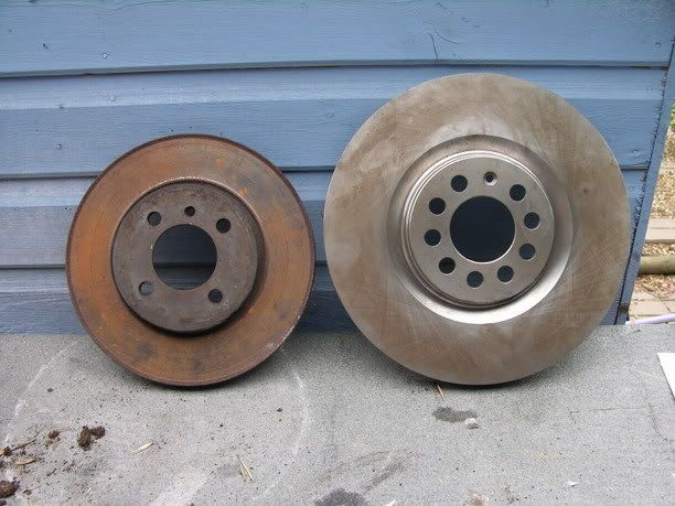

The TT dics are 312mm.
need to be drilled to 4 stud.
1mm taken out the centre bore.
325 disc next to TT one.

that's massive 8O i suggest only 17" wheels goes on

You can get 16" on.

but in the first pic two holes looks very tight, looks a bit dangerous :roll:

jeremy wrote:but in the first pic two holes looks very tight, looks a bit dangerous :roll:
Its not dangerous, The disc is not going to turn or fall off as it will have the wheel bolted to it.
I have seen one that has just had 1 hole drilled as there are 3 holes that will line up but if you drill it so its the same in the pic the holes are spaced apart better.

yes and you have to make sure the correct steel/metal is used, cant go using any old bit.

Hi all, have sent a message to tino at 300mm.de for 15 sets here is the reply.
Hello Dave,
i have calculate. here my offer with the best prices:
15 x set of discs 312x25
15 x set of adapters 312/2
normal price for discs: 15*298 = 4.470 EUR, your price: 3400,00 EUR
normal price for adaptes: 15* 198 = 2.970 EUR, your price: 2400,00 EUR
So you pay in sum 5800 EUR and not 7.440,00 EUR
additional comes the shipping. i have no idea, how much cost shipping 150kg to UK
bye tino
this equates to
£2289 /15 = £152 for the disks
£1616 /15 = £107 for adaptors
+ postage ?

Correct, but even more importantly is to make sure they are manufactured correctly.
The obvious choice is laser cutting for the initial profiling, but the massive heat build up in the steel caused by this process is far from ideal when considering the application.
I would be willing to take on the manufacture of these items if the interest is still there, but can assure you zero heat stress in the metal because I would get them waterjet cut (more expensive, but if it is the preferred choice of profiling for the aviation industry, then it should be good enough for our E30's....)
Let me know if you want me to chase this up?
Ant - do you mind me looking into this??
Anyone with a template or spare bracket they are not using??

in the correct materials to get tese watercut and machined locally is runing at just under £117 a set inc Vat, we are short on numbers to go much further.
@ the price TINO has posted, I's suggest that is a way forwards..
:thumb:
Happy for anyone willing to take this on.
