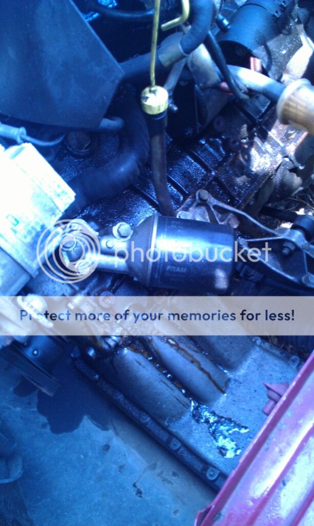

That could well be a leak - check the gaskets around the oil filter and sump.
Also check all the crankcase breather hoses are clear; if they are blocked, back-pressure may be forcing the oil out somewhere.

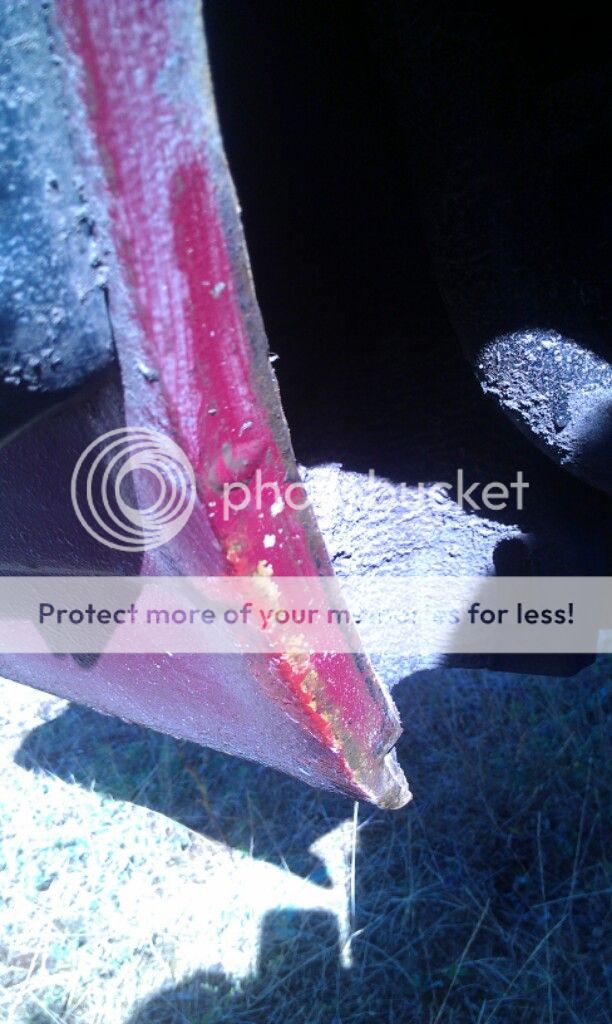

You are such a tease ! Where are the rust pics ?

Car isn't being driven at the moment so haven't had the time to have a good look, i did notice that there is a lot of mud in the arches so ill have to clean that away to have a good look

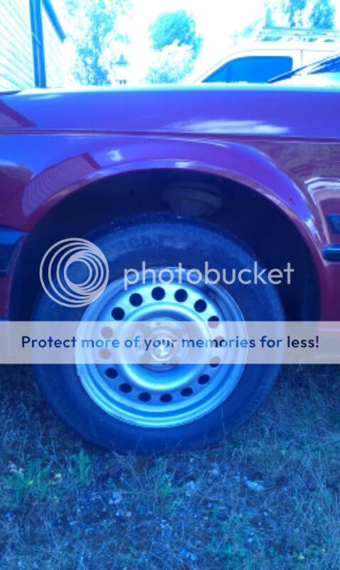

Noticed how big the arch gap is on these earlier! Talking to someone about lowering springs so hopefully he sells them. I Will be taking care of it to be honest, im more than happy to go 1mph over speedbumps!
Also, the front drivers arch has a parking dent in it, would it be worth getting this fixed and repainted or buying a whole new panel? Now sure how common the wine read is.. The panel has a few chips anyway so would need a respray.

Come on your not trying hard enough looking for the rust!

There must be a big surprise underneath for me, still need to get under and have a look!
