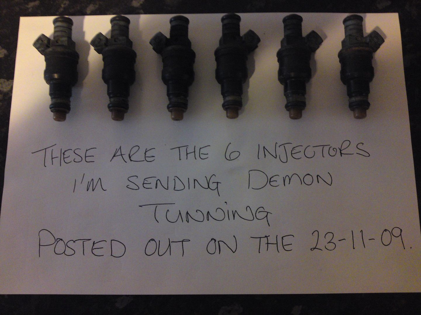

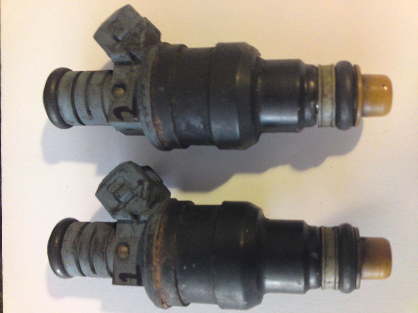

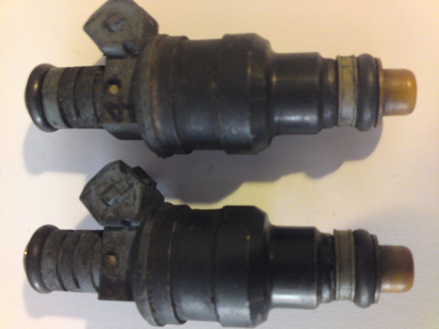

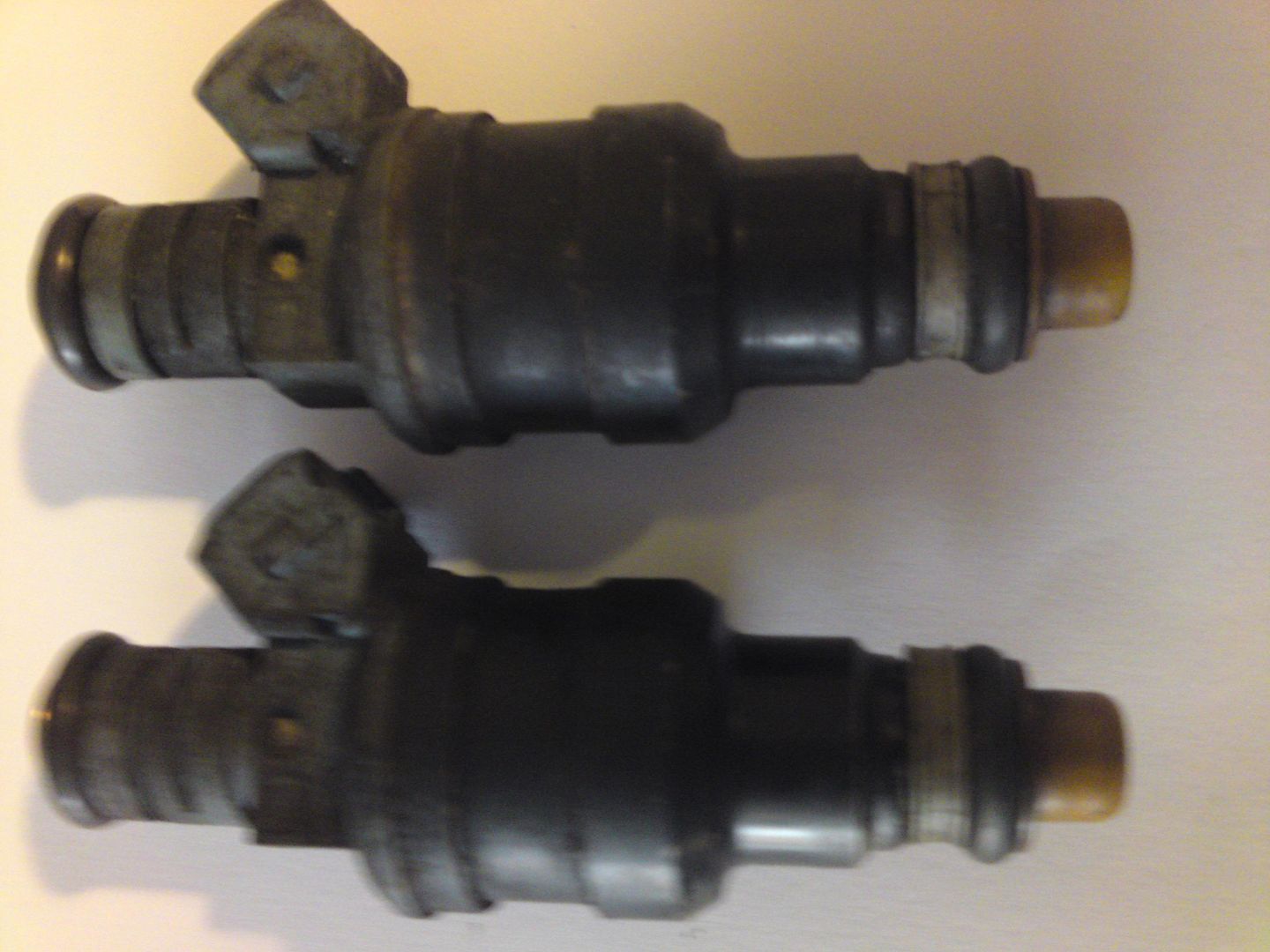

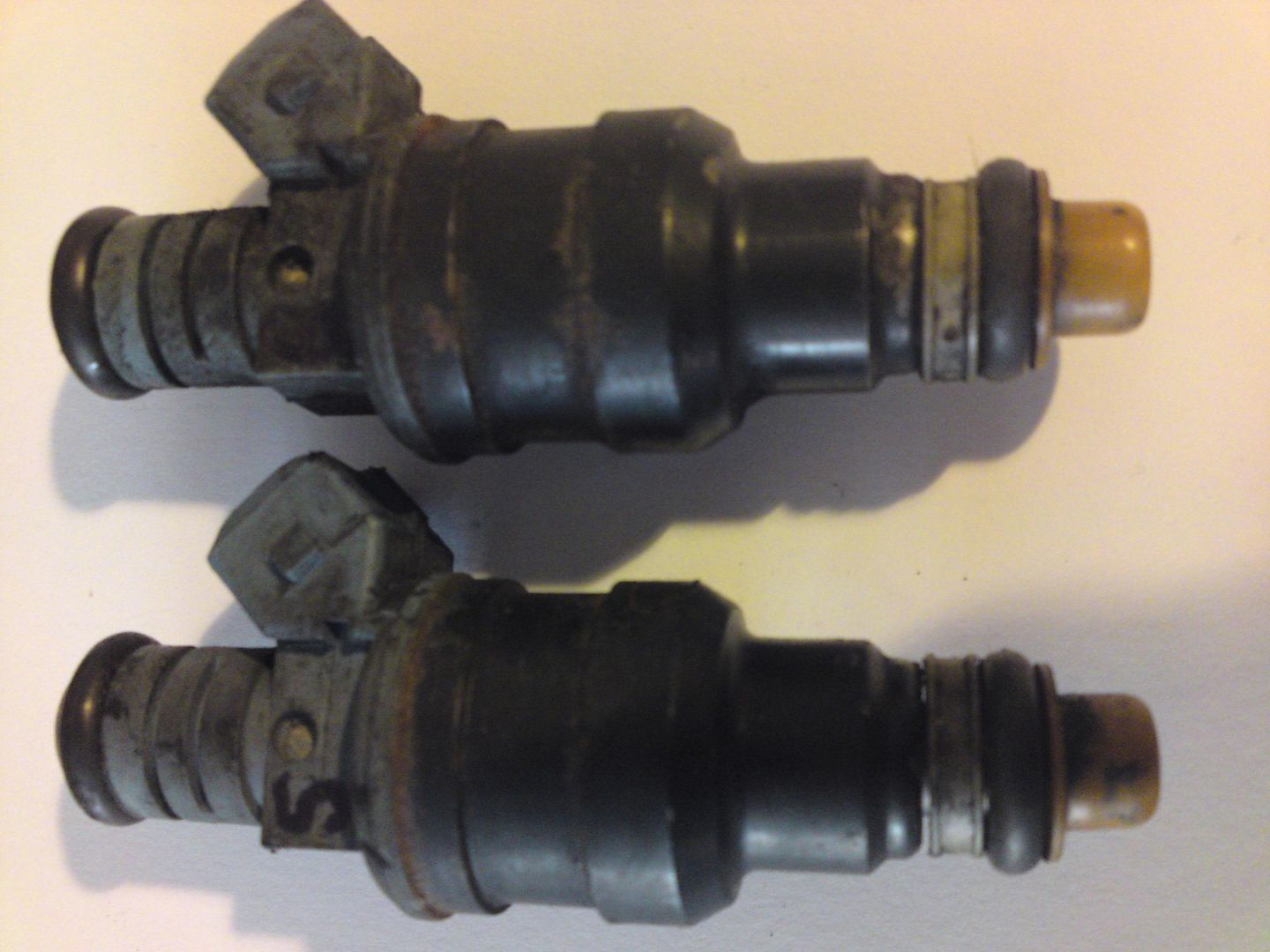

Right i have taken before pictures of the injectors which i`ll put up later of the ones i`v send to Demon Tuning, I posted them yesterday about midday special delivery so should get them today, once i get them back with the reports i`ll put them both on here for you guys to see then at the weekend i will install them.
