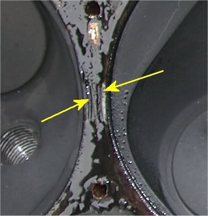

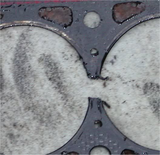

Another update! have found the problem!
Turns out i was worried about the design of the second head gasket with good reason.
When i had the drilling of oilways incident. the gasket i replaced the original one with looked a bit cheep to me!
When i say cheep the little bits of metal inbetween the bores didnt quite meet upto the combustion seals.
And im guessing that when i loaded up a better ignition map the increased pressure was enough to push throu
So have this weekend been removing the head cleaning it all up to be replaced with a decent gasket. Then it got dark so hopefully get it back together tomorow.
BLOODY ECP!
