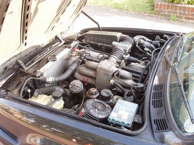

looks like you've been having fun though. i would have been tempted to stick a M30 in the moggy minor over the road while you were at it.
how did you find doing the engine swap with new paint everywhere?

guys do you have a side pic of the engine inplace?
i cant line my engine up? it seems to sit high at the front?

here's andys one fitted
http://homepage.ntlworld.com/a.law47/33 ... uring.html
they don't look like the bonnet will shut but somehow it all clears. the auto TPS (round plug) is taller and touched the bonnet on mine. also, i had to remove the plastic trim on the AFM.

Oh gareth they are the pics i needed!!!!!!!!!!!!!!!!!!!!!!!!!!!!!!!!!!!!!!!!!!!!!!!!!!!!!!!!!!!!!!!!!!!!!!!!!
that matches! so mine doesnt look at too much of an angle!!!!!!!!!!!!!!!!!!!!!!!!!!!!!!!!!!!!!!!!!!!!!!!!!!!

The weather was as good today as it was all week!
I was sweating buckets though!
After I drilled out the (other) broken stud in one of the exhaust manifolds it was easy getting the engine going, it started first turn of the key!
And in the traditional 335 way (even though I was simply replacing one M30 with another) with no exhaust!
I'm sure the neighbours were as impressed as i was!??
All seems good with the £150 Ebay engine and I can finally put my oil drip tray on Ebay!
The Z3 steering rack with brand new track rods and rod ends is fantastic, even without power steering connected! You only have to think about turning and it's done!
Got to get the tracking adjusted soon mind!
Now it's time to re-strip down my engine, sort out some niggles and get it ready for turbocharging!

I'm using just a single Scorpion rear silencer!
Neighbours and friends kept asking why I was changing a 3.5 engine with... another 3.5 engine!
I became like a tape recording in the end explaining my plans!

Excellent mate, pleased it all went well.. starting without an exhaust is so much fun, I was really tempted to go off my estate as it's about 200 yards then it's open national speed limit roads.. really wanted to hear the 3.5 under full load without an exhuast
I chickened out though
Do you have any under car photo's showning your exhaust system, layout ??
I've got a feeling I'll be redoing mine again tonight... first day back at work (had week off to do conversion) and realised that I know might fowl the speedbumps at my workplace
One of my downpipe clamps points straight down.....
Charlie
Charlie

glad that's running nicely martin, time to get the spanners out on that other lump now

How does the standard engine go compared to yours then?
I can't believe how clean this engine was under the rocker cover, quite reassuring that you can buy a replacement engine as good as that for £150.

Thanks guys!
You wouldn't want to copy my exhaust anyway, it's a bit of a Mad Max style bodge to be honest!
Toby - I'll be stripping my other engine down very soon and getting busy as and when funds allow!
Theo - I'm surprised how little difference there is between the two engines. If I did it again I wouldn't bother spending the money tuning a non turbo engine!
It is good piece of mind to know that if it goes bang engines are plentiful and cheap!
I don't at the moment - I had a major pc problem last month and lost ALL my photos, files, porn - the lot!charlE30 wrote:
Charlie
