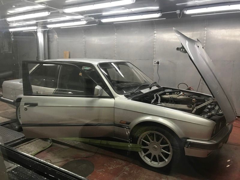

So I ended up going down the 944 S2 FPR route as I gave up trying to find an FPR for the E46 housing in the desired pressure.
Problem since that was engine knock was then present under anything but slight throttle, and starting had become much harder, to the point it could take a minute of cranking to get it going. The CPS was swapped out as the readings were bang on the limits listed in the Wiki, seemed to sort it for a bit.
Went for another mapping session in the hope that would cure it, but it still wasn't getting enough fuel, so everything was now pointing towards the pump being dodgy, 2yr old Bosch pump! So all that could be done in the session was some tweaks to get it running smothly.

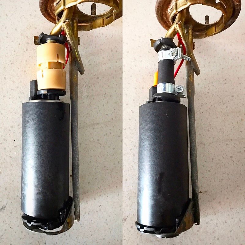

Pulled the pump out and found that the wiring on the cradle was showing signs of corrosion, so replaced that. Also after trying an E36 pump I noticed that the Bosch pump was quite a bit smaller, and seemed a lot looser in the cradle, I don't think the plastic link pipe between the pump and cradle was sealing well enough and possibly leaking. For now I've wedged a rubber mount I had to hand under the pump and it's now firing up as you'd expect an E30 to, also drives a lot better
. So I'll be pulling the pump back out and fitting some rubber fuel line to replace the plastic link so it sits in the cradle lower.

A fuel pressure test rig costs about 10 quid to make, and will instantly pinpoint any fuel pressure issues.
If you are going to use hose to replace the link between the pump and the cradle then make sure it is the correct hose. Most stuff is designed to carry fuel not be submerged in it.

Cool, could you tell me more about how to build a FP tester?maggspower wrote:A fuel pressure test rig costs about 10 quid to make, and will instantly pinpoint any fuel pressure issues.
Do not allow the engine to 'knock', I cannot stress how important this is.
Still looking good though
I'd not even considered a fuel hose wouldn't handle being sat in fuel, will do some research into that.

Fuel supply issue sorted with the use of some proper fuel hose to replace the plastic link, made sure I used rubber that's rated for being submersible in petrol as per maggspower's advice.

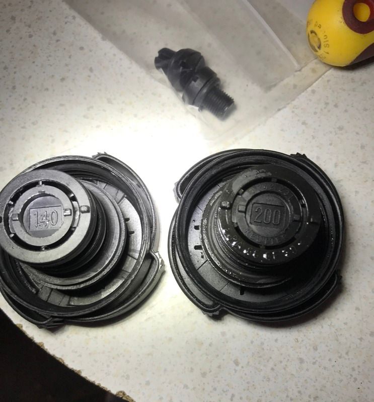

Had also had an issue where by the coolant system pressureised itself the last time it was on the rollers, temp fix to get it home was to remove the rubber seals from the cap. Upon further inspection I found that the rad cap was what looks to be a 2.0 BAR one, instead of 1.4 BAR. Hopefully this was the cause as I couldn't find any other issues. Just needs a coolant change and I'll be booking in for what will hopefully be the last mapping session.

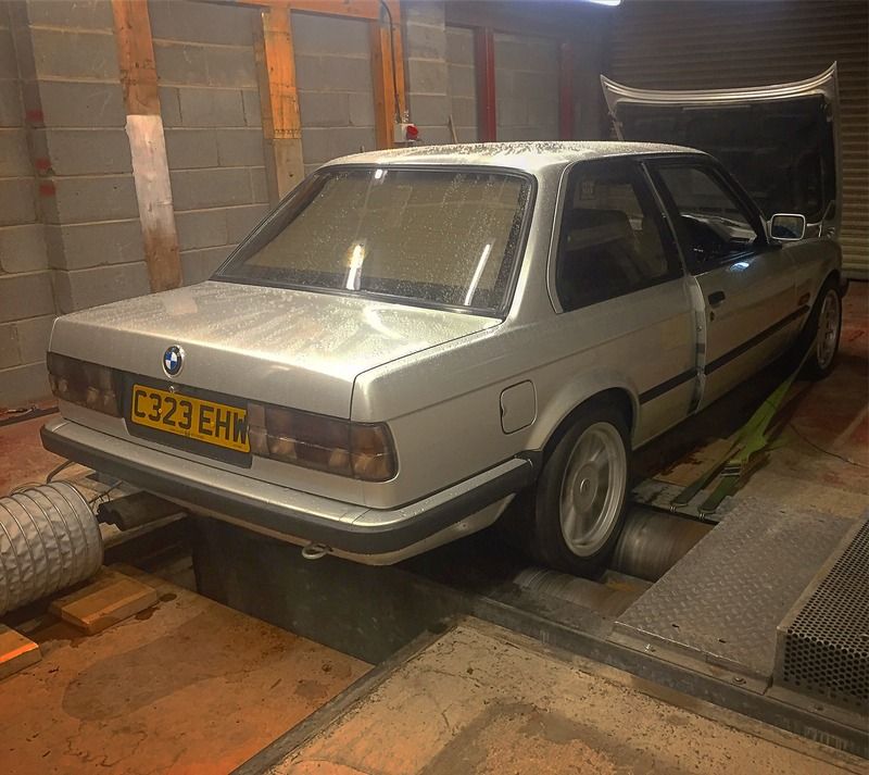

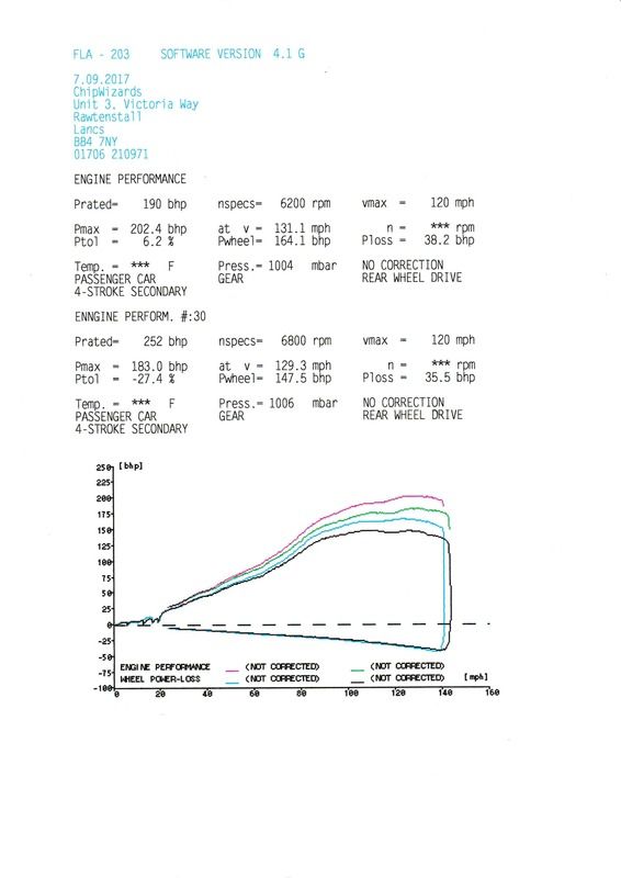

Finally got this thing mapped, in the end I had to upgrade the fuel pump. The Bosch pump just wasn't up to it (has been sent back to Bosch for bench testing), I had an E36 M3 pump fitted for a while, but it was noisy and only just flowed enough, and with not knowing it's age I thought it was best to go for a new aftermarket pump, went for an AEM part, seems nice and quiet. REports of noise is what put me off going down the Walbro route.
Now the mapping has been finished, it drives so much smoother, pulls harder throughout the rev range and it returning a hugely improved economy. Headline figure wasn't as high as I'd hoped (202bhp), but then other than the cam the head is standard, so there's room for improvement if I feel like throwing more money at it.
