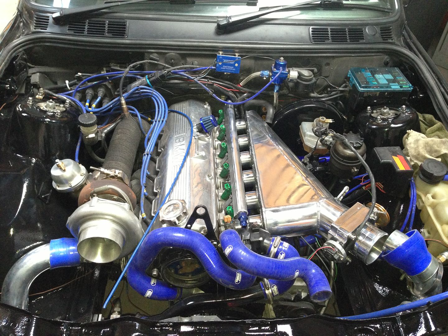

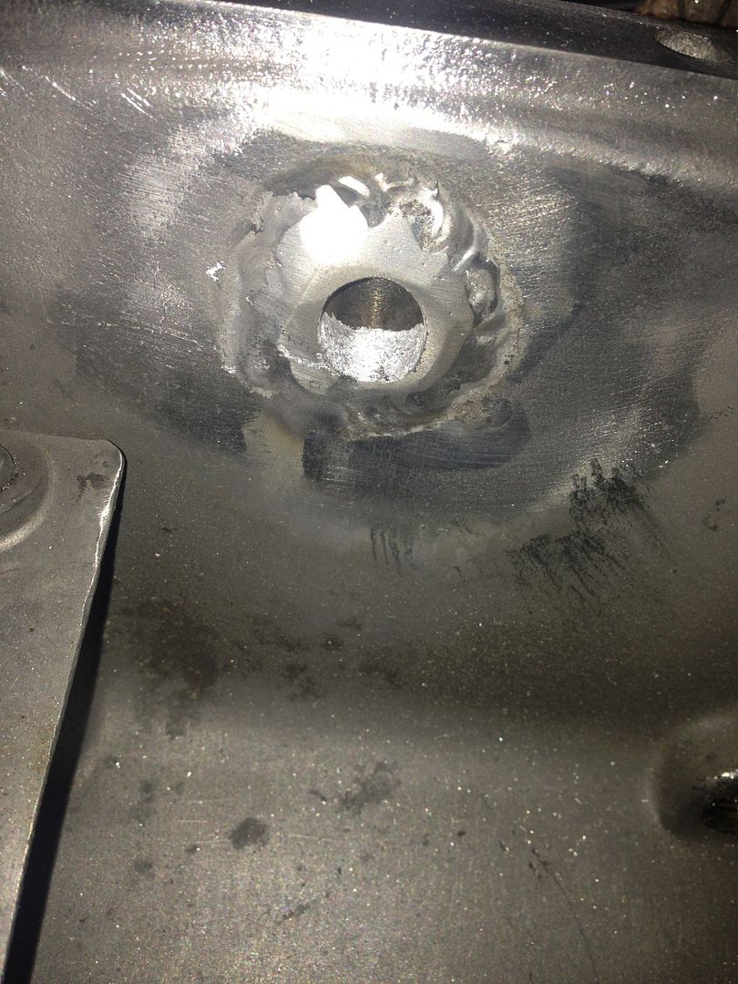

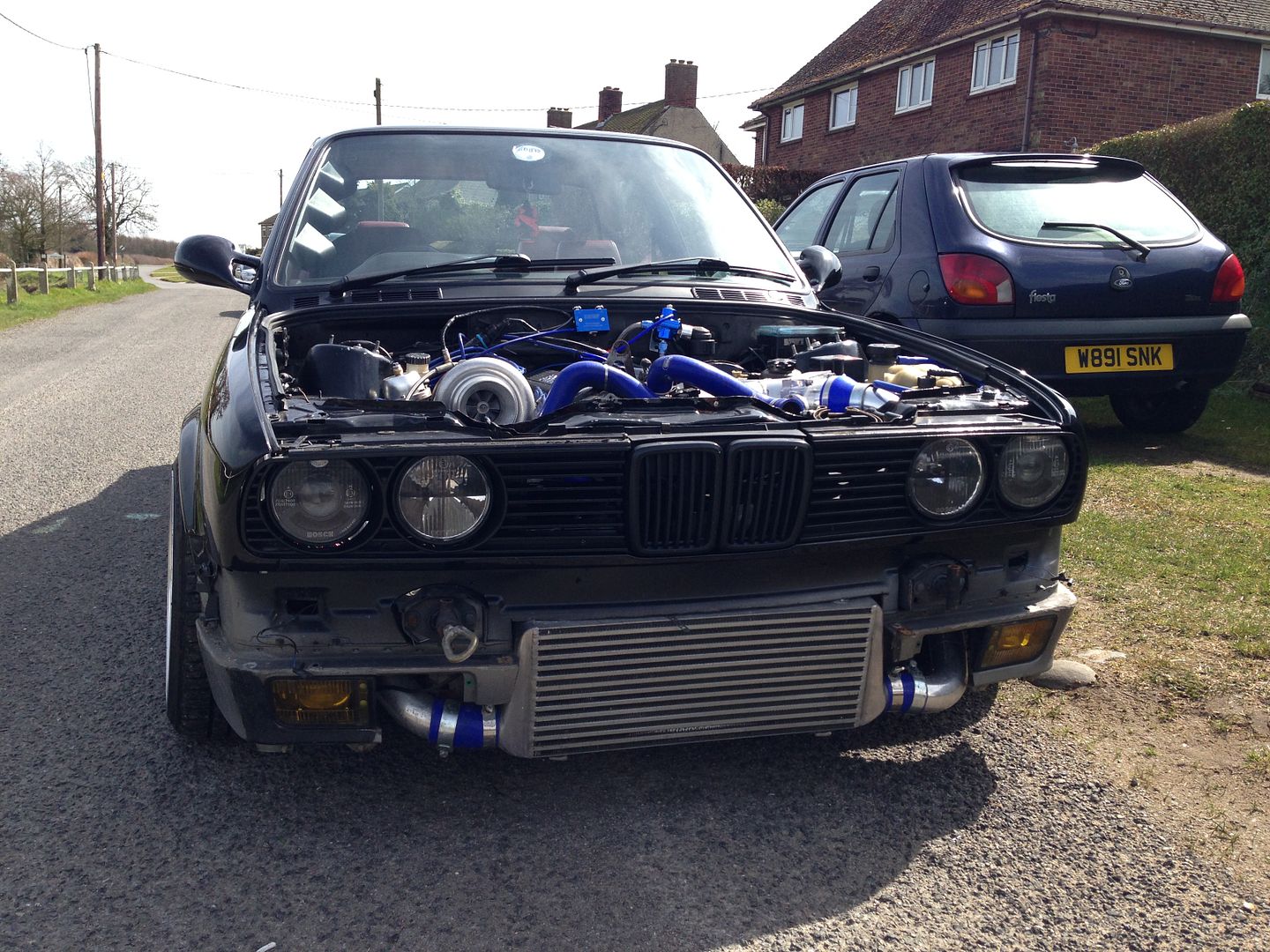

so i thought i better put some updated pics up of what ive been up to over the winter a few little new bits a few tweeks on the engine
enjoy

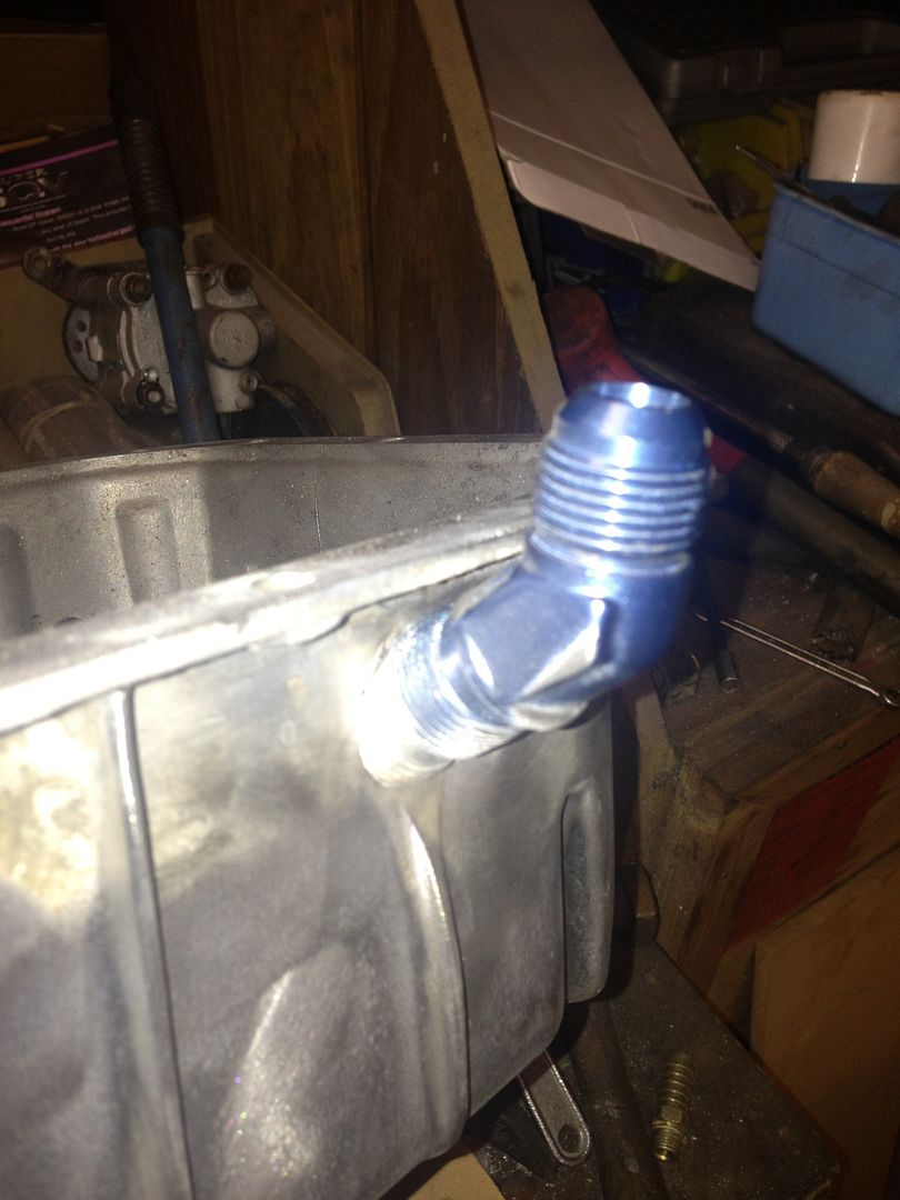

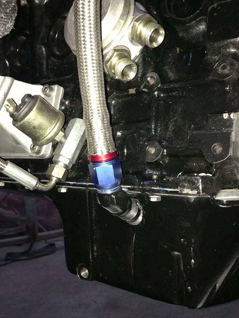

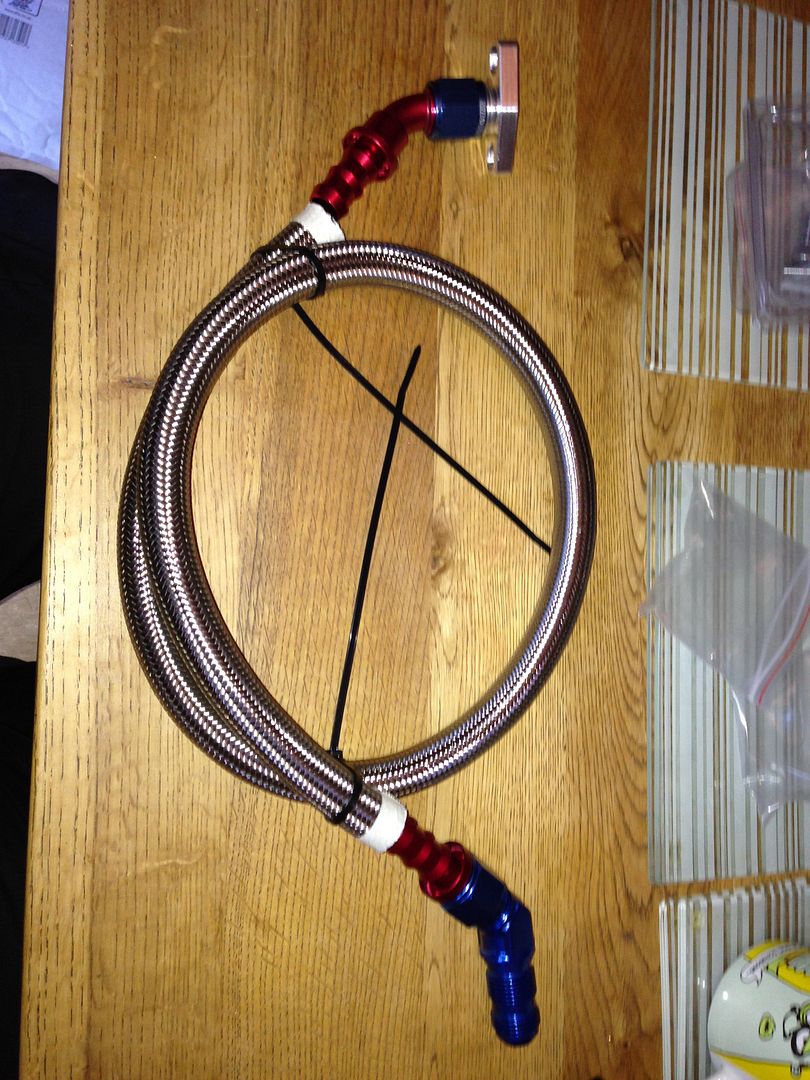

new oil drain for the turbo
drift look

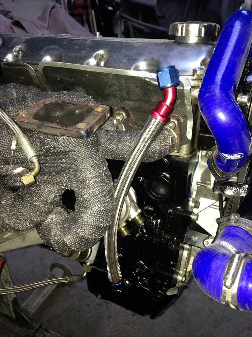

new oil drain and new exhaust wrap down pipe was also done

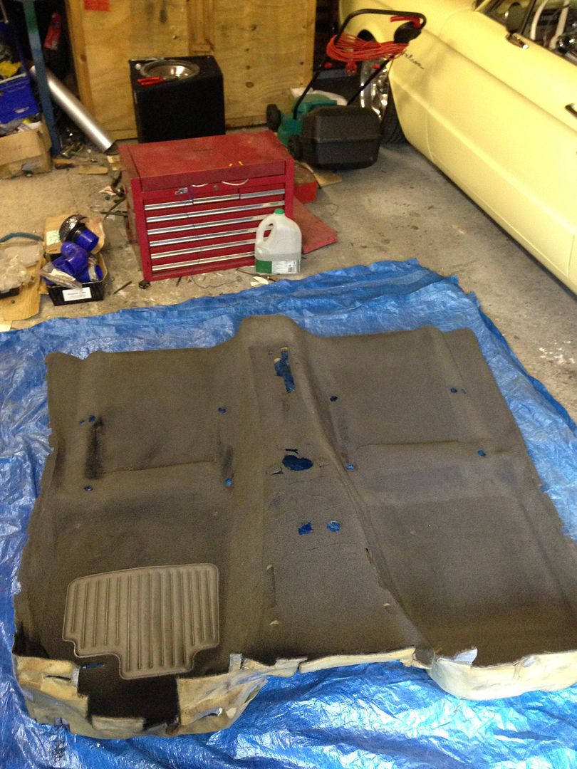

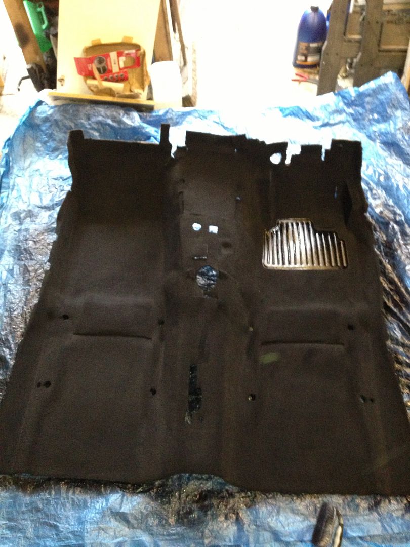

i also had a go at doing my carpet from gray to black bought the carpet of mick (magpie)and from this
too this

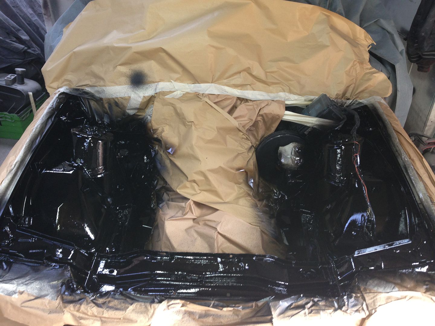

so whle the engine was out i thought id tidy the engine bay up a little so that got a lick of paint too
then just gave a few things a little polish
havent got a pic yet of the new carpet and mats etc in but i will take some maybe tomoz
drift look

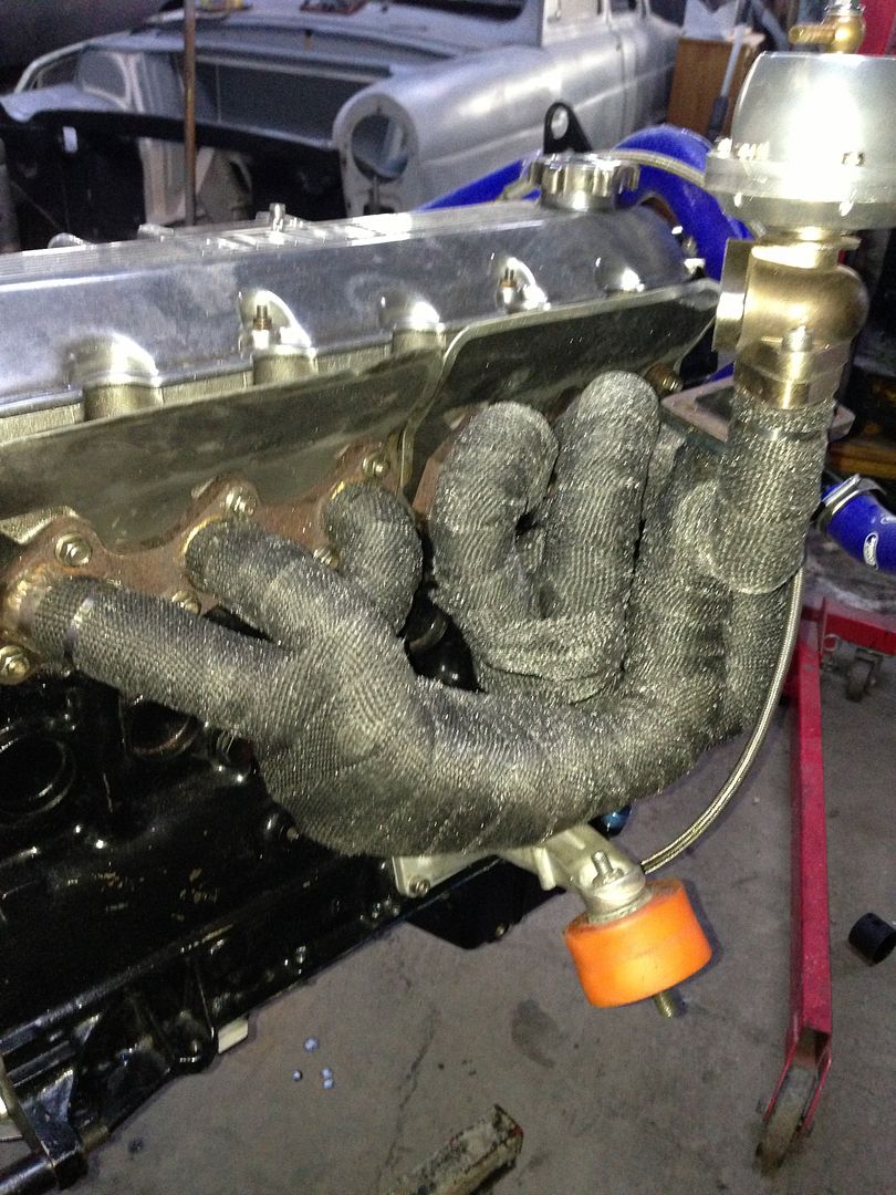

too this

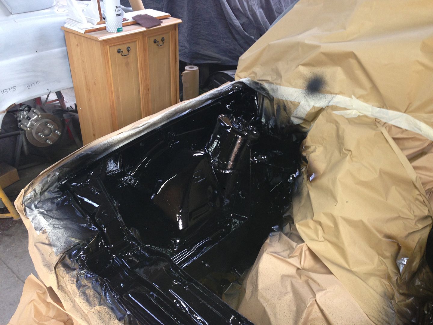

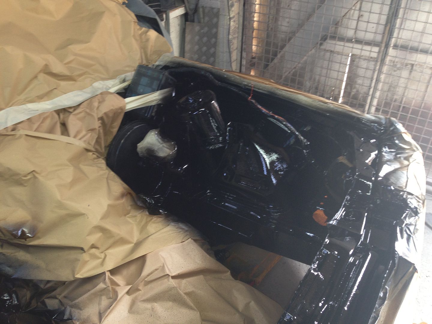

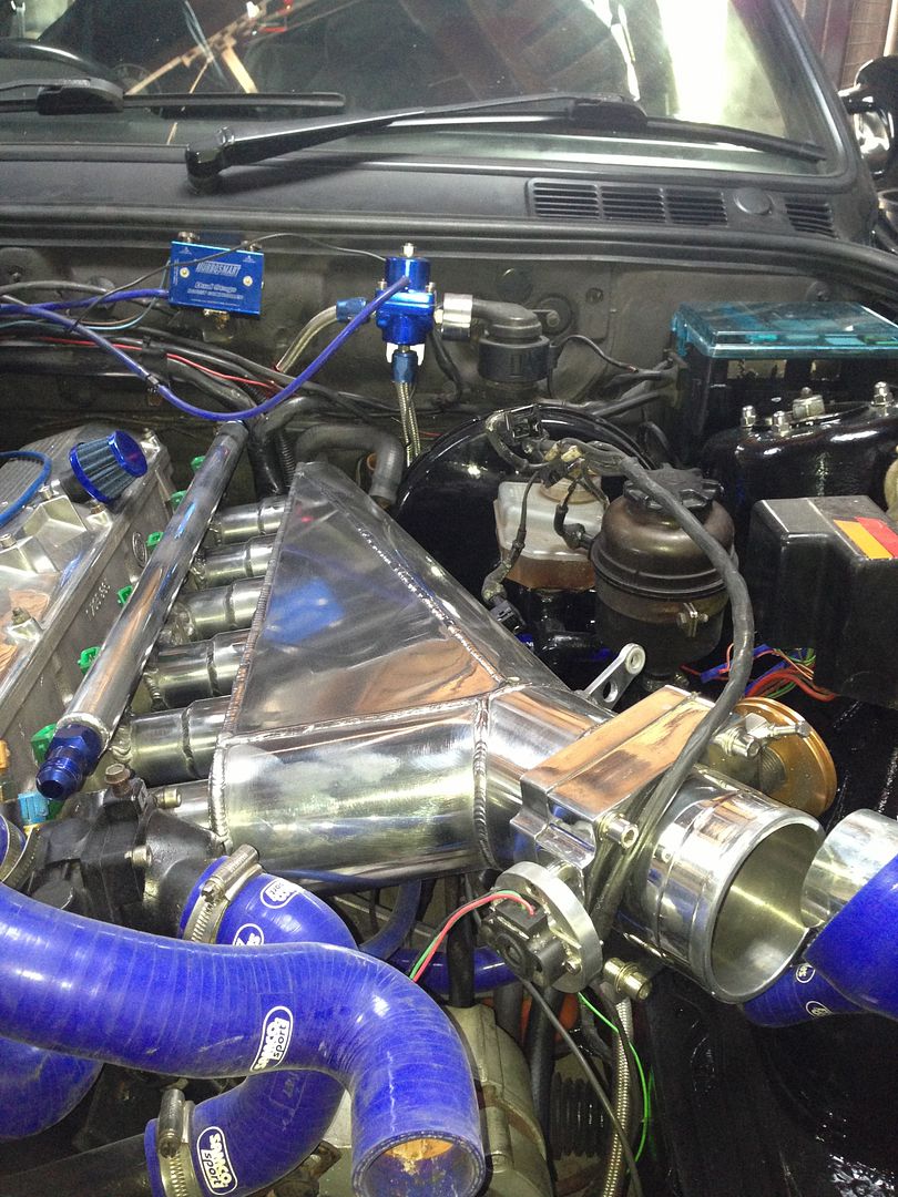

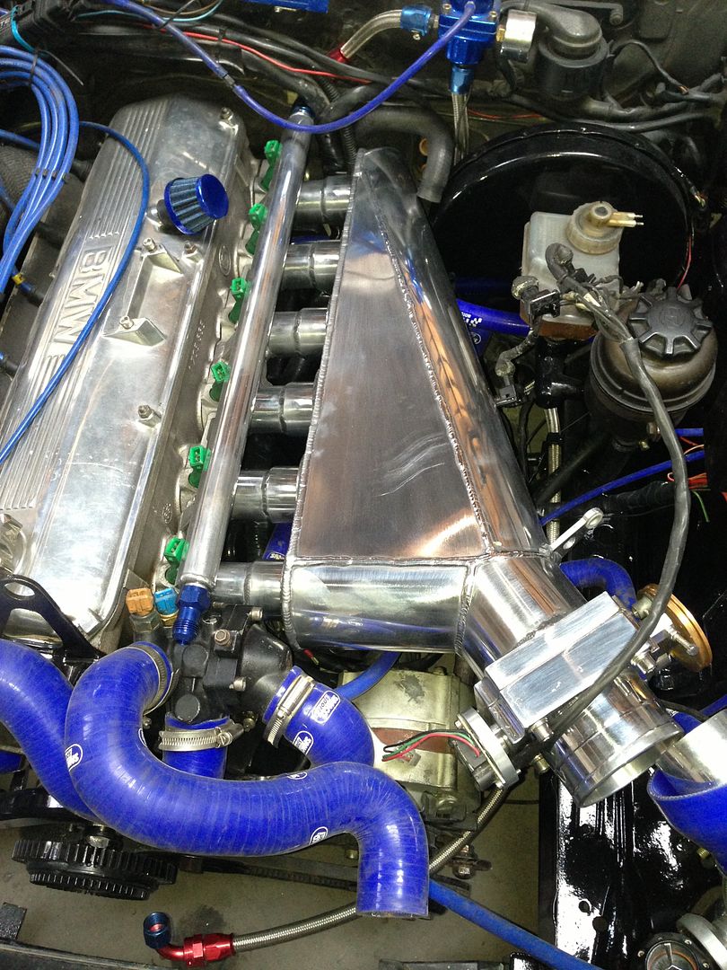

I haven't read back over this thread but what's the spec of this bad boy. Looks like it's getting more serious now with the inlet manifold etc
ross2009
- Posts: 2762
- Joined: Mon Nov 19, 2007 11:00 pm
- Location: In my beemer MAN !!!! st neots CAMBS

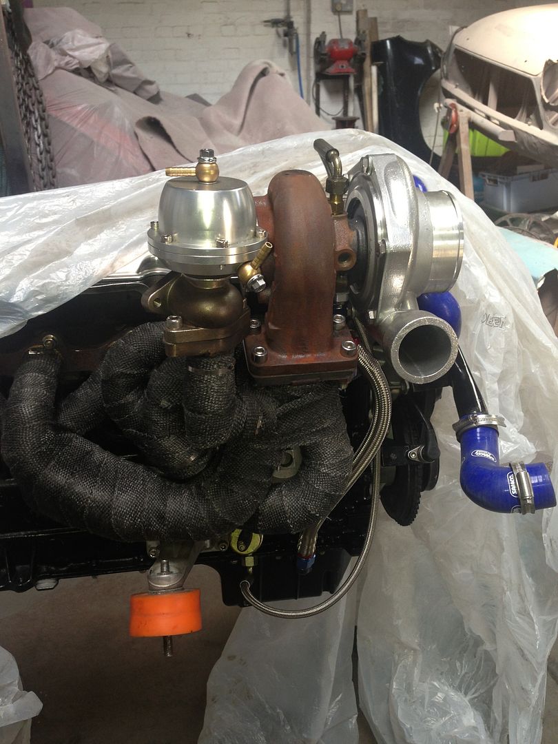

ha ha ha well the carpet had to be done as it was terrible erm engine its forged ross racing pistons etc etc 8.0-1 cr running about 1.3 bar its about 400 or so at the mo
