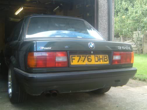

thought i'd change the badges for a while,
i was getting bored of looking at the same badge.
i'll leave this one for a while, see if i get used to it.
got some front eccentric control arm bushes coming tomorrow.
what do you lot think?

Post Mon Aug 15, 2005 7:03 pm
:lol: :lol:
Thats the one. :twisted:

Post Mon Aug 15, 2005 11:35 pm
That looks cool, It looks strange and unique and i think i know why. No bmw came with the second diget bigger than the first, i.e 325, 540, 750, wheras 350-that is just phat!

thats the bitch glenn :cool: :D
:bling: :drool: :drive: :burn:

Post Tue Aug 16, 2005 4:50 pm
Me want Q big time
Saying no to a double exhaust
front control arm eccentric bushes picked up this afternoon,
now fitted.

350 ,thats the one !!
Mines got the 332 !
Ant
