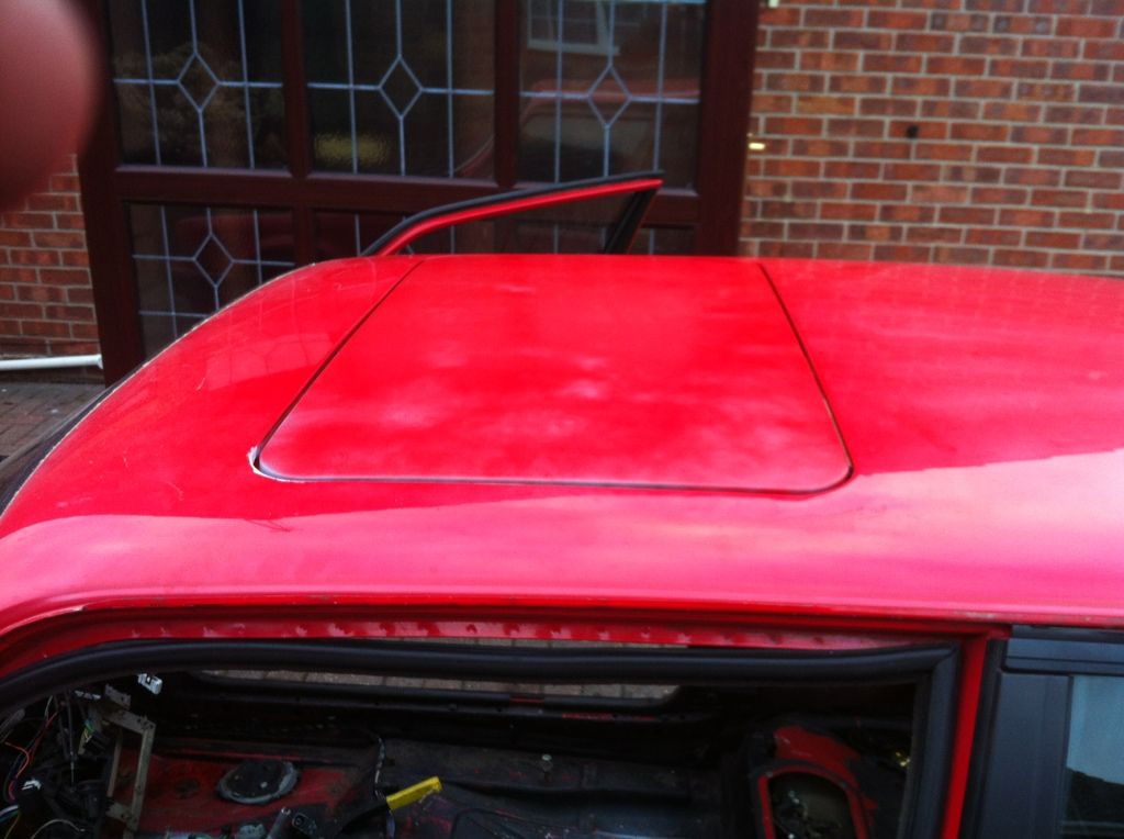

Found mine .
After advice ect . I have come up with this solution .

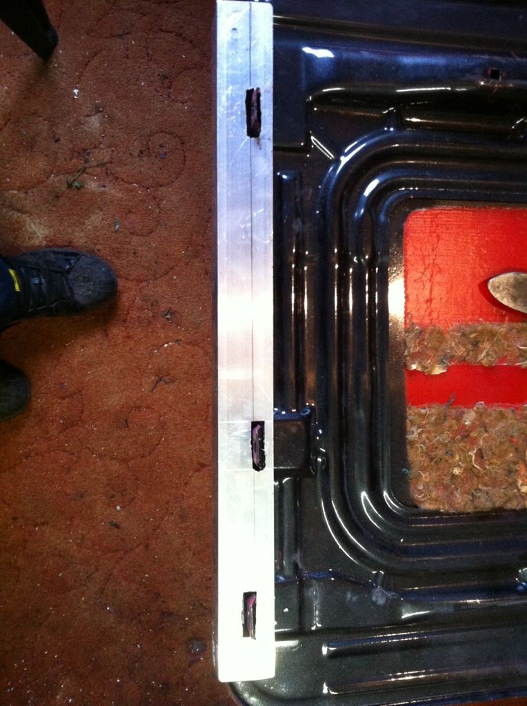

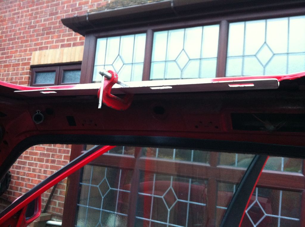

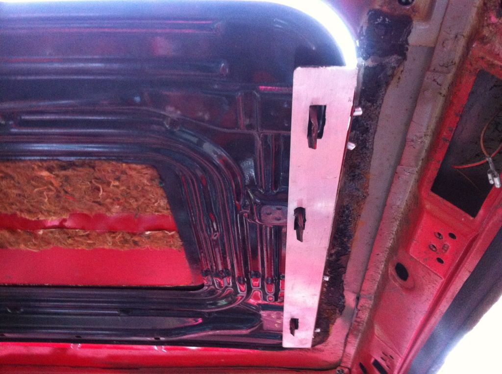

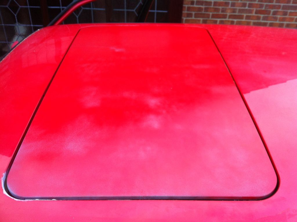

Sat Mar 02, 2013 5:42 pm

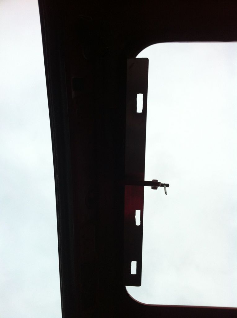

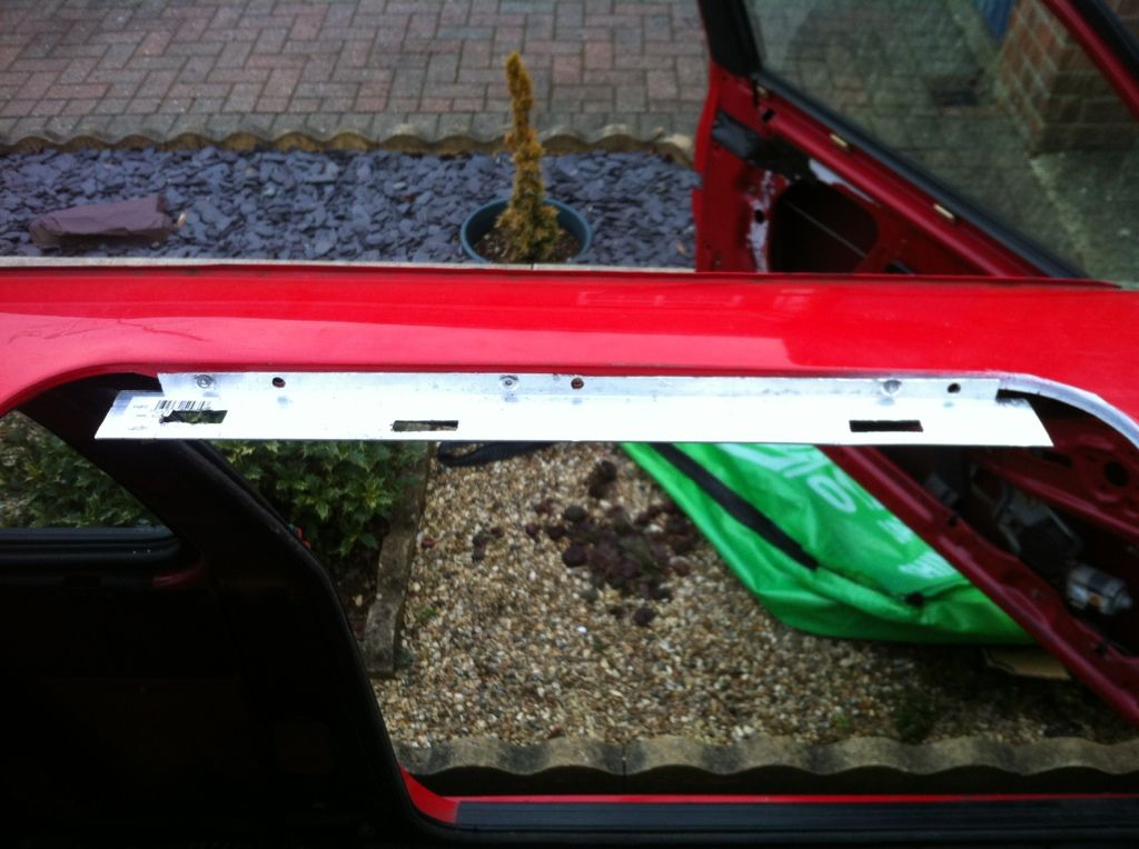

Finished up these brackets for the sunroof today , unsure if im happy tbh quite abit of faffing to get the panel level . Will have to make spacers and adapt how it will bolt down .
Its level but bolting it to the brackets is going to be agg , alot of thought needed tomorrow

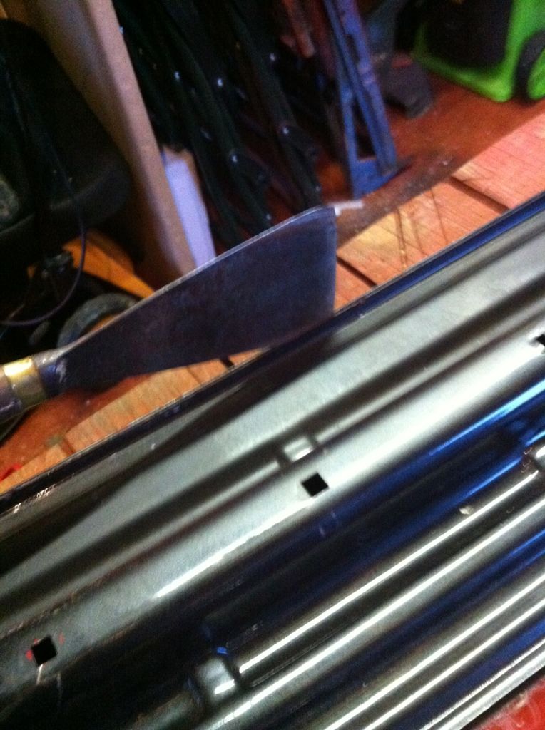

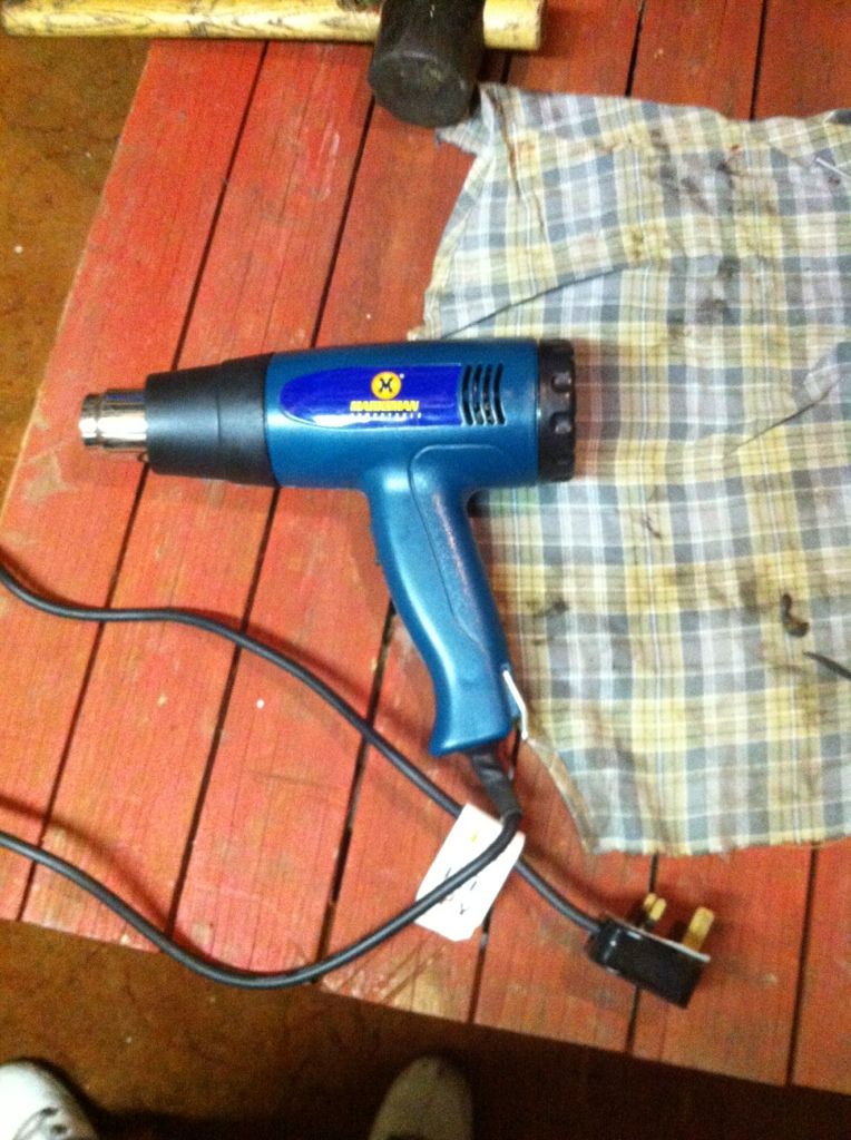

Mon Mar 04, 2013 10:47 pm

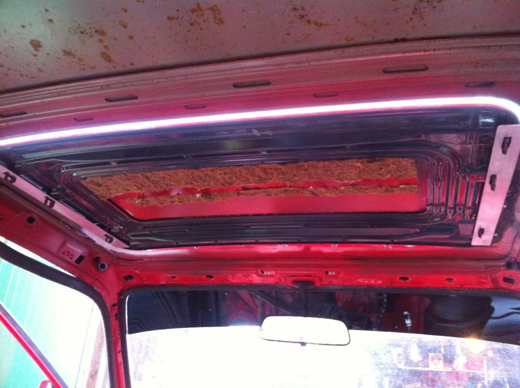

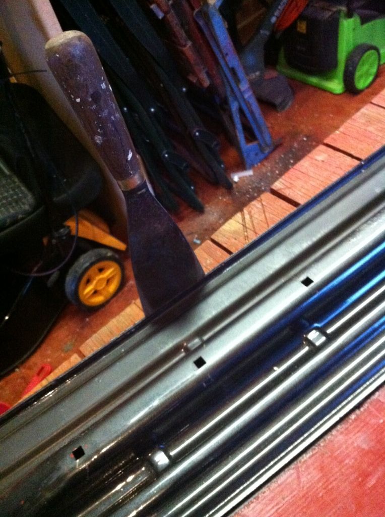

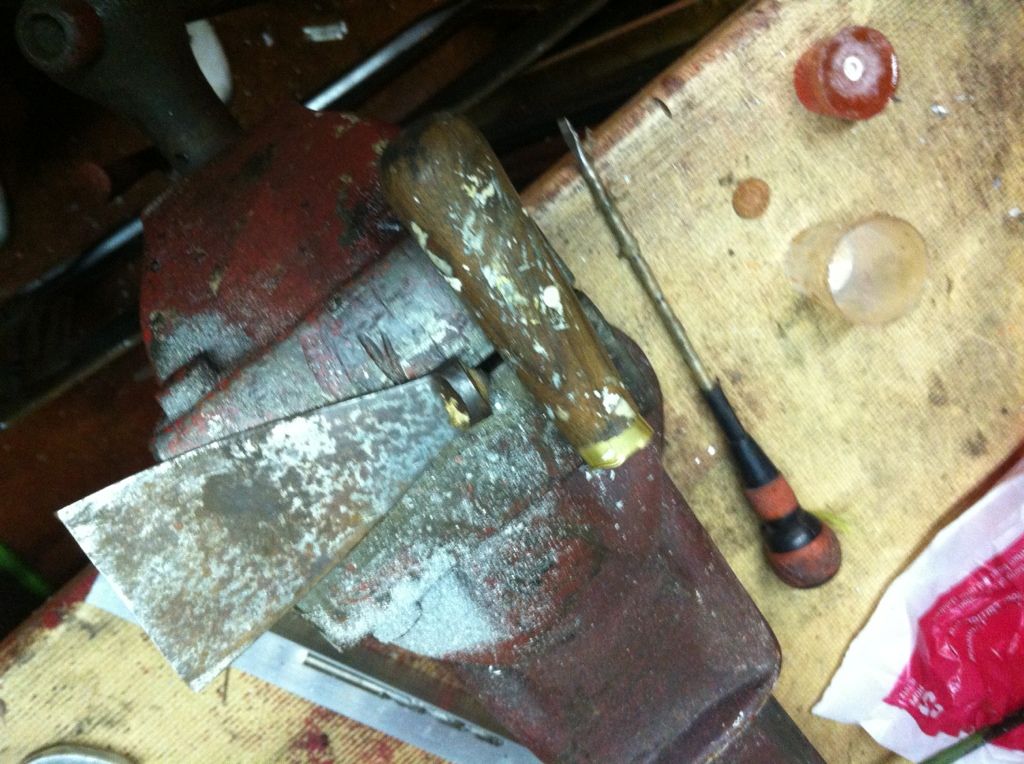

Change of plans with the sunroof . Dont like the brakets at all .
Soo today i received this handy little tool that helped me out alot today .
All sound deadening inside the "cockpit" may you call it is removed .

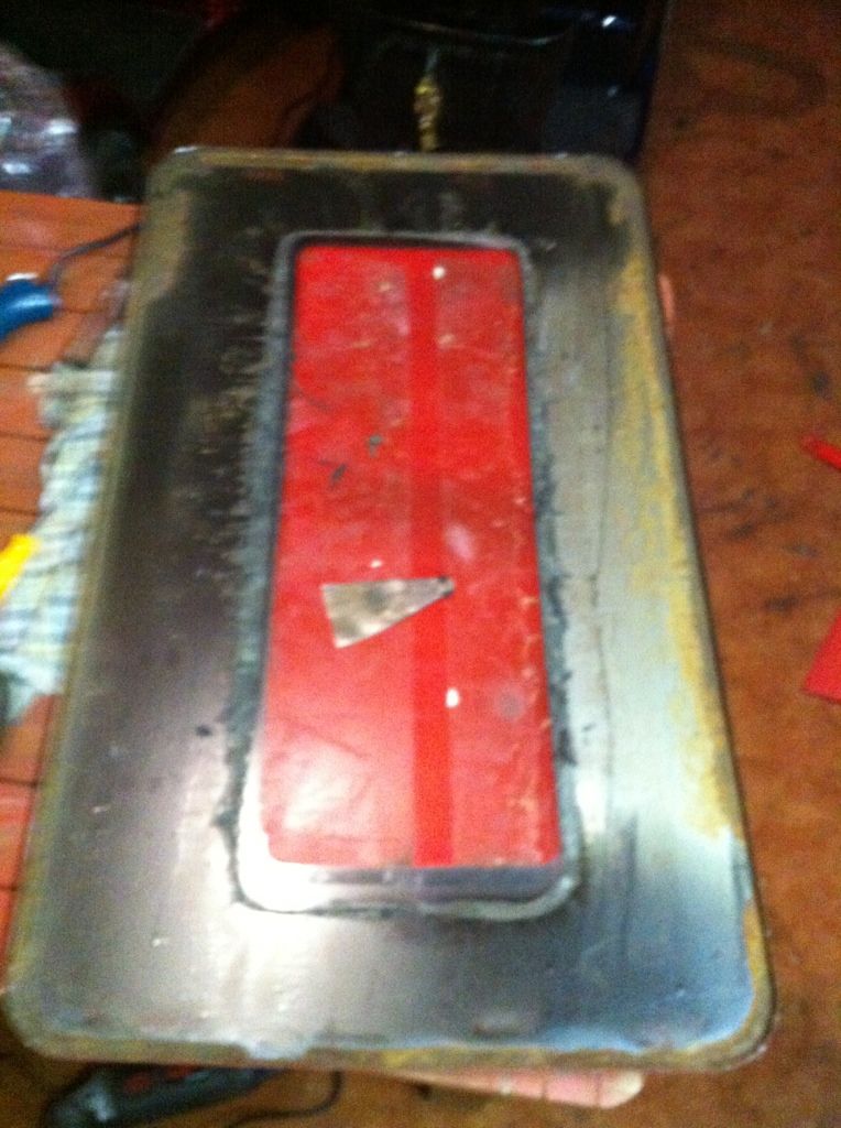

Then rethinking on the whole sunroof idea , had a look and i worked out how to seperate the two skins on the sunroof panel .
I used the grinder on one spot weld and thought id try hitting the scraper , after about 30-45 mins of carefull faffing about with said scraper and a rubber mallet .
I ended up with this .
And this , which i beleive is also older than me , i dont think my grandad will be best pleased if i continue to break and bend his tools lol (i do replace the broken tools)
Anywho , what i shall be getting is some 4mm stainless wire rope to go all around the panel and tack weld onto the panel, from now on its trial and error . I hope i will be satisfied
Thats all for today folks .

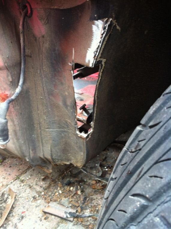

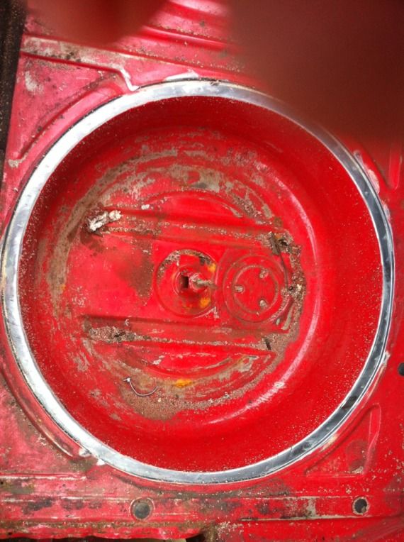

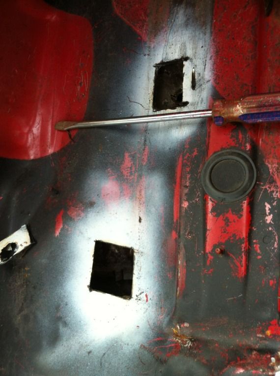

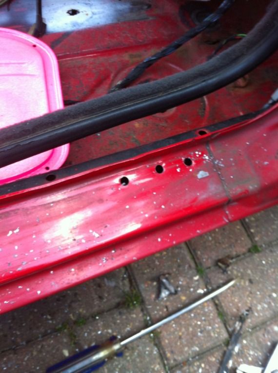

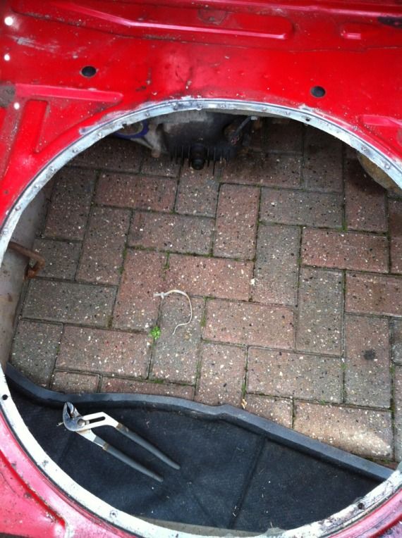

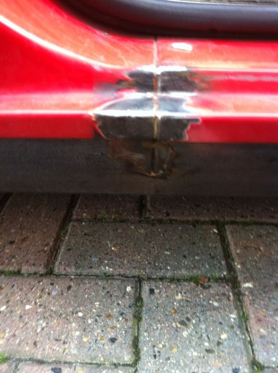

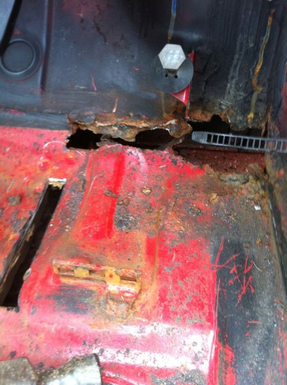

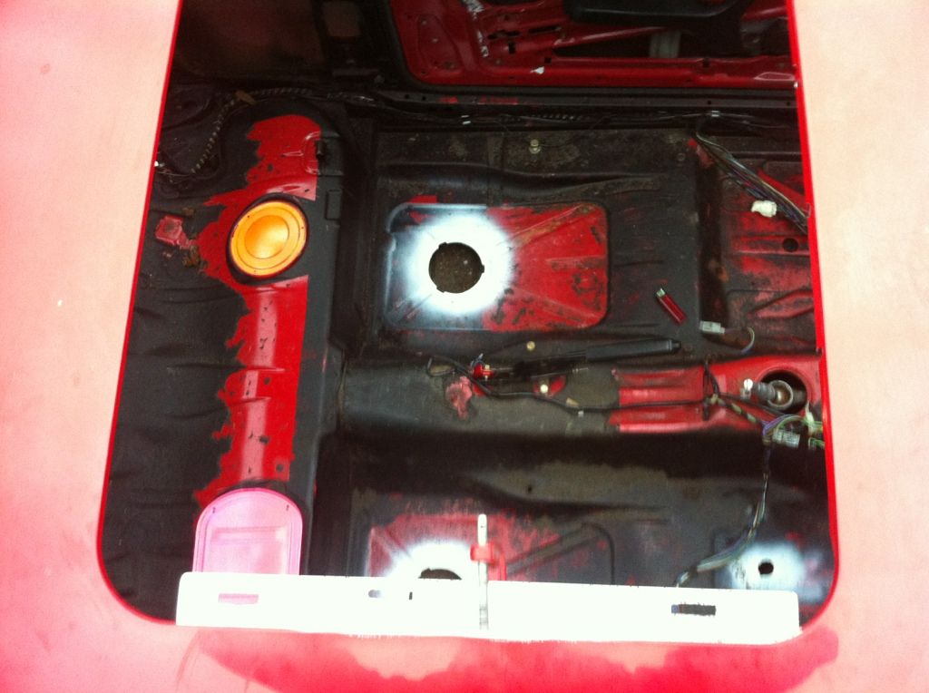

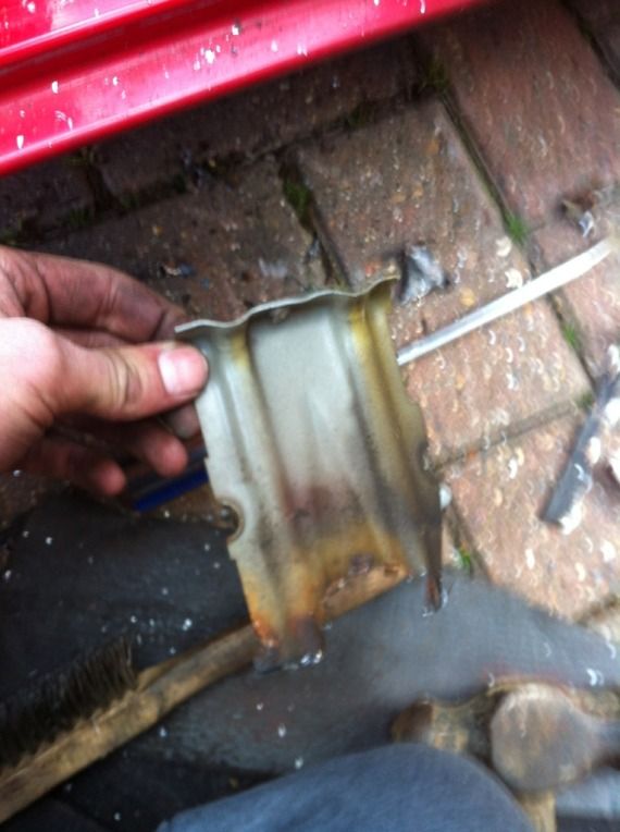

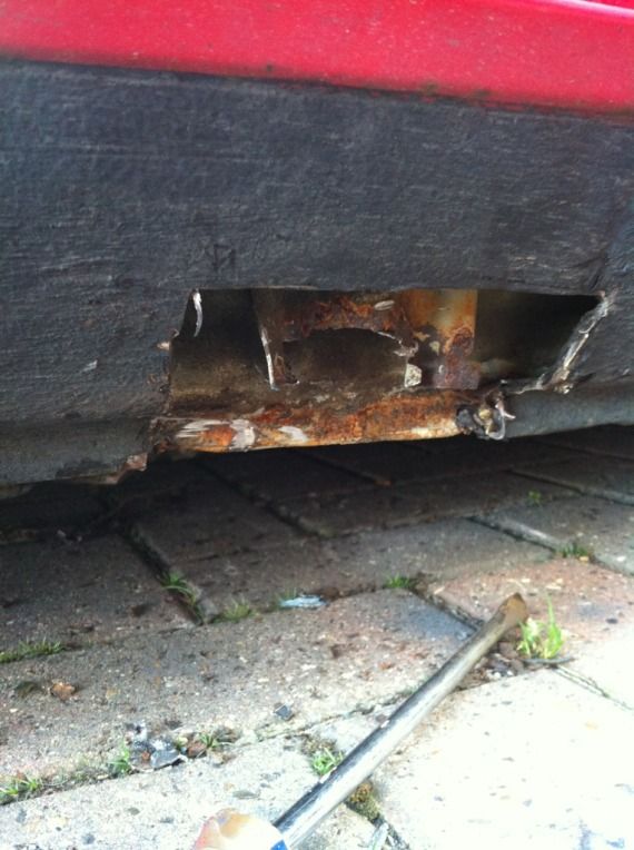

Soooo ive been getting a little down and dirty lately cutting out rust and removing shizzle , take a look.
Spare wheel well ,Grinded back the seem sealer and drilled out the spot welds . The only part that seems at all weak is the n/s/r corner of the hole

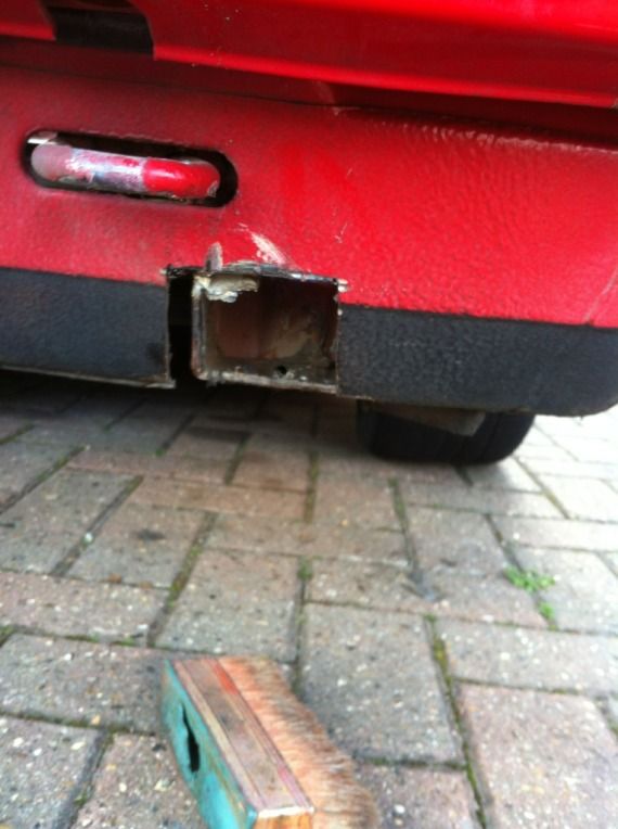

Then onto the rear valance , im working on all the rust on the drivers side for the mo so i dont have to turn the car around due to space .
cut out the rear valance and part of the rear box or whatever technical term for it is . Rust !
Then this ... Ground it down and a coat of Hammerite rust cure stuff .

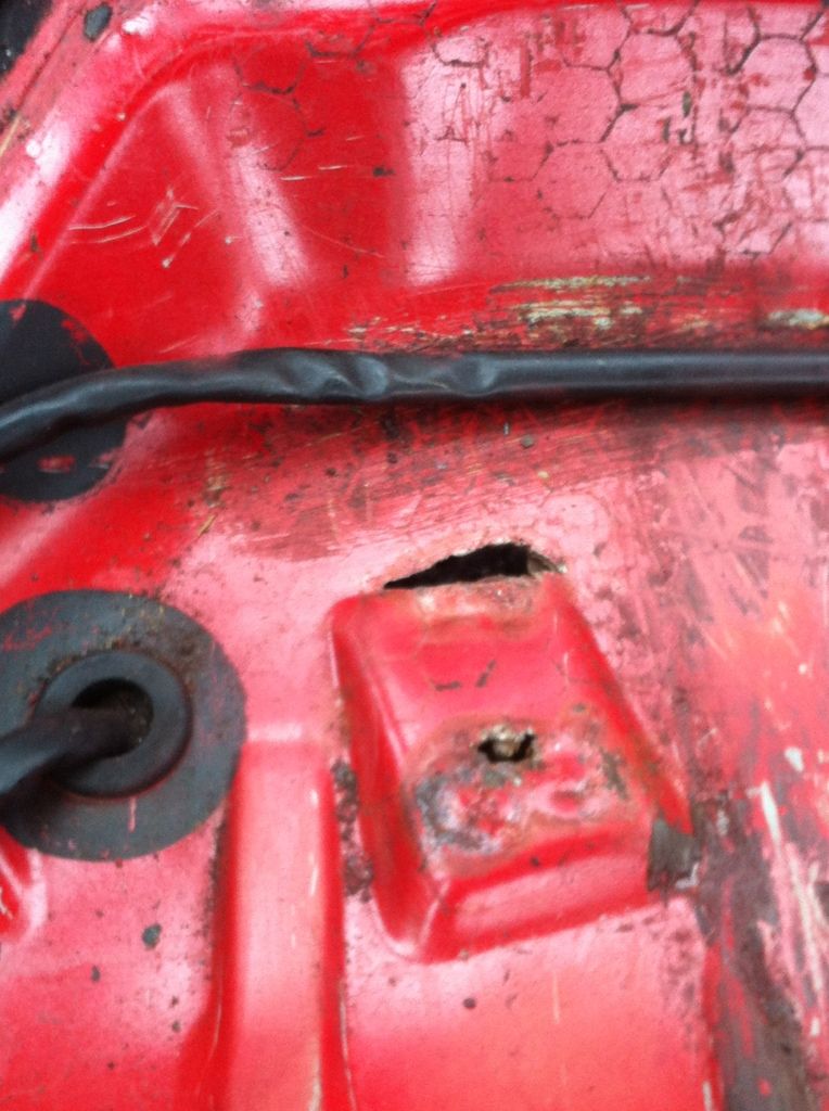

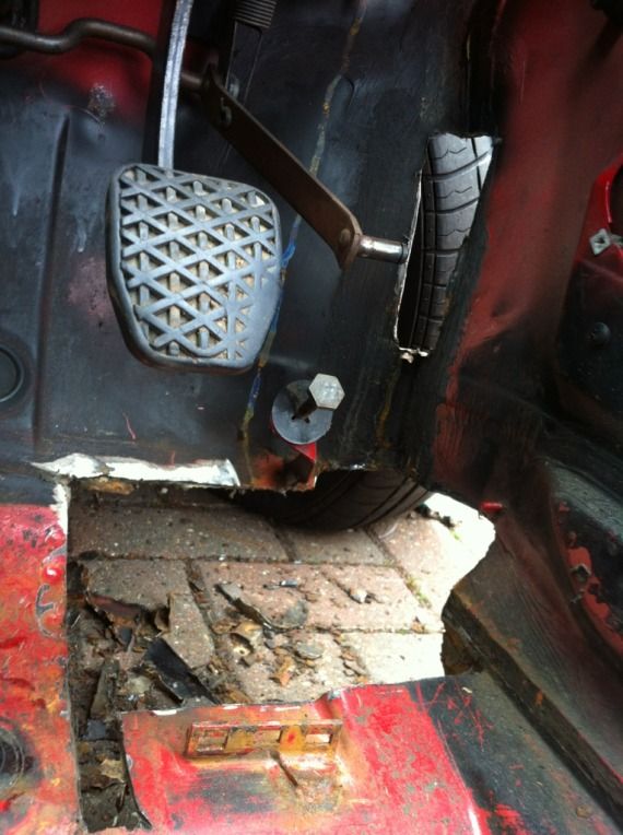

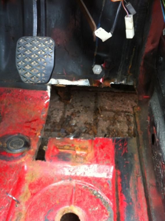

Moving on to inside the car !!
quite luckily the points for the throttle peddle seem solid !!
Front drivers jacking point !
before i drilled the spots out for jacking plate .
for now its all shot with some primer until my welder is working or unless i can borrow one for a weekend !
