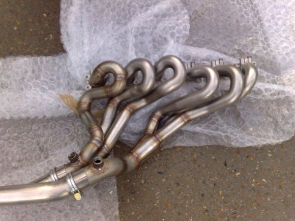

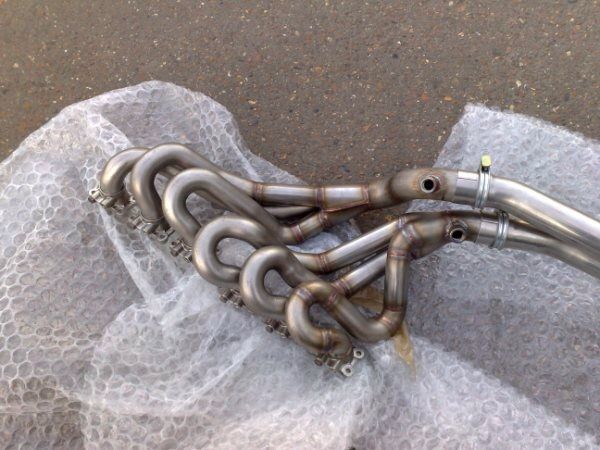

maynee007 wrote:manifold modded....
Is that a tempory solution or permanent for number 6?
It would be better like this

e30topless wrote:
maynee007 wrote:star
this is where it went wrong !
can't believe you went full rear quarters and didn't go pre-face rear panel to keep it sweet this would look so much better with early lights,
i understand your opinion but i have a genetic disease which doesn't allow me to accept the prefacelift lights.....ive never liked them.
what suggested to you that this may be a temporary fix and why is your suggestion better? be a bit more specific please.

I have seen many S50 conversions and indeed executed them myself too, but have never seen no'6 modded in this way. Most atempt to follow the shape of the other five giving a 'professional' factory look once installed and attempting to retain the equal length primaries, this is possible without being wrapped around the steering linkage in that manner, AKA Fritz Bitz, BTB or a good exhaust shop that takes pride in their work. The picture of your no'6 does nothing but scream Bodge Job! and i think undermines the other good work and effort put into your project, those that post positive comments regarding that picture really do not know what they are talking about, and i would be wary of taking advice from people who rave positively about something so poorly executed. I am in no way slagging your project, just pointing out something that IMO will let it down (others will think similar but not say anything), by the way good luck in finnishing it.

well length seems to be bang on ajay...and the route its taken has been kept similar to how it travelled down before modding! Im not too worried about how it looks moreso the purpose and the factors which affect performance. I was advised it is best to keep it as close to factory as possible. We'll see how it goes if not then out it comes....what d'you reckon?

Sure i understand its done now, and that you will give it a go, yes it does go from a to b but in the worst possible fashion. Most people atempt to avoid the steering linkage with all 6 primarys on the same side, if an exhaust shop was doing that they would soon go out of business. I personally could not live with that, but if your not bothered fair play to you. You may want to think about wrapping it to reduce the possible heat transfer in that area. GL

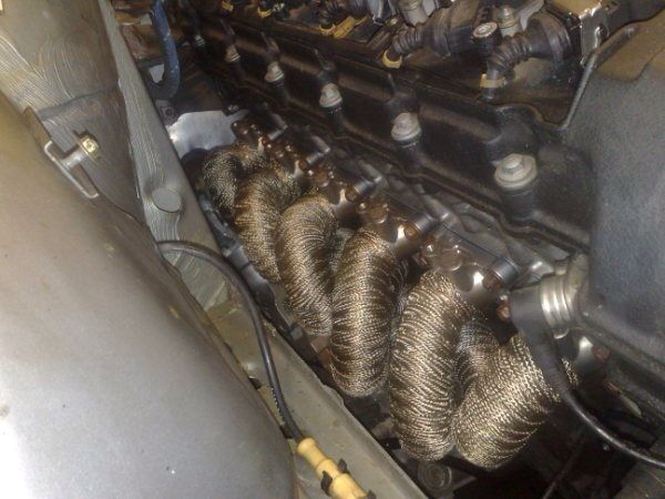

Does the No.6 primary clear the inner chassis rail like that?
I modded my first S50 manifold in this way (almost the same tbh), but I wasn't happy with the clearance to the chassis rail. Do you have any pics of how No.6 enters the collector?

another shot of the manifold
its sat perfectly in the bay...im well happy with the way it works down past the box and anti-roll bar. Have to wait now for some figures to back up the work.
