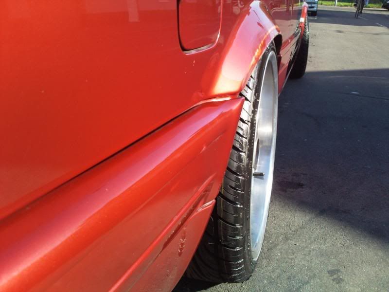

******UPDATE 24 AUGUST 2009******
Right i finally got the front E36 5 Stud conversion to sit correctly by the help from fellow zoners,this is what it consists of-
E36 M3 Front Struts
E36 M3 EVO Front Hubs/Calipers/Discs(massive)
E36 M3 EVO Front Wishbones
E30 M3 Front Control Arm Bushes
E30 Springs
E30 Top Mounts
I must stress to anyone who is looking to do this conversion using E36 parts,that to get it sitting SPOT ON this is the only way to do it!
Anyway here are the before pictures-
And here are the latest pictures with the new parts-
rear arches needed modifying,but as you can see the front wheels sit perfect.
ALL COMMENTS WELCOME!

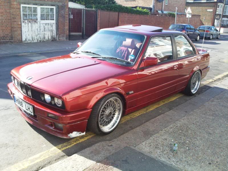

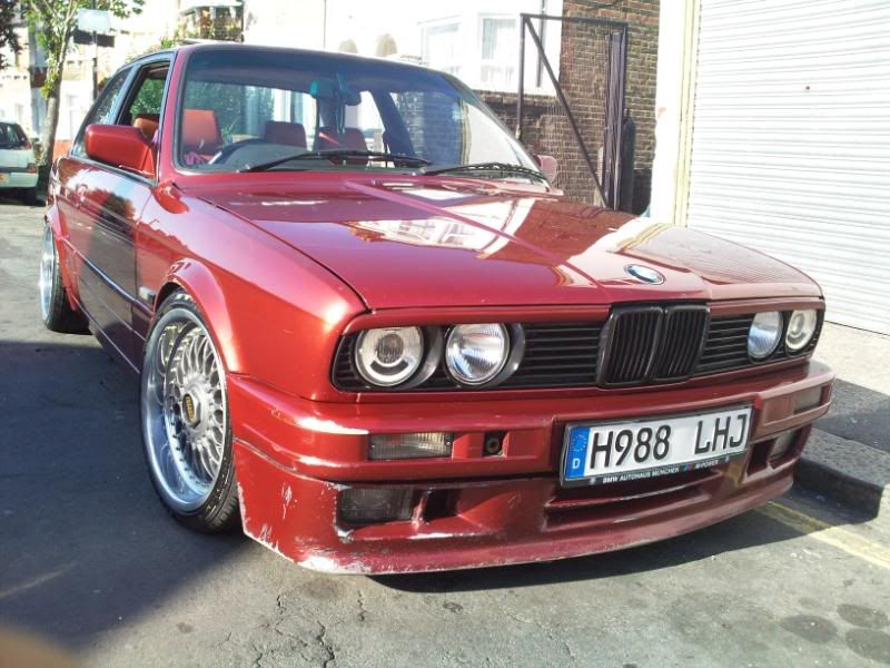

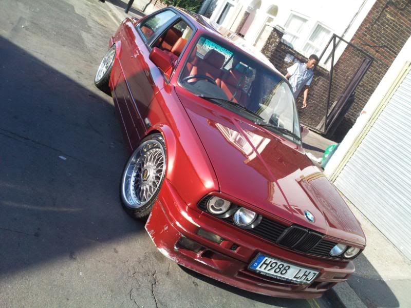

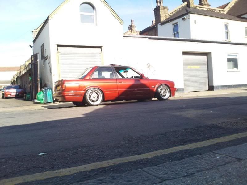

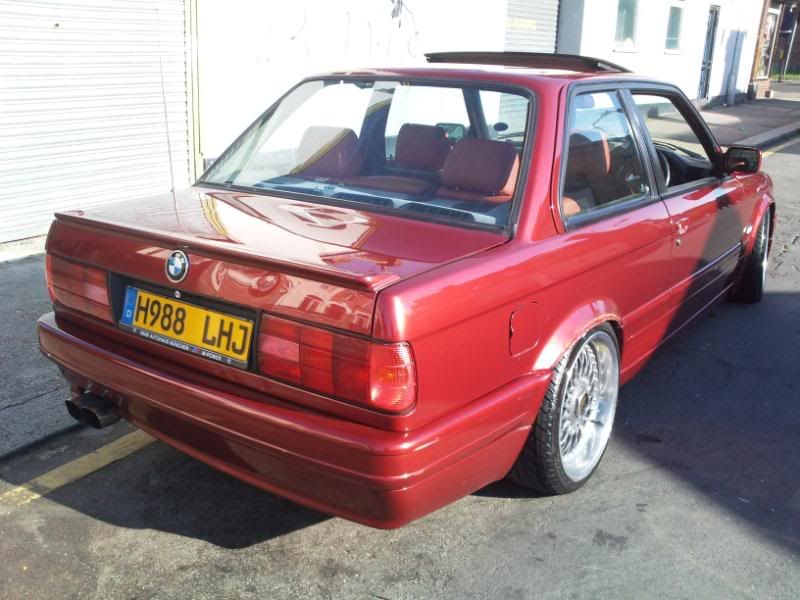

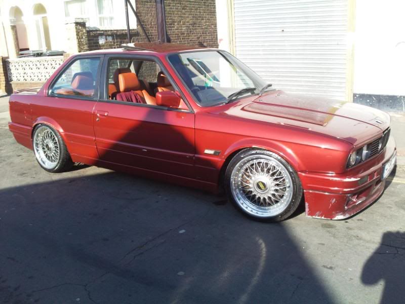

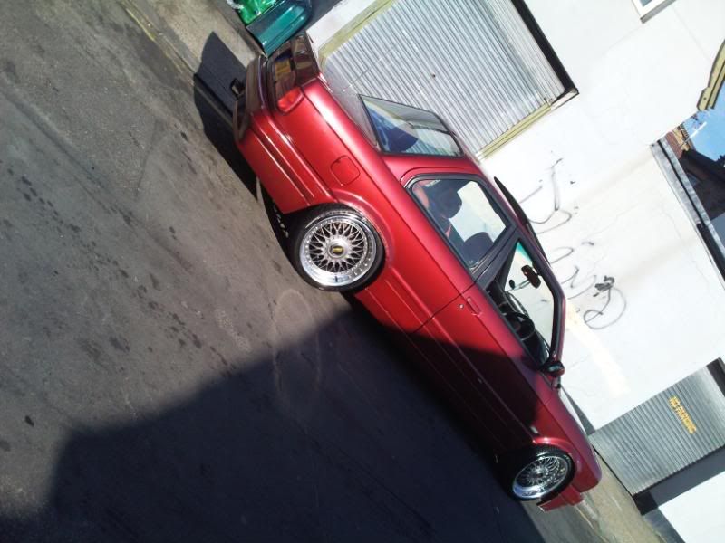

well been a very slow progress on this as i ahve been very busy in my garage with customers cars.
soooo,heres a minor update/change
clutch is gone on her so ordered a new clutch the other day and has been delivered,so as i need to drop the engine and box to change the clutch i thought while it is out im going to do the following-
Respray the complete engine bay
change most seals on engine
refurbish stater motor
wrap the manifolds in exhaust heat wrap
get the rockers covers&other bits painted
just to make the engine bay FRESH!
other than that,while im doing the clutch the following will get changed-
Brand new Front and Rear Suspension
New Front & Rear Top Mounts
Eibach Front And Rear Anti-Roll Bars
Wax oil/Underseal whole of underneathe

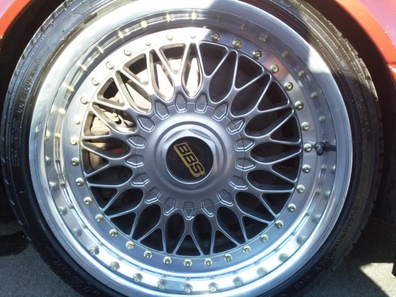

anyway thats that for now,as some of you may know i have sold the BBS RC's that were on the car(got bored of them),so i bought these babys on ebay for £50!!!!!
they are standard 5 series/7 series 16" BBS alloys,8J All Round,with 205/40/16 tyres,i think they look really good,but all comments welcome-

- Posts: 22478
- Location: Derby Massive!!
Wheels look good Shaz, bargain at that price
Loving the stance
Loving the stance

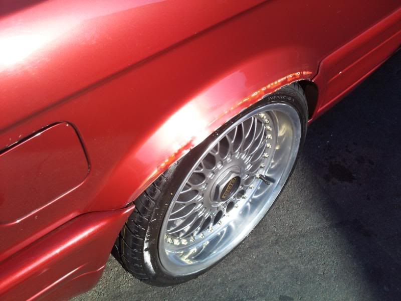

looks like a nice ding in the wing
looking very nice any way

prefer these wheels to the other ones shaz, look alot better...
got any pics of the engine bay???
- Posts: 24532
- Location: London/Surrey
As much as i like 17" style 5's those 16" BBS look awesome!
What parts did you use to convert to five stud?
