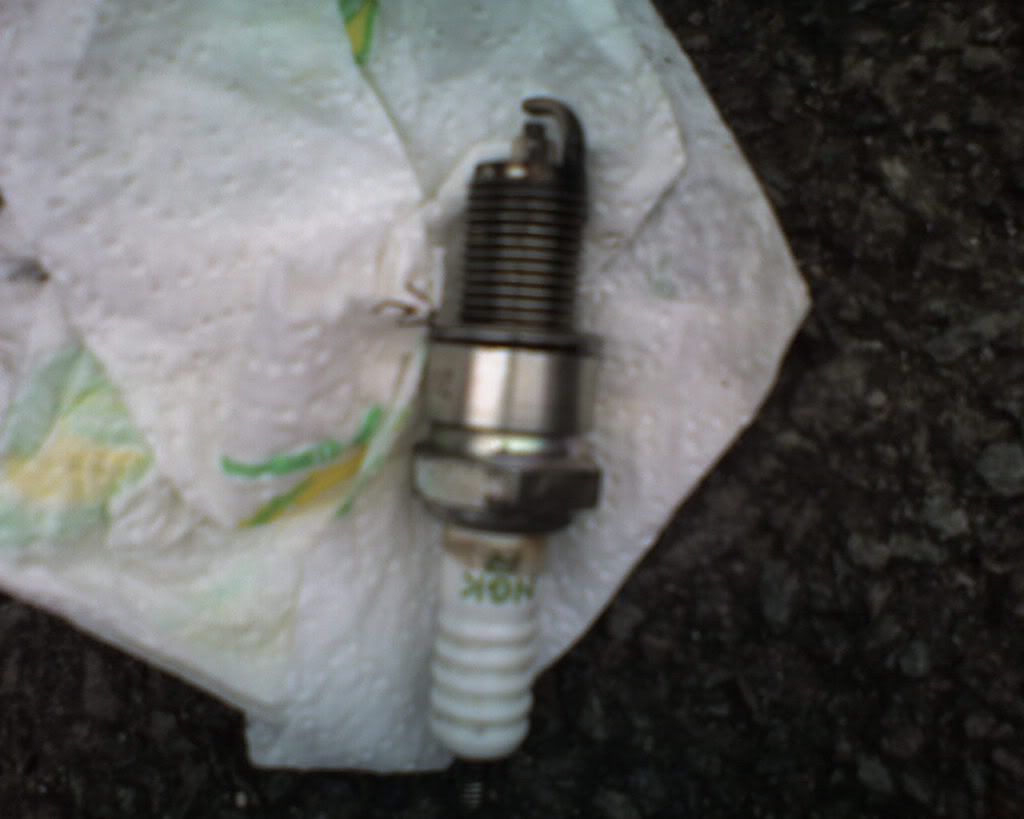

aceraf
Posts: 3005
Location: Derby
Post Fri Oct 10, 2008 2:15 pm
Guess I should've checked this earlier....the first 2 spark plugs (from the front of the car) were covered in oil (looks like it's been leaking from the Rocker cover downwards). From the 3rd one back they weren't too bad...a little burnt and black, but the 1st 2 were actually covered in oil!
Strangely though the oil level is fine.
Sorry about the pic...camera phone, i cleaned the 1st plug and took this pic...
basically the tip of the spark plug has a sort of burnt oil (black) deposit on it.
I've cleaned all the plugs and put them back in as i think i should fix the problem before replacing them (which will be done along with a full service.
Any ideas, could this be caused by just a leaky rocker cover gasket or do i have a bigger problem with this engine?
Strangely the car still pulls very well, and there's no blue/white smoke from the exhaust which is why i didn't think it would be burning oil.
