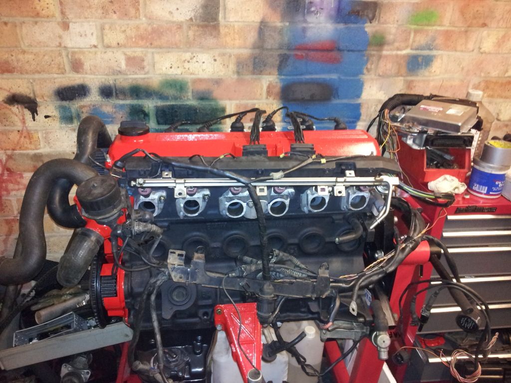

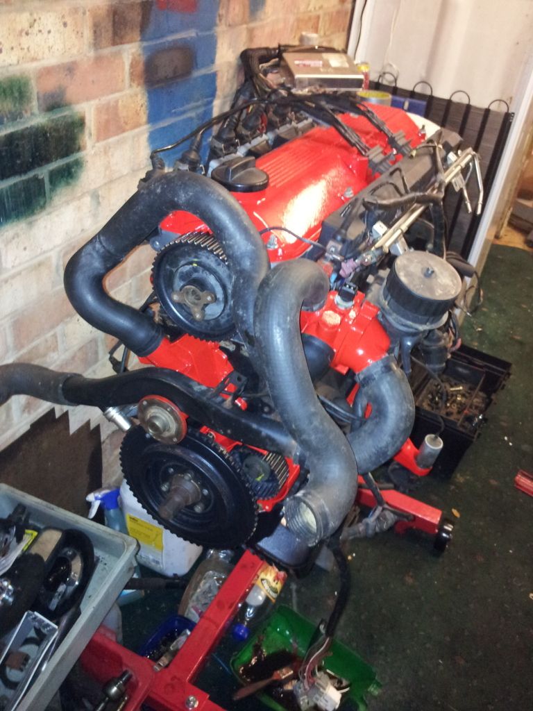

Been cracking on with the firing loom a bit over the last few days, managed to score a whole m50tu loom, coils and red label ecu for next to nothing locally.
Not happy with the way i have done the injectors and coils atm. I want to separate the coil and injection bit and move the injector feeds to the bottom of the cover for neatness sake.
This set up plugs into an e30 loom using and old ecu plug and run about 70% of the functions through the e30 loom with the extra features of the m50tu m3.3.1 added on.
This would allow a normal ecu to be used for fault finding with only a few plugs swaped over.
I still need to run a few feeds but after plugging it all in and checking the continuity to the output i am confident enough in the loom alterations to be able to post the info. (will do in a different thread later tonight.)

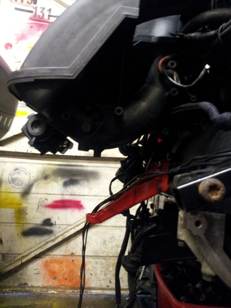

Moved the loom about and started looking at the manifold, re-taped some of the loom its much neater now but i need a new lid for the injectors and a plug for the coils.
Got lots of issues with the fitment but haven't got time to try solving them yet, still i'm sure anything can be done with enough work.
The spacing is making the intake runners 370mm rather than 320mm, which is a bit of a bummer however its only going to serve to move the torque curve and peak hp down a little although i am still on target according to the sim so meh.
Couple of photos for dan showing some specific areas of concern.
Posts: 28649
Post Mon Sep 03, 2012 10:27 pm
Looks to me like that manifold/throttle body will be in the bodywork, for the coils you could just do a similar setup to the iS, much much easier than trying to fit a coil directly onto each plug
HairyScreech
Posts: 6265
Post Mon Sep 03, 2012 10:49 pm
Coils are not finalized yet, might still even go with the renault ones.
Remember the engine is vertical (can't tilt it as the coils are not attached), i'm up to my nuts in some uni work i need to get finished off for the exam boards so haven't had time to measure much but it should be about the same positioning as an m50/52 manifold, the m20 head with the adapter is about the same width as an m52 head, the 330 manifold is 20mm shorter.
What i'm saying is when tilted it is pretty much vertically inline with the engine mount.
I will get a change to measure soon, if its not possible its not possible.

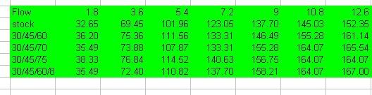

HairyScreech wrote:Ok, i know i have been promising this for a while but meh, times have been tricky.
I got a chance to test the multi angle inserts i whipped up around christmas time and go over the data.
There are a couple of obvious issues with the data which i will address first.
1. The flow is measured at the wrong valve lift - yep this ones 100% my fault the spread sheet i use takes its lift values from the valve diameter and it was set to 36mm exhaust.
This means the flow was measured in steps 5% of an exhuast valve (1.8mm) rather than steps of 5% inlet diameter (2.1mm)
2. The flow seems to be a bit low - Not sure if this is an effect of the port or the surface finish of the seats as this was done on a different head to the other tests. I had a feeling the results would be effected by using an insert rather than a normal seat which is why i made a stock seat replica.
All these two issues mean is that the data cannot be taken as absolute, the tests only show the trend rather than the actual flow a multi angle seat will produce.
As long as we look at the data as showing a % improvement rather than a peak figure then its all ok.
Obviously i will try to sort these two issues out and get true figures but for now this tells us all we need to know. (and i had already done each test twice before i spotted the error so i though **** it ill deal with it later.)
On to the data.

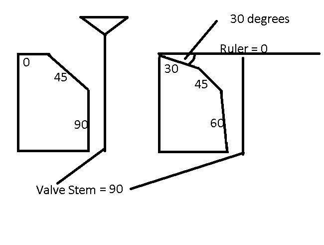

The valve seats have been referred to by there angle profile thus a stock seat is a 0/45/90, having a top face perpendicular to the valve stem, a sealing face at 45 degrees to the valve stem and a throat that is parallel to the valve stem.
The angle is measured as though a ruler had been put across the top of the seat and the flat of the ruler was regarded as 0.
Thus a 30 degree top cut would proceed away from the rulers edge at 30 degrees down into the port.
Its easier to draw so have some dick and quirty diagrams.
First things first the raw data.
This little chart has the seat profile down the left hand side, The lift value along the top and the Flow in CFM in the rest.
And this chart shows the contents of that table plotted.
Its pretty clear to see here that the best combination on the standard shape m20 port is the 30/45/75. Infact it matches the port and chamber so well it actually works better than a 4 angle.
the average improvement shown by the 30/45/75 over the range is about 13% which all things considered is a massive gain for a very simple alteration.
The plan from here is to test a port on this new head (late 89 rather than mid 85) and see if the lack of flow from the stock seat is due to the insert or the port or a combination of both.
Personally i think its a combination of both and would go a long way to explaining why some e30s are faster than others.
A proper steel 30/45/75 will also be prepared that will tell us the true gain from the multi angle, the inserts are cheap and quick for identifying the best profile but there's nothing like testing the real thing.
The other thing i will do is go to town on one of the ports and retest the inserts, it should help to see if the seats will need to be different once the ports have been worked or if they are more related to the throat and port/chamber angle.
i just checked the bentley manual and it says the stock angles are 15-45-75

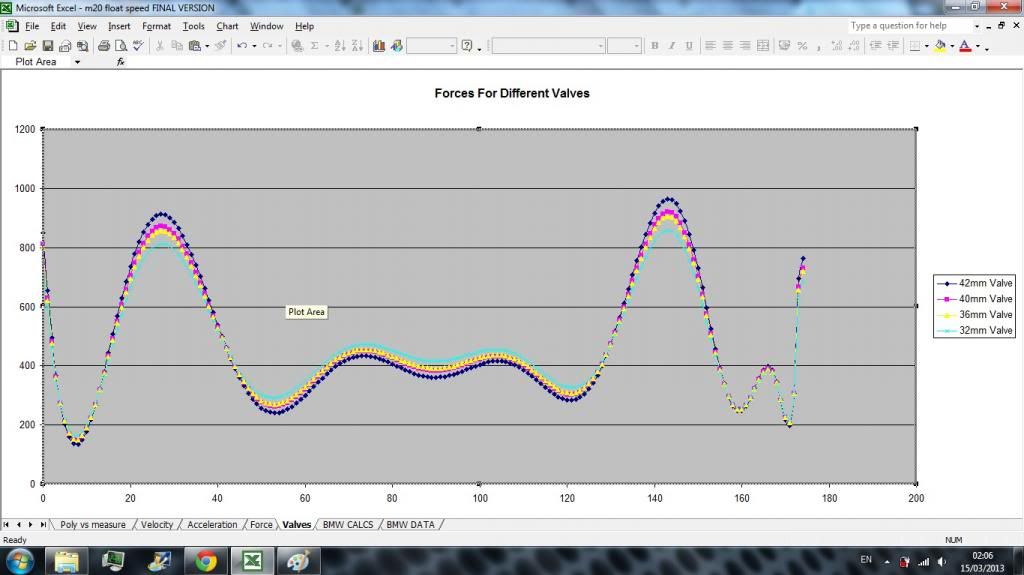

Latest flow graph is as follows:
That is still with a 42mm valve, port area has increased by about 1mm, however this can be reduced with epoxy work down to ~37mm diameter CSA with huge velocity (nearly sucked the dye up out of the pitot probe on the flow bench :mad: )
Have quite big hopes for this one with a larger valve, if it falls flat and dosen't make power then so be it but it will be a shame.

The green flow chart that you made.. Were the valves themselves standard sized? And the 45* angle is the sealing face, correct? A new set of standard valves (or oversized to same spec) should be alright to use, then, if the sealing face is left at the same angle.
I'm looking at doing a rotrex build, so the more flow, the better. Just need to research and see what, if any, oversized valves will fit with a 288 cam and my stack.
Only thing is, like you said, find somewhere that will cut the 30/45/75.
HairyScreech
Posts: 6265
Post Mon Nov 26, 2012 8:00 pm
So far all valves have been 42mm and 45 degree sealing faces.

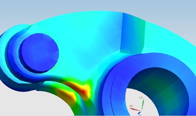

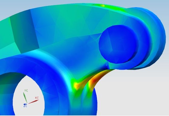

To keep this alive for now here are the FEA results from the rockers, This is the stress at 6000rpm and is clear indication of a fatigue problem rather than any kind of over stress or float issue.
Quite a hell of a stress concentration in the toe of that fork!

Post Tue Mar 12, 2013 10:58 pm
but is the stress higher on that point the oem's i mean thats only add 6k but what about you rev it till 7k or 8k will it break?

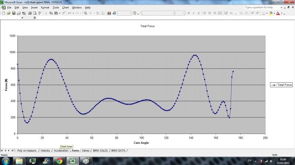

I will post a spread sheet at some point soon that calculates the valve velocity, acceleration and forces from the measured valve motion.
This lets you put in an engine rpm and draws a graph of the forces generated.
It can be used to predict the stress in the rockers and the speed that the valves float at.
It is not finished yet though.

So the rockers are potentially a weak spot then?

It's more an unfortunate consequence of the arch in the bottom of the fork of the rocker that allows it to clear the retainer.
It's kind of a design flaw but it's not really as they are fine in a standard engine and bmw had different goals.

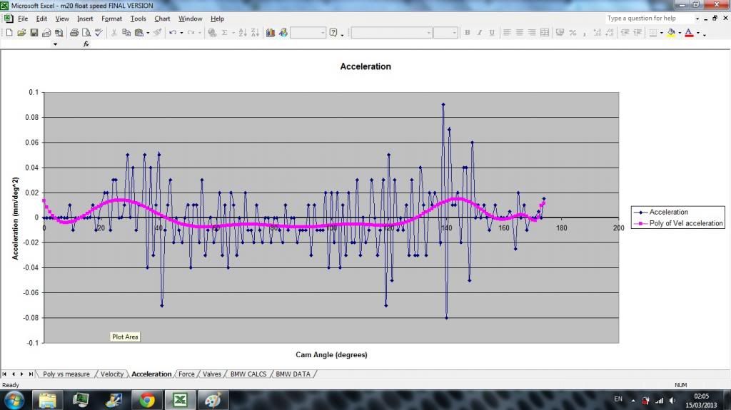

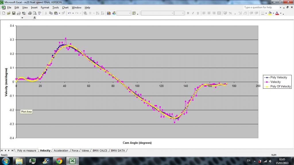

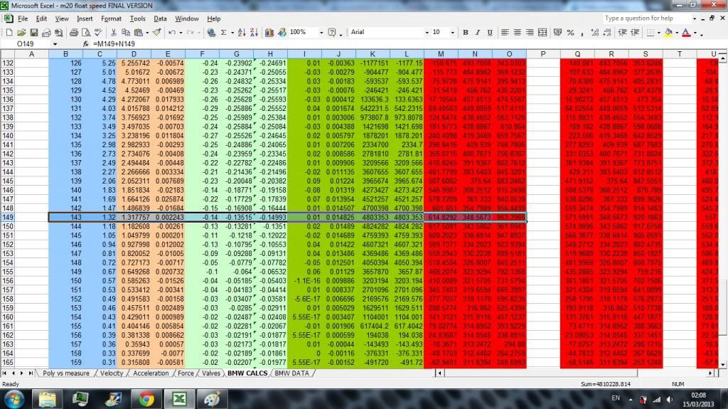

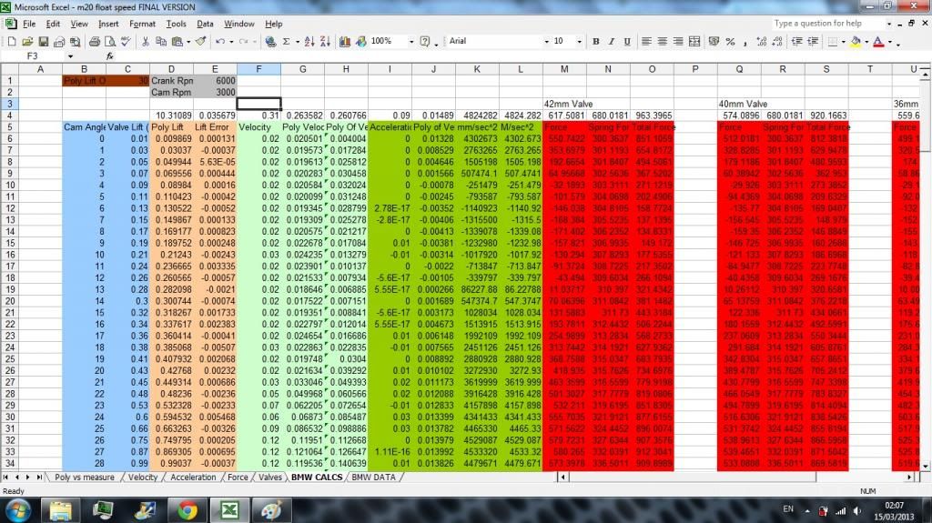

Oh yes, we are WELL in to high cycle fatigue.
We are talking about fatigue where it is all nearly unknown and materials start defying there trends.
The velocity etc profiles for the m20 map out kind of odd. They look wrong but the graphs actually do show the truth, the m20 curved rocker creates a strange valve motion.
Here are a couple of graphs from what I have:
The last one shows how valve mass effects things.
