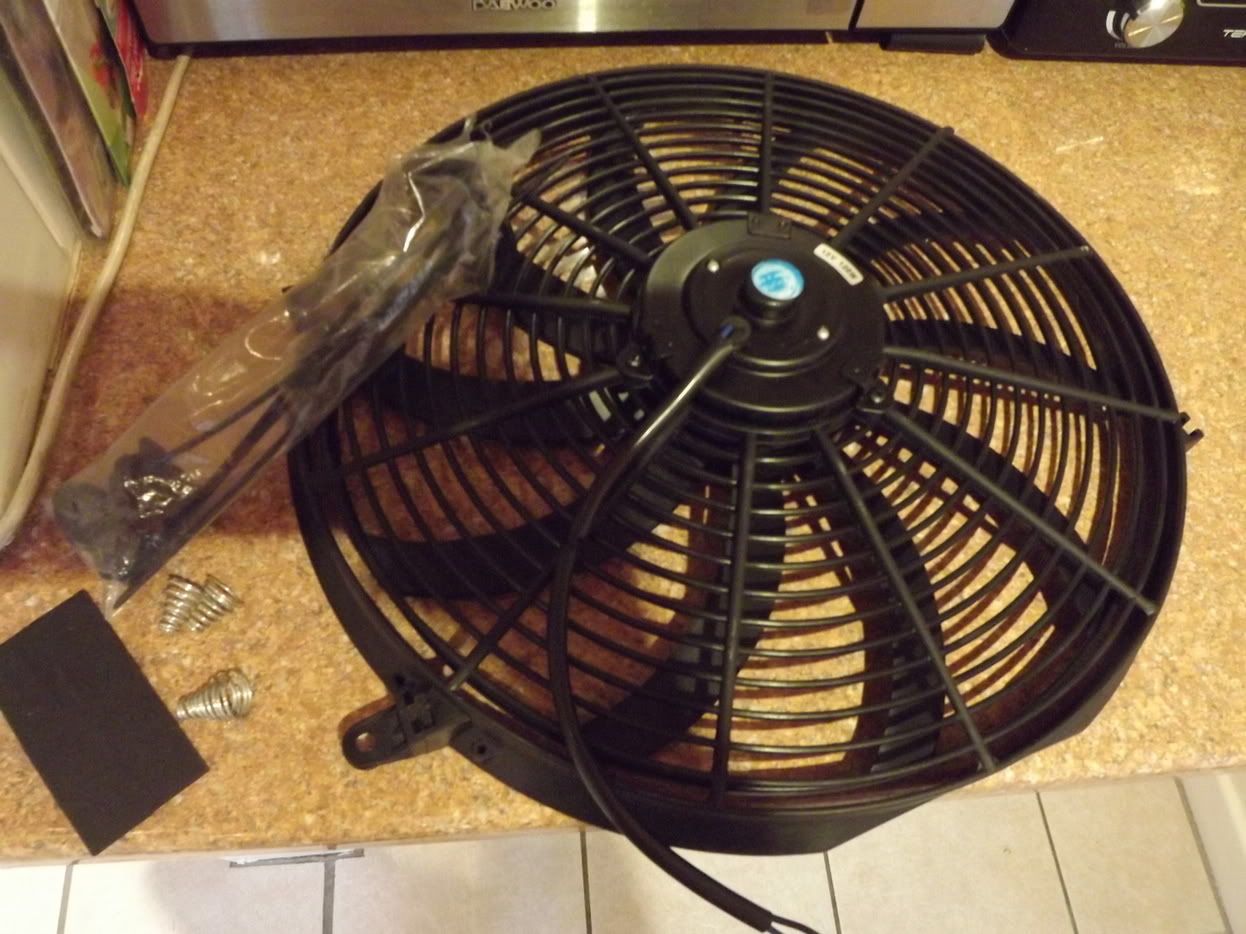

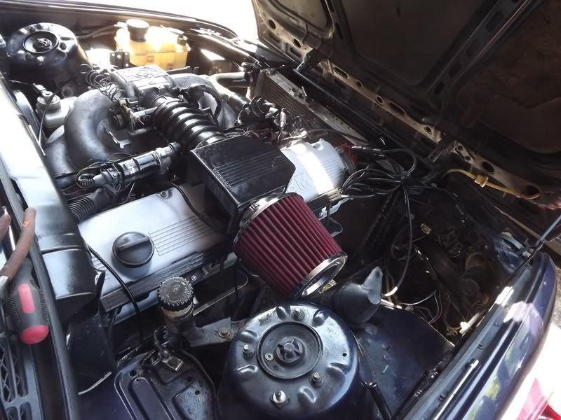

I also wired up the leccy fan to an aircon switch, ive got a dan the loom but didnt have instructions with me :o:
Ive put all the seats etc and tested all lights all seems ok, fitted old washer bottle for mot as i need a little bung for the 324td one as it has two places for the pump.
i also adjusted the TPS however, it seems to die slightly before reving when you are at idle and try to rev it.
Also whilst running at idle the temp guage was going to 3/4 it may have gone more if i left it but settled around there. this was with the fan on (yes its blowing in not sucking) :D

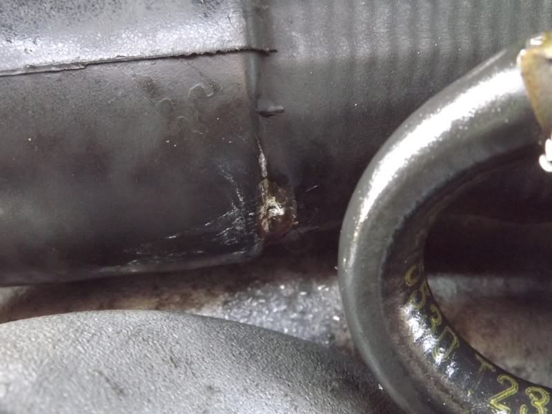

Prehaps the fact that the heater matrix isnt connected and the top hose has a slight leak wont be helping things aswell as it being 23 degrees

Leak on top hose

You need to get that top hose changed Alex it will fail big time at any moment, I wouldnt want it sat running on an MOT ramp like that! What temp rad switch do you have?
Sun May 27, 2012 10:02 pm
get that changed like Dan said.i'm checking when it's at york mind winkeye

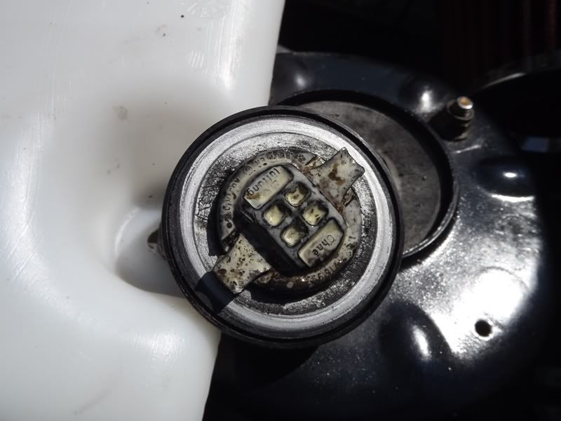

Popular thermostats for M30's are normally 80 degree, temp gauge should sit between quarter and half way if your saying its at 3/4 on the gauge with the fan running something aint right.
Is the system bled properly?
That mayo on the filler cap looks more like condensation to me, wipe it off and see how much comes back.

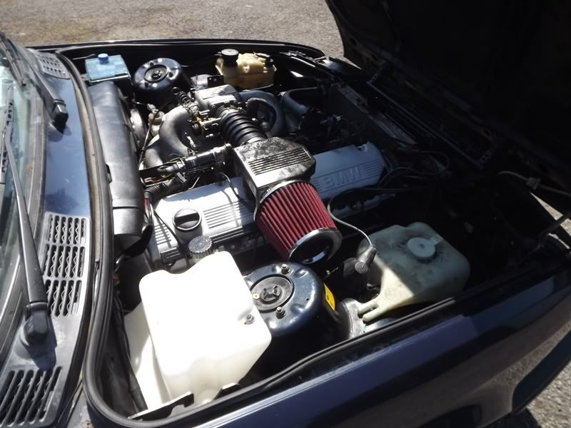

Good news you got it running though. 8) but what the fook is that induction set up your rockin. 8O
Mon May 28, 2012 12:14 am
leeparkes wrote:Good news you got it running though. 8) but what the fook is that induction set up your rockin. 8O
sucking up a lot of Hot air from the fannymold, redirect it towards the front Alex,

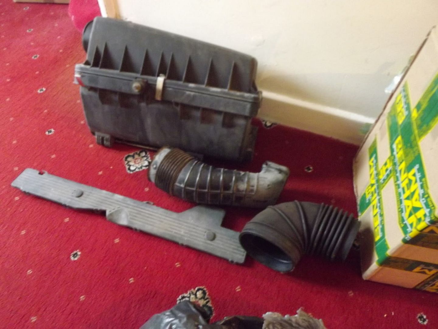

Dont worry i have an m30 airbox, injector loom cover and new hose coming from a friendly ebayer breaking a 735i
The Induction kit is temp incase the airbox doesnt come for mot time. Hose is coming tomorrow in post paid for super dooper royal mail extra special delivery
