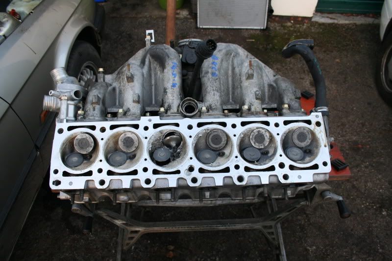

The bits have got into the other cylinders as they have been blown into the inlet manifold via the valveless No 3 inlet port.

Si there is no doubt there was contact, you can tell because all of the valves have a neat dark circle in the centre and i bet the diameter difference between the OD of the valve and the OD of the dark circles = the widest part of the valve relief on the piston.
The seats are not to blame here!

I bloody knew it would be a dropped valve. What a cuntage. That head might repair with TIG and some machining, but I'm not sure I'd trust it 100%. See if the lightly marked pistons will clean up - inspect them for cracks including the underside because they're tough old things. If they aren't cracked and the ring lands aren't pinching the rings, they should clean up and go again - dare I ask how much replacement slugs are?
Arev you going to repair it in situ or pull the donk?

fook thats a mess, sorry to see all that mate,
this is exactly why i never get seats and guides replaced............... you can never guarentee that the job will be any good. and theres aways the chance that it'll do this.
looks like the seat under the exhaust dropped, broke up then proceeded to distroy the inlet valve knocking that seat out when it snapped?
i know you think i'm a bodger, but to be honest, just clean any bers off of the pistons and run them again, it won't make any slight difference if any at all, bottom end is definitly salvagable.

Just to add, I bet if you popped the big end caps off you will see witness marks on the top cap with the valve hitting the piston.

There is no way the seats were at fault! You can clearly see there is no damage or wear on the valve to seat contact patch, forget the seats FFS, the inlet valve head broke off as it was being battered by the piston, the stem on the back of the inlet valve hit the inlet seat which shattered it and the pieces of the inlet seat pinged out the exhaust seat, and the rest is history.
If the seats on CYL 3 were to blame, why were all of the INLET clearances out after Simon got the engine running?!

If it was the seat dropping out there would be some big dents around the seat area as it would have to be broken up by the piston hitting the valve and squashing the seat against the head, chances of not breaking the valve in the process = 0.0%
The noise must have been the inlet valves getting bummed by the pistons

Agreed. There was valve to piston contact, one valve said 'f uck this', broke off and aided by the piston, chopped up the valve seat.Demlotcrew wrote:Si there is no doubt there was contact, you can tell because all of the valves have a neat dark circle in the centre and i bet the diameter difference between the OD of the valve and the OD of the dark circles = the widest part of the valve relief on the piston.

Are you saying that a seat is able to circumnavigate a valve head intact?Tay wrote:thats on hell of a seat mark on the piston!!!!
Where are the seat marks on the exhaust valve face then?
Forget it, the seat is not to blame!

o what i'm saying is inlet broke, and then knocked out the seat then samshed the other...... both are out

Im confused.Tay wrote:looks like the seat under the exhaust dropped, broke up then proceeded to distroy the inlet valve knocking that seat out when it snapped.
Tay
- Posts: 343
- Joined: Mon Feb 06, 2006 11:00 pm
one or tuther dropped but it may have been the inlet first???

Why do all the other valves appear to be seating correctly so arent bent and why do the pistons not show contact? for the engine to sound like a machine gun it needs some pretty good contact, same goes for a valve breaking.
Im betting if simon did a test on the remaining chambers in the head, those without seat damage from the bits of no3`s seat would still retain fluid showing straight valves.

As i said on the phone to Si, when he does the belt on the touring he needs to pull the cam sprocket off and see how many holes are in the end of the cam (which is the same schrick for those who didn't know).
If there is only one then why the f*ck is there two in the cam used on this engine and why was there a blind plug in the "correct" hole which needed to be pushed in or out to fit the cam sprocket?!
Be interesting to do a combustion chamber leak test with the head on the cylinders that still have valves intact to see if the valve to seat seal is any good. If the valves have hit then you would think that the seal would be poor.
Interesting that the compression test was good with the cam in the wrong position.
EIDT: Matt beat me to it with the leak check.

in answer to your question yes i do but i feel it i tried to explain it to you in even layman terms, you'd get confused even more than you are now! especially as both the seats are no longer in the head, and one valve is bust?
seat moves pushes valve into piston valve breaks, gets nipped under ex valve smashes ex seat bits knock out inlet seat complete???
considering someone told me i was wrong about the valve hiting with the cam 180 out when 1 and 6 lobes are exactly 180 oposite so turning 180 would do nothing appart from timing,
clearances way off? if they were loose then it would indicate the seat was pushing the valve or too tight showing the seat had bedded in more???
just a bit of a shame that alot of you are hobbie mechanics..........
