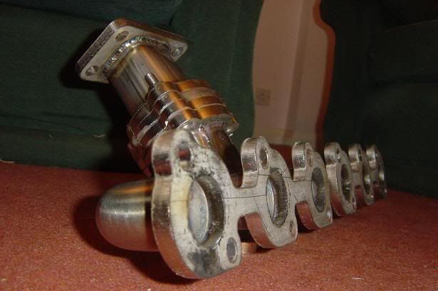

Turbo-Brown wrote:Yip doo!
More progress this weekend:
The turbos mounted on the tacked together manifold:

This one's quite a good piccy of the system as a whole.
You can see a large flap and actuator on the right hand side of the piccy in the air plumbing and also see how the small turbo draws all it's air through the large one.
Essentially, the large turbo lords it over the whole operation with all inlet air and exhaust gas going through it at some point.

The manifold's finished!
Just gotta leave it to settle for a couple of weeks and then take it to get skimmed.
Here's the finished article:

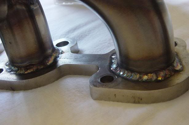

Some welds on the runners:
The T3 end of the mani:

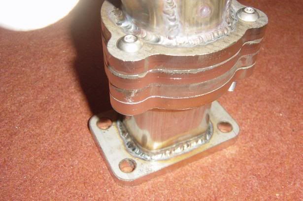

The T25 sized flange showing a tiny bit of the baffling. For anyone who's interested, the HX27 doesn't bolt straight onto a T25 pattern flange as the Garret hole's a little bit too big. That's why there's a load of weld around the hole, I needed to make up filler pieces so the holes matched.
Here's the whole thing from another angle:
And lastly, the welds I was most proud of....although that's not saying much :lol:

Excuse my thicko question but why use all those plates sandwhiched(sp?) together ?
Turbo-Brown
Boost Junkie
Posts: 4705
Joined: Tue Feb 15, 2005 11:00 pm
Location: Aldershot, Hants
Post Sun Jul 15, 2007 9:57 pm
Not a daft question at all dude!
Tow of the plates are welded to the mani and collector, and the middle two are going to form the bearings for the exhaust gas divertor butterfly.
I did have a thought about just welding two plates to the mani and machining them to accept the butterfly, but it occurs to me that the thing might get clagged up with soot etc so having a removable section was a good idea. Makes it easier to service and modify if needs be too.

Andy335Touring
Posts: 7144
Post Sun Jul 15, 2007 10:04 pm
I see now, like you say it might be handy to be able to split it all down because it's going to be a harsh environment for a bearing/pivot !
What sort of thing will survive the heat yet not leak exhaust gas ?
Turbo-Brown
Boost Junkie
Posts: 4705
Post Sun Jul 15, 2007 10:16 pm
Also a good question.
I'm going to go for a stainless steel spindle welded to a S/S buttefly. The far end of the spindle can be supported in a blind bearing (just a plain hole drilled on the split line of the plates but not all the way through) so that shouldn't leak.
The other end is gonna have a kind of labyrinth arrangement so there's a groove machined around that end of the spindle and a bit sticking out of the plates which locates in the groove. That gives the gas a couple of corners to turn before it can escape, plus a fairly tight clearance so it shouldn't be too bad......I hope anyway :D
