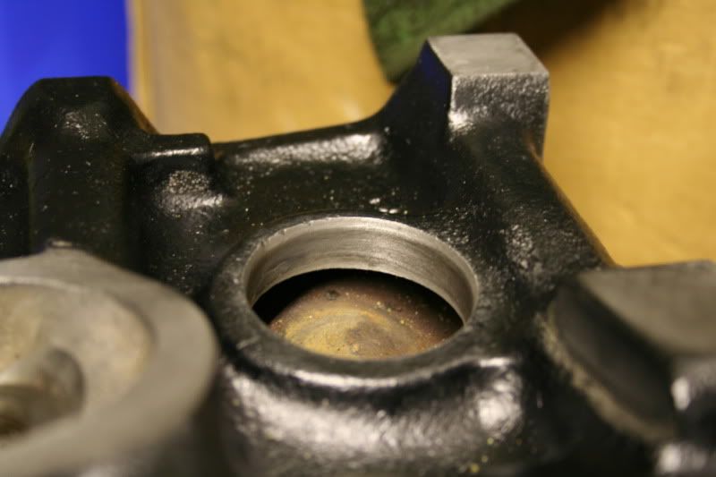

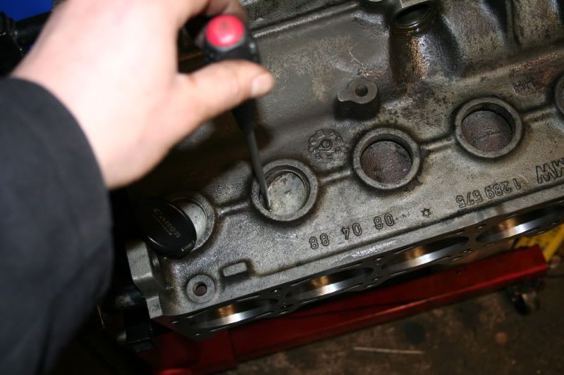

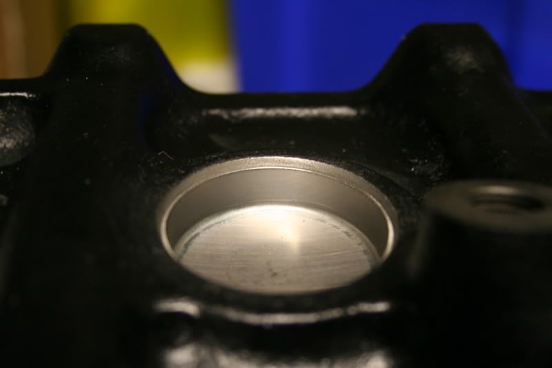

So carrying on with the block, i tickled the core plugs out. i had 11 news ones in a bag and i thought sod it. I'm gonna change out the old ones out and lie in my bed of it all f**ks up later down the line. So a slap with the 4 pounder and a 32mm socket to get the plug moving
Then punch one corner down with the flathead and the lump hammer. i was really scared of wacking the bores so punched the side of the plug down which was furthest from the bore. If you get me, then just levered them out with the screw driver. Took me a while to think of this after making a mess of getting the first one out!
3 out and getting into it
All 11 out and onto the next stage

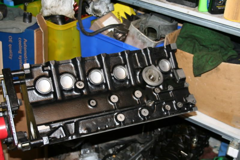

not rot/rust on the back of the plugs as you can see, just this thin layer of rusty sh!te. I said to barry the other day when he was over. This makes me suspect that due to the little amount of rust in the waterjacket areas that it was only recently before my onwership that some dickhead filled it with just water. My money is on the guy who runs a 24 recovery yard in Blandford Forum, Dorset where it spent 2 years sitting outside and being bodged up. Having spoke to him a few years ago and listened to the lies and drivel he told me thats my suspicions. Anyhow
I spent some time with some sand paper and emery cloth on the flat machined sections to get them shiney and nice. In fact alot of time enough to get sore fingers. its certainly easier to write about it than doing it! elbow grease and all that. I then gave the whole outside of the block a tickle some emery. Then washed it all down with a good douse of thinners a couple of times so we had some nice grease/sh!t free block sides for painting
Trevor put me onto this. I'm not going to lie i wasn't looking forward to all this as i'd never changed core plugs before or painted a block. I really didn't want to f**k it up not on this car at this stage in the game, but we have to learn somehow
On it went, it wasnt too runny but my paint brush could of been better to make the job easier! On this first coat must of taken about 30 mins per side.
So all painted, i did 3 coats, its quite thick paint so hopefully it will have adhered to block nicely and won't be coming off in 5 years. The last 2 coats were much easier and any over painted bits i just wiped down with thinners on the flat sections which shouldn't have paint.
Surprised myself on this and its turned out better than i thought, so i'm well pleased!

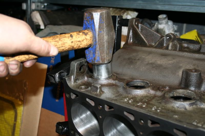

Big hammer and socket back out..........................
1 in and 10 to go, then a thought crossed my mind! How deep do you bang um in? And the socket was leaving a thin line in the plug.
Theres a green bit of cloth in 1 plug. I tried wrapping a rag round the socket then hitting it home, kind of worked until the socket cut through the cloth. opps should of guessed that!
You can see a slight chamfer (sp) on the lip of the plug hole. So my guess was to beat the plug down just past this to the flat section
Its quite hard to guess the depth on each one. You don't want to go too far but not far enough either. You don't want to hit the plugs in pissed either so 1 side is sticking in 5mm deeper was my guess!
Think i'm just about right comparing it to this 2.5 bottom end i've kept from the departed PYF.
All done. Seems simple enough but like everything on this project it took some time! i'd be quicker the next time round. So all in all i'm over the moon with it. To me it looks like something i'd of picked up from my main dealer after i'd ordered a brand new block and taken it hard for £2000 or something silly. i doubt i could of paid anyone to make it look any better than it is

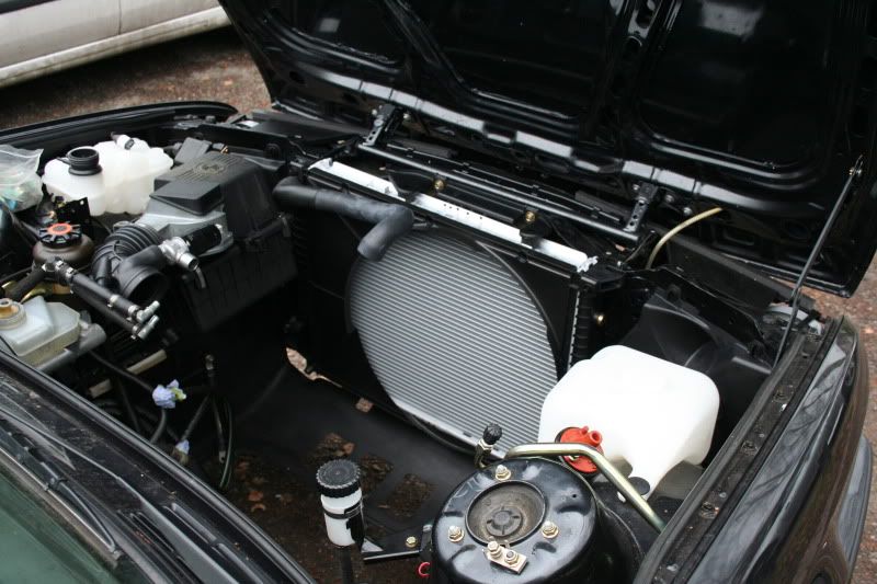

At last the proper rad in, i love euros. :?
Header tanked up, both pipes way too long. The over flow was 1 meter long! so i cut it in half. The other pipe which runs to the rad was also long. My guess is a tropical rad is 100mm or 4 inches wider than stock. So i cut off 100mm. New cap £11!!! joke. plus a level sensor from santa also. It dawned on me all this lot with the tank is about £100 all in 8O
this is where the overflow pipe pokes into the flitch. Little tip from Barry i never knew.

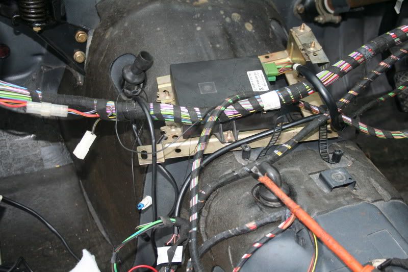

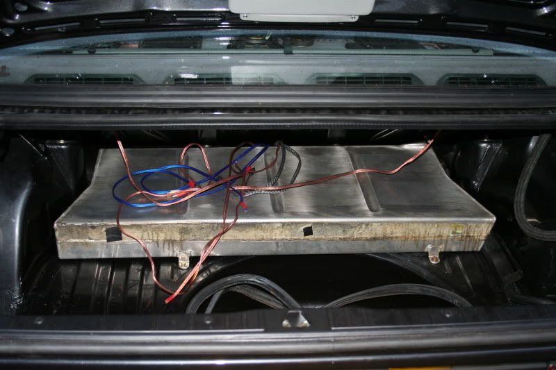

I've laid out all my ICE wires. So theres the speaker wires, 3 phonos, aerial lead and 2 wires for that, the remote thing and thats all i had on my little map. Just got to clip all the looms in and a little hover now. Ready for the sound deadening to go in the rear floor pans and then finally the epic moment of carpet fitting. Which lets be fair is a sh!t job.

When you lay any ICE wires, lay them at right angles to any other cabling for reduced crosstalk. It may mean your routing can't be all together and tidy but it will minimise interference.
Having said that, E30's are so crap acoustically that it's almost pointless.
Engine bay looks rad - is there anything better in the world than a minty engine bay and new rad?

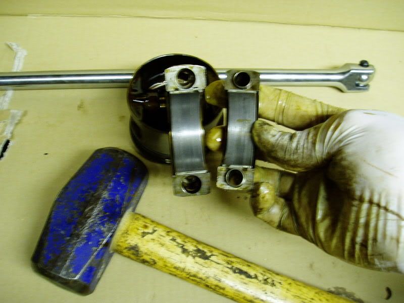

Then i thought right lets clean/give the journals on the crank a clean up. Build the rods with the shells, put the pins in the pistons etc. You know get it all ready to send it all off.
Heres what i wasn't expecting.......................being a warts and all resto so far we need to cover the bad and ugly along with the good.
Theres pitting in the main ends, you couldn't see it with the old oil all caked on. Moisture obviously got in when this bottom end sat outside before i bought it :? Now to be fair it would probably be ok, but we have come this far that it just won't do. So again the old mans opinion was seeked. The only way forward this far in to this engine is for a 10 thou regrind to +0.25mm main end shells. Which is a real f**king shame as i've got to cough for the stock main end shells i've bought already. Theres a lesson here clean the f**king journals up before splashing the cash :hammer: leave no stone unturned.
So then the suggestion from the old man, wheres the orginal crank gone? its in a plastic bag in the garage Dad. Bring it over! i said "its horrid and needs a regrind" "So does that now" was the reply. Back home then.
Its in this bag, next to some nice 2.5 cranks that don't need regrinds. If only..........
Thats what she looks like, i haven't looked at it since i stripped the donk, over 2 years ago. Its all scored on the mains and bigs look* ok. No woodruff key action though.
Nice shells, i've dug these up from when i stripped the donk down.
My dad is again of the opinion to work on the original like on the block. I can see his point so the mike came out again
We know it needs a grind on the mains, when measured to see they've worn down 3 to 3.5 thou on all off them. So a 10 thou regrind will sort that out and use +0.25mm shells like the other crank
Now the big ends looked ok, but are infact out of spec also :( they're all 1-2 thou out so the big ends need a regrind to +0.25mm shells there. Its strange here as there is only 1 size for each size on the big ends. Where as on the mains you have a choice of 3 colours in each size. Each colour is again another size with in again!
The two bits of sh!t together. Why do they have to be TD cranks?! rare as fook over here. I guess you learn from your mistakes. Right so the way it is is this. Both need a regrind on the mains. So i have to buy another set of plus size shells and the regrind, either way. Then here is the choice, go original and regrind the bigs and buy another set of shells and have a nice nose section RE woodruff key. Or stick with the other crank and save a bit with the big ends being ok and i've already bought those shells and have an unslighly nose section?! What does the forum think?
Anyone after some "white" main end shells?! What a nob, but hey ho

Post Sat Jan 08, 2011 9:44 pm
Oh c0ck. Measure twice, buy once ! :(
glenn
Engine Transplant Services
Posts: 2196
Post Sat Jan 08, 2011 9:46 pm
your too far in now si, i agree with your dad, and stick with the original crank.
in the total cost of the whole car, the extra is nothing.
Posts: 13595
Post Sat Jan 08, 2011 9:48 pm
sort the one with the good nose end, !
the H27 /td big ends I did last year had to be ground in Si , the oversize shells were not expensive at all, are the Mains fooked on em both ?
Posts: 24532
Post Sat Jan 08, 2011 9:55 pm
Bum!
Go with the original Simon.
beardymat
Posts: 1979
Post Sat Jan 08, 2011 9:57 pm
nice nose for me Si, its a no brainer really as saving money on this project is now an irrelevant action. Plus you get the satisfaction of knowing you have a fully fresh and true crank going in that truly astonishing block.
Keep up the good work.
Posts: 15841
Post Sat Jan 08, 2011 10:08 pm
I'd forgotten that crank had woddruff key action. Go wit the one with a good nose si.
