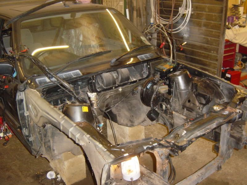

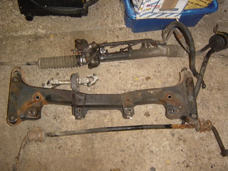

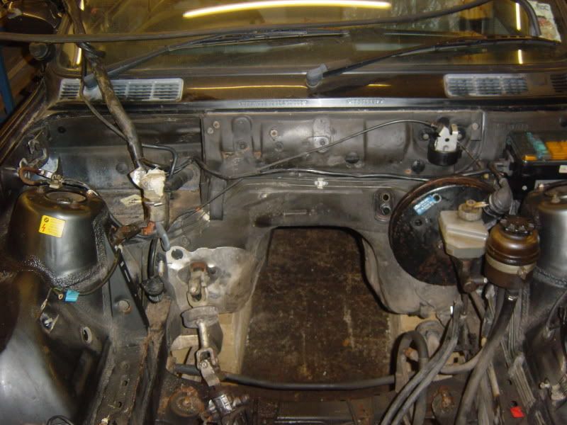

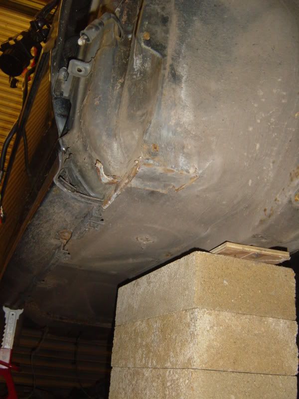

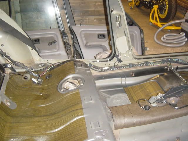

Today I pulled out the rest of the suspension, subframe, steering rack and mounts. Also went throught engine bay removing every clip, cable wrap, nut and bolt. I have a feeling me and RealOem are going to be very good friends soon trying to identify and replace all these nuts and bolts. These cars really are the nuts, out of all the bolts that I have removed to date, I have only had to cut one out with the die grinder.
Also removed the front panel and wings. Started to cut the spot welds so I can remove the inner front panel.

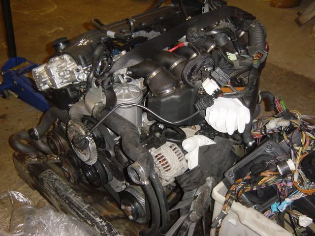

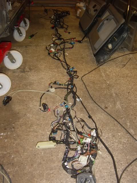

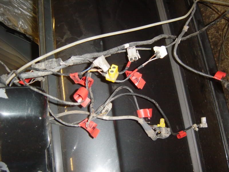

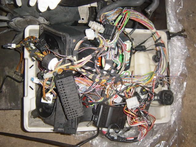

Before I get on with the rest of the pics, here's some wiring loom porn for Brian

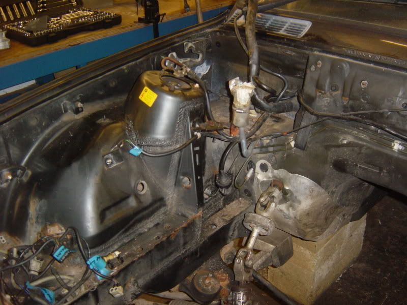

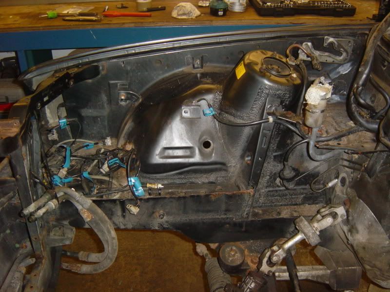

Engine bay, picture of drivers side inner wing around to passenger side:

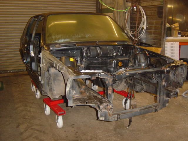

Jacking points and under side of the shell is in really good condition. Note my expensive Farmer style axle stands!
Old steering rack, subframe, ARB. Subframe going off to be powder coated on Monday.
Engine bay and front of chassis

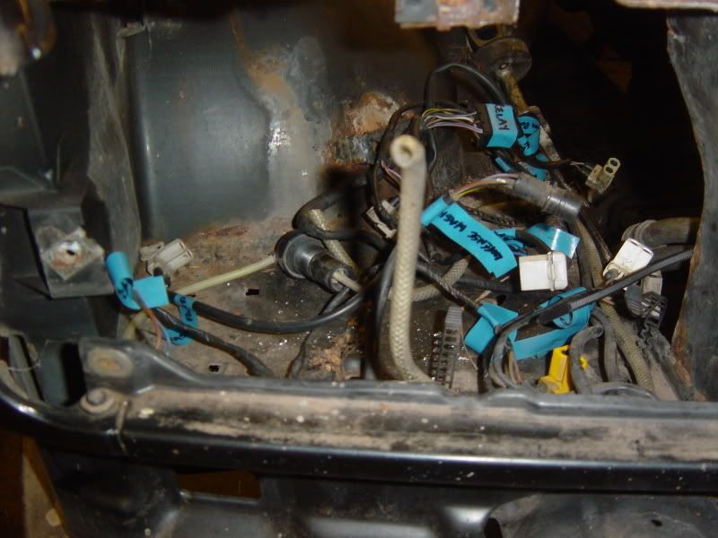

Everything labelled up, not taking any chances

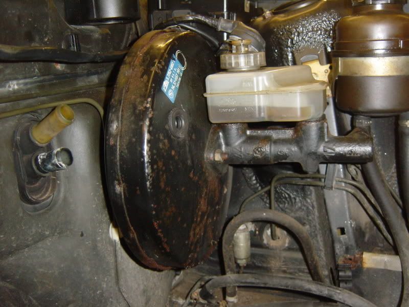

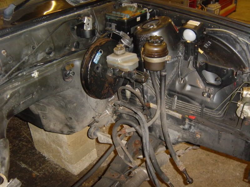

Master cylinder and servo, soon to leave the building for a more "compact" unit to make room for the S50 plenum.

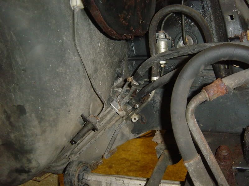

Here's where the steel fuel lines enter the engine bay from the rear, note three pipes, fuel flow, fuel return, fuel vent.

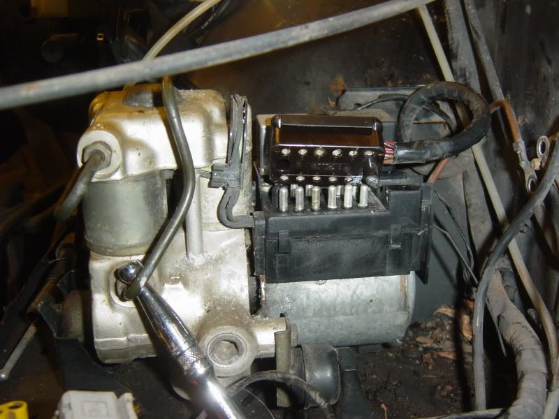

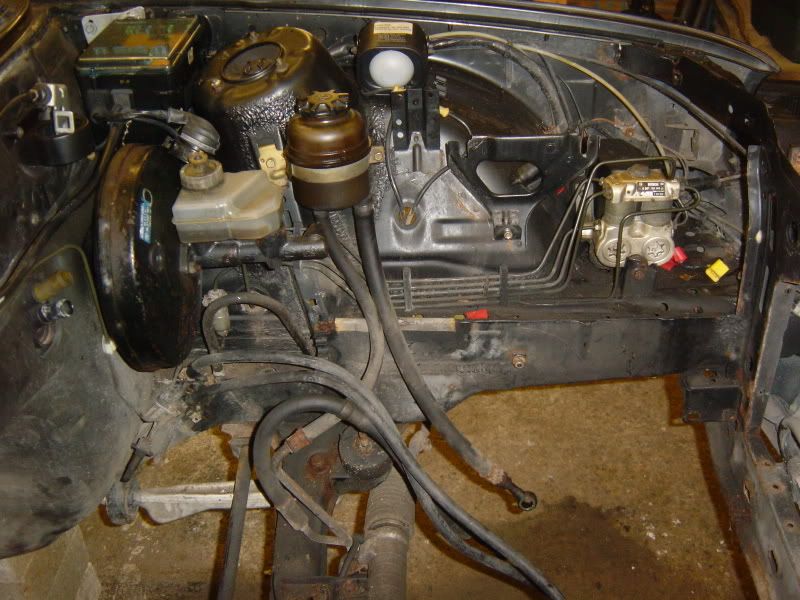

ABS unit, I'm considering junking the ABS altogether, I never have found it to be very effective to be honest. This would simplify the engine bay and save a lot of pipe making as well. One important note, I found some corrosion on the loom plug where it enters the unit. This would be the first place to look in the event of an ABS problem in my opinion.

Nice work! the ABS unit can be flipped to the underside of the inner wing if you need the room in the engine bay...
PM for details

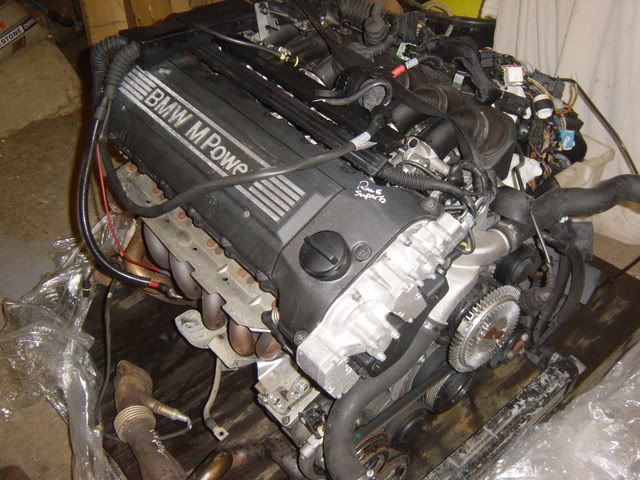

Well, just a quickie.
The S50B32 is being delivered on Friday, just in time for Christmas
Managed to find a 60,000 mile engine from a 1999 M3 EVO cab that had been rear ended - with full BMW history.
Got the M3 gearbox - 5 speed and rad, E46 rack etc.
Also got hold of the M50 sump, dipstick tube and oil pickup (after much fighting with it)with much help from WillG today. Cheers Will
Many thanks guys for the egging on, I'm hoping the interior and loom will be coming out tomorrow and the rest of the ABS which is going in the bin.
Then it's time to get down and dirty with some gritblasting.
I'll post more pics tomorrow night.

OK, here goes. It's been a busy week on the Touring.
Stripping to a bare shell took a lot longer than I thought but hopefully I have done it in a way in which I can understand how to put it back together. I have also taken the opportunity to make notes and look up replacement part numbers as I go.
As I have now delved into the deepest reaches of the car I am surprised at what good condition it is in overall. I have found no rust whatsoever even the floorpan is like new.

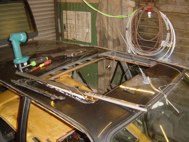

The hardest part of the entire job so far has got to be removing the sunroof assembly without wrecking it. The headlining is reasonably easily but once you've got it out and understand it it's easy really. Once I had the sunroof stripped out I rebuilt it and dismantled it twice just to understand how it all worked. If I can remeber all of that in a few months time it'll be a miracle!
In order to get the fusebox out of the engine bay the whole loom has to be pulled through the firewall grommet hole. That means accessing and unclipping every part of the wiring. Not a five minute job. There may be those who might say why not cut the loom, not for me.
There is still a little way to go, I have to remove the fuel tank and pipework, rear quarter glass, windscreen and rear screen. Then just strip the doors down.
I've already done away with the ABS and am looking forward to picking through the wiring loom, all 23ft of it, and removing the ABS section. The brake servo is out and I have been looking into the difficulties in elongating the mechanism and moving the servo mount over. Doesn't look too bad a job to be honest. I didn't realise that the braking rod is a push/pull type, so making it longer shouldn't effect the throw and leverage.
It's amazing how much room the parts can take up once they are removed, I have a working area five times bigger than the car and even with that much space it's driving me mad. How people can do this on their drive
Anyhow, I haven't posted any pics for a while although I have taken over 300 so far. So here are a few taken tonight.
Shell sat on dollies. I bought the dollies from Machine mart and custom made a jig to locate into the jacking points with some mild steel and my trusy MIG
Now the shell sits level and I can roll it around wherever I want. Also, because the shell is at a good height, much of the reassembly can be done leaving them in place.

Random picture of the floorpan and wiring

Hmmm, 3.2ltr of goodness
