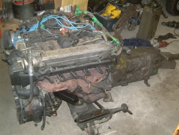

just a couple more pics for your enjoyment.
engine gets lifted in and out on the crossmember.
had an adapter made up on a cnc machine with an interference fit, to mate the e30 prop up to the v12 box.

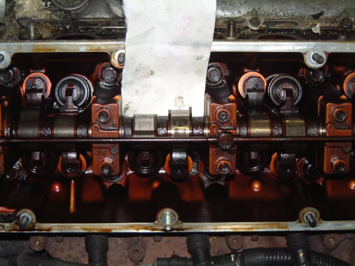

Post Tue Mar 07, 2006 9:01 pm
took off the inlet manifold gaskets this evening, as dips wanted them changed.
the job is up there, ranking as one of the toughest jobs we've encountered.
there's a row of 10mm bolts on the bottom half of each manifold that were bast**ds to get out, and they've got to go back in yet!
whilst we had them off, we removed the rocker cover's to investigate a 'tapping' from the rockers, and found two lobes of one cam were shot

Never seen one as bad as that !
good job you had a look M8, isnt that intake a cnut to remove, ive done one in situ and my back still hurts :lol:
loving the Y piece coolant manifolds too, they just love too weep @ the O rings :mad:

That cam.......Ouch !
That will be a few quid to put right in parts alone, 2 cams and 24 rockers ! $$$$$
Would the cam from the 850CSI be an upgrade ?
glenn
Engine Transplant Services
Posts: 2196
Post Tue Mar 07, 2006 10:30 pm
my etk shows different part numbers for the 850csi m70 /750il
just had a look at the ecp website, one cam is over Ԛ£700 :eek: the other is over Ԛ£400 :eek: . rockers just under Ԛ£10

the rockers and follower are cheap as they are m40 items the dissy cap is m20 and the cams :cheese: :cheese: going to see if sal can get some after market ones

There is a special tool to get the inlet manifold nuts on and off. It is like a 1/4 drive long extention with a 10mm socket blended into the bar which is magnetic. Also dont forget to replace the gasket ontop of the block between the valleys while its apart.
M5pilot
Posts: 4968
Location: Luton
Post Wed Mar 08, 2006 9:36 am
Been searching for After Market ones and havent come accross anything yet.
Did look into Alpina Cams but they wont deal with me without a Chassis number and Car number.
Spoke to Kent Cams and they may be able to reprofile it - Glenn - can it be dont in the state its in? If its saveable then your looking around Ԛ£300 for a reprofile.
850 cams- Ԛ£1400 roughly.
If aftermarket ones arent available then its a case of going to the scrappies and finding a good set which I doubt will be easy.

If you want a custom regrind go to newman cams, dave some BMW stuff he does not list on his catalouge, the has m20 blanks. I wonder how close these are to the v12 as i think the block archtecture is based on the m50 witch means the bore spacing may be clsoe to the m20.

I might be able to get some Hartge 268 cams.
Ԛ£1400 for the pair.

http://www.kormanfastbmw.com/schrick.htm
seem to have shrick m70 cams
im sure Sal can get a better price on them!

yes got some cams at last :P :P
