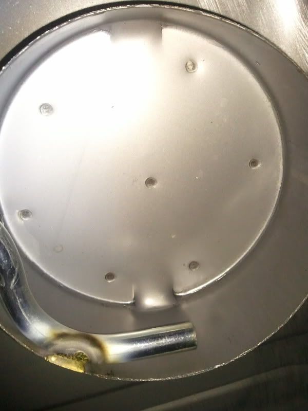

Dan, i'll try measuring the pots original and new tank and let you know, along with comparative pics!

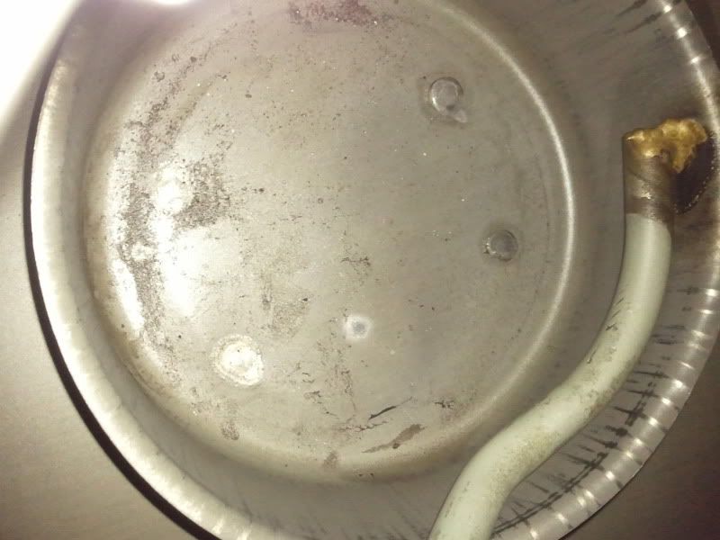

Got a pic of the to swirl pots, the first is the ECP tank and looks the same as your GSF one. They seem about the same depth but the ECP pot looks a lot bigger so that might be the issue!?

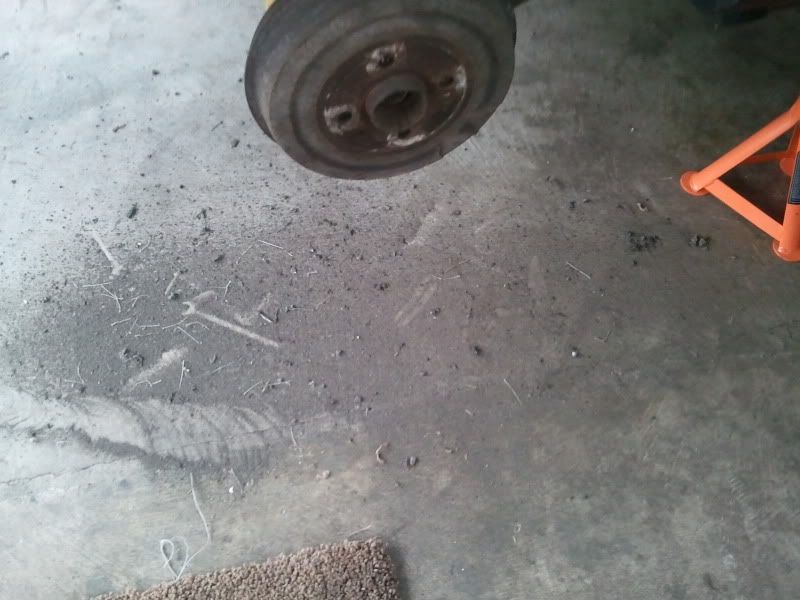

Spent a couple of hours removing the diff, ARB, fuel filler neck and gave everything else a good squirt of WD to hopfully make live a bit easier.
26 years worth of crud from above the fuel venting system, could've been worse i guess

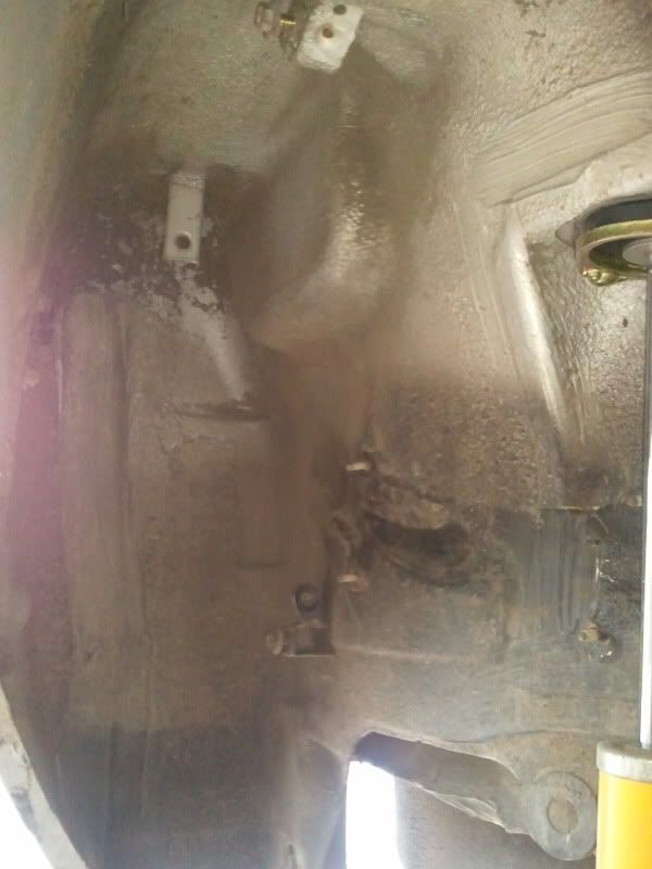

Now for a few more pics of underneath and the arches.
Given it all a clean up since and nothing more has become apparent other than a few bits of surface rust around a few threads, by the brackets and a few under the floor. Going to blast these areas with a grinder and wire brush back to bare metal and then treat them with something. Once that's done what do you guys recommend painting everything with? Somekind of underseal followed by a coat of waxoyl or just straight in with the waxoyl?

There are a couple of bits that do need taking back Dan, small bit on the back of the wheel well plus a bit in this pic by the rear valance/chasis rail;
