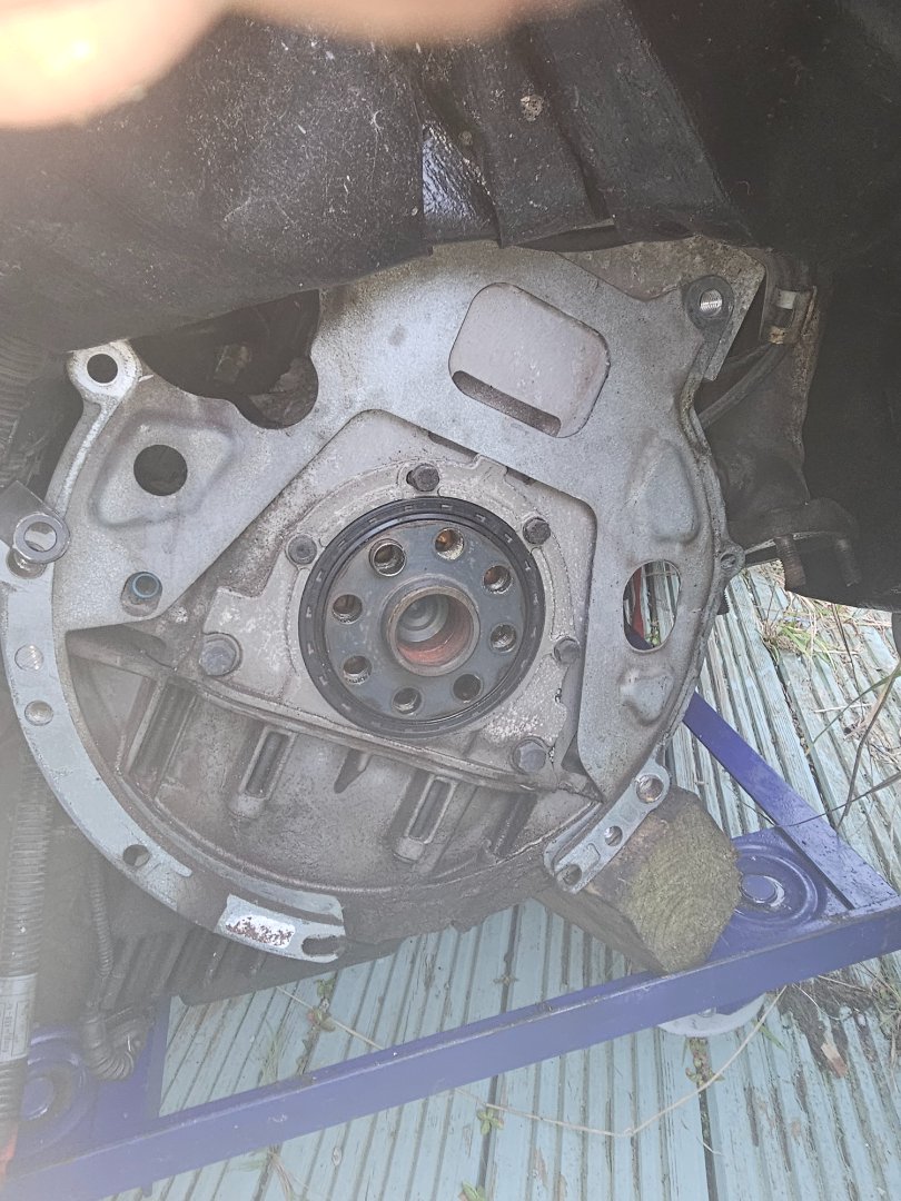

I have managed to remove my e39 engine and auto gearbox, I am getting ready to fit a 2.8 clutch kit to my 2L gearbox but there is a metal plate I am unsure if I need to keep it or change it to fit my manual gearbox can anybody advise me please
Wed Oct 16, 2024 6:42 pm
Plate needs to stay fitted yes
