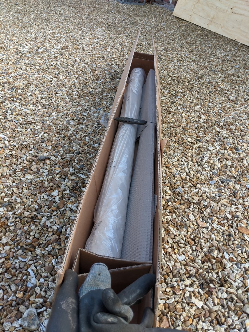

For any one interested, this is what part number 51951924961 looks like.
The roll is quite heavy and seems like there is plenty for my more door
- Part Number: 51951924961

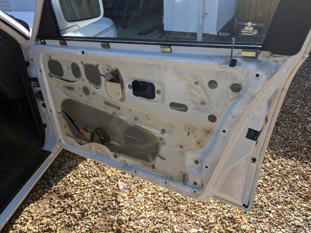

30 year old membrane on a garaged only E30. Condition is much better than expected and the membrane gave quite a fight when I tried to remove it.
Got to use my new trim removal tools for this job. Worked a treat - didn't break any clips or damage the paint either the door card or the paint on the door.
- 30 year old waterproof membrane.

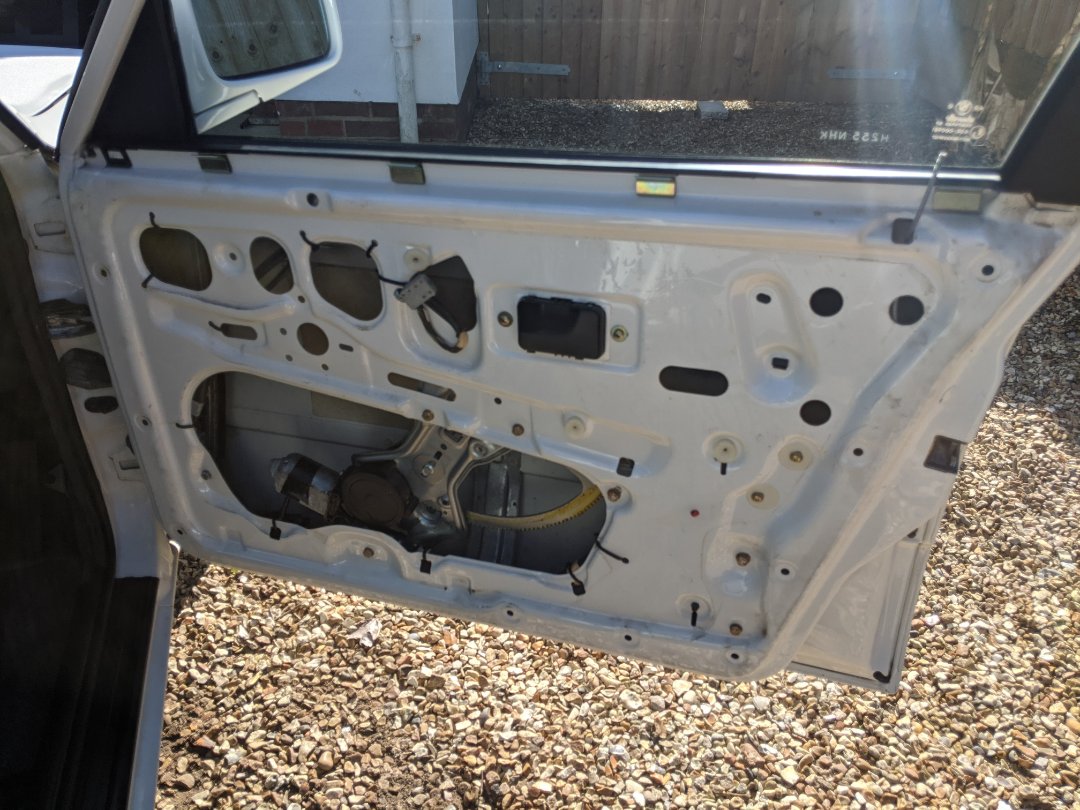

With membrane removed. The window mechanism is quite impressively over-engineered.
- Door with waterproof membrane removed.

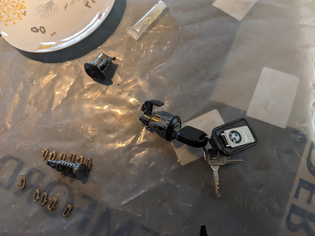

I did however get around to using my lock rebuild kit I purchased 6 months ago... Very impressed with the updated design. Lock actual works now and have ordered a new one for the other side too.
- Door lock rebuild kit.
