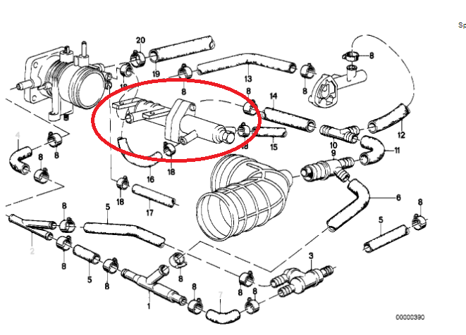

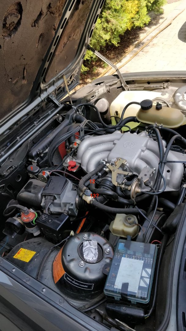

In the place where is No. 12, I have two inputs as you can see in the picture, first goes to the collector and the second to the throttle. Also, the pipes that come from No. 7 are connected together, don't know why. I check the rest tomorrow.
- Attachments
No 7 is your air valve slide.
On mine 11b is connected direct to the Manifold, missing out 8 and 8 has a loop of pipe just closing it off. It has made no difference to mine whatsoever.

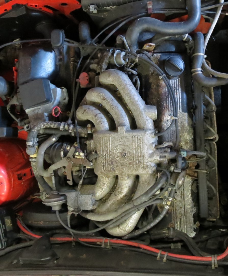

Here is a pic of mine as it sits now (don't laugh) but it shows where things are connected (under the bonnet foam debris.)
It is the first of the 150bhp models so there are differences
But this is why this engine will be kept for posterity and a the next one will run on motronic
I have had enough Jetronic fun and games years ago
Top marks for getting it looking so good though
In you picture websky, number 1 is just a fuel damper to reduces the impulses from the fuel pump. They are not necessary as mine is without one there.
As I said on mine, number 8 is there but not piped up, just looped round.
On the attached photo you can see my number 1 from the diagram and my number 8 from the diagram and the hose that loops from number 8. So no it is not a necessity as number 1 is.
The air valve you said just had a loop of pipe instead of piped correctly - have you sorted that now?

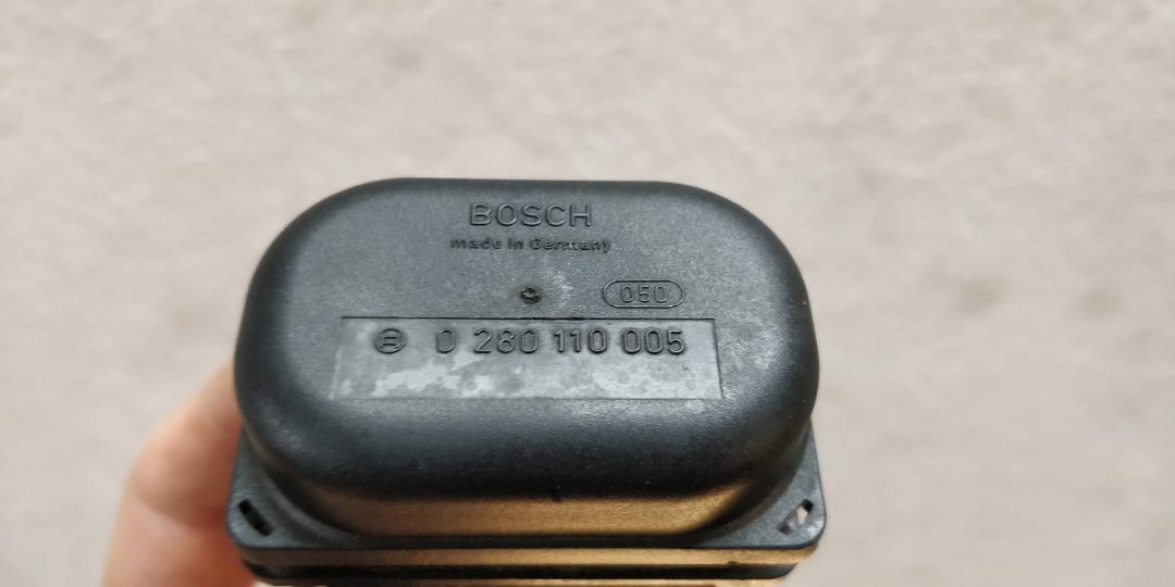

I replaced ECU with another one and the problem with low RPM is gone. Now the power is back. All other parts are ok.

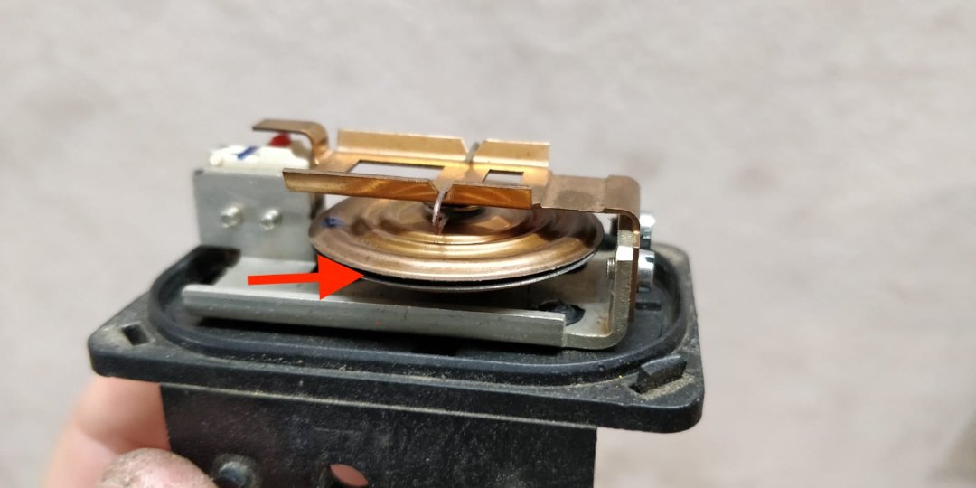

But it seems that this little peace is broken, can someone tell me if this needs to be closed/glue together? Looks like it was soldered.
- Attachments
Hi, I have a 1983 323i.
I just fixed that switch a few days ago, both plates are soldered indeed, however I did not attemp to resolder them because I was afraid to drop material inside the plate, also it was half opened. First I cleaned thoroughly the inside of the diaphragm from the opened area and from the hose fitting end then I sealed it with loctite 5699 very carefully, precisely and just enough to join the matting faces, waited a few hours and slight recoated the edge to ensure the job, then waited 24 hours to meet/exceed the curating time. (Be careful not to spill sealant or bridge it to near surfaces)
I also had to change a small resistance beneath the micro switch connectors so check continuity to ensure the proper functionality of this piece.
There are three plastic anchoring points which tend to break so be careful, otherwise you'll have to cold weld(there's too little room for rivets or screws) the plate as I had to.
As in this unit there is only suction I consider there is no need for hard glues or welds, just a sealed and flexible union to ensure vacuum effect.
I tested the job on a straight 6 hour journey between 3k and 4k rpm and no problems at all. Also noticed a little extra pull at full throttle.
Hope this hint helped.
By the way, re seal the plastic case to ensure water proofing, black loctite SI 593 did the job for me with aesthetic results. You may also secure the job with small plastic wire ties, there are slots at each corner of the case that have enough room for them.
