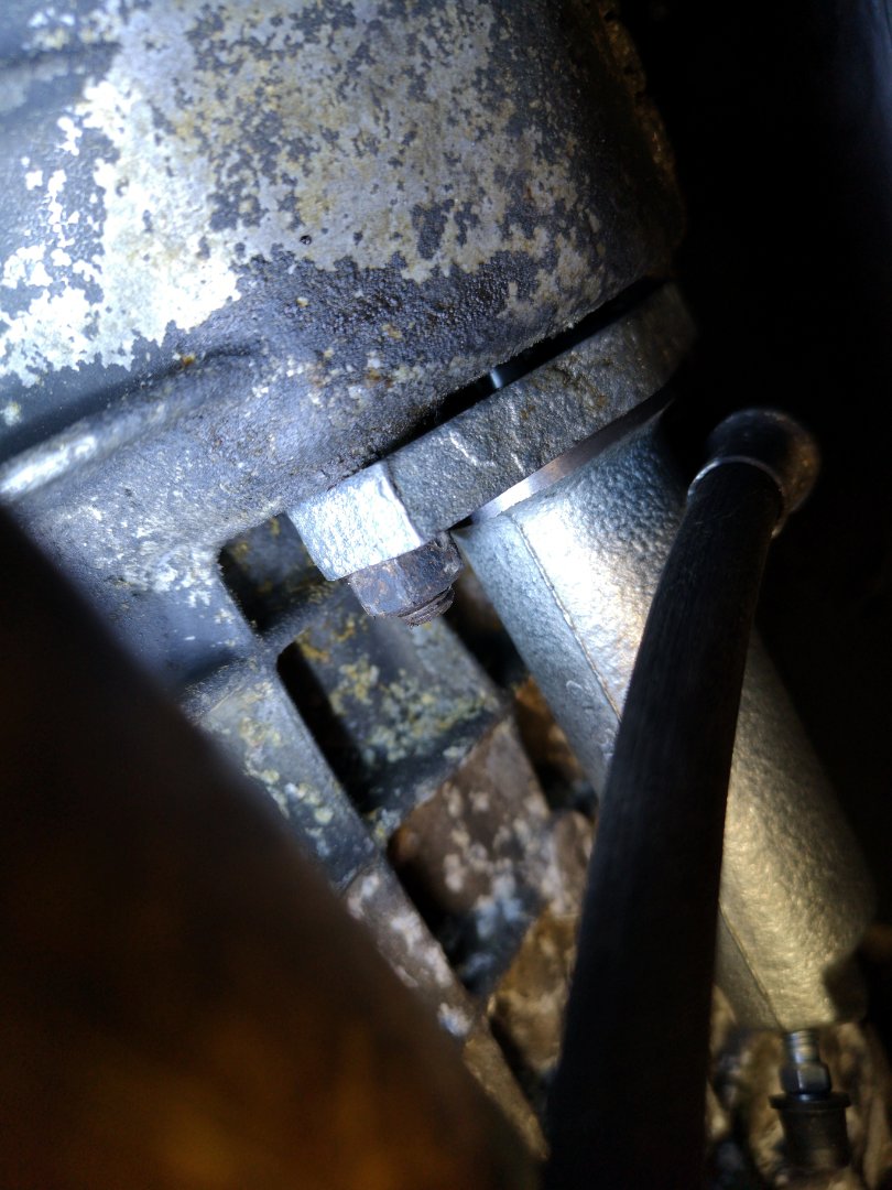

I've just looked under and can see fluid under the front of the gear box housing.
How about bleeding the system?
Is this easy?

Sounds like the slave cylinder has developed a leak. Yes, you could try bleeding it, and you may get lucky and be OK for a while.
Bleeding is fairly straightforward - pretty similar to doing a single brake caliper/drum bleed. Even easier if you use a Gunsons Eesibleed or similar.

Okay, so far......
BnB components, slave and master cylinder for £45
There's a wiki page for replacing the slave cylinder, which seems straight forward...ish.
But not one for the master cylinder, which is the behind the pedal....any advice?
Its a 1991 316i
Ta

Master cylinder is more difficult as you have to contort yourself in under the pedal to remove the bolts--better taking out the drivers seat. You don't necessarily have to do both at the same time although it's recommended. You have an immediate slave cylinder problem and your master cylinder may well last for years yet. Here is a YouTube video on the master cylinder--poor camera work but can be followed.

no need to take the drivers seat out, just push it right back,
also make sure you have a selection of extensions & deep sockets to hand,
& be prepared for a fight with the little plastic elbow that goes into the master from the hose from fluid reservoir as they can get very stuck.

So slave cylinder out, new one in..... However there's a gap between the cylinder and where it attaches to the gearbox, pic below.
Should there be a gap???
You can just see the silver rod between the gap!

I never saw it under the car so can't confirm. Did the new part match up to the old one?

Looks gapped on the Zone guide too:
https://www.e30zone.net/e30wiki/index.p ... _Cylinders
