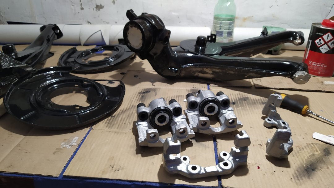

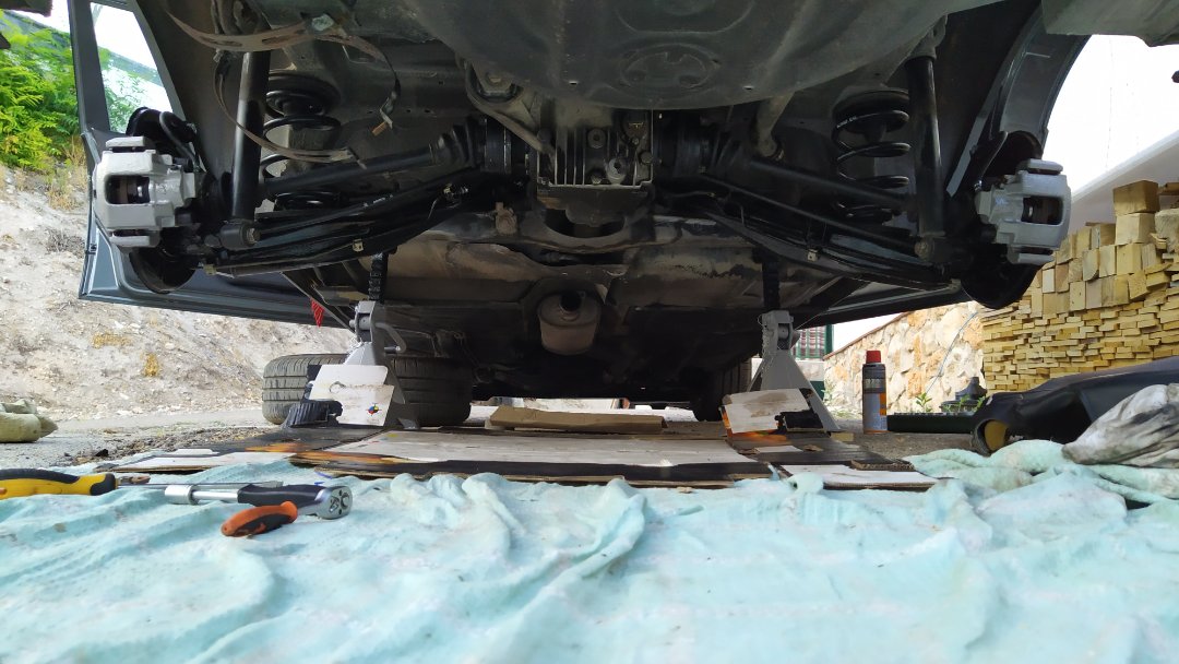

Hey, I also have an 316 and the only difference with an 325 is that the 316 does not have rear sway bar, and about the brakes; 316 have non ventilated front discs and rear drums.
Now I have on my 316 the trailing arms with the rear disk brakes from an 325i, and I am looking for a rear sway bar.
Also, I would like to put a good m20b25. So, if you can put an M20 or M50 in it! :banana:
Nice one man, looks nice. Well done.
