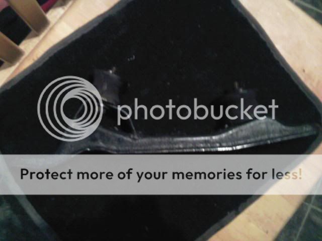

Fri Aug 23, 2013 11:13 pm
pull the 4-pot box out attached to the engine and re-do it with a 6-pot box and bolt on suited prop...ie 320i prop for 320i box job jobbed .don't forget the suited gear selector on your shopping list .
Fri Aug 23, 2013 11:22 pm
or you could bosh it...
and the gear linkage ....

SAS325i
Posts: 6
Joined: Tue Aug 13, 2013 11:00 pm
Tue Aug 27, 2013 8:21 pm
magpie wrote:or you could bosh it...
Mate thanks for these pic's, given my budget and the availability of 325i or 320i boxes looks like my only option at present is to do the botch job....
I feel like a dummy asking this question (after all you have sent a photo) but if I look at your mod to the g/box mounting it looks like it would add to my current problem.
To try and explain I will refer to passenger side and drivers side of my right hand drive E30
Look up at the gearbox from the rear of the car the g//box is tilted slightly of center to the passenger side of the car. ( I read somewhere it is 3 degrees to the left of center)
So when I bolt the mount to the box the drivers side of the mount is touching the floor of the car while the passenger side has a massive gap between it and the floor.
Are there any other mods or brackets I need to make it all line up.
On the gear linkage side of thing I do have both linkages from an original 325 manuel so the lenght is correct but do I still need to bend them to allow for the tilt to the passenger side ??
