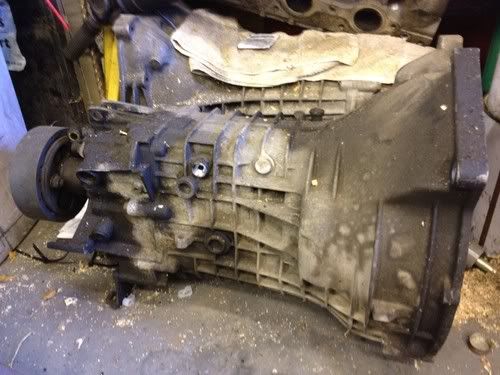

If anyone wants the old E30 M42 box (it jumps out of 4th occasionally when changing down from 5th at 80 mph)
£5 Collection Only SE24 London. (p.m please)
I have no use for it except for an autopsy
