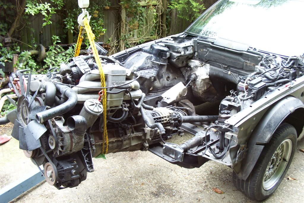

Me. I had a 2.5. Bought all the things needed for a 2.7. didn't even get close to doing anything like that. Bought a 3.5 M30 after going for a spin inSpadges one, swapped that in but had trouble keeping uo with a tuned M20, so out it came and the M60 went in. I don't kmnow if I'd swap it out again, probably for a 4.6 if it blew. but that's if and when. If it goes bang when it's back in Oz, I see a nice LS2 can be had for about 750gbp, so that might find it's way in!
