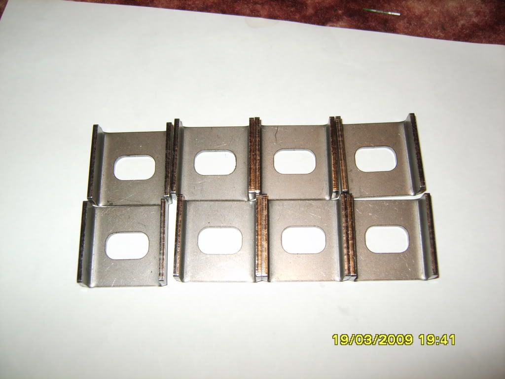

As there's an issue with the one's sent to Danthe,I've just double checked the one's that were sent to me.
The ones sent to me.
And the ones in the post/I.E site.
The ones i've got appear to be the correct ones.

DRIFTBOY wrote:They look rather simple, how the feck did an engineering company get those wrong?BadDave wrote:![]()
Just a guess, but i reckon they folded the wrong 2 edges meaning the slotted holes ran parallel to the raised edges.

Well, if you try a bolt into them Dave you will realise they have been made wrong! The edges should not be folded, the piece should be made from 8mm flat bar, they should be milled, the folded edge creates a radius which stops the bolt dropping all the way in, ive exchanged a few pm's with Jhonno about it and it seems he has filed down the edges of the bolts/washers so they fit flush, I dont like the idea of this as apart from the amount of money the firm has had out of this group buy the folded edge is much thinner and with a weld on the back of it its likely to distort, if they are making them again im up for returning these

A milled 90deg edge would indeed be better than the current folded edge.
Jhonno did mention that there would be a little tweak required to make it work as it should.
A proper milled set of tabs would be the preferred option, however, as they've mucked up 2 batches already, there's probably little chance of them doing a milled batch.

This is the trouble! I shall speak to them and see if they have started the new batch, if not then I will ask them to mill them.BadDave wrote:A milled 90deg edge would indeed be better than the current folded edge.
I have no idea why they folded them tbh!
The 'wrong' ones they did with the slot parallel to the lip as has been said! I get the feeling I am not their favourite person, as they seem to be blaming me for the error, when I have only ever given them 1 drawing and a even the above picture of what they should look like

Sorry if you boys think im being fussy, but if they are being arsey ive no problem having my money back, and TBH id rather that than these folded tabs
