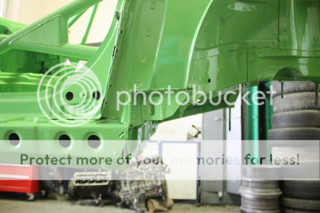

The works:
fitting the rear suspension...
The engine is mounted directly on the chassis
GREEN!! :D
