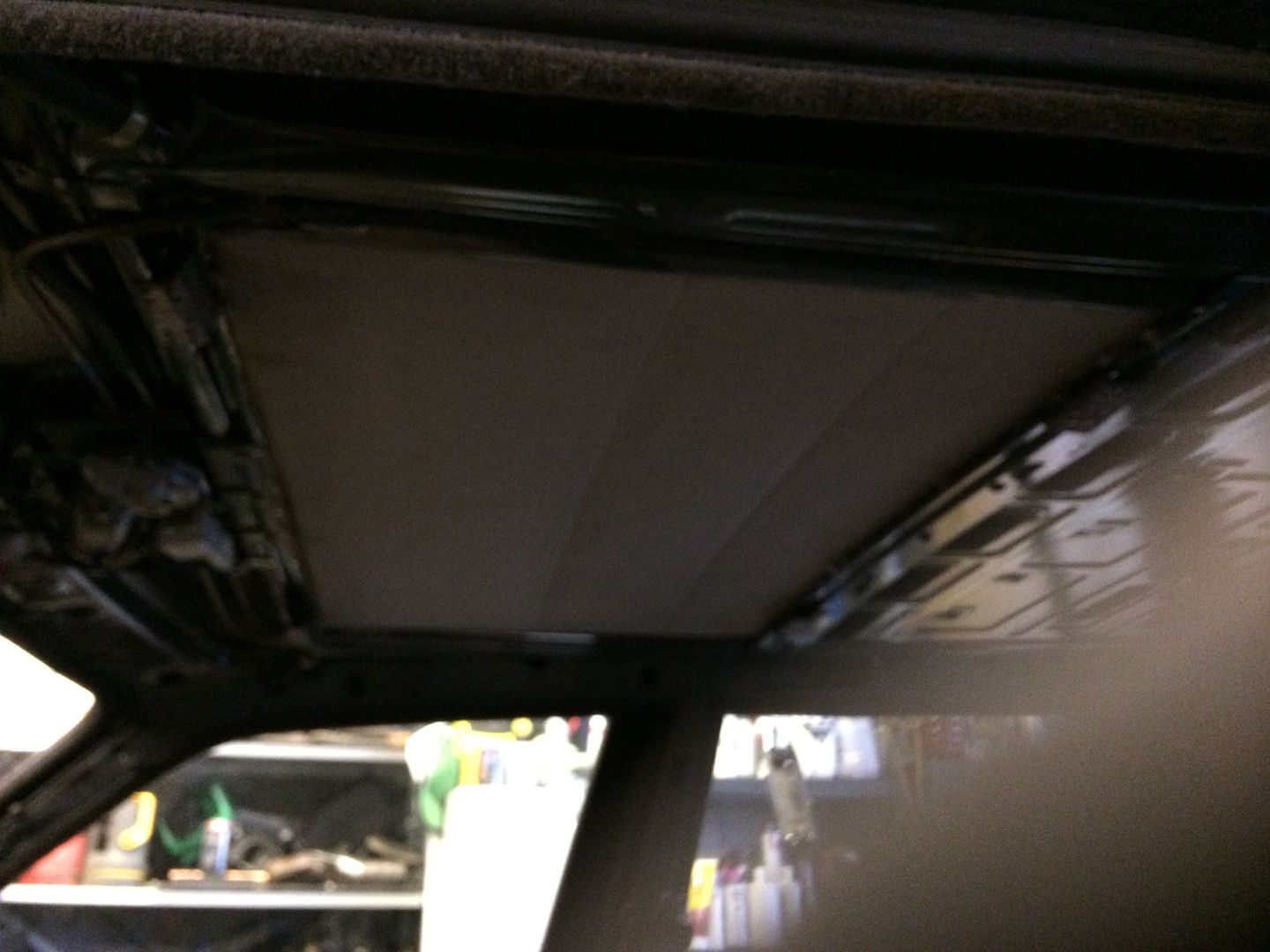

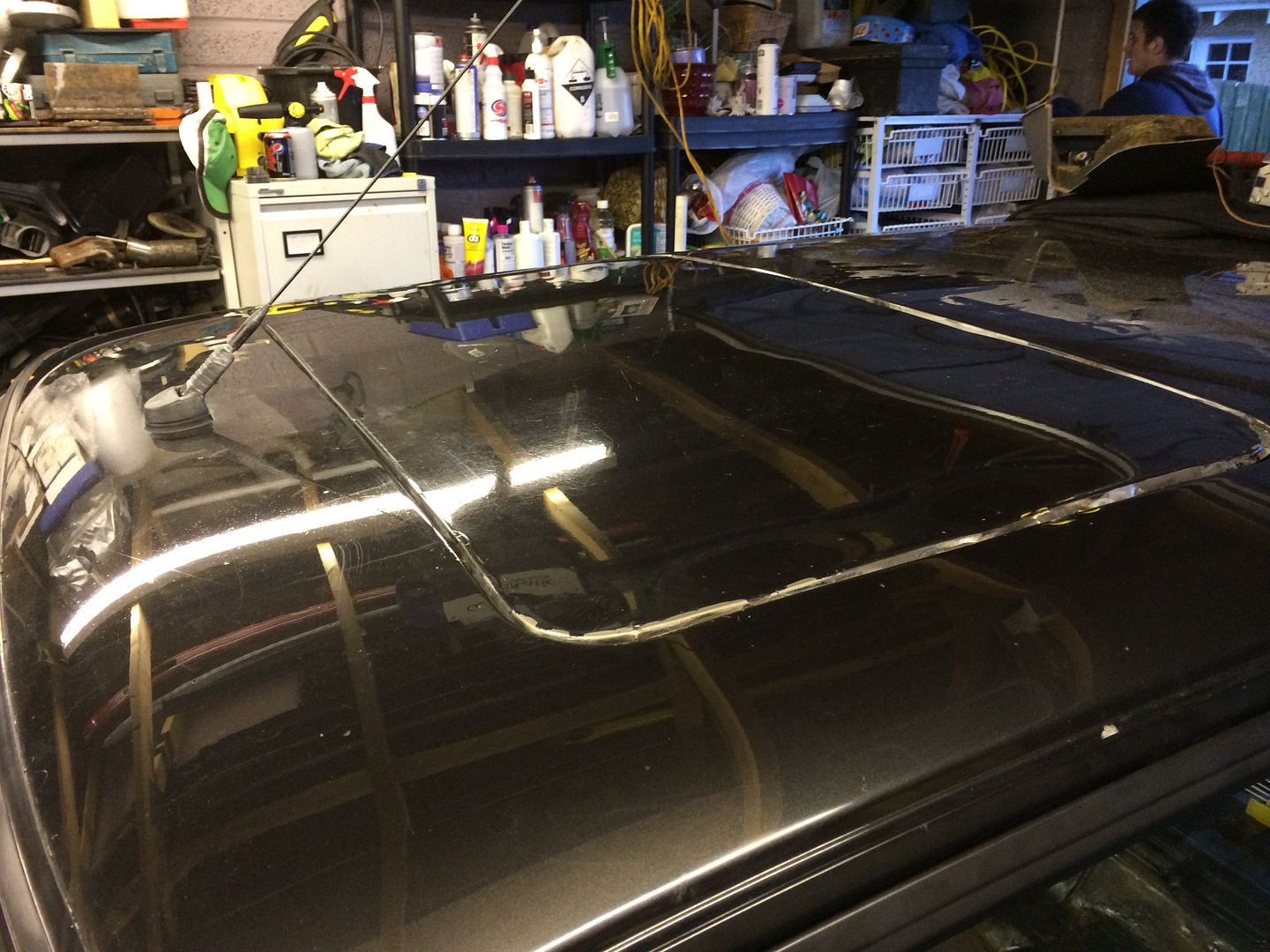

Was thinking about the sunroof ,whats the easiest way to fill the hole ?I want to avoid painting if i can.
Got a spare diff sitting atm so just going to weld that to see how things go.Can always get a proper lsd if i hooked and plenty track time.

There are several options - you can carefully remove the existing outer skin panel from the sunroof and find a way to bond that into the hole. There are carbon fibre panels that can be bonded into the sunroof hole, but that might go against your title of a budget build!! winkeye
There are other more crude ways of filling hole by means of ally panels and rivets that I have seen, none of which are pretty!!
shedrool83
Posts: 4395
Location: Dundee Scotland
Post Tue Dec 31, 2013 5:38 pm
Removing the sunroof panel skin tacking it in and sealing it up seems to best option to me.

Take a look about half way down:
http://www.e30zone.net/modules.php?name ... sc&start=0
Mine was done using a few welds and some sealant.

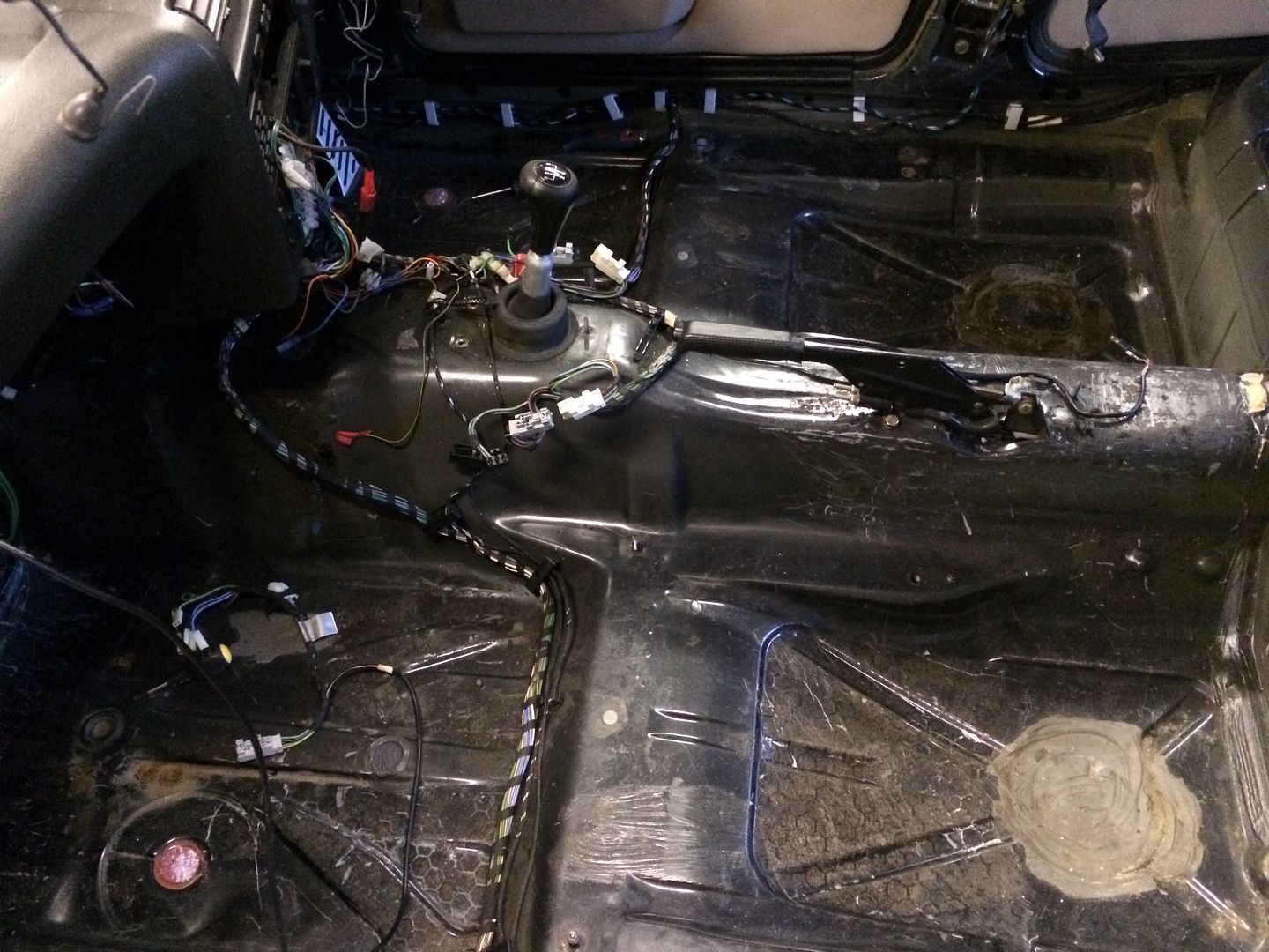

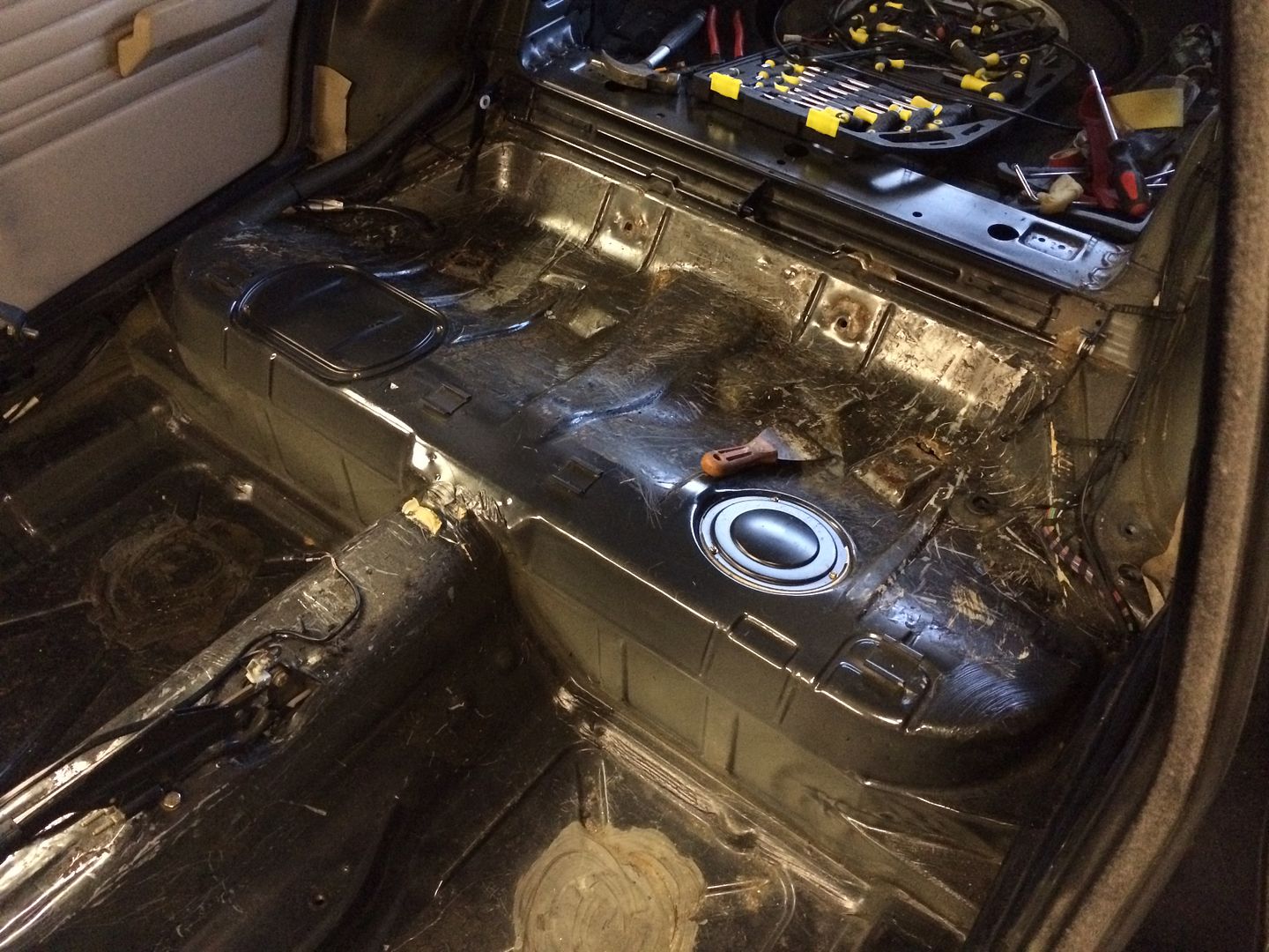

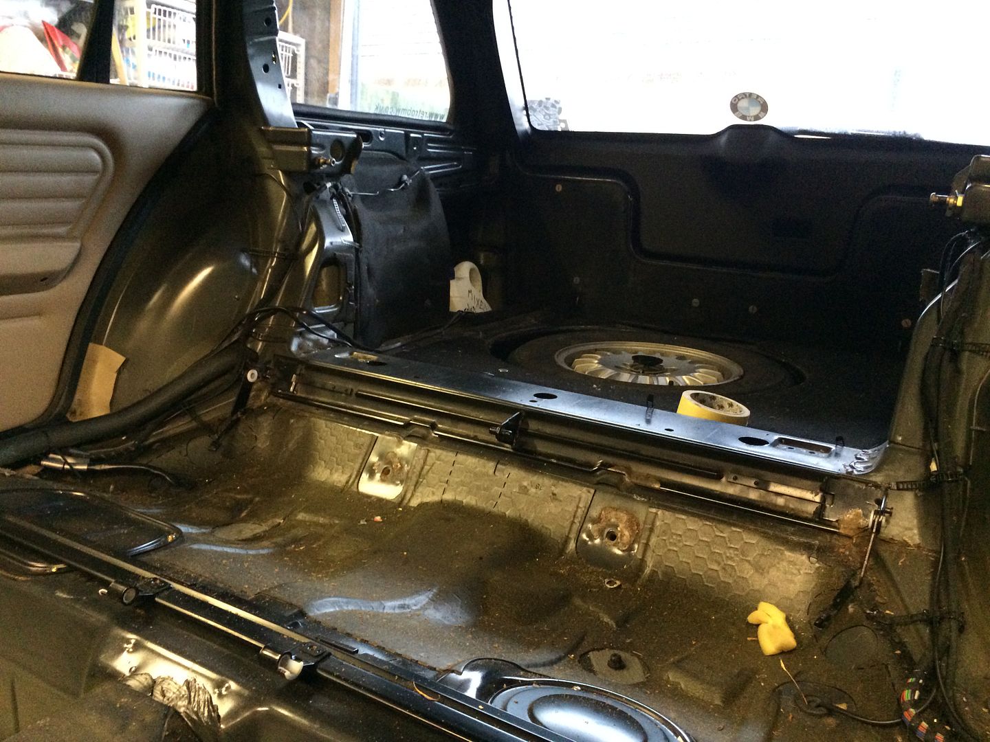

Sound proofing removed.
Sunroof cassette out and sunroof panal skin in with a few tack welds
Few dents etc in the roof/sunroof panel but hay ho.
Found a bit of rust under the sound proofing at the rear seat area so will need to plate that .
The green bag is half full of sound proofing can believe how much it weighs.
Next the dash will be coming out along with any wires i dont need.

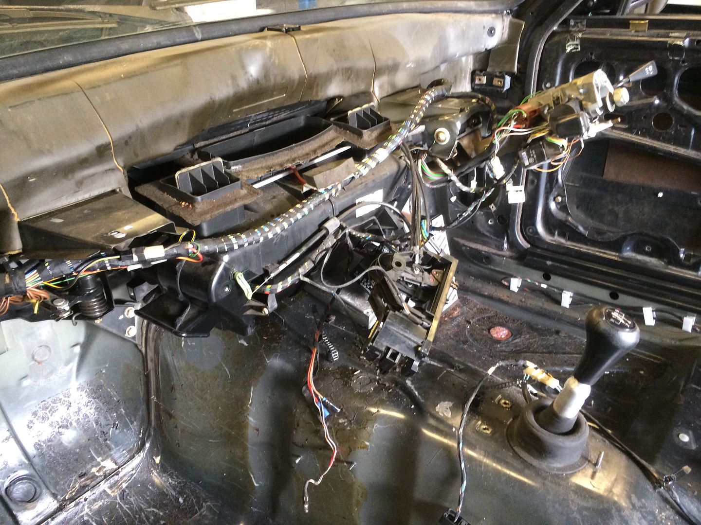

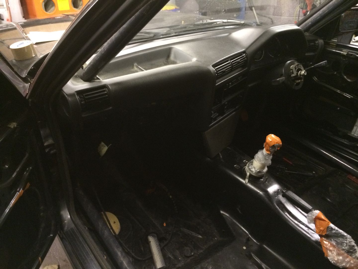

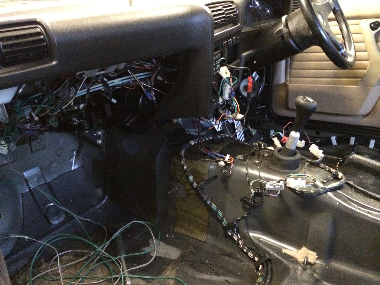

Today saw the dash , electric windows and door looms removed.
Looking at the electric window body loom it seems to go to the rear lights and god knows what else.
Is the only way to remove this is to open up the loom and remove the wires i dont need or am i missing something.
Basically i only want the bare minimal working for mot purposes.

Post Sun Jan 05, 2014 2:19 pm
The electric window loom and central locking are taped together, the wires you see going towards the rear are for the boot solenoid, doors etc.
You can pull all this out in one big go without disturbing any other systems in the car.
Unless its a late touring, it should all be separated from the main chassis loom and you can quickly cut it all out in sections.

Post Sun Jan 05, 2014 4:48 pm
Spot on
Pulled it all back down the pass side un hooked the relay off the accessory thingy, through its over the drivers side and pulled that side out to along with the interior lights.
Have a one loom left down the drivers side wit 4 wires in it which i take is the fuel pump.
I had to cut these 4 as my alarm seemed to be connected to it .The alarm will be coming out to so will properly need help sorting the wires out afterwards.

No the one down the drivers side will most likely be the rear door switch and fuel flap solenoid, the fuel pump is in the main chassis harness.
Andrew

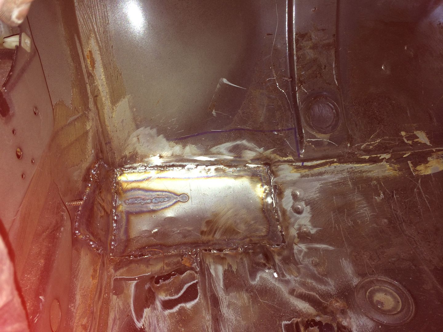

Post Sat Jan 25, 2014 4:59 pm
Wee update
Bit of rust found and cut out today

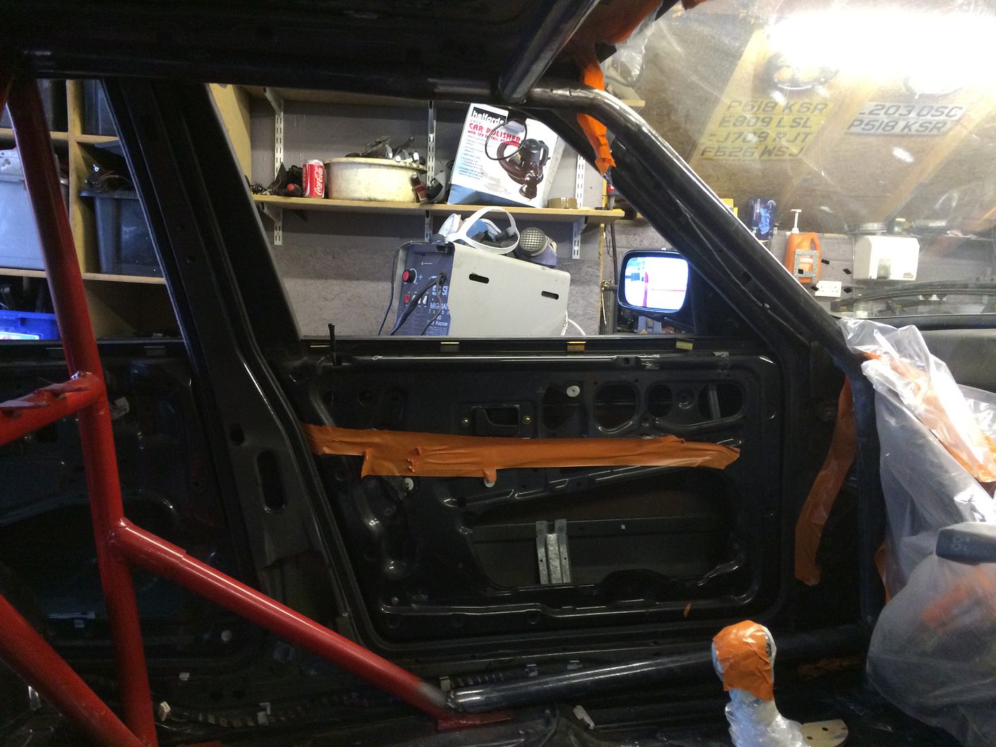

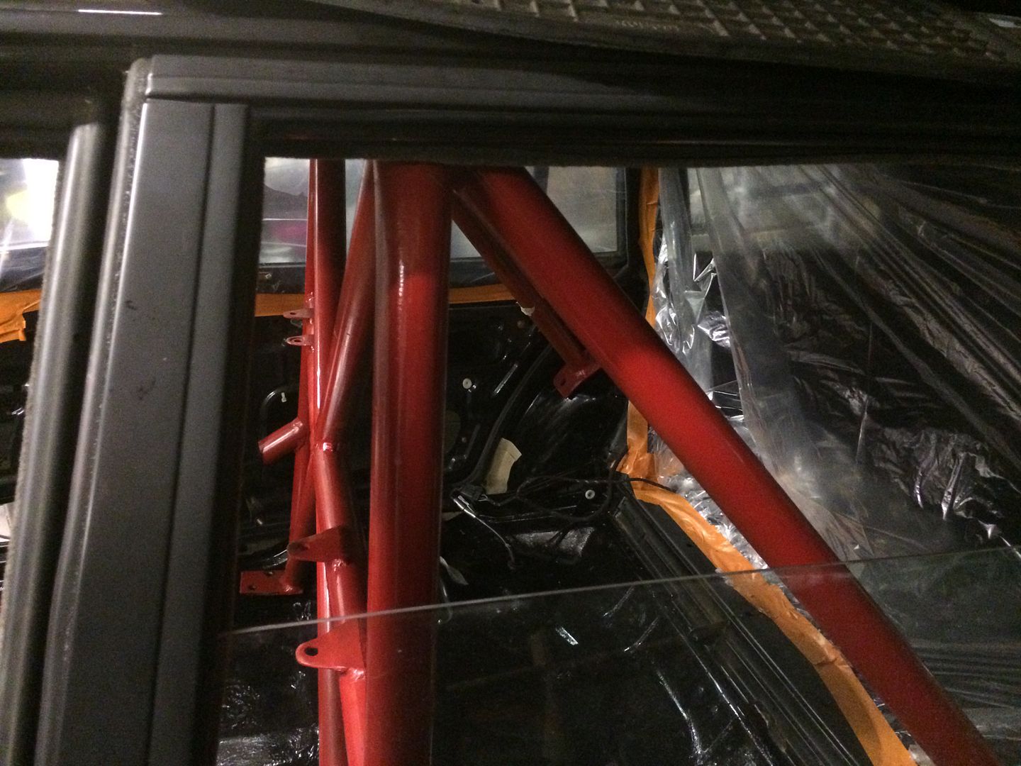

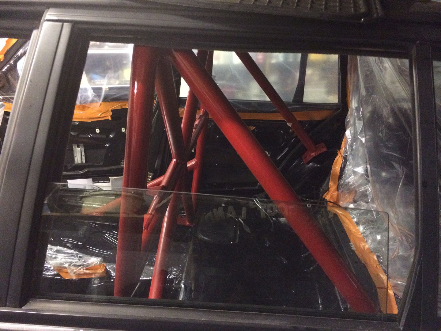

Post Tue Jan 28, 2014 7:25 pm

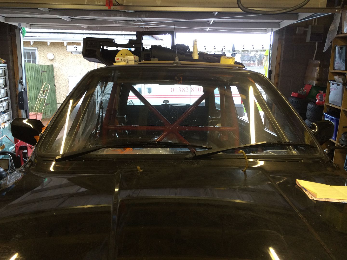

Floor painted and cage sitting in place.
I was a bit disappointed when the cage arrived tbh.
I thought it was a full cage but due to me not asking the seller enough questions and asking for front pictures i'll live with it.
I have tube sitting so i'll add the front sections and add a few more brace pieces here and there.

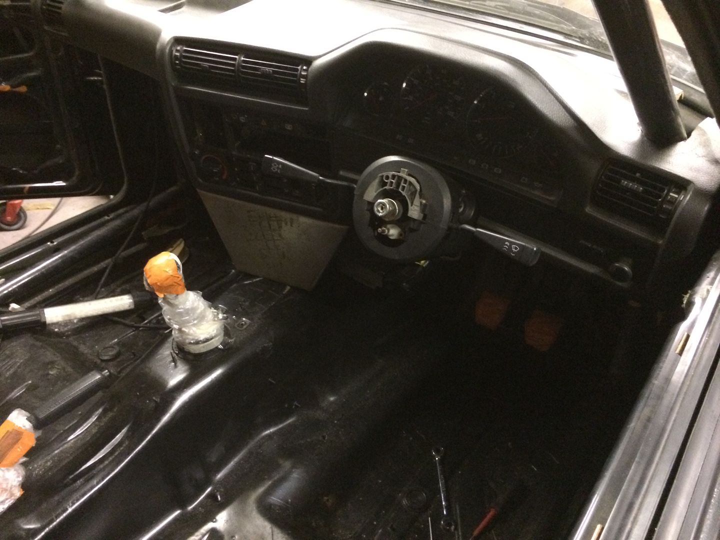

Post Sat Feb 01, 2014 3:55 pm
Front section of cage nearly finished.
Made a bit of a hash on the passenger side it's a bit to far away from the a pillar .
Seats should be here on Tuesday and hoping to get the dash cut and back in tomorrow.

Post Sun Feb 02, 2014 3:36 pm
Dash back in and made a panel for the switches.
