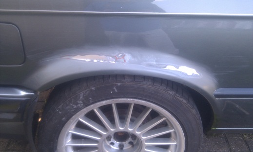

Gave this a go at sorting!
Not great, maybe too heavy on the paint? Applied some lacquer looks semi okay now, better than before and not going to rust!
