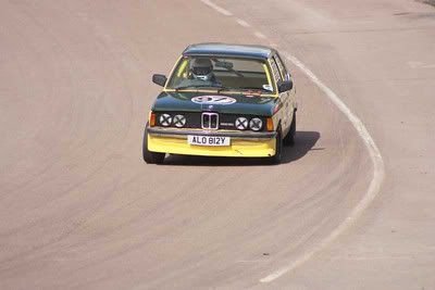

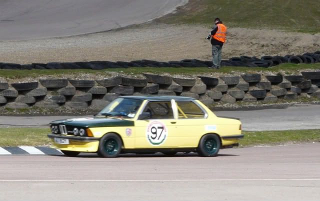

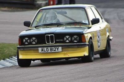

Thought this may be of interest to some of you!!
Bought my car part converted to a race car about 1.5 years ago. Finally got it all finished this year for my first race with it in April.
Here are a few pics.
Its gto a 2.3 M20 engine running on K-Jet. Fritz manifold, Homemade Stainless System, Heavily ported 731 head with 300 deg cam, E30 gearbox. all lightened and balanced. Leda coilovers, Quick rack, Full cage, Extinguisher system, braided brake lines, race brake fluid, yellowstuff pads, Dunlop D83J Tyres on Compomotive wheels.

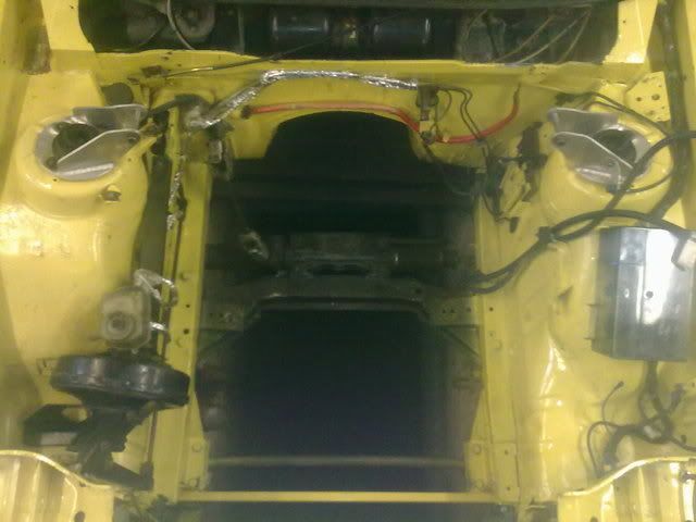

Major upgrades are occuring :twisted:

If I get it finished before the MOT & Insurance run out it'll be on the road for a bit as well.
350bhp
under 1000kg's
Welded diff
:mad: :mad: :mad: :mad: :mad: :mad: :mad:

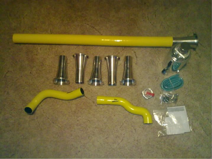

Got some shiny bits in the post, Its gonna make a nice noise 8)

Yep I know I'll be gaining some weight with the S54, but the car was only 930kg in M20 race trim. Now with a bigger driveline and the S54 I'd expect to be up to 980 ish.
May think about some bricks in the boot to get some traction and maybe some more rear downforce.
Also MOT ran out in January, however the plan is to have it up and running ready for a trip to the Pod in July.

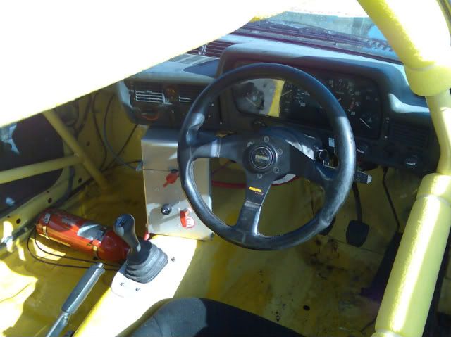

Can I ask why use a welded diff on track? Or will you be drifting in future? :)

Well first off its a lot cheaper than an uprated LSD. Really you'd want 40% or more on track whereas std is 25% if the diff is still like new which most are not.
Also the front running cars (Ford Falcon, Holden Monaro, Lotus Sunbeam) in Classic Thunder run Spool diff's. Which are basically a solid axle just like a welded diff. Supposedly the gains in the faster corners are much higher than the losses from the understeer in tighter turns. Also in tighter turns the throttle can be used to help matters.
Also the car will only be used rarely on the road so tire wear isn't an issue for me.

With that boat anchor up front leaning over the axle, you're going to need all the front end grip you can get + those tyres are going to get a killing! Personally I would budget for an LSD, it really is night and day with a welded differential.
If you need any help with getting more clutches in there, please send a PM to Graham or I can assist. :)

Yep tyres aren't going to like it much although they are 225/45/13 R888's. But when they wear out it'll be going onto 15"slicks.
I was running a Quaife ATB in the small case 168 E21 diff and 4.1:1 so not strong enough for the S54. I've also run a std E21 bmw lsd as 3.45:1 which didn't feel any different in tansition etc to the quaife on track apart from the obvious gearing differences.
Its now running an E12 Side loader 188 3.64:1 and stronger driveshafts/CV's.
Long term an LSD may be the way to go but i'm going to give it a go with the welder first. Got enough expenses going into this as it is.

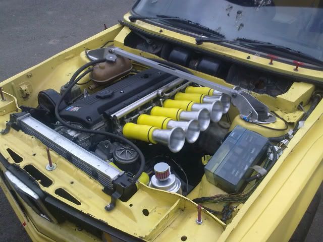

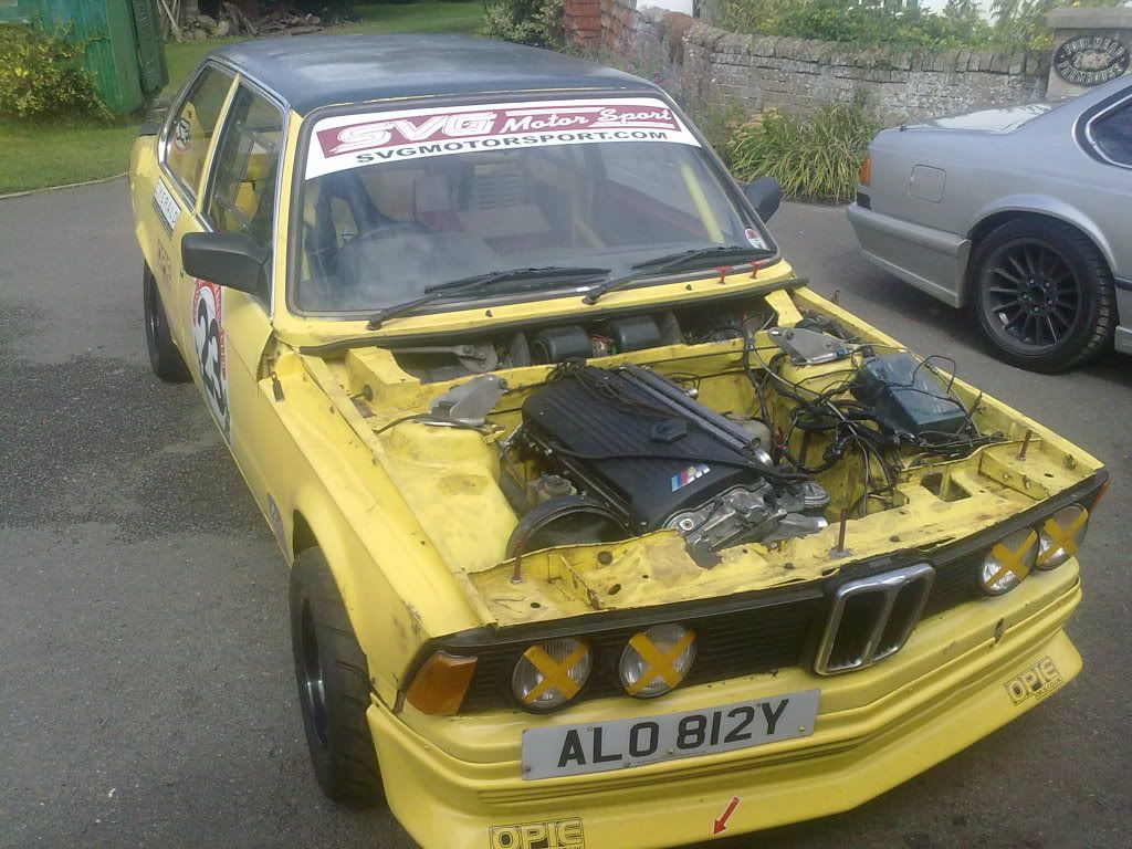

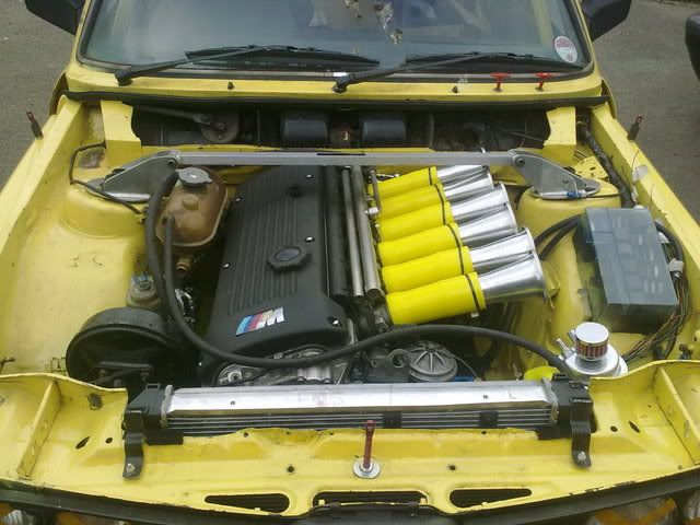

Got the engine out, cleaned the bay up a bit and refittted the engine for the last time, hopefully.

Looking good, could you not get the standard airbox to fit in the bay?

ross_jsy wrote:Looking good, could you not get the standard airbox to fit in the bay?
Hi
Never got the airbox with the engine and it just looks awesome with trumpets. As its purely a track car filters aren't 100% necassary however I will probably fit some socks to be safe from any gravel :roll:
I would of thought the std plenum would fit easily as there is no servo to worry about on that side of the engine bay with an E21.

ross_jsy
Posts: 7307
Location: Jersey, C.I.
Fri Mar 23, 2012 1:41 pm
Wasn't really thinking about the filters, more the fact I would have thought the standard airbox would offer more performance. Or even better, a tuned carbon airbox

ross_jsy wrote:Wasn't really thinking about the filters, more the fact I would have thought the standard airbox would offer more performance. Or even better, a tuned carbon airbox
winkeye
There should be bellmouths inside the std airbox and its the length from these to the head that affects performance. So effectively I have the same setup without the box around the trumpets. My advantage is I can now easily play with intake lengths to move the power/torque curves around or at least see if it makes any difference.

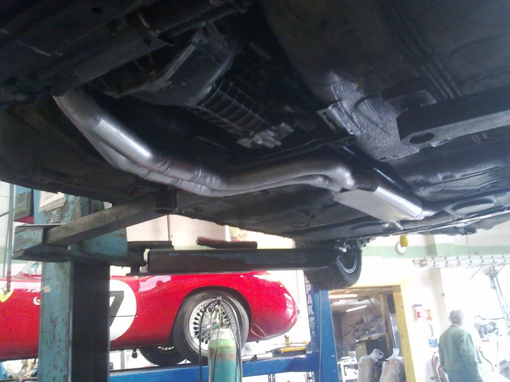

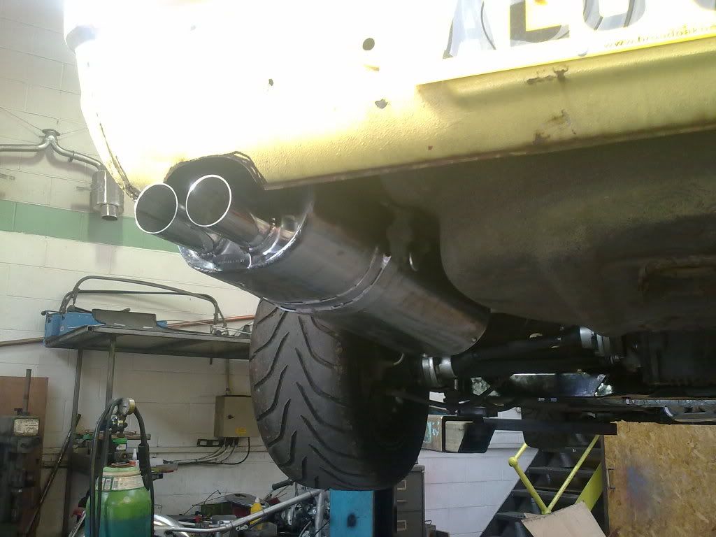

Progress:
Exhaust system has been made now and the car is at Emerald for the software/ECU updates and mapping. Should be running this week and finished by next. Can't wait to hear it winkeye

Oh my... that does look impressive!
Please though - do fit some kind of air filtration......! 8)
Gravel is the least of your worries, especially on a lovely engine like that - trust me, I am an engineer!
