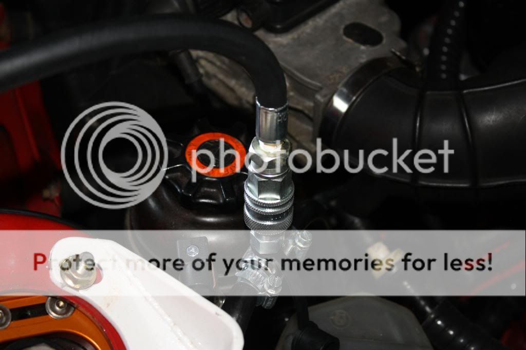

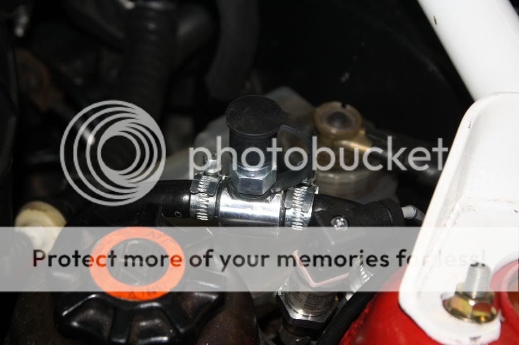

Fitted a t-piece and dry brake to the fuel system so I can pump the fuel tank out. This enables me to work out fuel usage over a lap, session etc. plus it allows me to only run the fuel I need for a race rather than having to 'guess' how much is in the tank and how much to add:
Thats all for now :)
where did you get the t-piece from?
shame you had to pull out of the racing!
It's a FSK3 kit from Mocal. Have to say though the 'dry break' is toss and does 'squirt' a bit when connected to a fully pressurised system :?
It's a shame about the race for sure although the weather for next weekend at Silverstone looks horrendous haha.

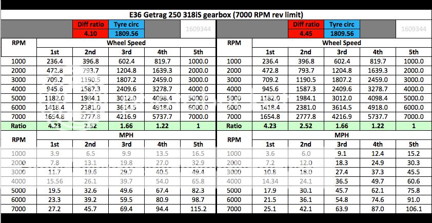

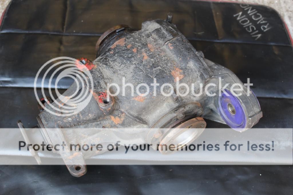

Sooo a little quick update. Dave the engine man came over a couple of weeks ago and corrected the timing chain sprocket issue. All back together with the cam sensor plugged it in now runs as it should to. We also made an adjustment to the idle screw on the throttle body as well to help that as it was set too low.
After having been keeping my eye out for a 4.27 or 4.45 ratio LSD for a while, a 4.45 came up so I grabbed an opportunity to buy it. The 4.1 I currently have fitted is great but I wanted to just see what difference fitting the 4.45 would have and have the option there to change should I feel the need to. It's not the sort of item especially with this hard to find ratio that will lose value on what I paid for it.
The chap I bought it from did hill climbs in his car and had this diff paired up with an E36 318iS gearbox. Being a bit of a sucker I bought that and associated prop shaft and linkages as well as the price was reasonable. After putting some numbers into a spreadsheet however, it became apparent that with my rev limit; the E36 gearbox and 4.45 diff combo would bring my top speed down to ~108mph. Alarm bells started to ring as he had told me that his car had done ~120mph in the past and not to worry. It later transpired that his engine was a bit of a monster and revved to 8700rpm in comparison to my relatively standard 7000rpm.

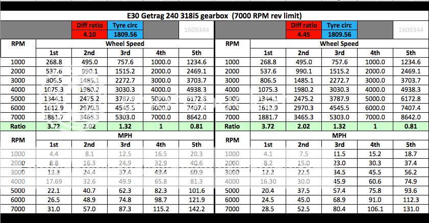

Here's the E30 318iS gearbox comparison with 4.1 and 4.45 diff ratios:
And E36 318iS gearbox comparison with 4.1 and 4.45 diff ratios:
Quite a noticeable difference there, wouldn't be much help when heading down hanger straight at Silverstone to name just one example!

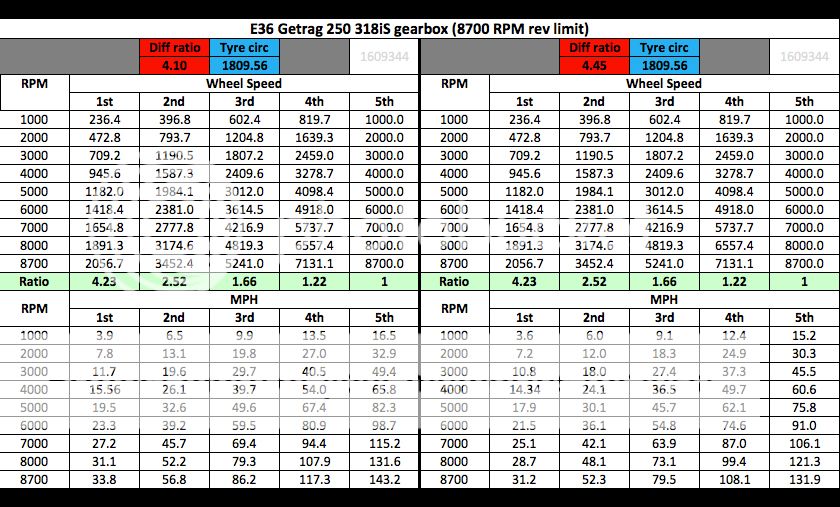

I decided to extend the table just to see what the difference was with this other engine revving to 8700rpm and it explained a lot:
Long story short I will more than likely be keeping the standard gearbox in and moving on the rest of the parts. I will hopefully get time to do a track day earlyish next year and will be able to do a back to back with the diffs and see what the differences are in practice.
Also if any one notices and blatant errors I've missed in those tables feel free to point them out so I can amend the spreadsheet :thumb:

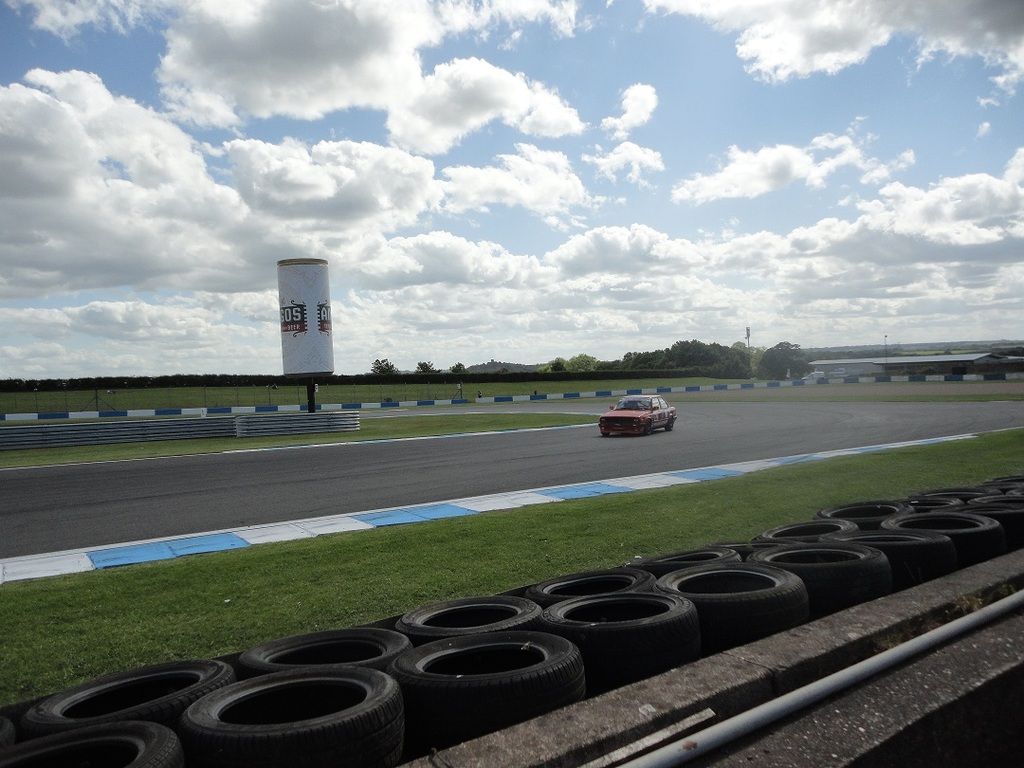

Looked good going round mate, how did you find it?
(we spoke in the pits previous to your race)
[/img]Image[img]
Few more photos of you & others here.....
https://www.flickr.com/photos/11720525@N06/

rix313 wrote:Sooo a little quick update. Dave the engine man came over a couple of weeks ago and corrected the timing chain sprocket issue. All back together with the cam sensor plugged it in now runs as it should to. We also made an adjustment to the idle screw on the throttle body as well to help that as it was set too low.
I'm Running a 4.45 Medium Case LSD paired with the standard Getrag 240 box and the speeds in each gear seem spot on.
