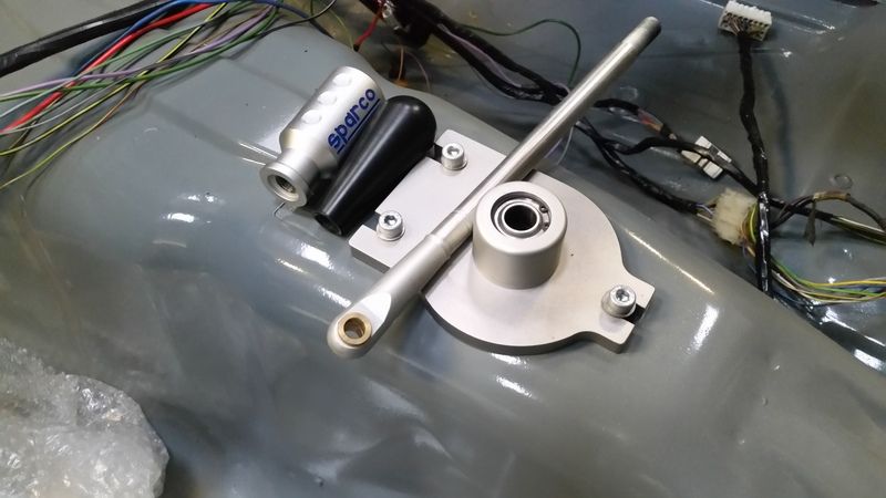

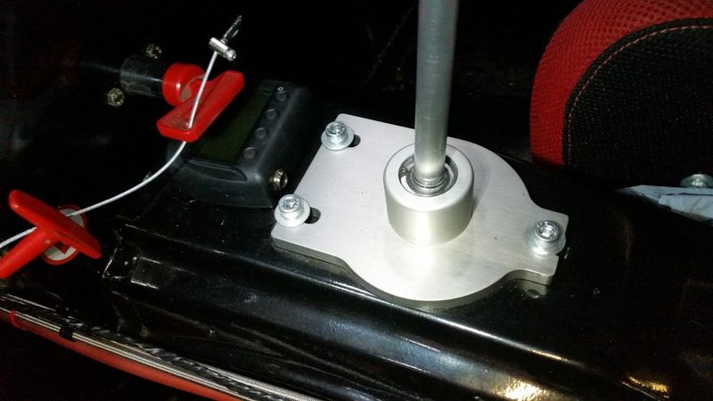

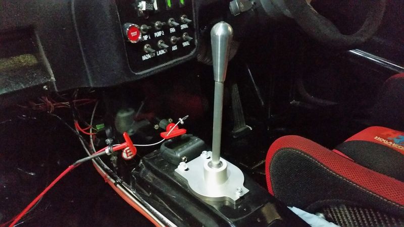

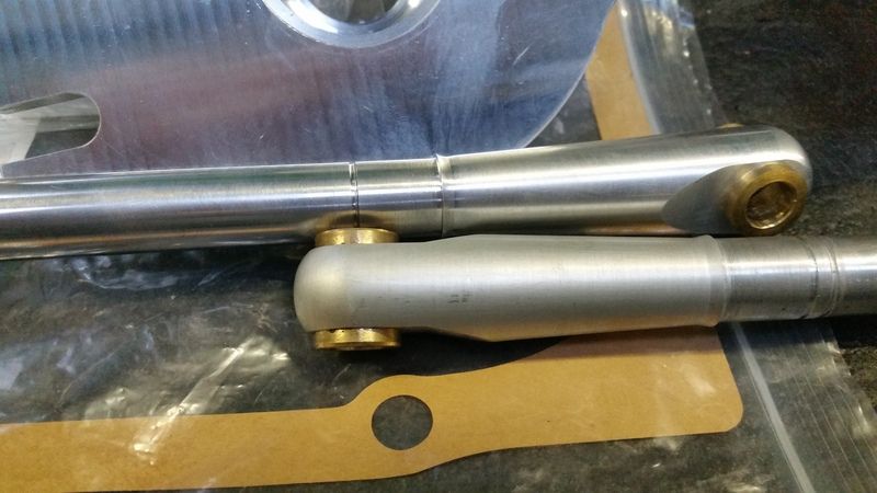

A nice man has made me a new gear shifter
Very similar to the AKG shifters but half the price!
There are 2 more of these available if anybody is interested, they've been assembled and fitted, only one has been used for a few hours racing in the E36, the other has just sat in the E30, price is £150 each with a choice of gear knobs as pictured, aluminium or white delrin also.
Send me a pm if your interested

Last track day of the year was Anglesey on the 29th Nov, another great day and the gear change is fantastic to say the least! No pics of the day unfortunately.

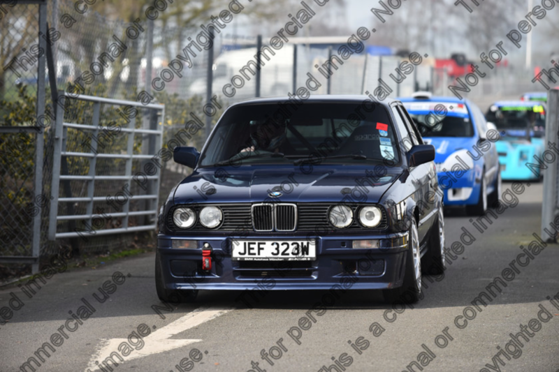

Couple of pics on the Javelin site I found, you need to click the links
4 of us went for the day
All over my mate in his E36 Compact, I did get past it

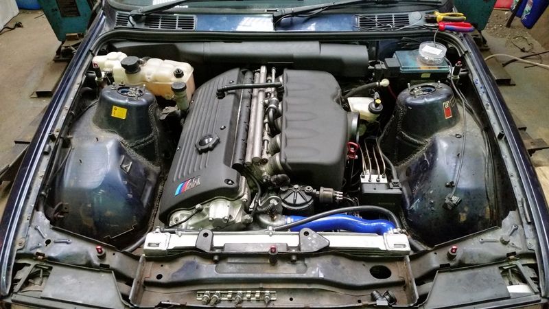

And this is the one I didn't get past, I wired up an S54 engine and the E46 M3 ABS/DSC a month or so previous. Made 394hp with a few subtle mods

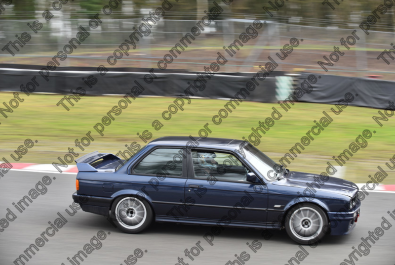

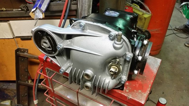

Had a great day out at Oulton last week, changed the diff ratio to 3.91 and its now 'well rapid'
Gave it a bit of titivation whilst I was on
Some branded pics
And if you skip to 8 mins there is a bit of video here
Jobs to do before next outing = change the geometry a bit, apart from the rear roll I'm well happy
Some branded pics

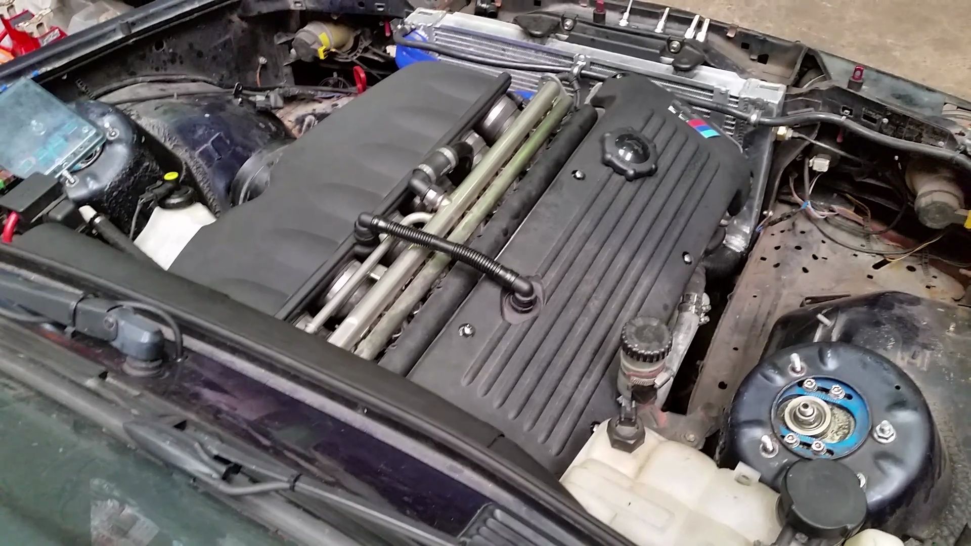

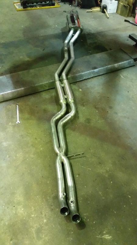

Not many yet, exhaust is nearly done, definitely won't be at Santa Pod though
There is a local show tomorrow morning and an air show too, as much as id like to go I can still taste the flies from the last time it was held in summer, car not ready and local shows swings it

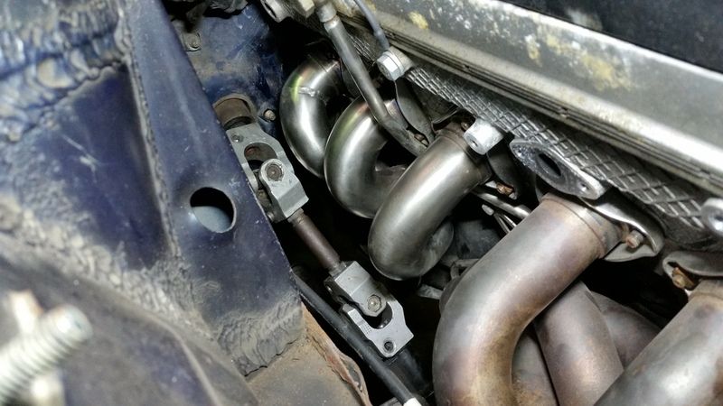

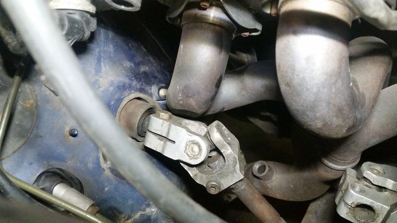

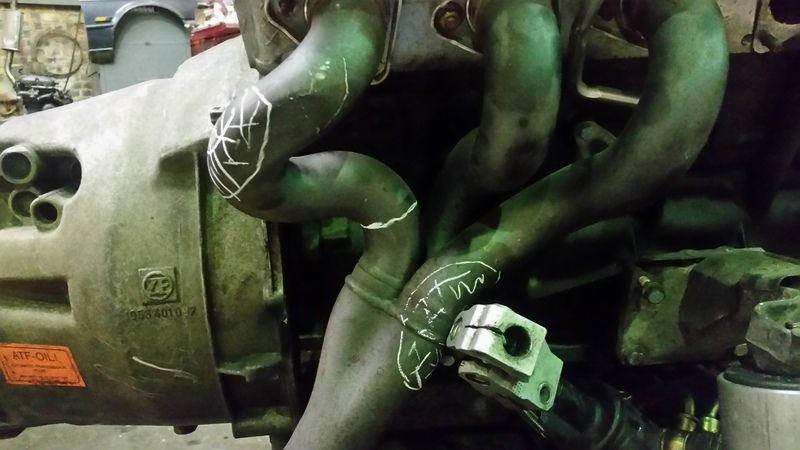

Number 6 looks close here but its above the UJ not alongside it

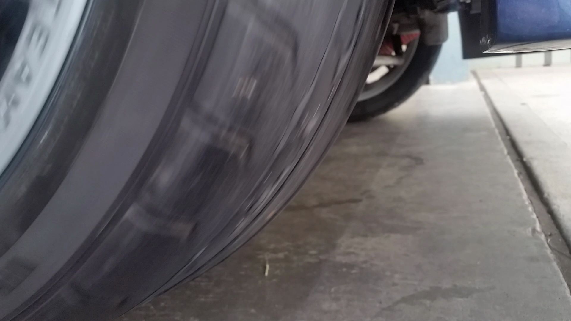

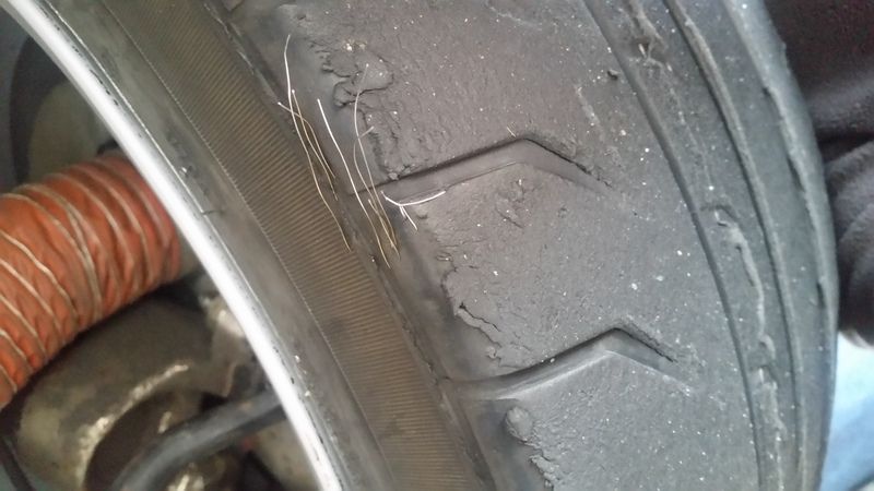

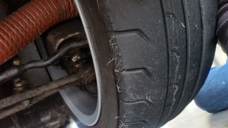

So I got it run up to temp properly at about 3.30pm this afternoon, everything seemed ok so I gave Javelin trackways a ring to see if I could squeeze in on their Donington Park evening, arrived just in time and had a great few hours on the track, handling didn't seem too different at all TBH, a bit more roll on the front but otherwise just fine
coming up towards 8 o clock the steering wheel started shaking a bit and got worse, especially at speed, so I checked a few things over and eventually spun the wheel to check the tyre and found this
Click for vid -
And this is the near side front
Kumho V70's brand new last year! Ive never seen anything like it
Click for vid -

I ve had this on slicks - down to the pressure getting too highDanThe wrote:[/URL]
never had it with kumho's

Not updated for a while but after killing the Kumhos I found out they were the soft compound which explains the problem a bit more. So ive bought some Yoko AD08 R for wet/intermediate use and a set of used Dunlop slicks for dry.

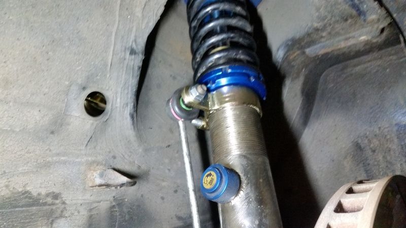

Did a local sprint day in August, lots of roll!

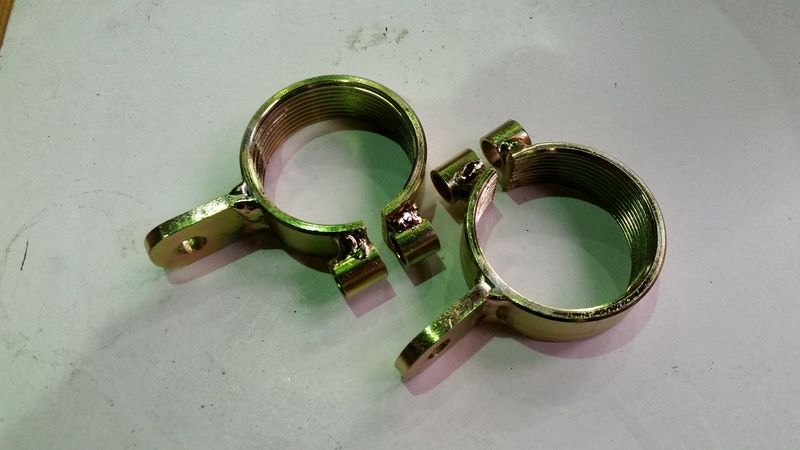

So ive now moved the ARB drop links up to the strut to combat the wheel lifting
No brackets on the Gaz so I had some collars made and the correct trapezoidal thread machined on the inside, cut a gap, welded some bits on and had them zinc plated. Ive used E39 long droplinks

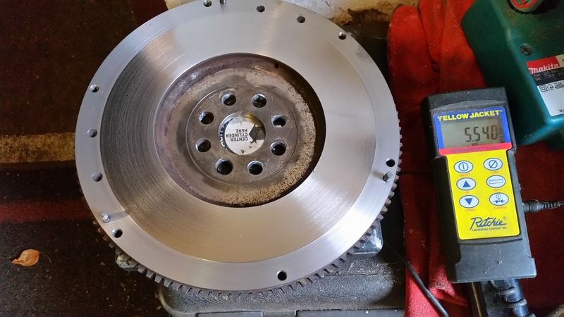

Had the flywheel friction surface skimmed in an attempt to reduce the paddle clutch judder
Its a bit better but still a PITA at low manoeuvring speeds...

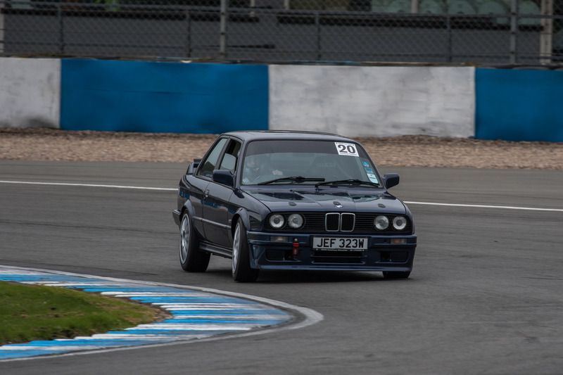

Also did the car club trackday at Donington just over a week ago, dryish morning with light rain which meant I could use the slicks for about an hour but the rain gradually moved in more so had to get the Yokos on, little vid of some M4's being very careful and a 570hp 4 wheel drive 911 twin turbo clearing the way for me
[youtube][/youtube]
The ARB is now working much better, you can see the difference in some of the pics below, im sure ive got another pic of the car with the M52 and 15's coming out of craner with more lean on it than whats showing now
