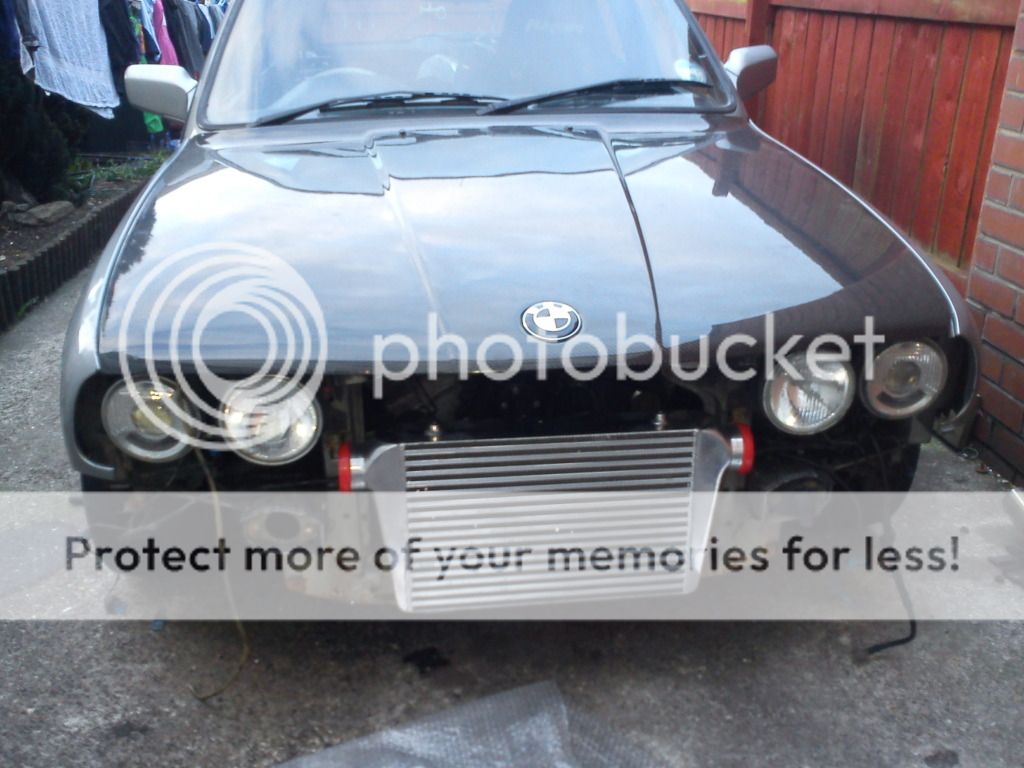

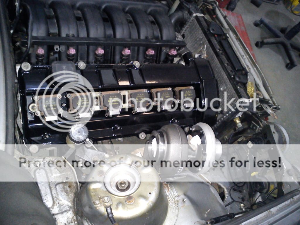

The intercooler has been test fitted
and fitted
It sits perfectly, just right for the boost pipes to be routed under the lights :)

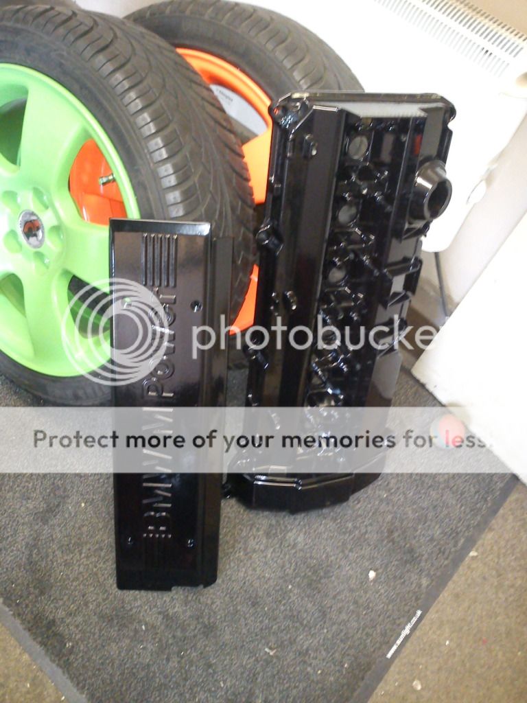

And I thought while the car was getting a seeing to, I would get the covers powdercoated,
Not sure what to do with the top cover yet, I was thinking of buffing the lettering to a nice shine..?
and speaking if shiny parts what an awesome piece of kit this is..
Shame it's not going to be seen, it'll be hidden away under the manifold :(

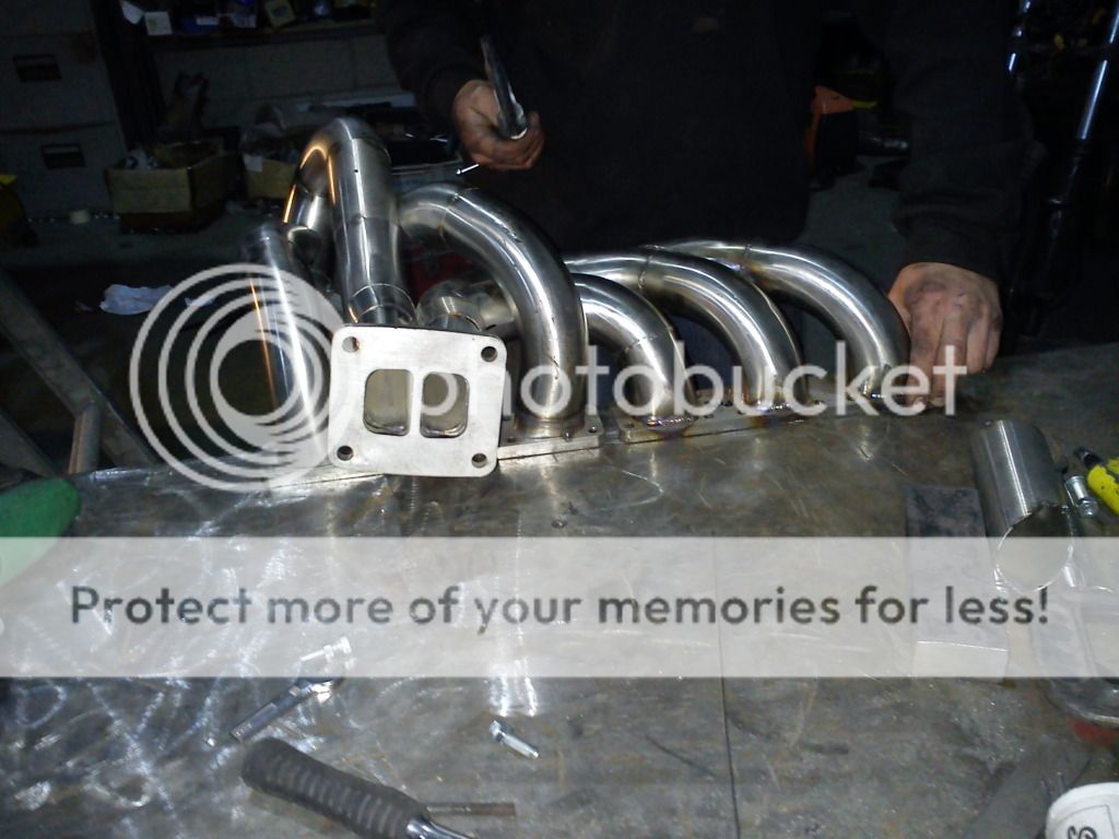

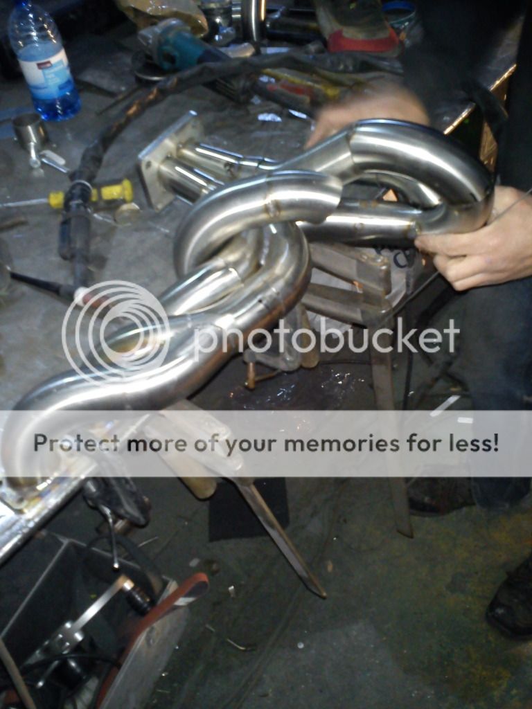

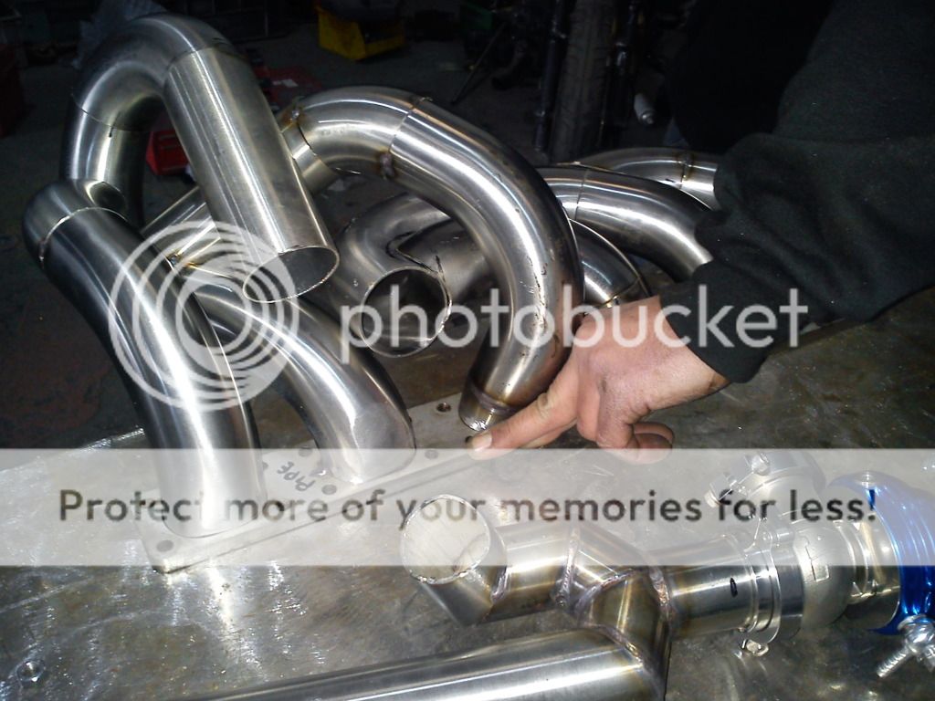

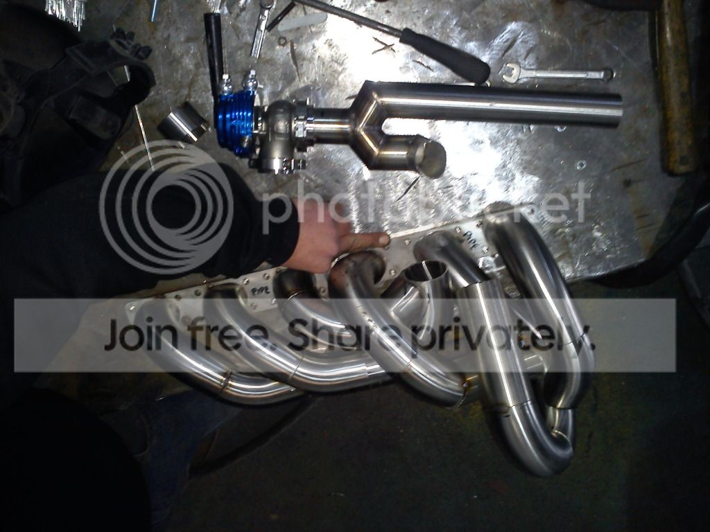

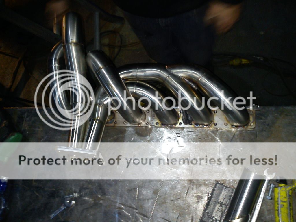

After a bit of test fiddling, we decided on the best place for the turbo to live,
And after a bit of jiggling around it found its rightful home

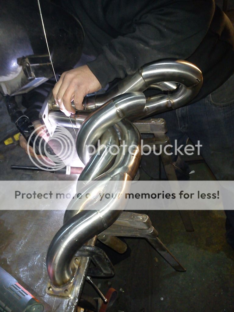

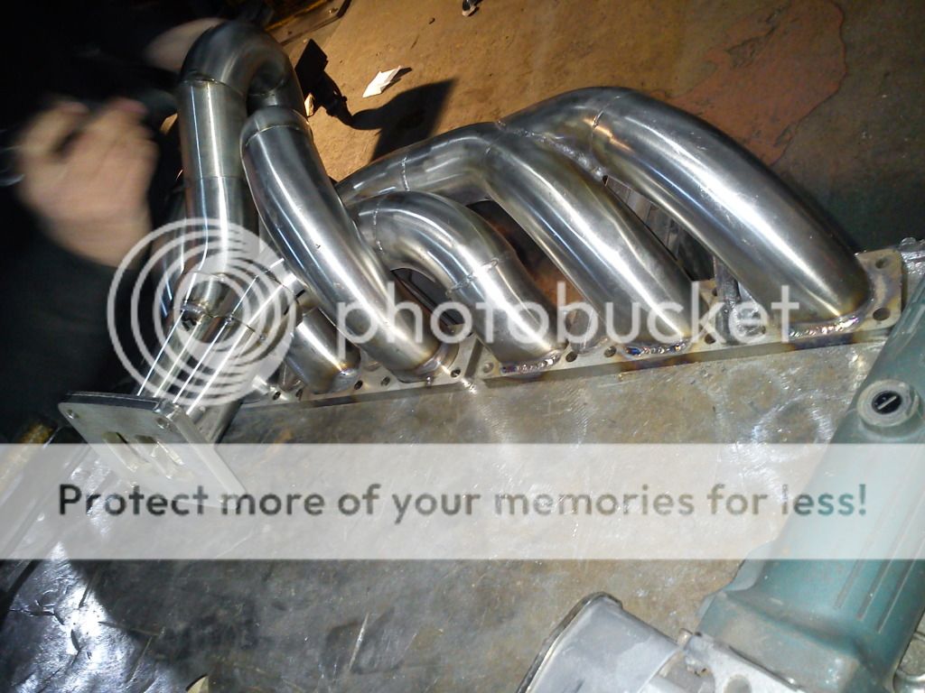

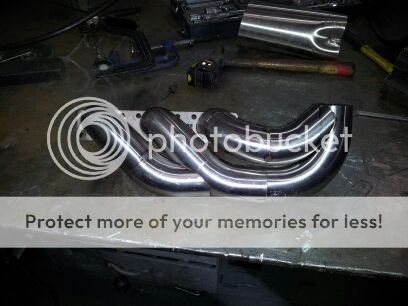

Once I had the turbo in just the right place, it was on to the manifold,
I had the flanges laser cut out of 10mm 304 stainless steel,
and the rest of the pipework is all 2" 316 grade stainless,
We got the rear 3pipes lined up quite easily
Then we just took it from there, test fit, tac on, cut it here and there, tac it back on, take off, cut again, tac back up :/ you get the picture, it wasnt easy, infact, this is one of the most complicated systems we have ever done,
But we stuck with it and an pleased we did, because it's ended up like this...

Are the runners "2 out of the head?
Looks to me that manifold is going to do very well.

Gunni wrote:Are the runners "2 out of the head?
Cheers dude, I think we have got it to "go with the flow" it took some doing, and it's defiantly not a job for the faint hearted.
I had to get the laser cutters to open up the port on the flanges when they were cut, so we could get the 2" pipe to sit inside the flange,
Dont worry, all the welding on the inside of the flange, to the pipe, has a lovely angle to it :D

51mm exhaust runner pipe is very excessive FYI.
Are you planning on 1000hp?
With great challenges comes great engineering.
Gunni
@ 2012 VEMS group buy !!
craigieeb
Posts: 4988
Post Sun May 13, 2012 11:34 pm
No, just 500 :D
if I used anything smaller, the manifold would of needed braced in a lot of places due to the weight of the thing as you know,
So instead of using a smaller pipe or a lower grade only for it to crack/break etc and have to do it all again, just wasnt an option for me.
Better off making 1 that is beefy, and going to last, because once it's on.......
I dont see it coming off for any reason
