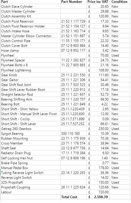

Vez010
Posts: 100
Joined: Mon Oct 05, 2020 9:01 pm
Wed Jul 07, 2021 10:24 am
Hi, apologies for the delay - total cost including labour was £2508.39.... breakdown as attached. I chose to have the flywheel lightened and also opted for a short shift lever.
