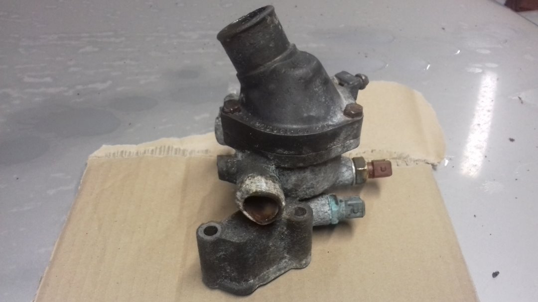

Hi,
I am after a Thermostat housing for an M20 (lower hose connector corroded and fell off!)
Car is a 1986 320i, but are they the same for all M20 engines?
After a good 2nd hand one, or can anyone point me to a new aftermarket supplier?
Thanks

Rockauto american supplier i got one for mine,the only difference being is the're 2 extra threaded holes which have to be blanked , after ordering was on my door step in 2/3 days . link here

How did you block off the extra holes?

From memory i think i used spare brown and a spare blue sensors, had to cut the end off one if i recall was a while ago now, if not an easier solution would be to take it to a hardware store and match up some short threaded bolts with a sealing washer.
