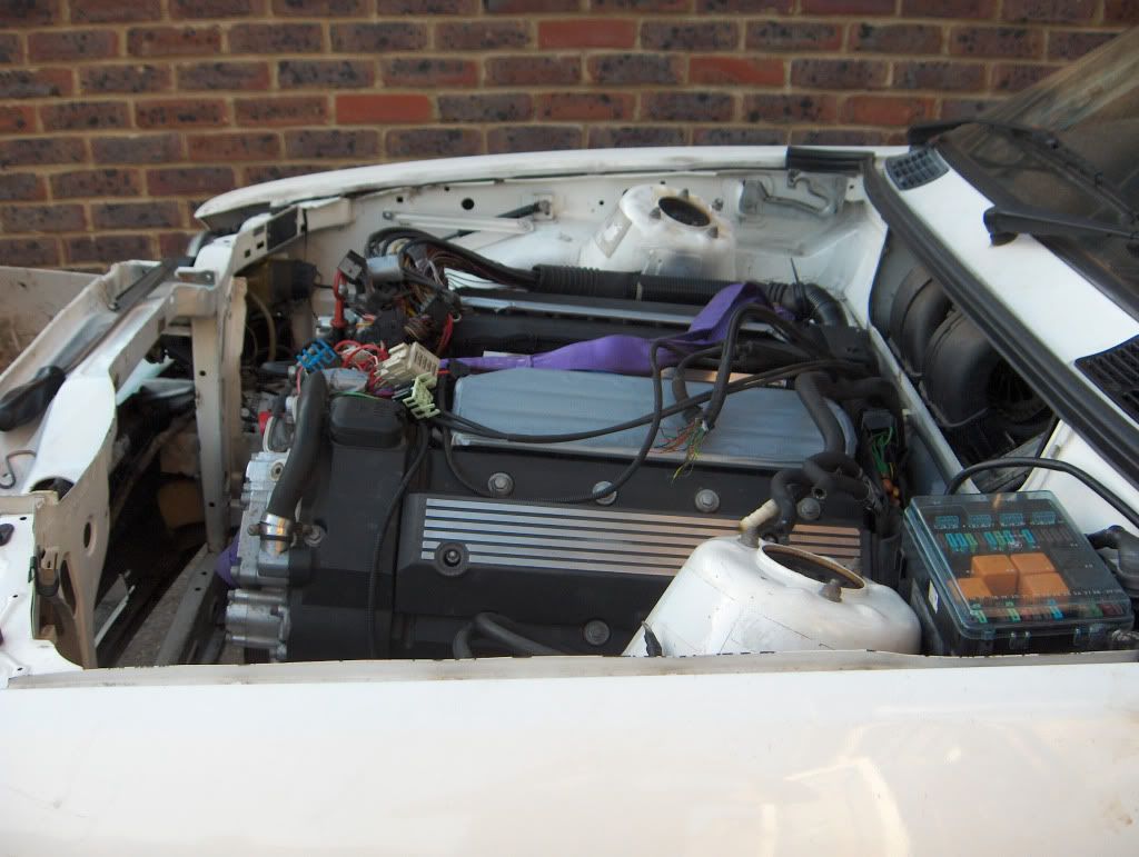

My 320ise S62.

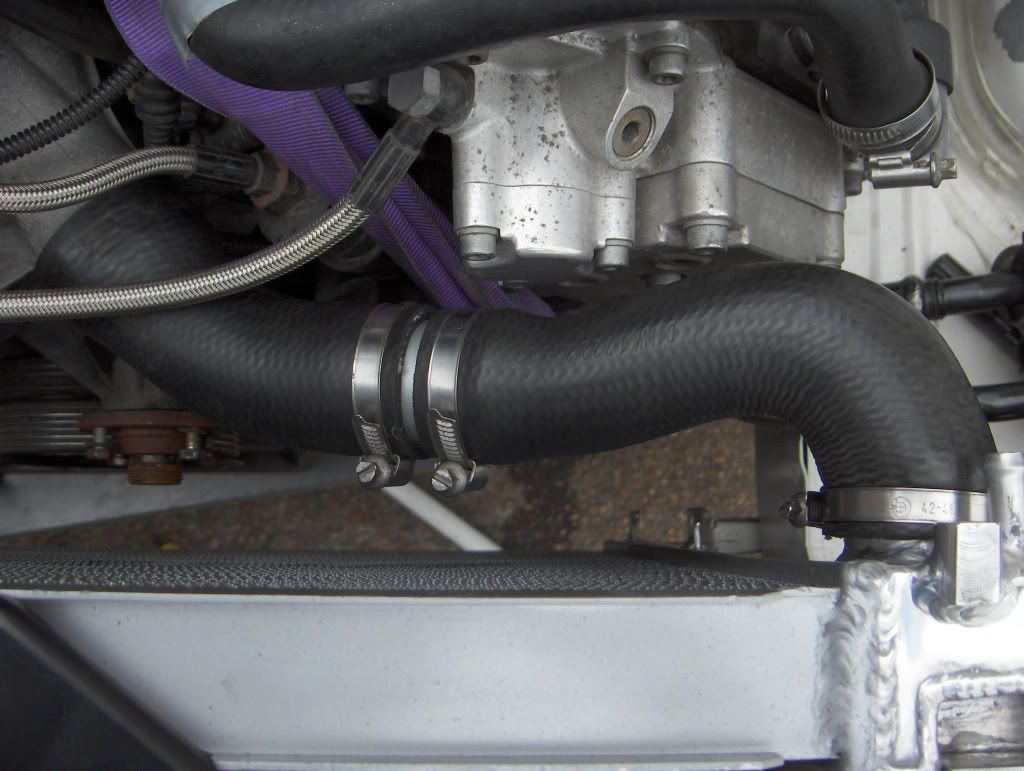

Wow, seriously fantastic work. The radiator looks amazing too, very tempted to treat mine to one of those!
When I had my engine sat as far back as possible the damn heater matrix hoses kept getting pin size holes in them, so had to really think about getting some clearnace in there!. How far back have you managed to get yours?

The engine mounts are set in the forward-most position on the 300mm.de engine "arms", but I'll have a look at how far I can rotate the mounts (and engine position) back when I get home. The main limiting factors are (as you know) the heater pipes (which *could* be modified), and the steering rack/sump clearance.
I took some pictures of clearance between the bulkhead and engine today, but my camera lead is packed away in my snowboard bag round a mate's house.
I routed the engine loom through the bulkhead today. I'll get some pics up when I get back.

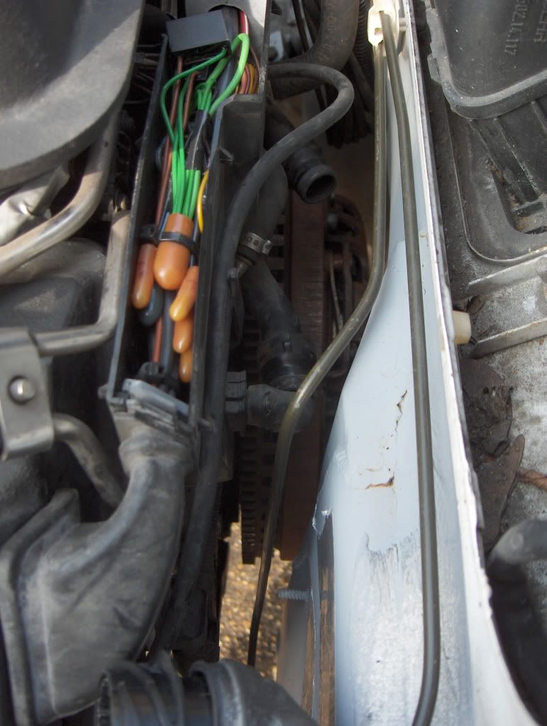

I got back from Chamonix at the weekend. I've spent a couple of seasons in Canada over the last few years, and have been trying to figure out a way that I can spend more winters in the mountains without working... So far, I've not come up with much!

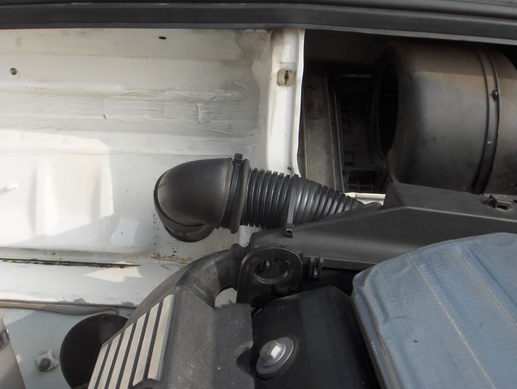

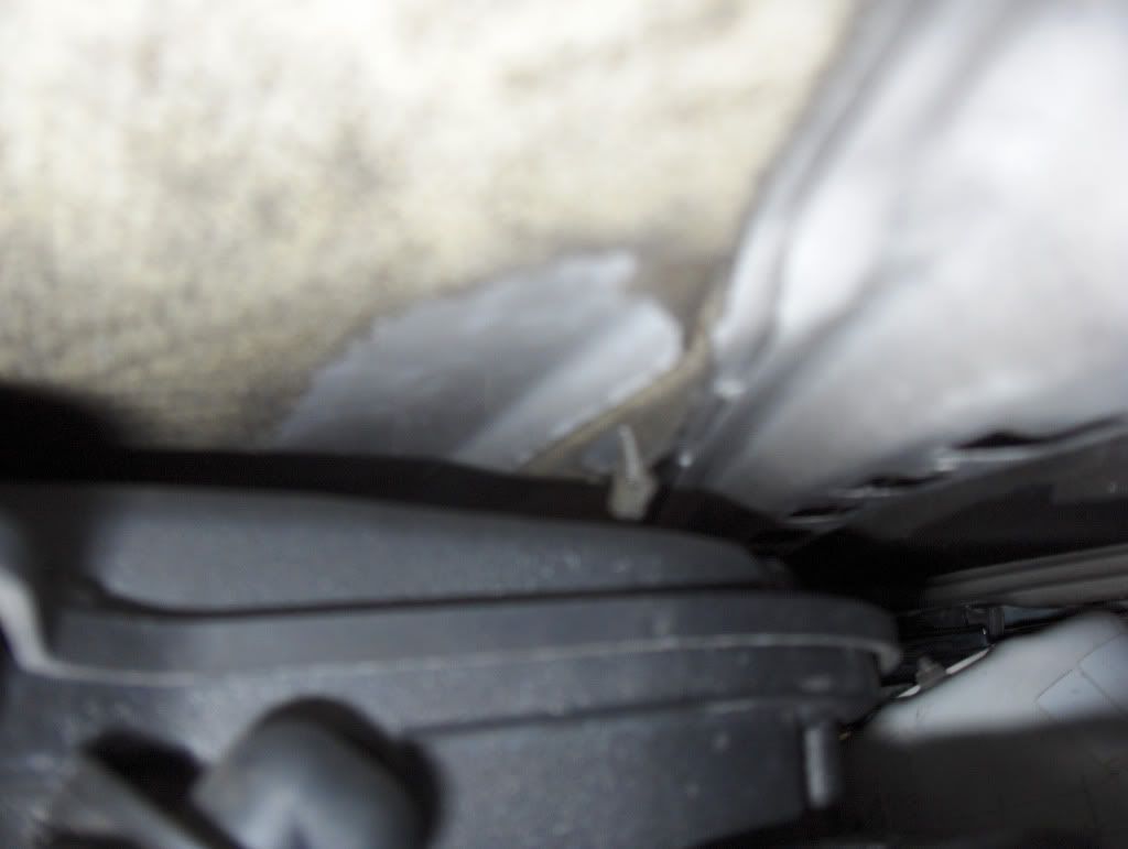

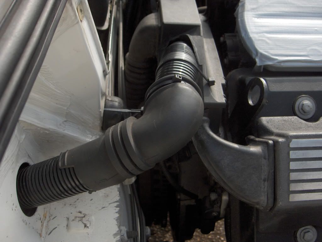

Anywho, I've not done a great deal at all this week, but thought I'd pop the photos up of how I routed the engine loom through the bulkhead. Where the S62 loom leaves the engine, it routes upwards a couple of inches, then toward the nearside of the bulkhead via a plastic cover and 45 degree rubber boot, and isn't long enough to mount the ECU anywhere in the passenger footwell area as I kind of planned.
I didn't take any "before" pics, but I cut away the upward pointing part of the cover and cut a portion of the plastic trunking from the loom, which now lives between the cover and the 45 degree boot...
It still needs finishing with proper cable ties, a grommet and a tidy up, but (hopefully!) you get the idea.

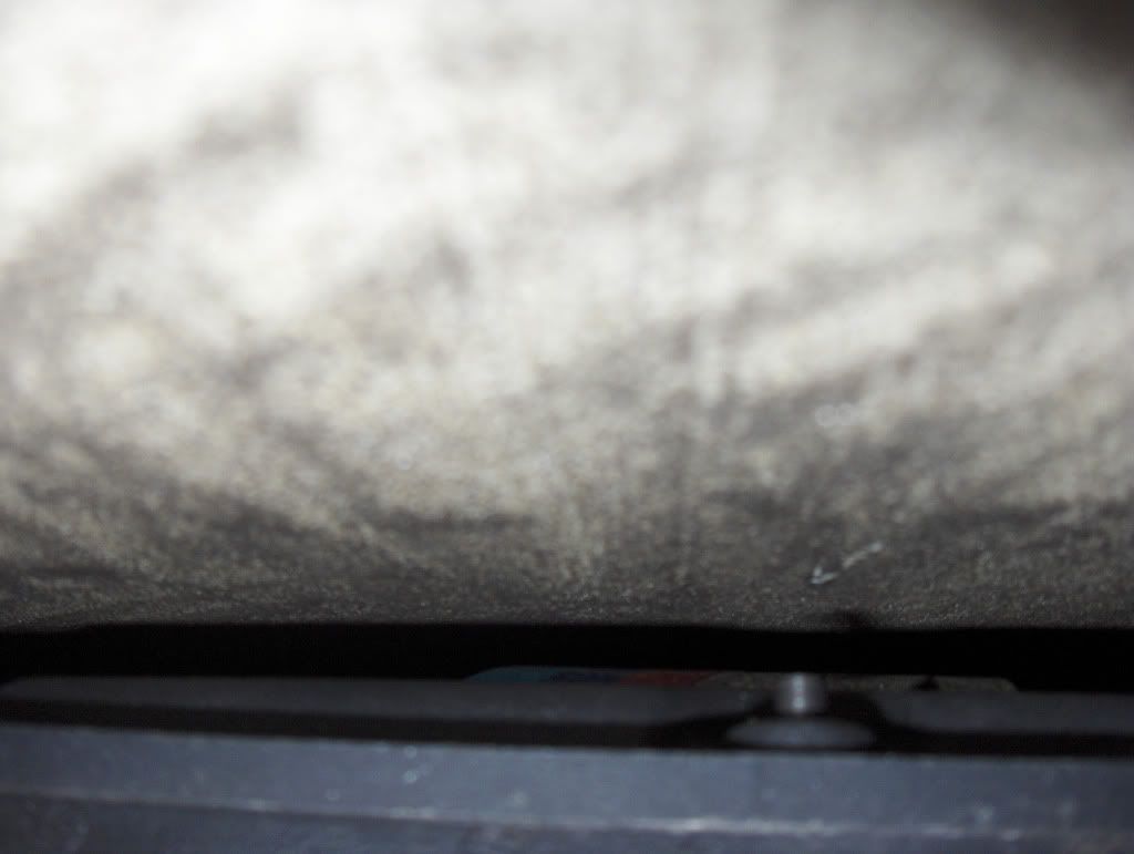

Here's how much bulkhead clearance there is at the moment...
I've not got the gearbox fitted, so the engine's pretty much plonked in there at the moment. I'm pretty sure I'll give the heater pipes a tweak so they exit parallel to the rear of the block which will give a little more clearance.
Cheers. Dave.

You'll find plenty of space behind the ashtray area if u haven't got aircon, the wiring should be plenty long enough to get to a decent mounting point. Let me know when are ready for me to do some wiring ;)

thats where i ran the engine harness on my s62 swap dave,
its where it felt 'right'.

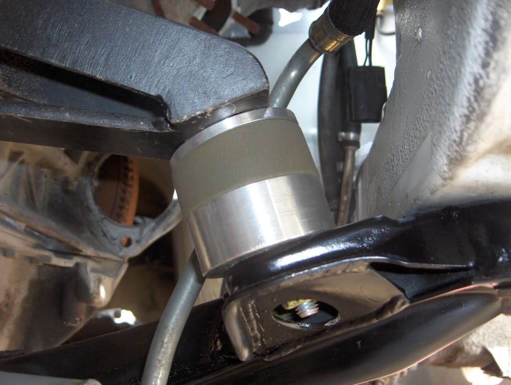

I had a mess about with my engine mounts yesterday/today. When I first did a test fit, I used a set of second hand E39 mounts which I bought off fleabay. They obviously weren't a matched pair, so when I noticed the engine was on the pi$$ a bit, I wasn't overly concerned. However, yesterday, with my new mounts fitted and rotated equally, the right hand side of the engine sat 10mm higher than the left.
The left hand engine mount was also getting a fair old off centre squeeze.
The problem was with the engine arms.
I must point out that these are NOT www.300mm.de parts, but replicas.
The seller of the arms offered a 10mm spacer and told me basically that they fitted ok. Now call me old fashioned,
but I prefer not to have engines mounted on the pi$$ thanks, so I cut the offending mount arm and rewelded/braced it so it fits correctly.
I'll post pics up if anyone's interested, but it's a pretty straightforward cut and shut job.
The real pain in the arse of all this, is that I took the measurements for my custom mounts from the incorrectly put together mount. I'll have a proper look when I bolt the arm back on tomorrow, but if I don't need to have the custom mounts shortened 10mm or buy another set of mounts, I'll owe myself a fiver.
Ah well, onwards and upwards!
Cheers. Dave.

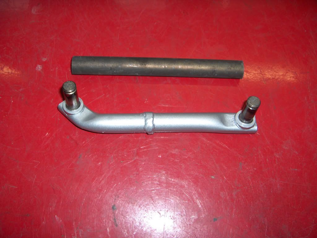

I had a bit of an engine lining up session earlier this week. As I said, the engine height was 10mm out from side to side. As I didn't say, it was also off centre too.
With a couple of solid spacers to give the engine mounts the correct height, a bit of jiggling and some spacers behind the O/S mount, I got the engine sitting level, and in line +/- just a couple of mm. The aluminium parts of the mounts are now at a local engineering company getting 3mm taken off each end.
When I get the mounts back, I'll be able to get on and test fit the gearbox, make a mount and shorten the gear lever rods.

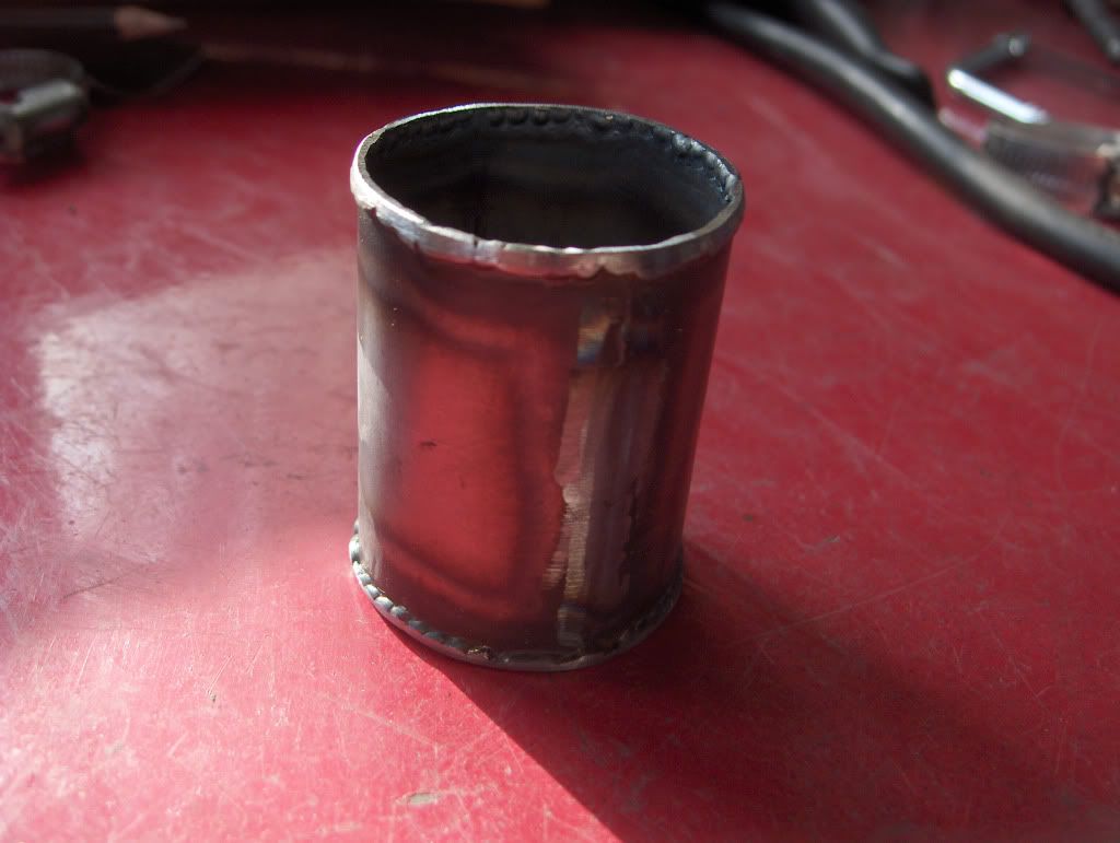

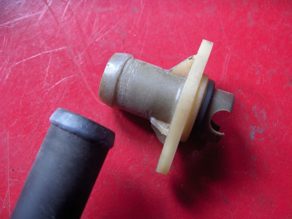

In the mean time, I wasn't keen on the heater pipes popping off the matrix, so I modded the ends with some Araldite and a file:
Does anyone know where I can get something like this, but with 19mm (ish) ends?
http://www.cbsonline.co.uk/product/Blac ... d_SBHJ1690

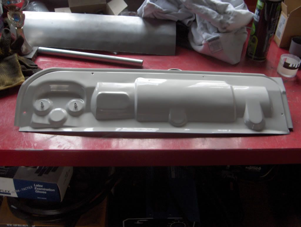

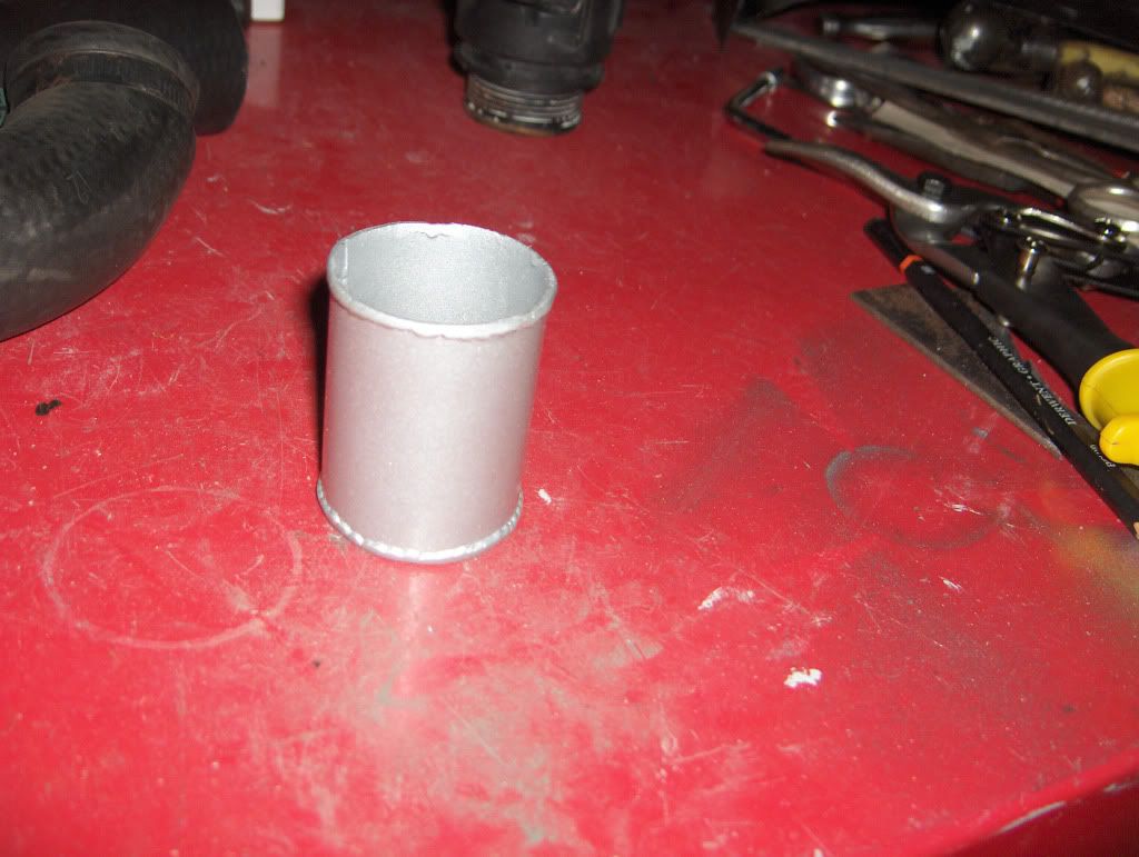

I also dug out the heater cover panel which I'd previously stripped of its sound proofing and looked like this:
I cut off the studs, beat out some of the pressed protrusions where the studs fitted, welded up a couple of holes, skimmed a bit of filler here and there, plopped a bit of paint on, and hey presto!:

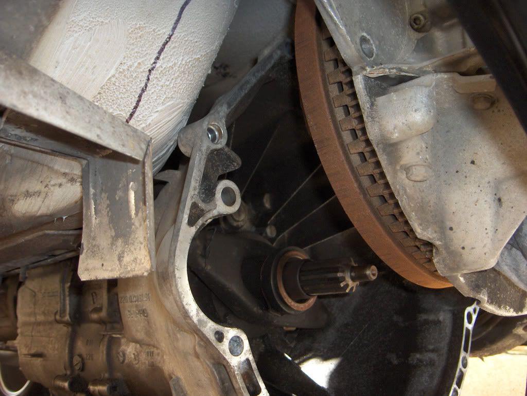

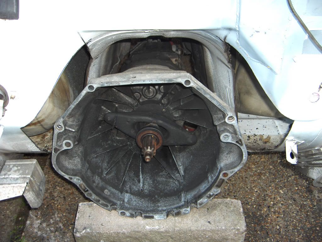

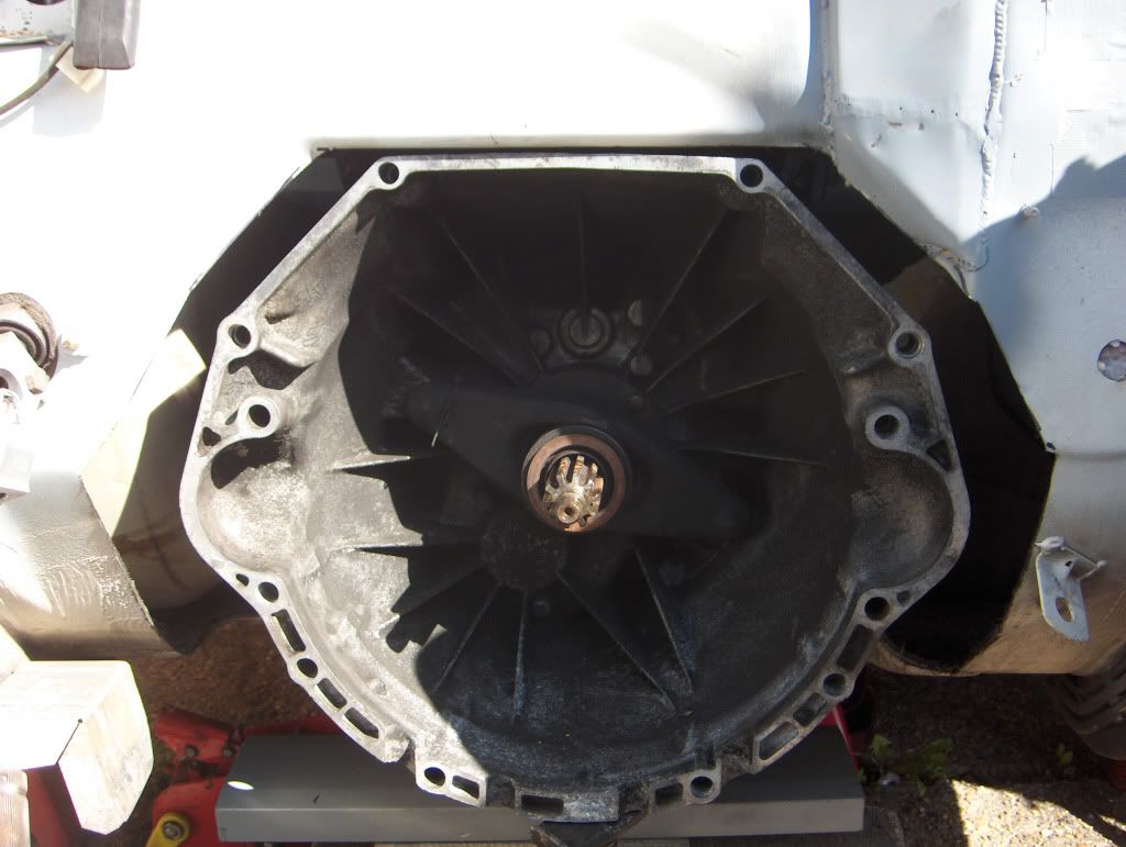

So, I got my engine mounts back, (now 6mm shorter than they were) and today, had a go at fitting the gearbox.
I decided I'd like to try not to use spacers between the chassis rails and subframe for obvious reasons (geometry/bump steer). I thought it might involve a little more work but (hopefully!) it should be worth it.
I also want to be able to remove the 'box without semi removal of the engine.
With the engine on its mounts (which I rotated foreward), and rocked back as far as it'll go, I got the 'box in this far:
In other words, a bloody mile off!
I did think about dropping the crossmember/engine, but seeing as I like to make things hard for myself, I stuck to my guns, popped the engine out, and got the grinder.
Before:
After:
To be continued!
Before:
After:
To be continued!

davethegoat
- Posts: 455
- Joined: Fri Oct 28, 2011 11:00 pm
It might be a bit drastic Glenn, and *maybe* I could have got away with a bit of massaging with an Irish spanner, but, it would probably have looked pretty $hite. I know it wouldn't be seen without a proper look when the engine and 'box are fitted, but I would have already seen it!
Also, like I said, I want it to be possible to fit a clutch without it being an utter ball ache.
Brave? or... the other one Turk?!

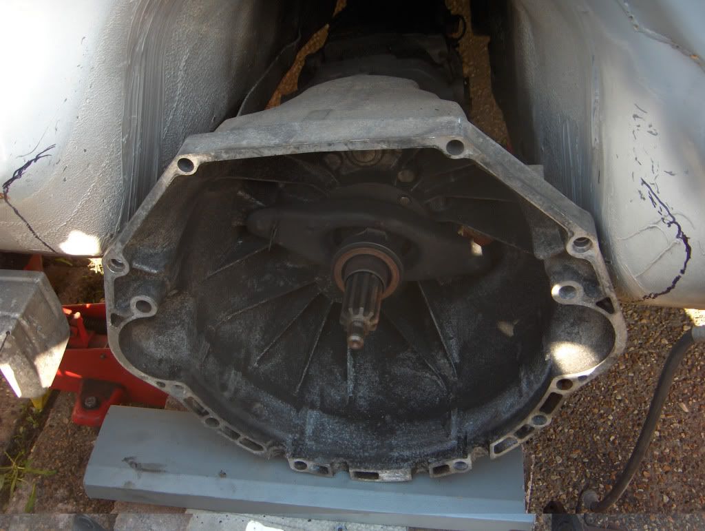

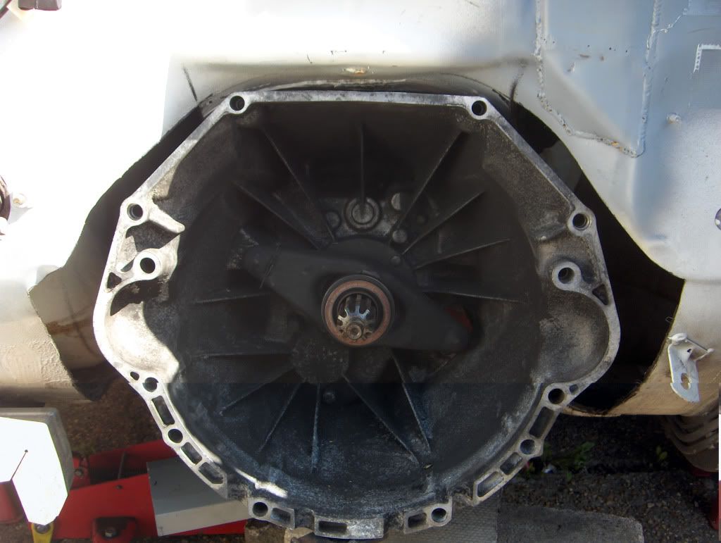

Anywho, the bloody 'box still wouldn't go in with the engine fitted! It needed to go up a bit from here as the top of the bellhousing fouled the top of the transmission tunnel:
So, I popped the engine out again, and did some more cutting
It's still tight going in, but the gearbox now fits when the engine's rocked back on its mounts.
With somewhere close to 10mm between the rack and the sump, and the gearbox topped out on the transmission tunnel, the engine sits tilted back way too far
The only way I can think of getting it to sit level, is to cut and extend the transmission tunnel upwards. However, this (at first glance) will mean that the centre bearing will need to be moved higher into the transmission tunnel too...
I don't suppose you remember roughly how much sump to rack clearance you ended up with on your engine Glenn? Did you get your engine sitting pretty much level?
Cheers. Dave.

i think i had about 10mm clearence between the sump and the rack's top mountings, and then the bonnet would close, albeit very close!
to get the gearbox on, i had to do it the same way as my current swap.
the engine is lowered into the bay, without the crossmember fitted. then the gearbox was fitted, then raised back up into the bay and the crossmember refitted etc.
i didn't think i would be changing clutches often enough to be bothered about the hassle of doing it this way.

the engine was level dave, and i didn't need to touch the tunnel.
as with all of these big engine swaps though, the tolerences become very tight!
i've seen me lift the engines 'in & out' lots of times, because measurements for spaces are critical.

I removed the mounts (again) yesterday, and replaced the 25mm tall flexible part of the mounts with 15mm ally spacers. The engine now sits pretty much level.
I still need to have a jiggle about to get it exactly where I want it, but it's close enough not to give me nightmares now.
Funnily enough Jonsku, where it's sitting now, I have just about exactly 3mm clearance!

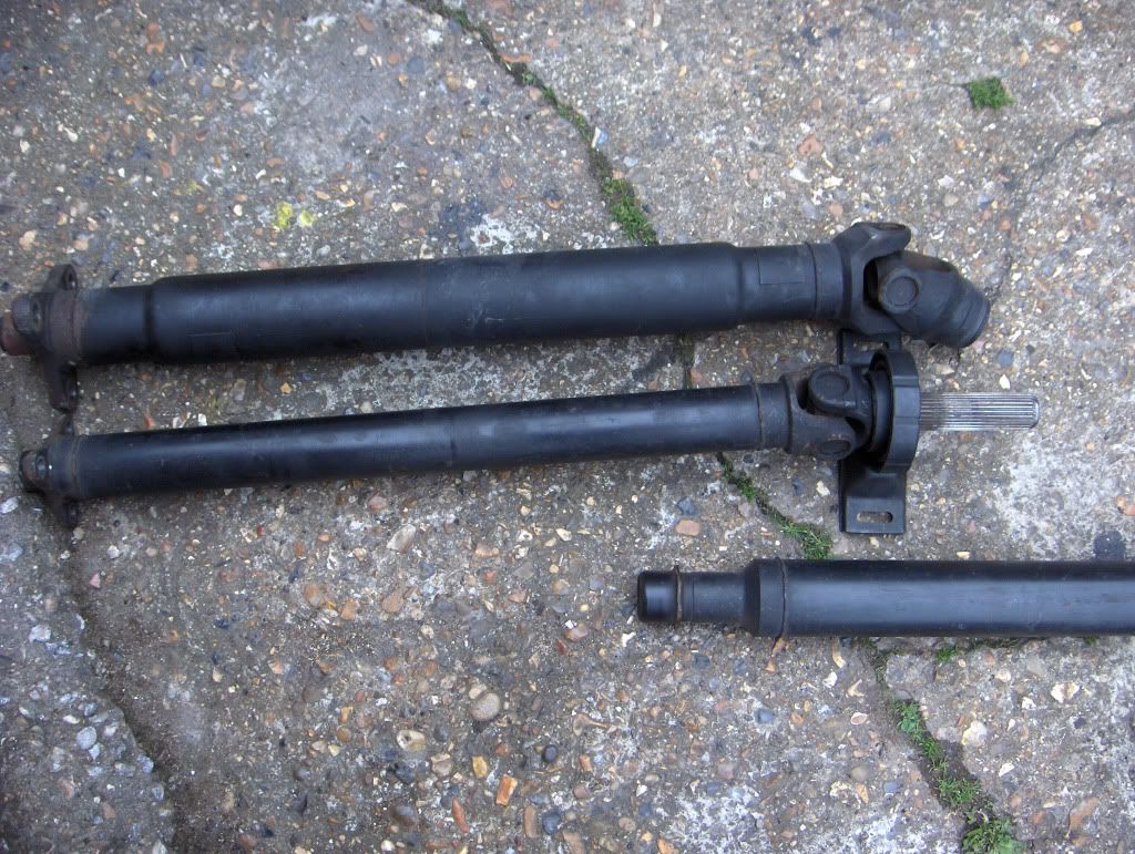

I ordered the front half of an E34 540i propshaft today.
Hopefully it'll be with me in the next few days. I also ordered a new Lemforder centre bearing, so I'll be able to have a measure up and find a company to make it all fit together. I'll get a new rear U/J fitted too while I'm at it.
Once I line up the prop, I'll knock up a gearbox mount.

Cut, test fitted and welded the steel part of the gear shift linkage. (I'll get the aluminium part welded by someone else):

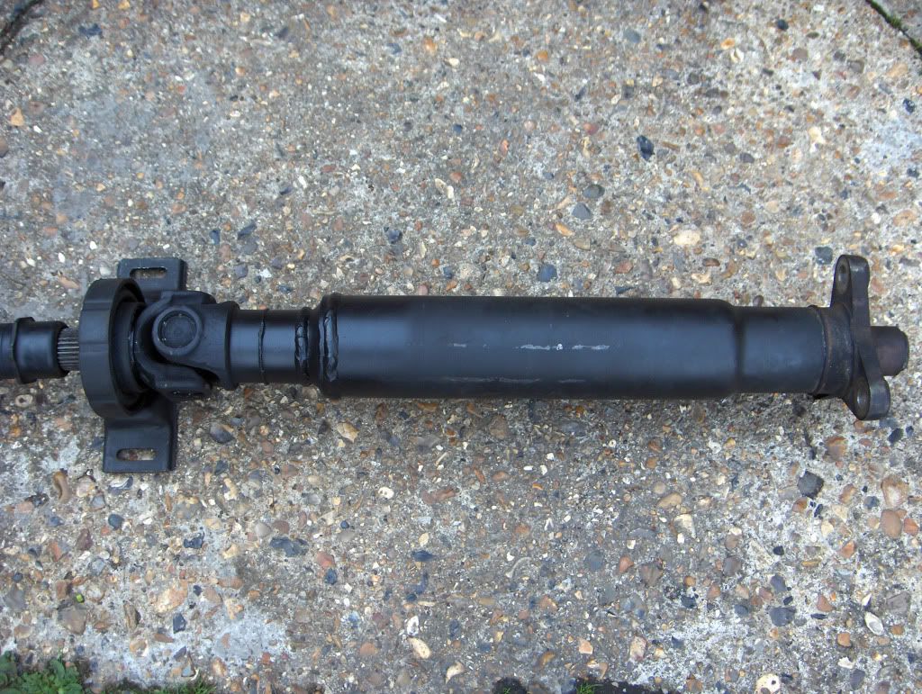

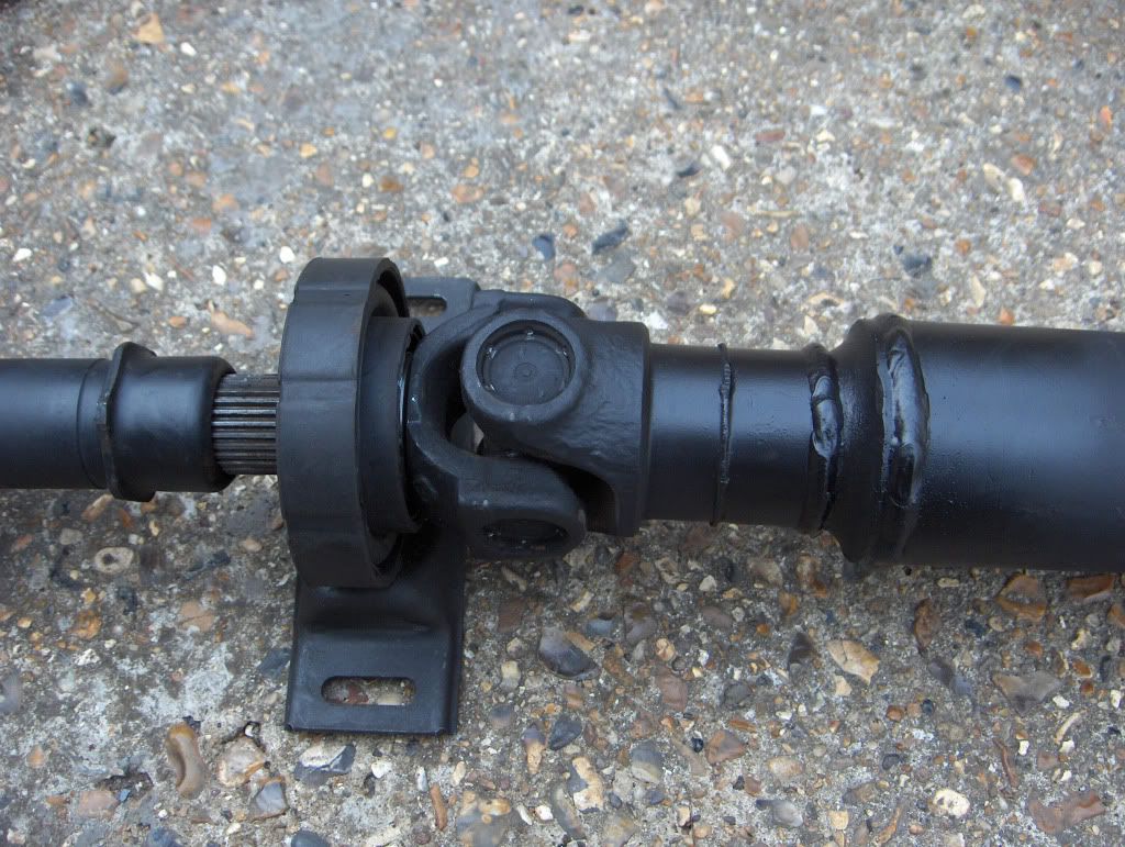

I've not got too much done in the last week. Life has got in the way somewhat!
The 540i prop turned up the other day, along with the centre bearing.
I'll get it measured and drop it off to get sorted at a company not a million miles away during the week hopefully:

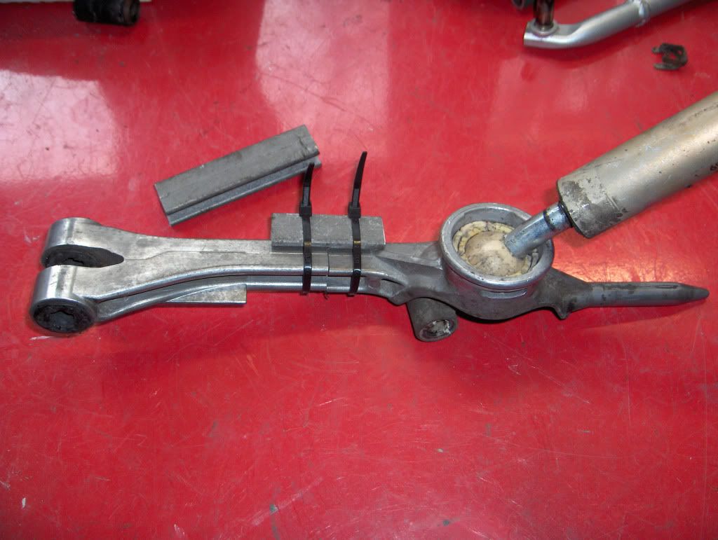

I used the old (knackered) centre bearing with what remained of the rubber cut out of it to line up the gearbox, and started on a gearbox mount. I was after some smaller steel channel than I ended up with, but anything smaller was seemingly near impossible to get hold of.
Anyway, I don't think it'll break!
Here it is unfinished. It might end up being a fair bit shorter at its front ends, and shaped a little more. Hopefully it'll look less like something from a bodged tractor when it's done!
Here's the top hose which I test fitted last week:
I tried to get some decent pictures of bonnet-airbox clearance Jonsku, but couldn't, so here's a cr@p one!
I'll have a mm or two more when I tighten the engine mounts and bolt the airbox on without a lifting strap under the right hand rear of it.
Another at the centre (front). (You can just see the "M" badge)

I have been thinking about my gearbox mount though. I might have dropped a bit of a ball. I'll have a proper measure up before making an @rse of myself on here (when I get a chance), but there's a possibility that I'll be starting again with it.
Let me know what you need pics of and I'll fire some over.
That's properly tight clearance Glenn! I'm hoping to get my prop back this week, so I can get everything aligned spot on, then get every last millimetre of clearance left!
IIRC, you used an M5 prop with E30 rear U/J? Did you use the M5 centre bearing? Is it offset like a stock E30?
Cheers! Dave.

That looks like a tight fit there!
Don't remember, did you drop the front subframe?

I'll be able to get a few more mm's there, but yep, it's pretty tight!
Nope, no subframe spacers.
I managed to grab enough time to get my tape measure out today.
As the gearbox sits on its rear mount now, (mounted to the chassis in line, but further back than standard) the 'box is somewhere close to 15mm offset to the right. Mounted like this, the prop lines up with the standard E30 (offset) centre bearing. The diff flange is offset (also to the right) by somewhere just short of 20mm.
Now, 15mm's difference from the front of the engine to the rear of the gearbox is barely anything in terms of alignment angle, but the pedant in me says that it should be in line.
However, as the diff flange is also offset, running a little offset at the gearbox gives the propshaft a straighter run, so less strain/possibly better reliability.
So, what do you reckon guys? Engine and 'box in line? Or offset?

Is the E36 325 TD Prop suitable for a 6 speed box? I've had my prop sorted now, but it'd be handy to know for future referance.
Here's (the modified bit of) mine:
The company I used didn't want to weld the prop tube directly to the U/J, so, as you can see, they made a reducer.
Looking down the driveline toward the rear of the car, the prop is offset to the left, so to the right hand side of the car, so, should be ok.
Yes, I lined up the engine/gearbox to line up directly to the offset centre bearing.
I'm still torn between getting it lined up completely straight, or leaving a little offset to give the prop a slightly easier time...
I should be able to grab enough time to fit the prop and get a pic or two tomorrow..

To calculate what diameter tube is required, I need some cam timing figures. Specifically, the number of degrees the exhaust valves open before BDC at 4,500 RPM. I'm (as the Chinese would say) frucked if I can find any figures for the S62, but I've got some for the M62, which should do the trick if I can't find any further info.
I'm pretty sure the manifolds will be made of mild steel with some kind of coating applied to stop rust, and act as a thermal barrier. Anyway, that's a while away for now.
