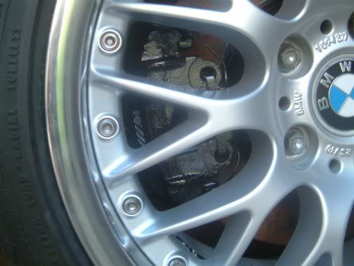

measured them this evening james and yes they're 315mm.jmc330i wrote:Ive got a list like that - its massiveglenn wrote:but it's on my long list of 'must remember to do that' jobs![]()
Those discs 315mm then? I nearly got hold of a set of E36 M3 stuff, but TBH, Im glad I didnt - I dont want to run 17s and I dont think those discs and calipers will fit behind 16s
also wire brushed the calipers and painted them black.

Thanks Glenn.glenn wrote: measured them this evening james and yes they're 315mm.
Glad I didnt get them now, Im sure they wont fit behind the 16" BBS.
I bet the calipers look 10 times better now

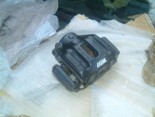

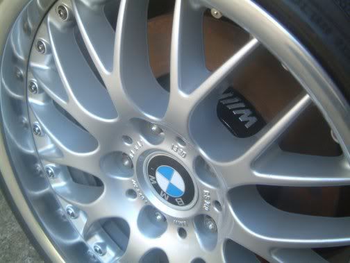

here you go!I bet the calipers look 10 times better now

That looks so good with the M emblem on, again another little acheivement for glenn, soon it'll all be together and you'll be blasting down some A roads enjoying your work

And those calipers with the ///M looks

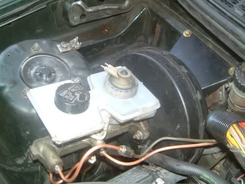

power steering all on and connected up, just needs toping up with oil.
had a little oil here but not enough.
cant try it yet as the exhausts are off at the moment

got to pick up a new brake pipe tomorrow to link the master cylinder across the bulkhead, i can then try the brakes.

i changed the servo and master cylinder today as the one that was on there didn't have big enough pistons to supply to slave's.
i've now got a 25mm piston master cylinder set-up off a mk3 transit.
my mate own's a breakers, not too far from me, so i had the servo and master cylinder for a tenner.
changed it over today with a few small modifacations,
and now the brakes feel fantastic!.
next job is to sort the handbrake.

Thats one very full engine bay !
Makes mine look like a toy dinky engine
Apart from the hand brake have you got much left to finish ?
