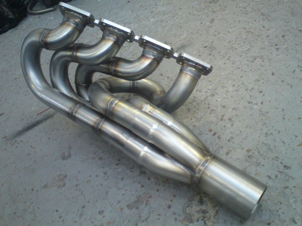

I've been picking away at some exhaust calculations over the last day or two, and went to see a guy pretty local to me with the intention of ordering some mild steel bends, flanges and wot not to knock some exhaust manifolds up.
I was thinking of modding the E39 manifolds, or (as suggested by Turk) using modified X5 manifolds. (Left hand drive ones Turk?)
Yesterday I had a quick go at fitting the E39 drivers side manifold to see how it'd work out. One part bolts straight up, and even looks like it might clear the steering column. The other part would need a fair bit of chopping about, and probably require the first pipe to be modded to fit.
So, as well as looking like poop, they'd be a PITA to fit... I didn't bother looking at the left side.
I'm aware that they work, and are a easy solution, but the X5 manifolds also have all the grace of a misfiring tractor with buckled wheels towing a trailer full of steaming manure IMHO.
Anyway, I digress. As I said, the manifolds were going to be made in mild steel, then plasma coated for protection against corrosion and to keep under bonnet temps down a bit.
It turns out though, that the cheaper options of plasma coat don't last, and the proper stuff is hideously expensive. Like way over £500 for a pair of (long) manifolds expensive. :eek:
So, the upshot of all this is that I'm pretty sure my manifolds will be stainless. Seeing as I've only had around 10 minutes practice at TIG welding, my car will be taken down to the guy's workshop in (hopefully) the next couple of weeks for a set of equal length lovelyness. Luckily, as well as being pretty bloody handy at making exhausts, he's a decent fella, and agreed to let me give him a hand to keep costs down a little. 8) (I make a decent cuppa if all else fails :D )
I'm a bit gutted not to be making them myself, but if you can't do the job properly yourself, then find someone who can... (even though it'll cost a ton of money :cry: )

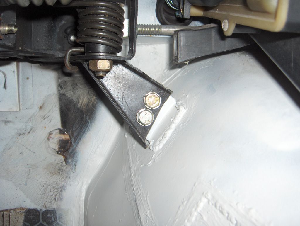

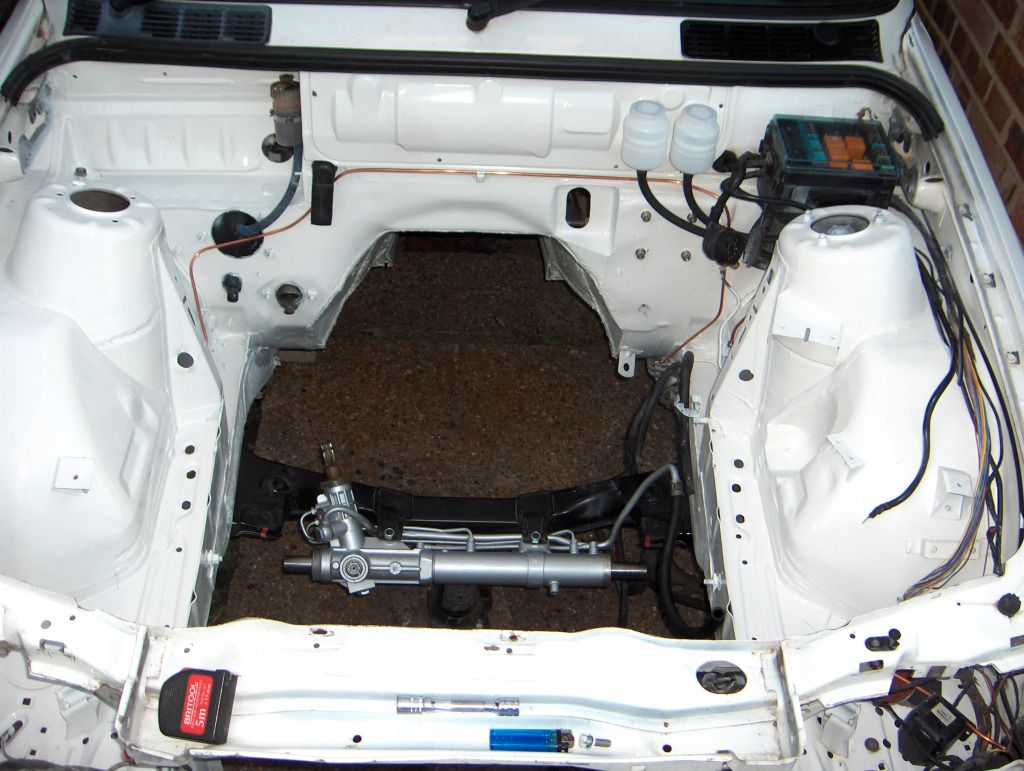

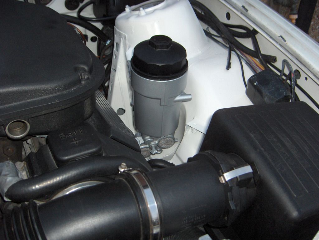

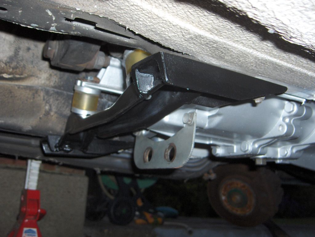

I've not done a ton of stuff of late, but next time the engine, it might actually stay there. winkeye Consiquently, I've been doing a few bits and pieces in the engine bay.

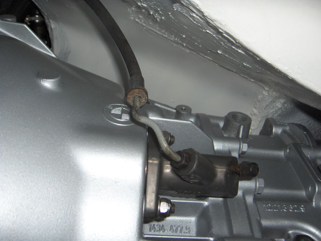

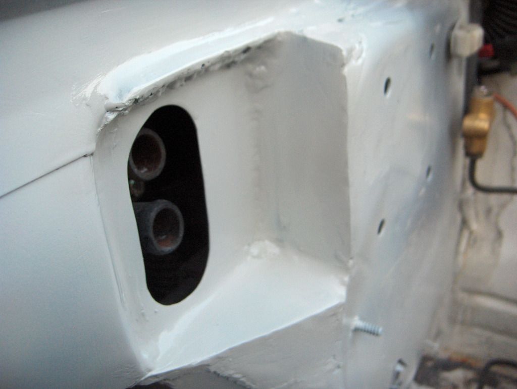

I boxed the section of the bulkhead ages ago with the intention of running the heater pipes out of the matrix, along the inside of the bulkhead to the left, then out into the engine bay to give a decent amount of length to the pipes. Since then, I've got the engine fitted a little further rearward, which resulted in the left hand inlet cam position sensor being very close to the box I'd made.
To cut a(n already!) long story short, due to routing hoses etc, I cut the box out and went kind of back to the future. :mad: :
I threw some paint on it as the man on the telly said rain was coming. He lied.
The pipe exits are set back a little more than they were, but over all, not a massive gain for the work I've put in to it! :roll: Well, it'd all be a bit boring if were straightforward eh! :mad:

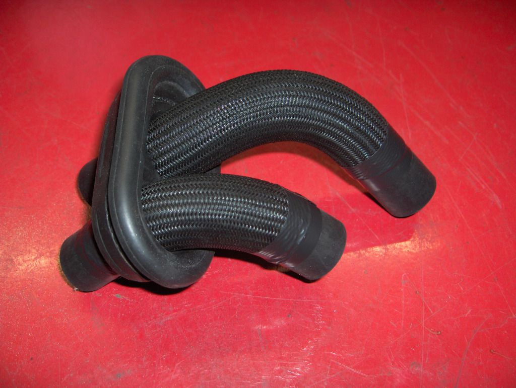

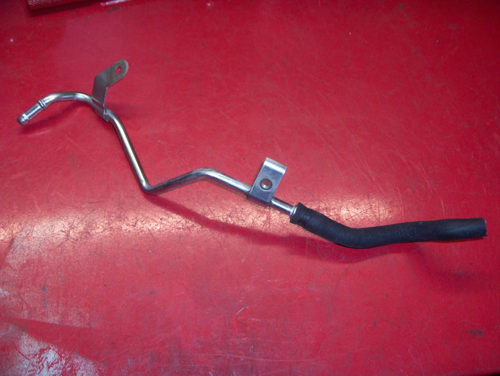

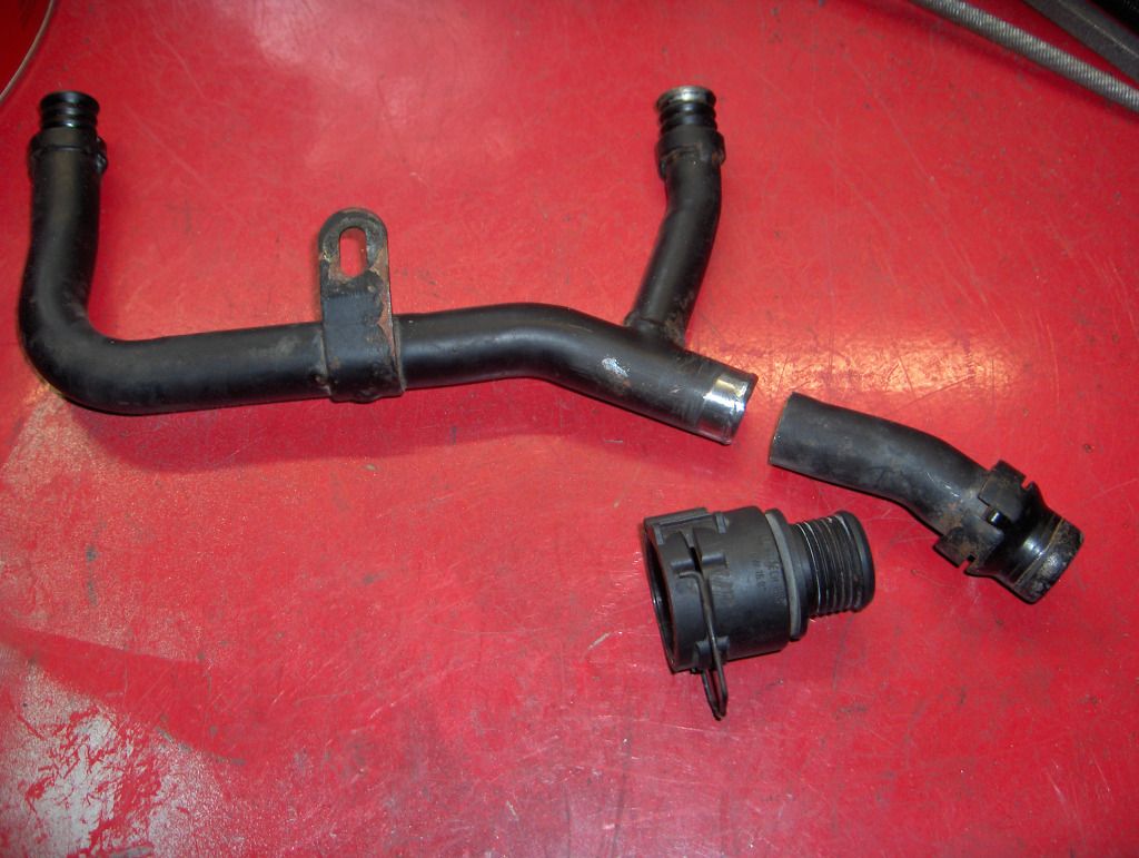

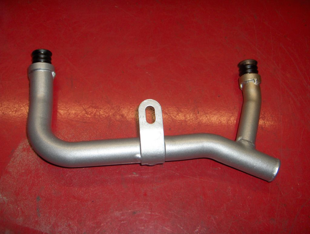

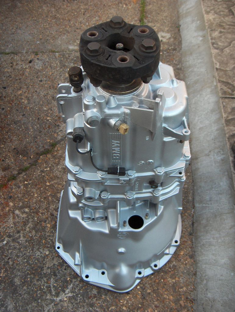

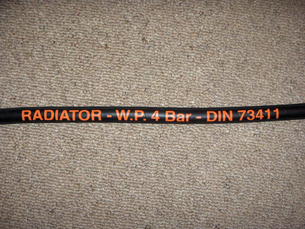

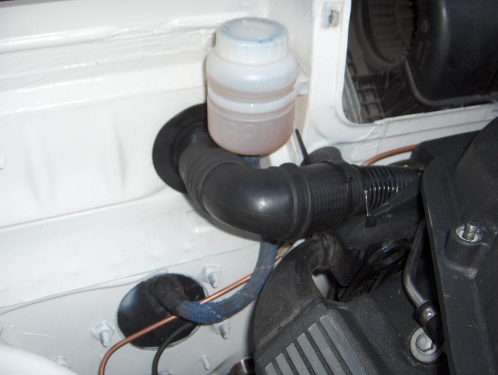

To get a bit of length back in the heater pipes, I cut the standard quick release hose attachments from the engine side (which were angled too far towards the bulkhead anyway). I'll weld a couple of beads on the end of the pipes and get a pic tomorrow. :) I'm pretty sure the pipes won't give any trouble, but if they do, I've now got a decent plan B. :)
I also gave the gearbox a proper clean (bloody hose pipe ban meant I couldn't use my jet wash :roll: ) and gave it a coat of paint. :

willnz wrote:That manifold is just naked sex!!! :D
It's nice Will eh! winkeye
I can't wait to get my car down there now!
Here's one which he did for an RX7:
The guy is down near Purley, Surrey Germangorilla, which is way closer than Salisbury to me. :D Your Wiltshire guy is obviously good too. 8)

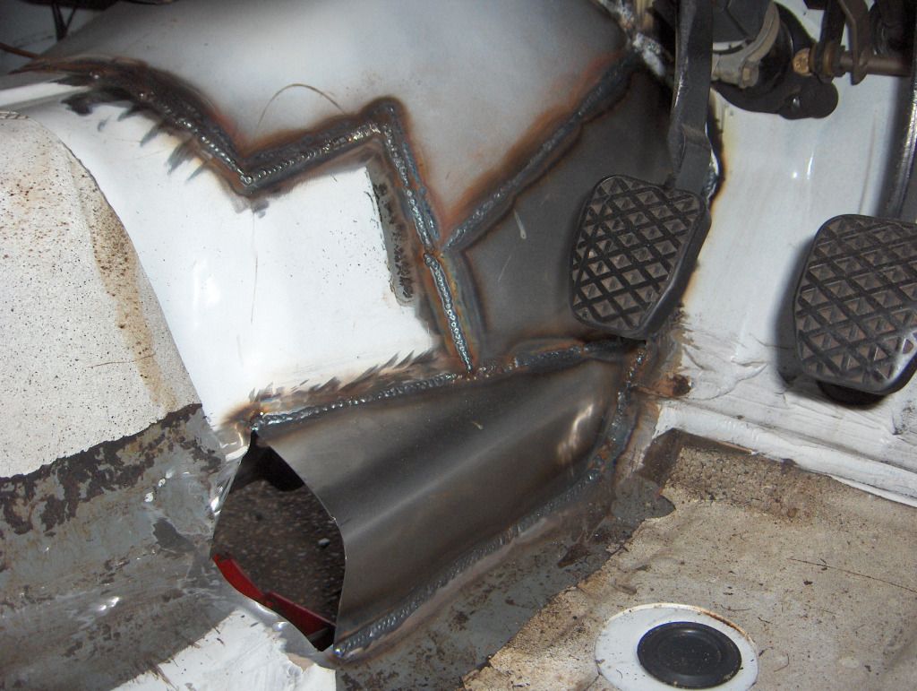

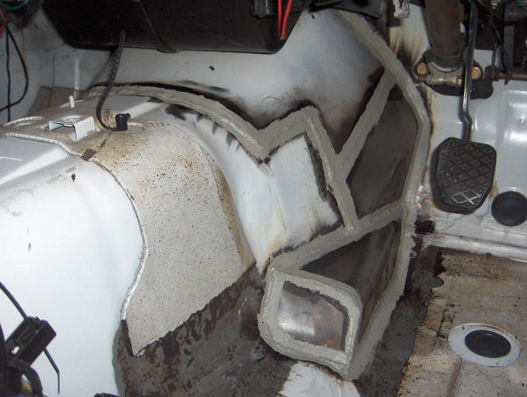

I've been doing a spot more welding. :)
The extension piece(s) where the tunnel meets the floor are where (when they are finished) the 4-1 exhaust collectors will live. (The primary pipes will be somewhere close to a metre long.) Hopefully the rain will stay away for a bit so I can get the welding finished, seam sealer, and underseal it. :D

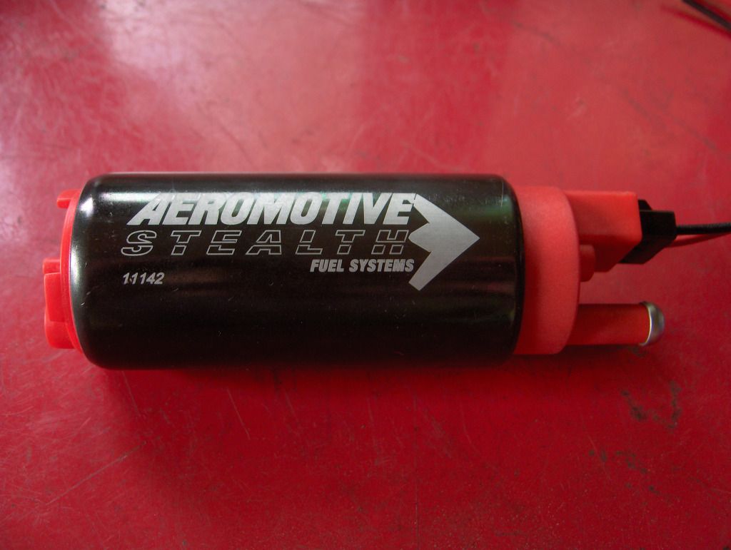

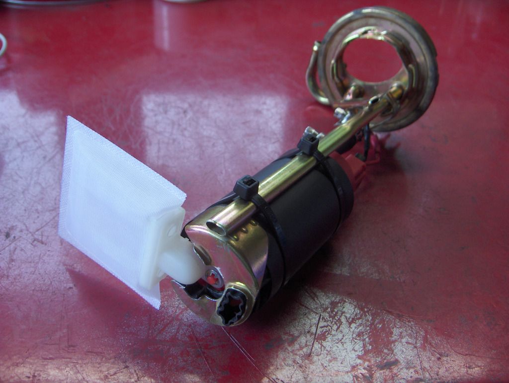

Righto, seeing as the weather has scuppered my plans for today, I've done a bit of reserch into pumps and wot not.
I might go for an (hard wired) Aeromotive 340 stealth pump. They're an in tank pump (so more convienient than an 044 Bosch), and are quiet. They also compare well to an 044 in terms of performance.
http://forums.evolutionm.net/automotosp ... -test.html
It would be nice to find one at a good price mind!
That and an adjustable FPR should do the trick. :D
I'm pretty sure I'll not bother with a swirl pot for the minute. If I run into any problems, I'll fit one, but for the sake of making sure the car's got a bit more fuel in it *if* I take it on track, it's a bit overkill.
I've got a standard E30 fuel filter lying around. How are these regarding restriction?
Thanks again GermanGorilla! :thumb:

Why not run the 044 in-tank? I did that on my E36/LS3 hybrid and it works, holds the pressure rock solid at 60psi.

[/quote]Why not run the 044 in-tank? I did that on my E36/LS3 hybrid and it works, holds the pressure rock solid at 60psi.[/quote]
For some reason I missed that as an option Yamoda! :mad: Even stranger seeing as I had an 044, in tank on a previous car... Cheers. :)

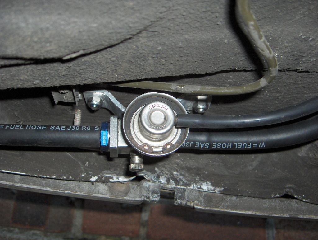

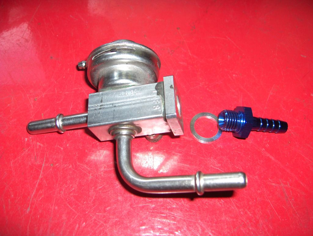

I've done a bit more reading up on dead-head fuel systems. There's some interesting reading here: http://www.centuryperformance.com/mallo ... pg-81.html
I think for now, I'll run an upgraded, in tank fuel pump with the stock FPR. I may well look again at a dead-head system in the future, but I'd prefer to keep things simple/avoid any potential issues for the time being. :thumb:

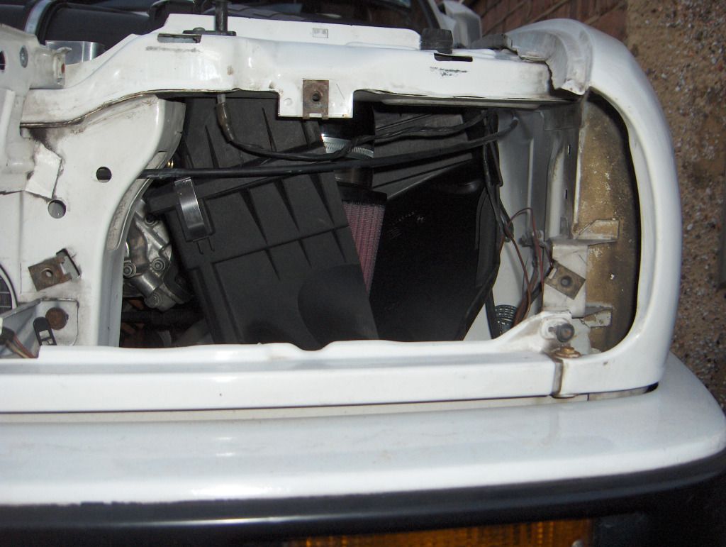

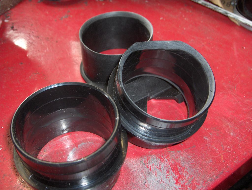

I planned to get the welding I was doing finished over the weekend, but today went: Weld a bit, hastily pack away because it's started raining, get stuff out again because it's stopped raining, pack away because... etc. Luckily, I ran out of welding gas and had evidently used the spare bottle that I thought I still had, so that put an end to it! :roll: I started to prep the engine bay for a splosh of paint, but 5 minutes in it started raining again, so I popped the bonnet on, went in the garage and finished my airboxes.
Of course, the sun then came out for the rest of the afternoon. :roll:

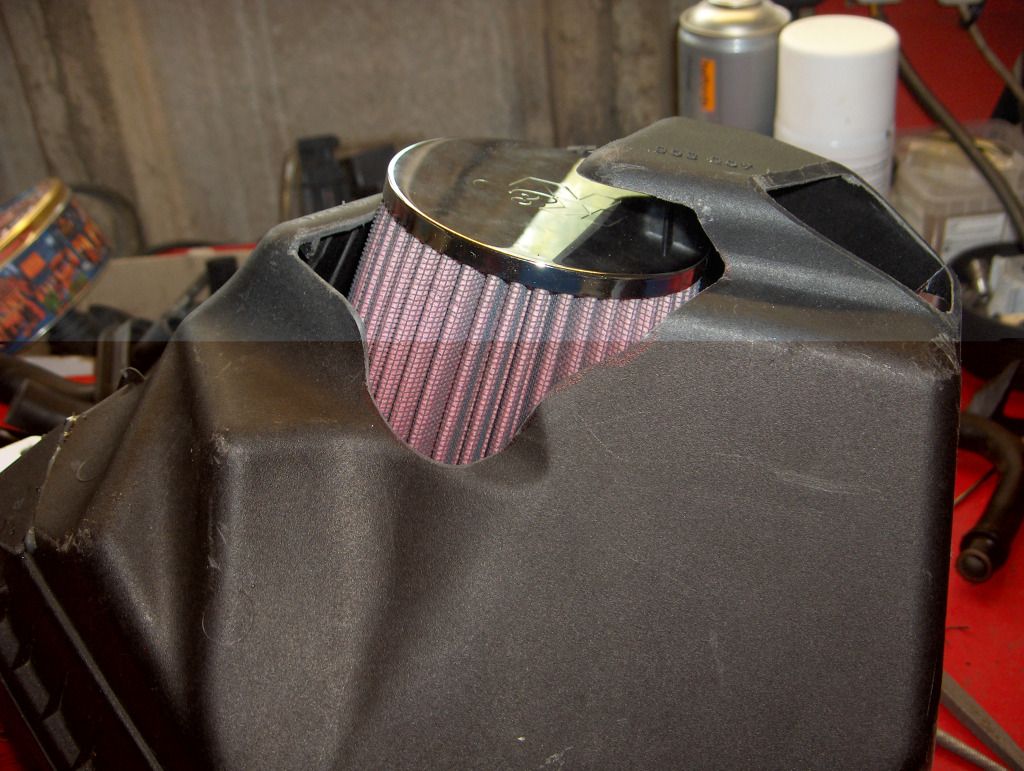

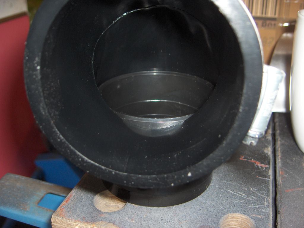

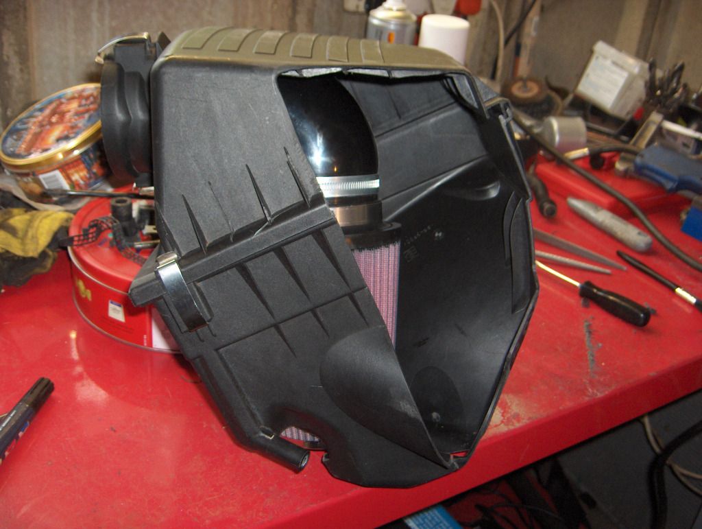

Anyway, where I'd shortened the elbows, the ends of the adapters protruded into the bend:
So, I removed some material, and got rid of the square edges on the adapters and airbox tubes. Here's a before and after kind of thing:
I've got some filters turning up this week hopefully. I've ended up going with K&N's which I got a very good deal on. winkeye

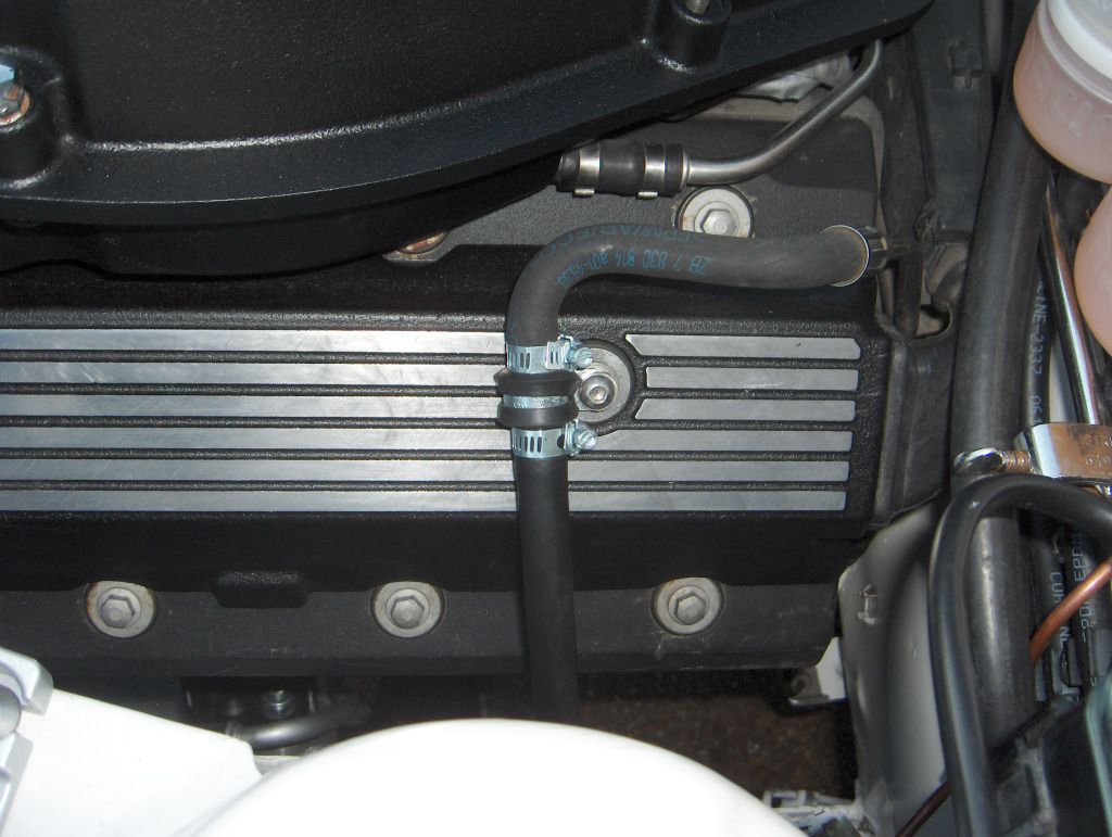

Today, I removed this:
I cut the pipe which it was attached to on the engine end and plugged it. Did you remove the valve which the pipe feeds Glenn? Having a load of stuff on engines which does nothing makes me mental, but I don't want to remove anything that's going to stop it running! :mad: I was going to wait 'till it was wired up and check whether it has a live feed, but it'd be nice to get as much done as possible before I fit the engine again. The same with the EGR valve too Glenn? :D
I robbed some of the hose protection from the lower half of the steering reservoir pipe, and popped it on the heater pipes which will exit the bulkhead. I don't want them leaking. (The shorter pipe will have a connector and another length of pipe on the end of it) :wink:
Also, I finished the heater hose feeds from the engine. I like the quick release hose connectors, but they're pretty bulky, and where I want my engine sitting, one of the pipes rests on the bulkhead. Also, a bit more length in the heater pipes will be nice. So, I cut the ends off the pipes and welded a bead on the end:
Then gave it a paint. I left the heat gun pointing towards it to dry/harden the paint, but it got a bit hot and burnt the paint. :oops: I best have another go at that tomorrow then!
My filters turned up. :D I couldn't get the filters that would have been an easy fit, so I got slightly larger ones and cut the airboxes to make them fit. :)
Front view:
Bottom:
Haha, I said bottom!
I'll bond a rubber grommet to the airboxes under the filters to be 100% that the won't move/rub.

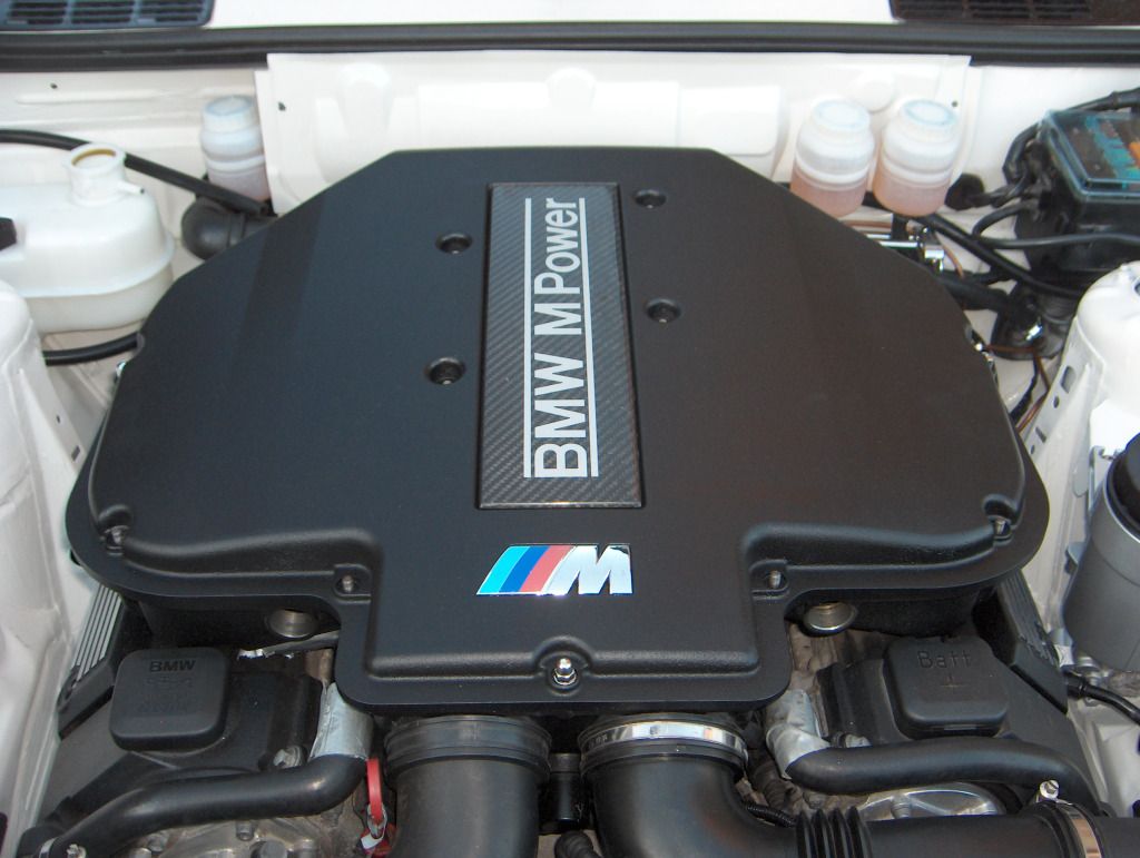

I finally got round to taking an engine bay picture today. :) :
The gearbox tunnel is finished externally. Seam sealed, primered and a ton of stone chip.
You might have noticed that I've got a pair of master cylinder reservoirs mounted. I'm about half way towards finishing the brake pipes too. :)
There were a couple of small bits of surface rust on the gearbox tunnel inside the car, so I got a load of rust treatment on it, then some seam sealant. I was going to mask it to make it nice and tidy, but I'm going to have some kind of carpet over it (and I'd ran out of masking tape), so (for once) I decided to give myself an easier time of it. :mad:
Cheers! :D

The interior of the gearbox tunnel has paint on it. The pedal box bracket is a little shorter than it used to be.
I finished the brake pipes, fitted the engine and 'box, (for hopefully the last time :D ) and modified/painted my previously tractor like gearbox mount:
I used the E39 clutch slave, and tweeked the E30 clutch pipe to fit:
Fitted a clutch fluid reservoir, and gave it a bleed up:
The bulkhead now has a reamed out E30 grommet for the engine loom. Even with a load of lube, it was still a tight enough fit to make my thumbs feel like they've been peeled away from my thumb nails after fitting it. :cry:
The airboxes are now in too. The outer rear of the headlamps are tight to the filters, but with the plugs on the back of the lights turned 180 degrees, they fit in there just so. :D (Phew!)
The oil filter housing was looking a bit less than new, so I gave it a clean and a splosh of paint. It was silver, so I painted it silver again. It might end up black yet though.

I got a few bits and pieces delivered the other day. I'd ordered some black, (yes, I said black,) coolant hose. A package arrived, and I thought "That'll be my black coolant hose". I opened the package and found this!:
WTF! :eek:
That pretty bright orange writing runs the entire length of the pipe.. Well at least I can be sure it's suitable for radiator hose I suppose! :? It's also pretty suitable for being sent back in the post. I can't help but wonder who thought that would be a marvelous idea??!

I've also had a look at where the stock M5 fuel filter/FPR will go. As a complete unit, there's no way of tucking it under the car so it's out of the way enough to keep me happy. So (if I use it complete) I think I'll mount it in the boot. Or, I *might* use a stock E30 filter (because I've got a new one), with the M5 FPR tucked away just downstream of it.
Cheers! D. :)

i too used the e30 filter, and mounted the regulator up near the n/s turret/fusebox area.

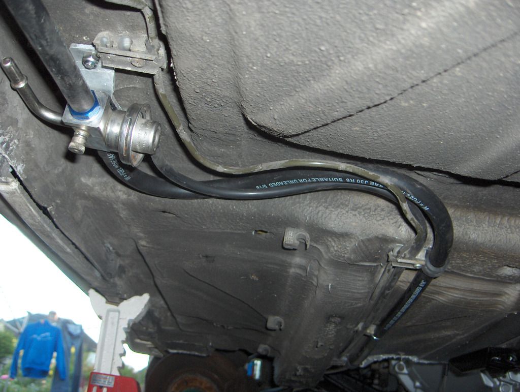

Cheers Glenn. :) I thought about mounting my FPR up by the fuse box, but as suggested by yourself and GermanGorilla, I found a space to tuck it away near the fuel tank. :)
So, I removed the FPR from the filter and screwed this hose adapter on:
Hopefully, with some decent clips it'll hold 5 bar without popping off!
I made a drop bracket out of a bit of ally I had hanging around, gave the rear brake pipe a tweek, bolted the bracket to the floorpan, chopped the standard hose holding brackets down so that P clips would fit on the side of them, fitted a new (standard) fuel filter. A couple of feet of fuel hose, and a few clips and that'll be ticked off the list. :)
I'll more than likely get some kind of heat protection for the front portion of the fuel pipe, and probably some crimp clips to hold the pipes on.
Also, this turned up:
So I got a hacksaw, file and soldering iron out and fitted it to this:
As well as the insulator sleeve which came with the pump, I managed to use the standard bottom pump rubber, so hopefully it should run nice and quietly. :D

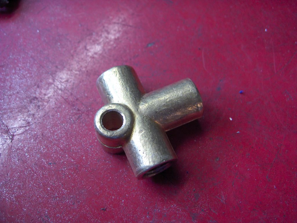

I've been quietly having a small nightmare with leaking brake pipes since I fitted them. The ends were all sealing perfectly, except for the ones going into the T piece I'd bought:
To cut a long story short, after re-making all the pipes and buying another T piece, it turned out that the T piece seat angles were too sharp. This was causing the brake pipe nuts to bottom out before putting enough pressure on the pipe flares to seal them. :roll:
So, I found a drill bit which had less cutting angle than the seats, got my hand held drill out, and re-angled the seats. I didn't think I'd be able to hold the drill straight enough to leave the threads undamaged, but by some miracle, I ended up with all three seats re-angled with un-damaged threads! :eek: winkeye
Hey presto! No more leaks. :D

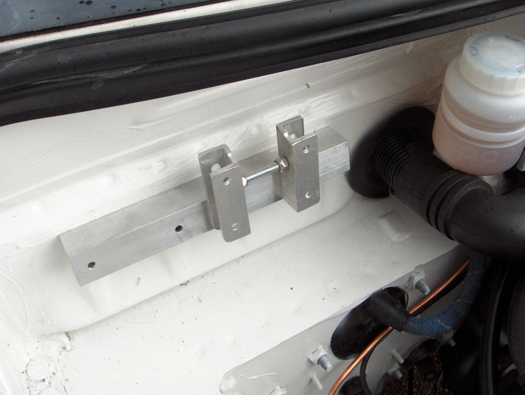

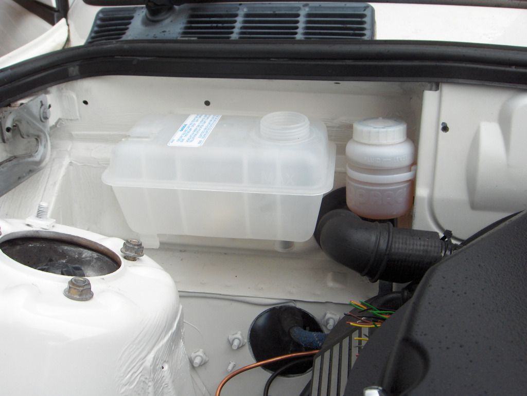

I'd bought an E30 M3 header tank, but the main hose routing was just that bit too much of a compromise, so I had a good search on the internet and bought another one.
Then, I made this:
And slid my new header tank onto it:

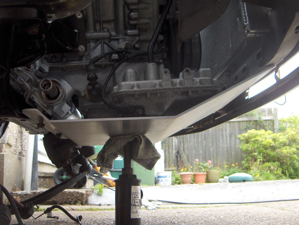

It's pretty close to the front face of the sump. I'll have a fiddle with it when I get a minute, but I might end up getting another bend or two put in it for extra clearance.
