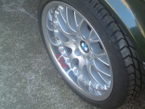

I am planning an S50 and 5 stud conversion in a touring and noticed you have E36 front end. Just a few questions.
Do you have the part number for that eccentric bush thingy and how much?
What Rim width and offset wheels are those? I was thinking of using E36 328iS split rim BBS ones but would like to tuck the tyres well into the arches.
Do I need the complete strut assembly (like this picture) Plus the calipers.
Was gonna try to source Z3 or E36 compact bits for the rear end.
Keep up the good work!

sandy,
i've replied to your pm,
just let me know if you've got it, as it keeps coming up' not sent'
