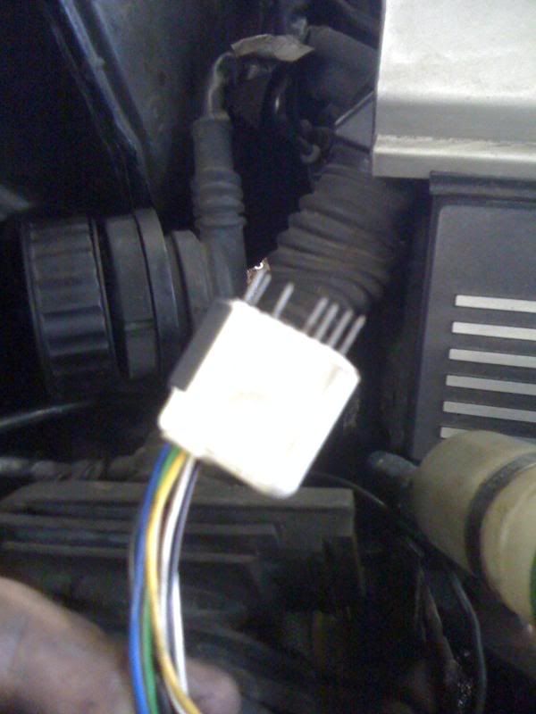

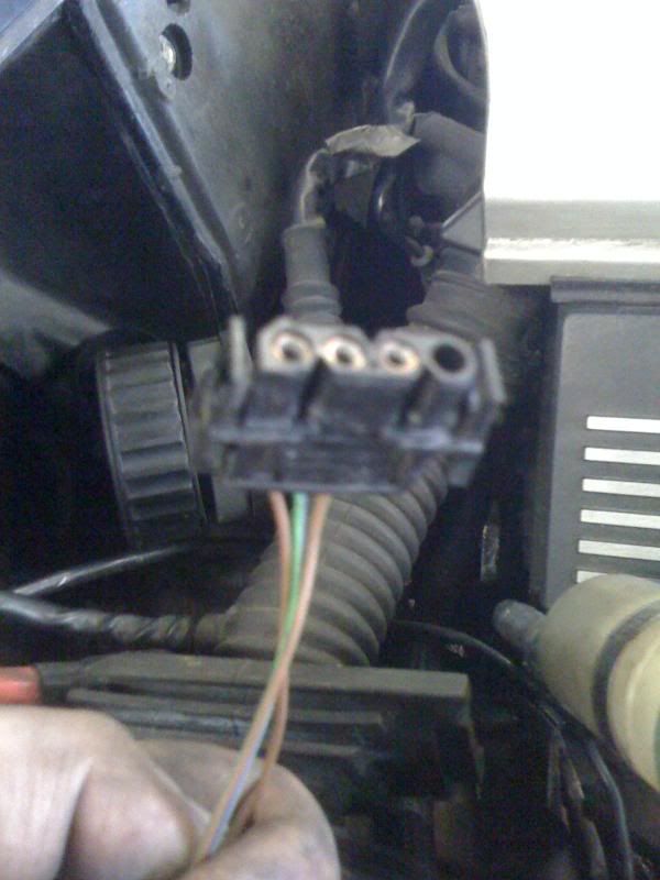

also need some loom help. im using a 1993 e34 530i loom.
the loom has the wiring where the two lambda sensor plug in, at that point there is also a two pin plug. what is that for?? its pictured on e30.de but it tells you in german and translator dont make sense.

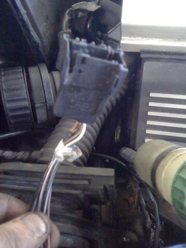

there is also the obvious where it goes into the car i.e ecu plug, battery voltage and negative feeds and the three realysbut then there are these plugs pictured below....what are they and do i need them ??

so i need to use the first two plugs shown?

looking at e30.de there is a picture of the loom layed out and it says what the plugs are. the second on i have pictures seems to be white apose to black and is for abs/asc
however the first one pictured... x10104 is not shown on the e30.de loom picture. :?

WILLNZ, i have since spoke to a very very helpful german.... non of these plugs are needed / used on an e30 conversion
RESULT!!!!

You don't need to use them, all you need is in the big X20 connector. Reverse-signal comes through one of them, though. Here you can see the pinouts: http://users.tkk.fi/jhaukile/ETC/C101_X20.pdf
