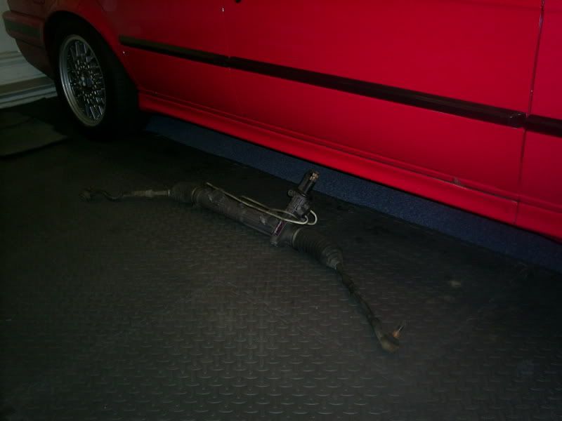

e46 compact rack adorns the garage floor and I need to send my UJ's off to you Dan (sorry it hasn't happened sooner was waiting on another one to arrive).
