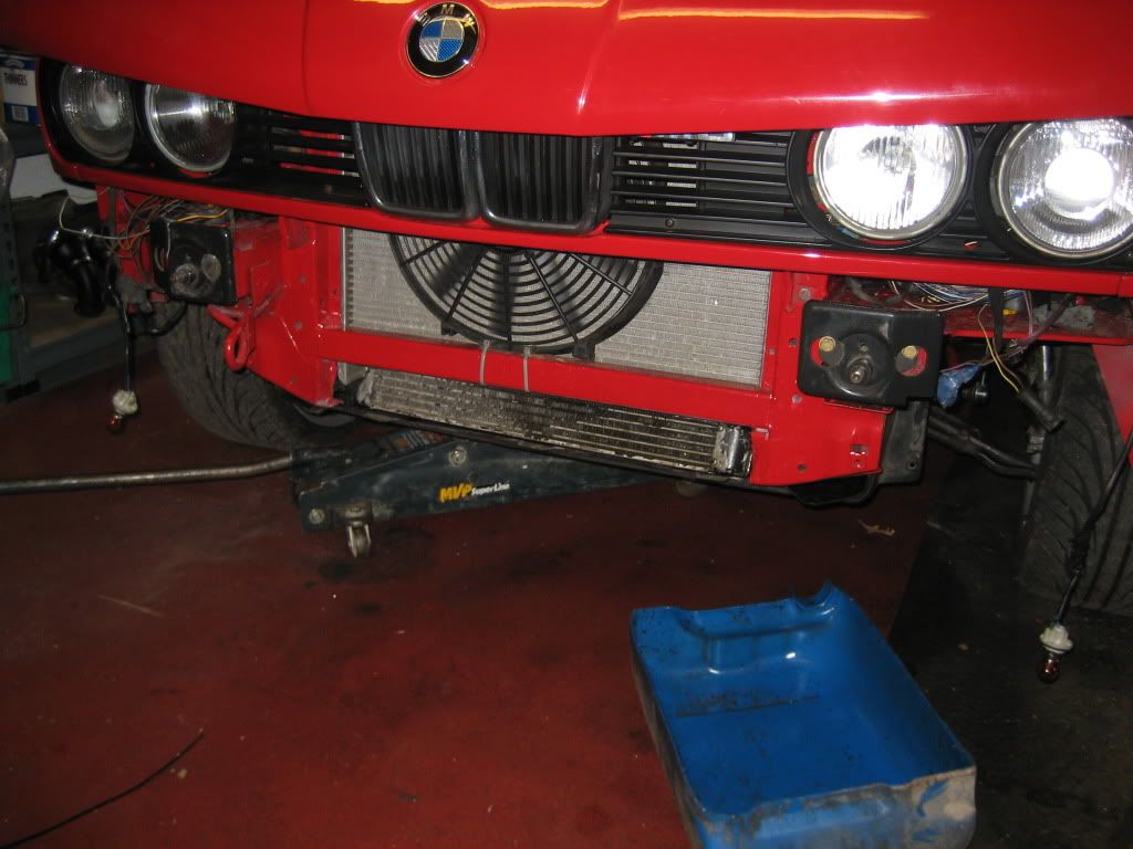

yetti24
Posts: 140
Joined: Fri Jan 05, 2007 11:00 pm
Location: southampton
Tue Mar 16, 2010 9:39 pm
i went with e36 m3 rad goes straight in place, oil cooler mounts straight to the bottom and take the blanking cap out and use a fan temp switch to run an electric fan, (i dont know if the e28 rad has a blanking cap ?)

yetti24 wrote:i went with e36 m3 rad goes straight in place, oil cooler mounts straight to the bottom and take the blanking cap out and use a fan temp switch to run an electric fan, (i dont know if the e28 rad has a blanking cap ?)
The cooler may mount to the bottom of the radiator, but it will get virtually zero airflow through it in that location.

yetti24
Posts: 140
Wed Mar 17, 2010 7:01 pm
good point ian i forgot i cut the section out and rewelded a thinner bar in a slightly different position

e92mirro
Posts: 112
Joined: Sun Feb 21, 2010 11:00 pm
Thu Mar 18, 2010 12:28 am
yetti24 wrote:good point ian i forgot i cut the section out and rewelded a thinner bar in a slightly different position
Looks nice and neat mate 8) Did you scrap the viscous fan completly or run it along side the electric fan?

hybrid
Posts: 81
Joined: Wed Jul 04, 2007 11:00 pm
Sun Mar 28, 2010 3:04 am
What im running in mine. Fluidyne all alloy from the US.
