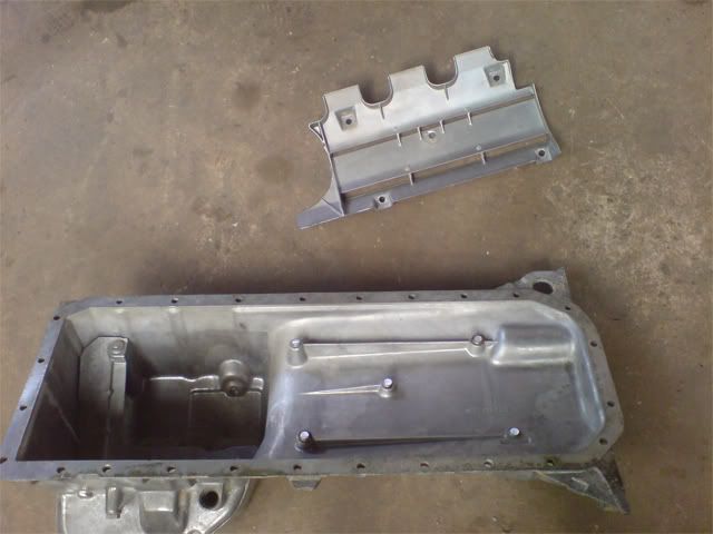

I then started on the M50 (E34) sump. It needed the oil return tapping in and a damn good clean. My crappy tap set only had one of those two handle arbors so I tapped a ring ratchet onto the tap. Bit lame but it worked a treat. I then went to re-fit the oil level sensor and found that I had to nudge the return pipe over to allow clearance. Que crappy photo's:
Image Image Image
Right: I can't decide if the windage tray in the sump needs removing! It doesn't seem to hit the crank (though I find it hard to turn the engine over without a BMW tool.. very annoying). What did you S50 guys do? The tray can be seen here for comparison:

Post Wed May 14, 2008 1:19 pm
Tray had to come out of mine.. i think :mad:
Post Wed May 14, 2008 1:23 pm
That cleaner is awesome btw.. Have to get at mine with it
Thinking about it.. Mine never had a windage tray in it, but im pretty sure other had to remove

Post Wed May 14, 2008 6:33 pm
i didn't have to remove it off the sump i used, which was off a 2 litre m50.
i'm sure i've read on here that some need removing and some dont.
perhaps it's a 3.0 / 3.2 thing?

Post Wed May 14, 2008 7:26 pm
Wasn't yours a 3.2 glenn? I'd have thought if it was a 3/3.2 thing the 3.2's would have to loose it due to the longer stroke.. That said, the crank counterweights seem to be the bit that sticks out the most, perhaps they are different on the 3.2...
I've turned the engine over with only a few sump bolts torqued down.. I'm gonna go out and torque them all down and see if it clashes, if not I'll cross my fingers and hope it's OK come startup time! I'd rather leave it on if possible.

Post Wed May 14, 2008 8:20 pm
jaistanley wrote:Wasn't yours a 3.2 glenn?
yes mate, mine's a 3.2.
i'm fairly sure ian didn't have to remove it with his 3.2.
somethings telling me james and jhonno did have to remove it on they're 3 litre's
i'm sure they'll be along to correct me if i'm wrong

Post Wed May 14, 2008 8:49 pm
glenn wrote: somethings telling me james and jhonno did have to remove it on they're 3 litre's
I dont remember removing anything from the sump, just the baffle thing from the bottom of the S50 to allow the sump to fit. Mine was a 1995 525i sump.

Post Wed May 14, 2008 9:00 pm

Post Wed May 14, 2008 9:50 pm
Dont worry Glenn, it does get confusing - Ive also read that some M50 sumps dont have the tray. I know I didnt remove anything from the sump, but thinking about it, I cant honestly remember if mine had the tray or not :o:

Post Wed May 14, 2008 10:46 pm
On an M52 the main bearing caps have extra supports, these stop an E34 sump fitting as the bolt heads hit the baffle, this is the remedy -
AFAIK this isnt a problem with iron blocks

Post Wed May 14, 2008 11:22 pm
glenn wrote:i'm fairly sure ian didn't have to remove it with his 3.2
I'm pretty sure the sump didn't have one fitted at all.

Post Thu May 15, 2008 1:17 am
Well I fitted the sump with the tray in place, torqued it down and the engine turned over fine. Guess that panic is over..
Onto the next one! I've lost all the bolts that hold the ancillaries onto the engine! I'll have to order them (and LOADS of other bits and bobs). One concern: I'm not fitting the aircon (yet) and am wondering how the hell the belt is going to go. More specifically, the tensioner bolts to the aircon bracket. Am I going to leave the bracket on the engine or is there an alternative setup for non aircon cars?

Post Thu May 15, 2008 3:11 pm
I had to remove the baffle from the 2ltr sump i used.

Post Thu May 15, 2008 4:40 pm
I spose that makes sense... Windage trays sit near the crank and I guess the 2 litre has a smaller diameter crank due to the lower stroke.. bit tenuous though!
